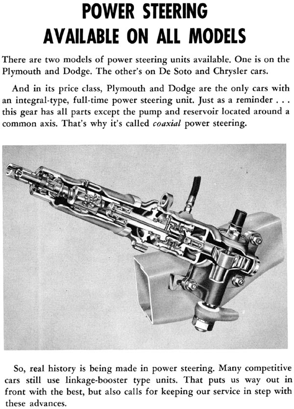

    But you might want to look into whether or not the coupling types are used on both Gemmer hydraguide and Chrysler Coaxial type steering. Some of those older models did not use a coupling for the steering wheel shaft.

    Here is a pic of the coaxial unit. The hydraguide unit has two round cylinder type pieces side by side.
