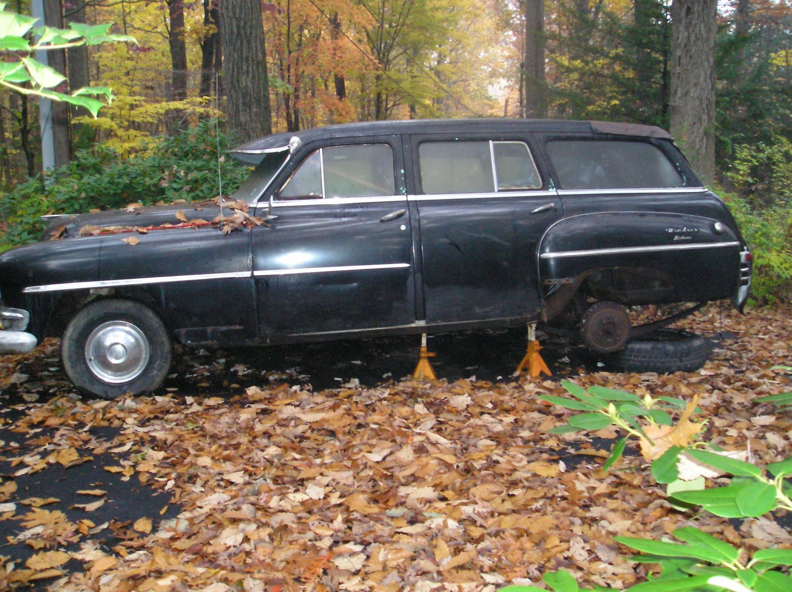

    Thought you would appreciate a picture of my old ride. This is at least 10 years ago. Lot's of metal work done before the limb hit the roof. Drove it home 15 years ago. Cancer, hurricane and retirement has cost some time. Had to rebuild my home on the coast for 3 years because of Florence. Cancer took several years out of me.

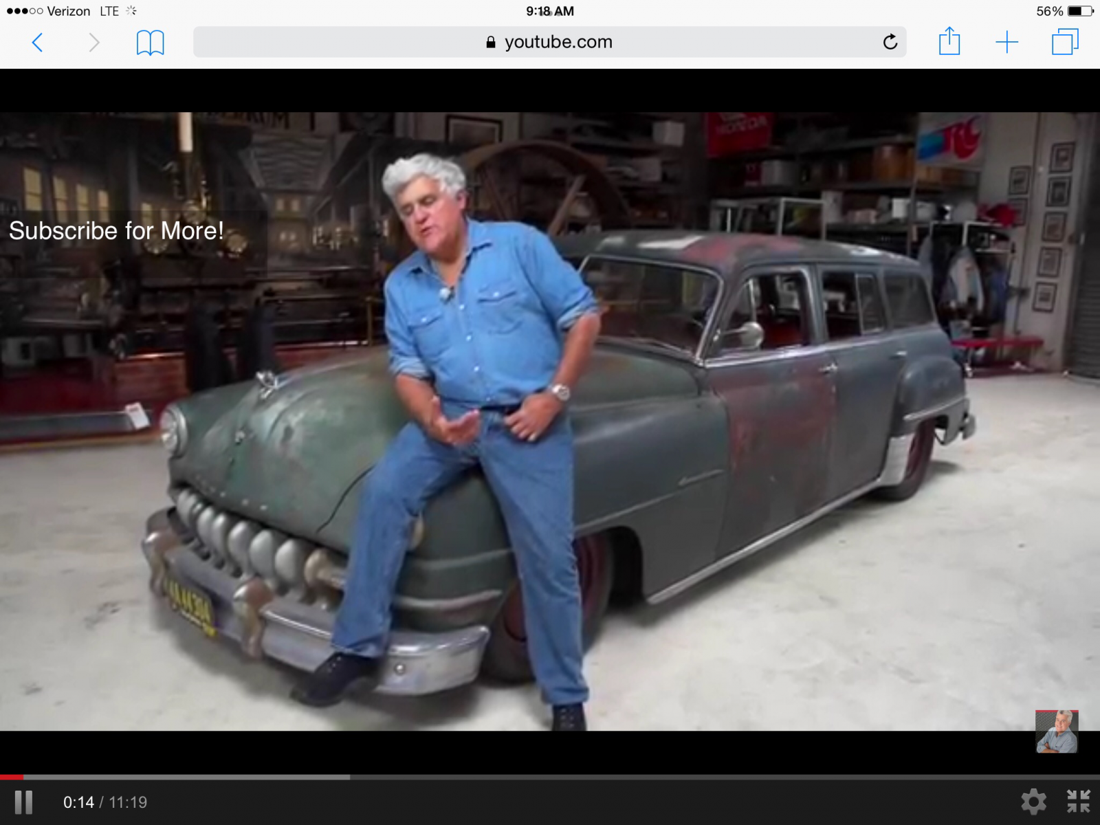

    3F048AD4-A46E-40F9-B502-270240878FE2.png a few years ago jay leno checked out a 52 chrysler wagon with a desoto front clip. late model mopar drivetrain. nice. 2015.
