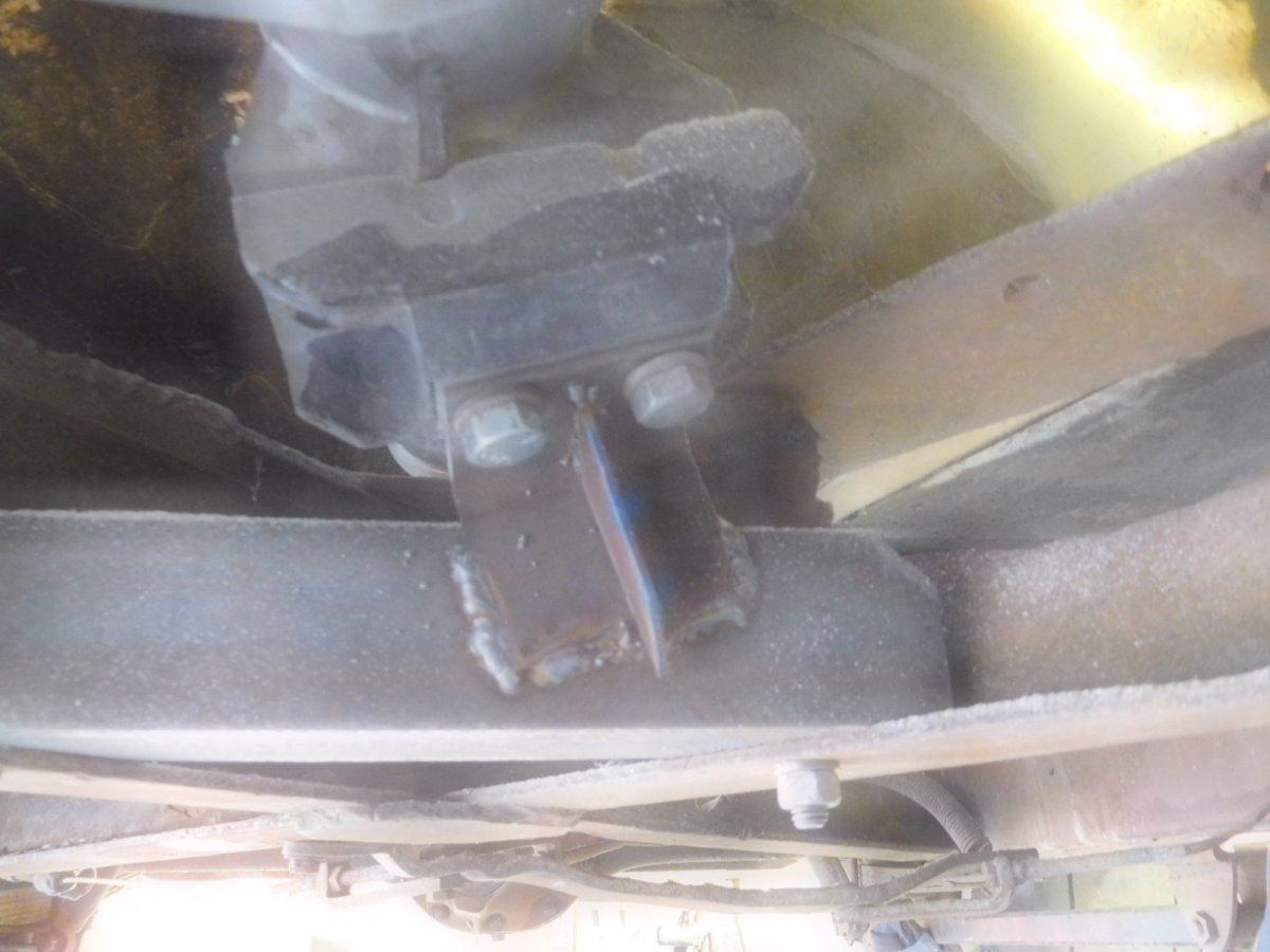

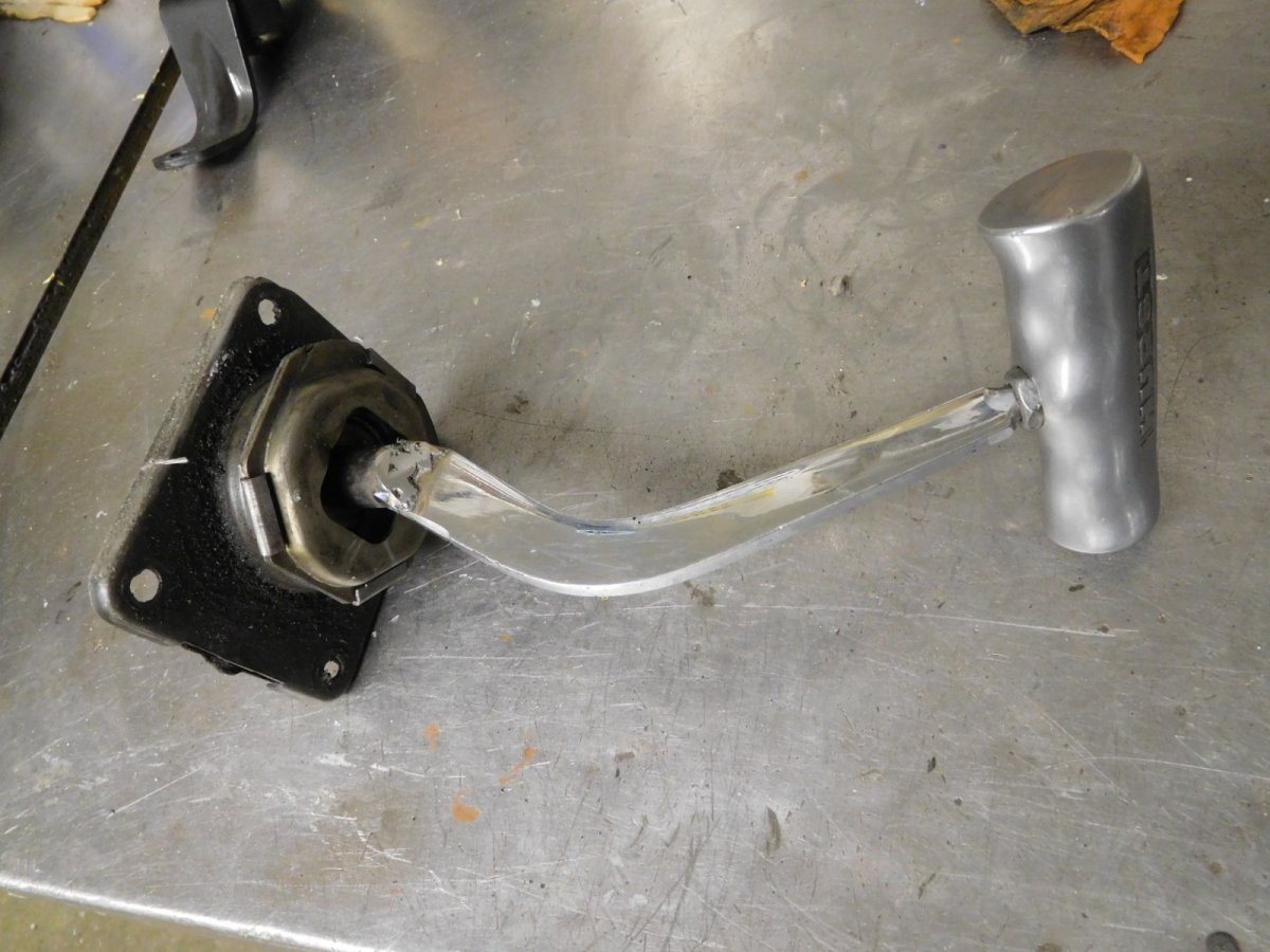

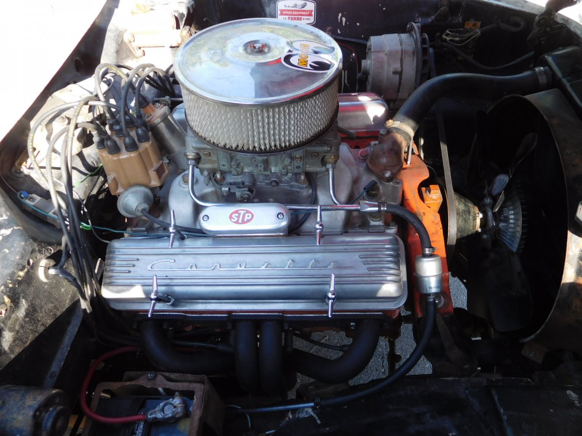

    With the engine in place the transmission mount needed to be fabricated. I'm using a 5 speed out of a Camaro. A lot of people I've talked to about using these are puzzled by the transmissions angled mounting and how to adapt it to a conventional application. Just drill out the 4 front mounting holes to 1/2 inch(they are a slightly smaller metric size)and bolt it into your old bellhousing then build the trans mount on an angle. There was a large hole for a shifter and some damage on the tunnel so I cut out the offending part and gl***ed in a patch from another car. I also cut off the stock shifter handle and welded on a Hurst type stick to make it look better. DSCN0884[1].JPG DSCN0895[1].JPG DSCN0881[1].JPG DSCN0887[1].JPG . View attachment 3230683 View attachment 3230683 View attachment 3230687

    Nice fabrication trick, the car is looking great.

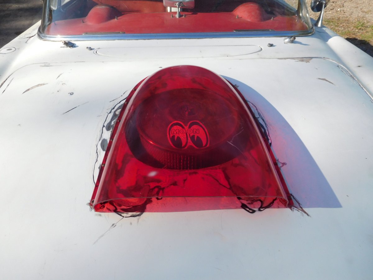

    Doing a little work on the hardtop. I installed the red tinted back window and stuck a headliner in it. I had some red "Doeskin" headliner material left over from an old project so I used that to make the interior a little more inviting. Also chiseled some seat belt brackets off the bottom of a body shell I've got laying around. Corvettes didn't have seat belt anchors until 56 so I installed some later ones in the 54. It's getting close now, just need a cooling system, exhaust and carpet. DSCN0896[1].JPG DSCN0904[1].JPG DSCN0902[1].JPG

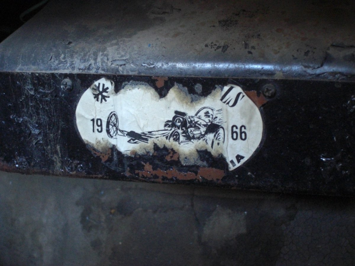

    More than just "Cool" - that is a Winternationals decal from Pomona, CA 1966 ~ So that car did some real racing to come down south!
