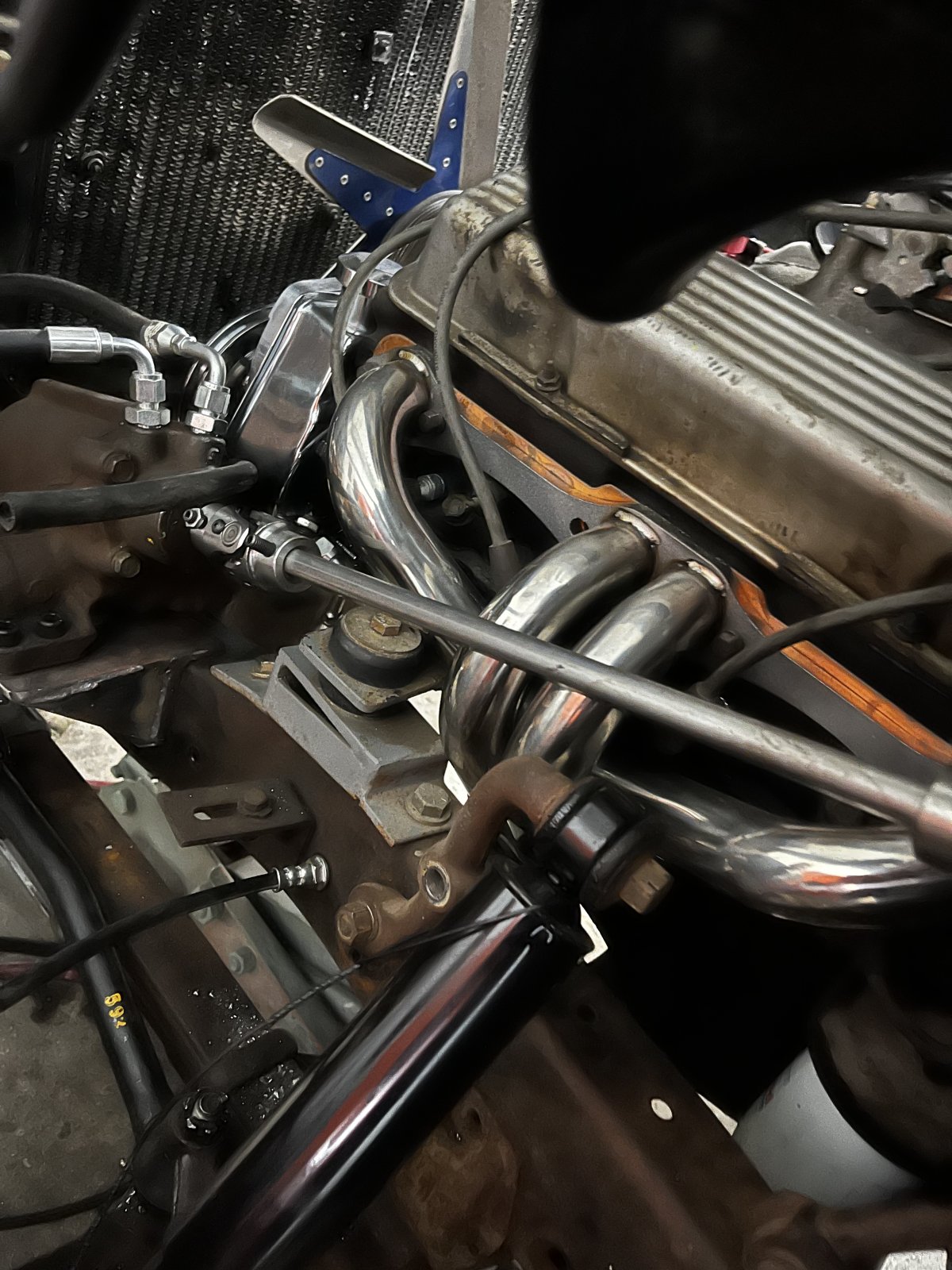

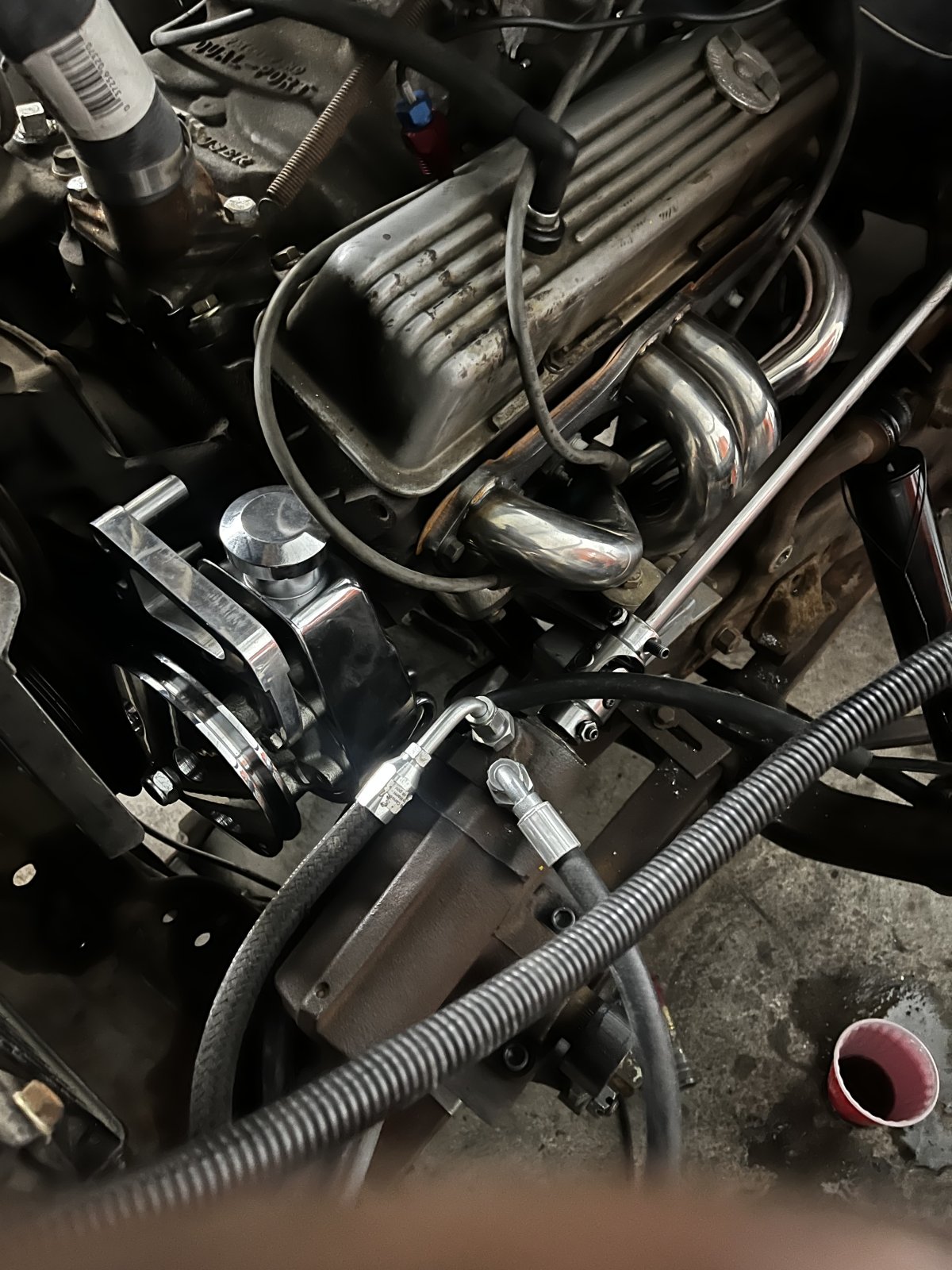

  7. Here’s a pic
    stubbsrodandcustom likes this.

    Good looking Panel for sure. After looking at your photo I think your issues may lie with the Mechanical nature of the steering box and pressures. The Ch***is angles look good and should be close to stock so the caster should be about spot on also. I normally wouldn't suggest adding caster in, but I think 2 degree shims to put you 8-9 deg may benefit vs going down the rabbit holes of pressure regulating etc. You evidently have enough power in the steering box where things feel light, and adding caster will add some effort and more steer ahead tendency. I would say give it a try and let us know your findings. Its easy to swap back if there is no change.
