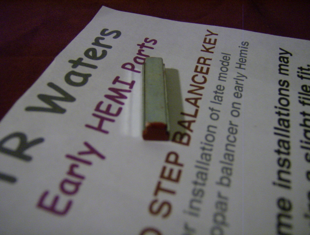

  15. TR Waters
    Joined: Nov 18, 2006
    Posts: 1,439
    TR Waters
    from Vermont
    1. Early Hemi Tech
    there is no 259 or 301. there is however a 291, 341 and 345.
    I sell the stepped balancer keys and a few other parts for the Dodges, like a front fill valley cover.
