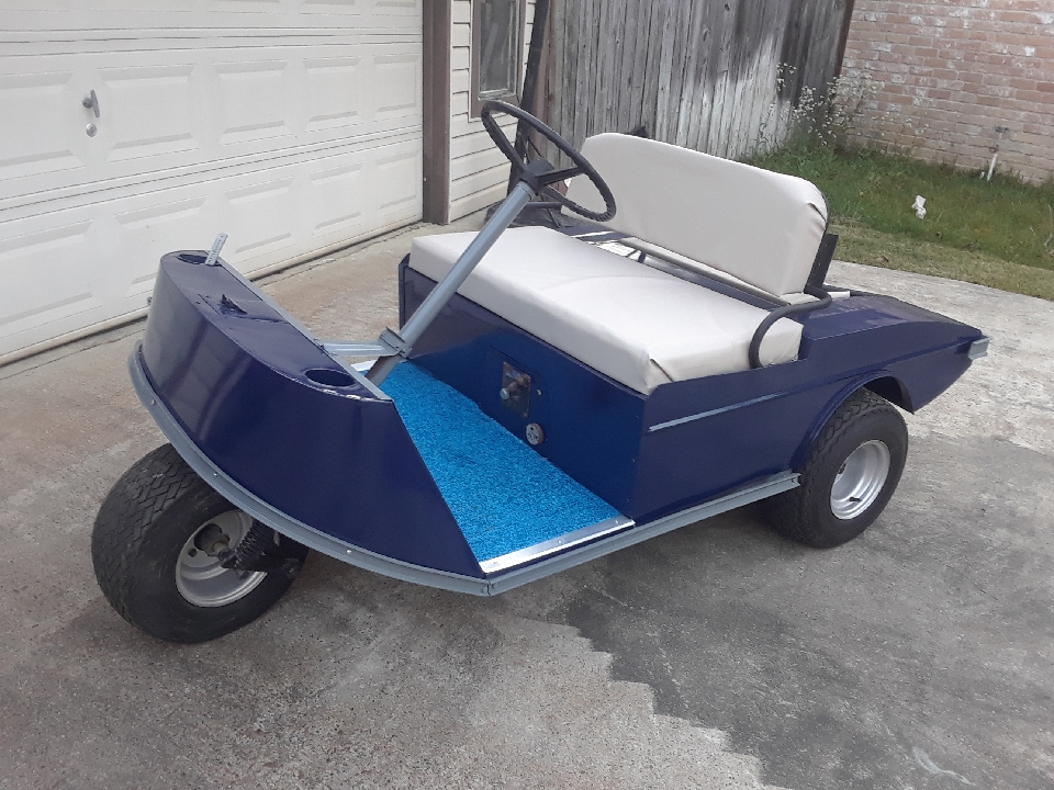

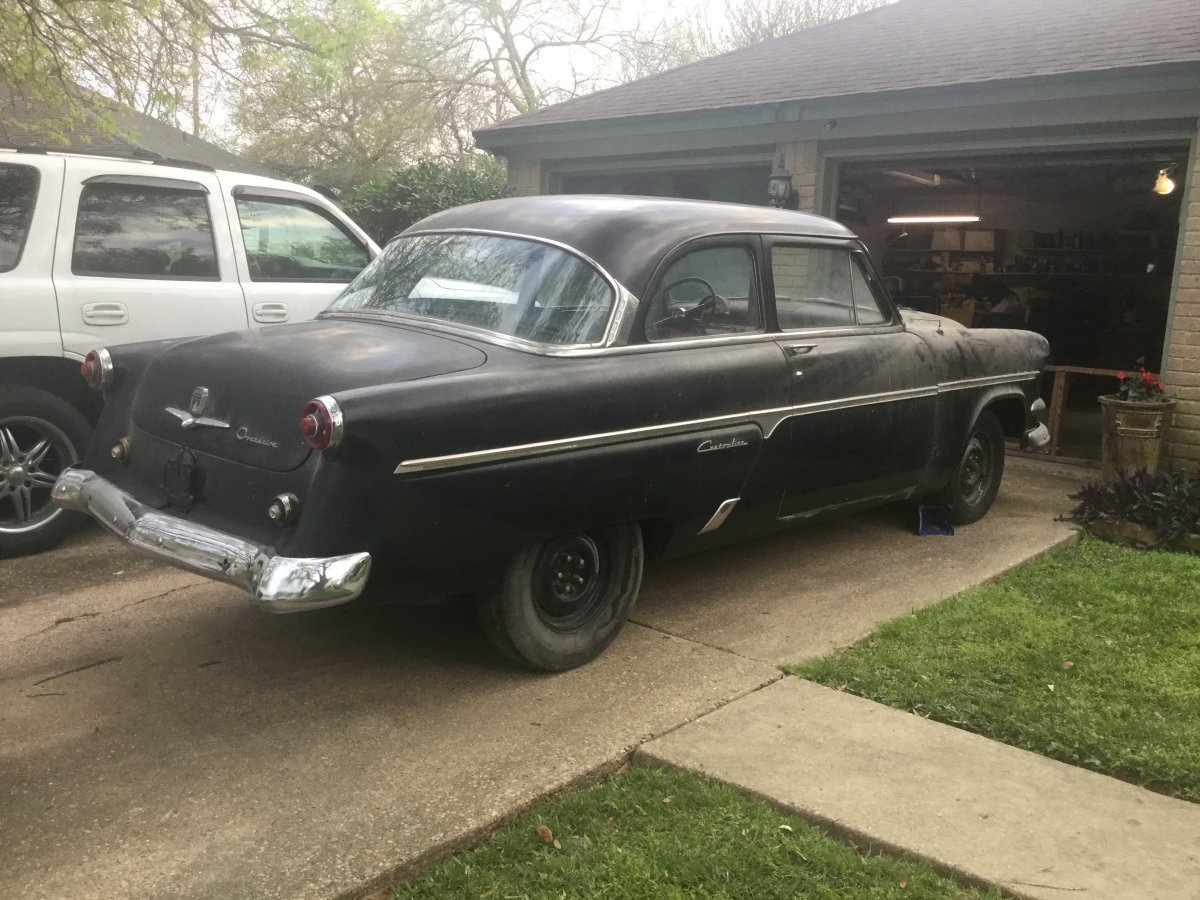

    So finally got going on my 54 customline. Been sitting in my driveway looking for some attention. Unfortunately I was a little preoccupied finishing a vintage golf cart of all things, but I had to get it done to free up the garage space and my time. I knew if I started on the car the cart would never get done and I badly needed to get it done and out of my garage. I have been posting some questions for several weeks while the car was in planning stages. I did scrounge up some parts and have also been practicing my sewing skills as I plan on tackling the interior myself. I have been following a few folks on here and learned much from what they have posted. Hopefully I can gain more info and maybe p*** some along.
    dwollam and treb11 like this.

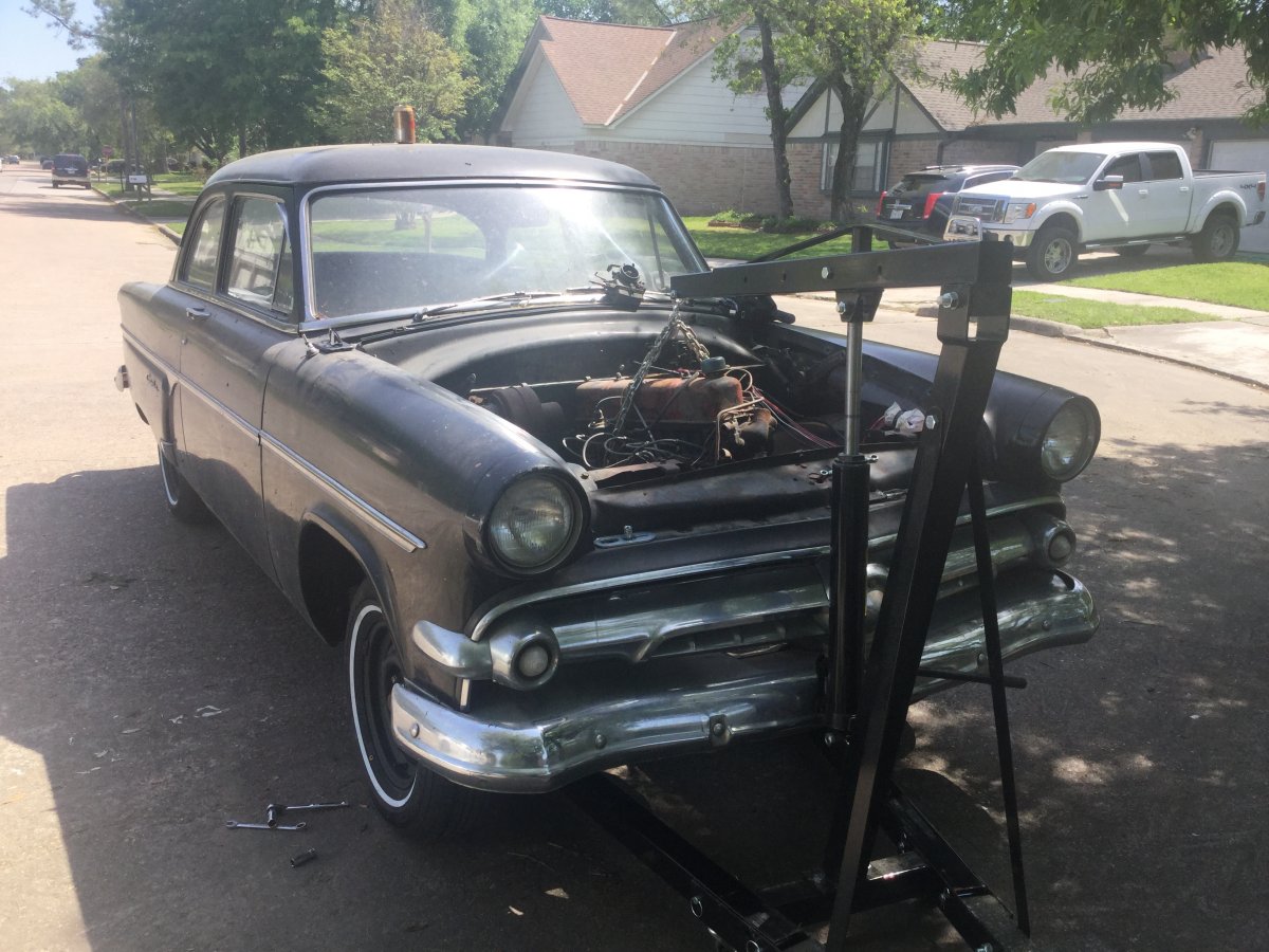

    So this is what has been holding up the start of my build. It was a mangled mess and glad to see it done and gone.

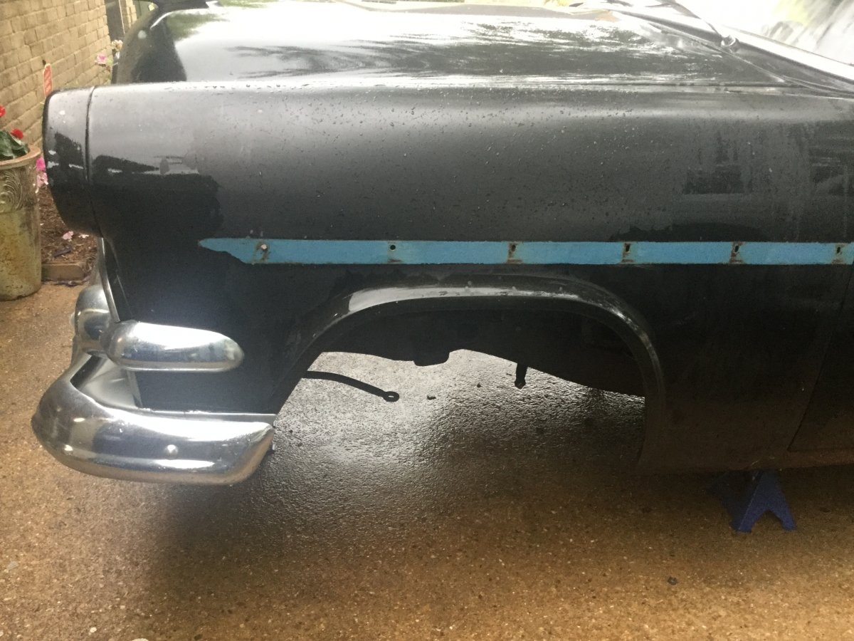

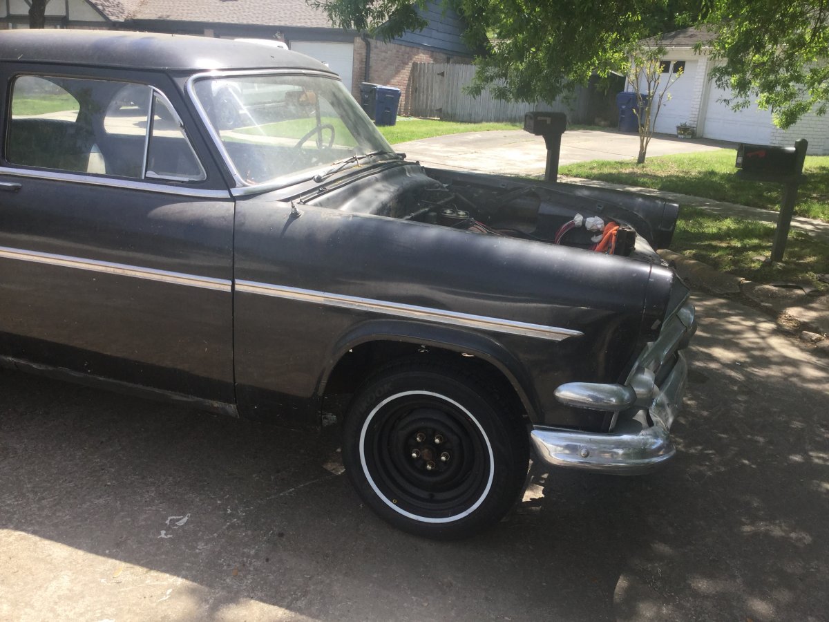

    I had to roll the car out on to the street to yank the old 6 cylinder out. Unfortunately I have a little incline to my driveway and it would have been a little tough to move the hoist around. Probably would have took off on me. So started early before it warmed up out there. Perfect 60 degree morning. Couldn’t have asked for a better temp.
    treb11 likes this.

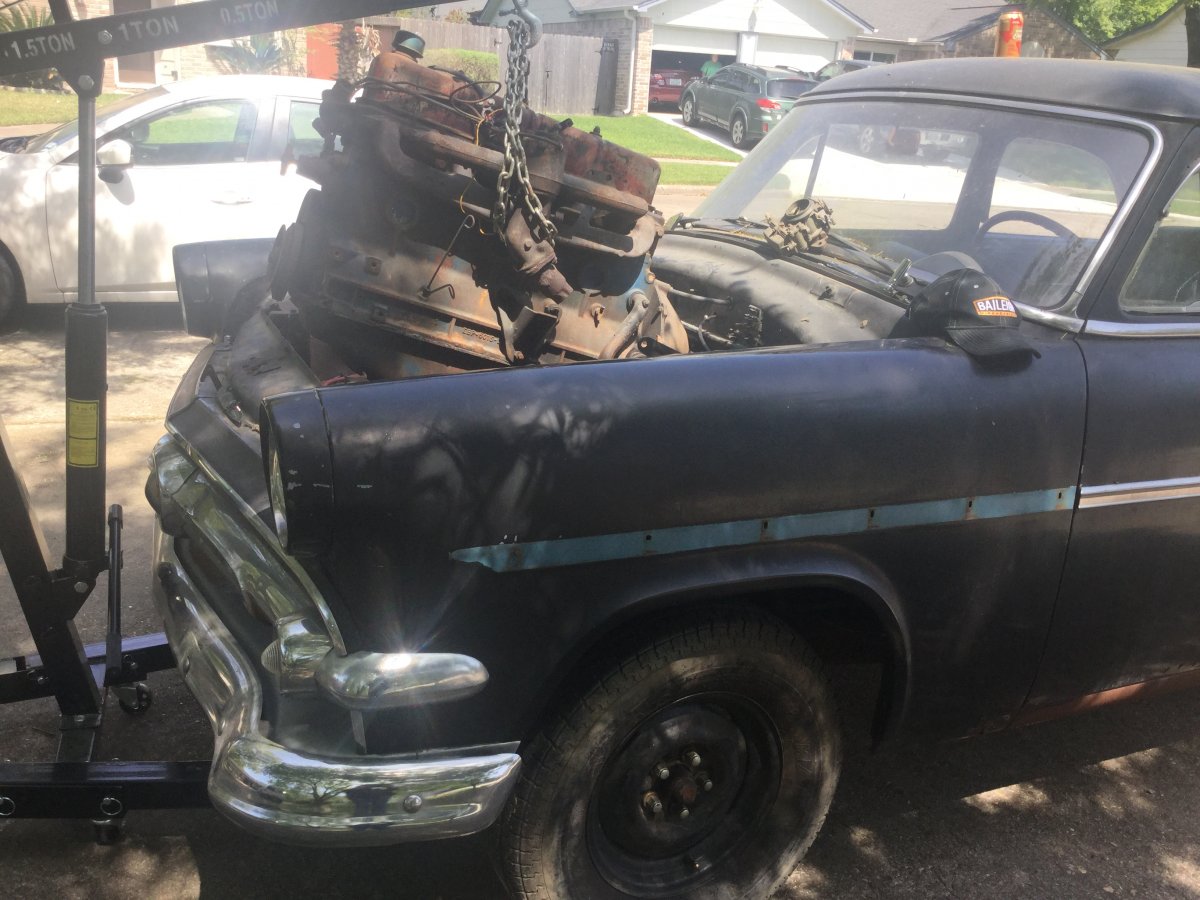

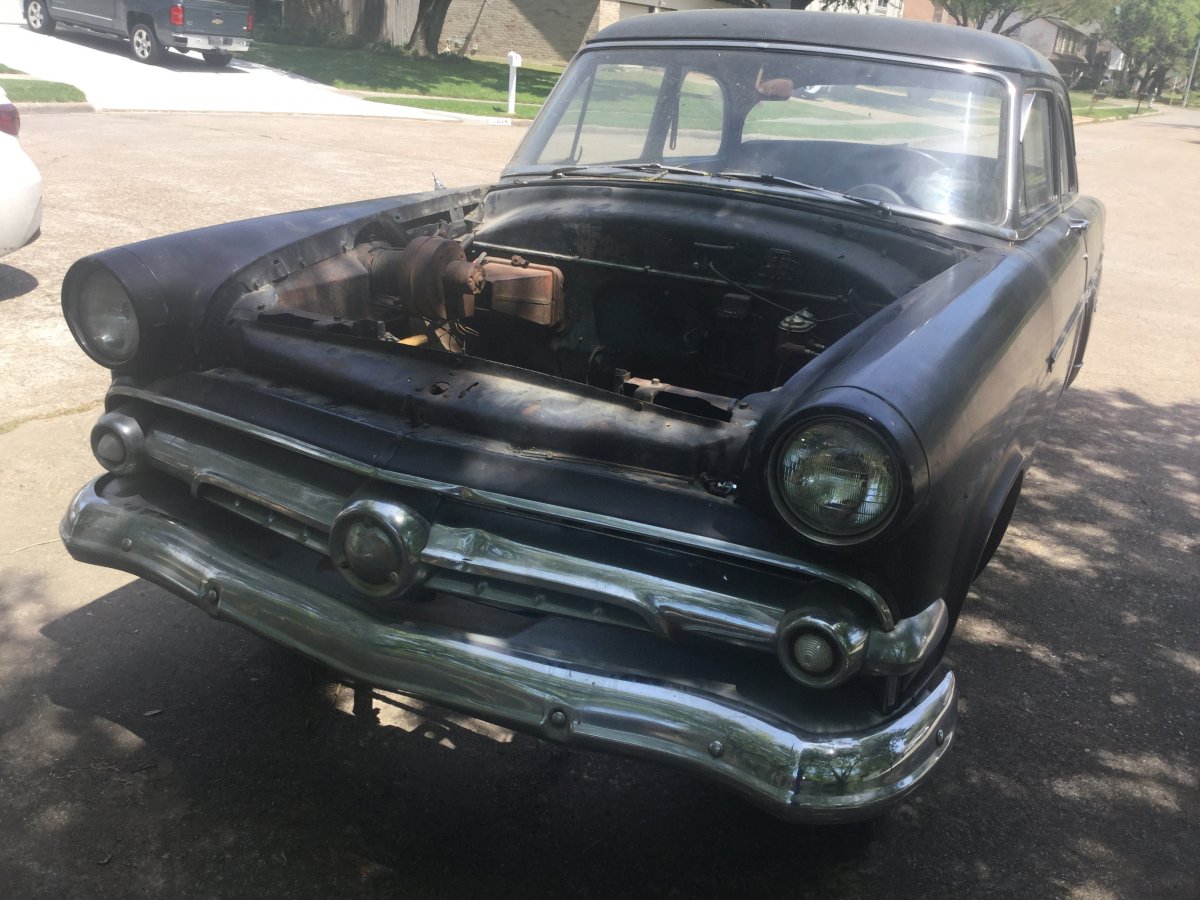

    Three hours, four wrenches, one screwdriver, one wire cutter and two diet cokes and she was out. Happy to see an empty engine bay. Time for a shower and an old man nap.
    Unique Rustorations likes this.

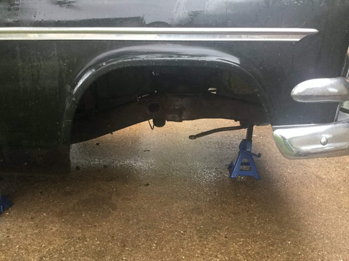

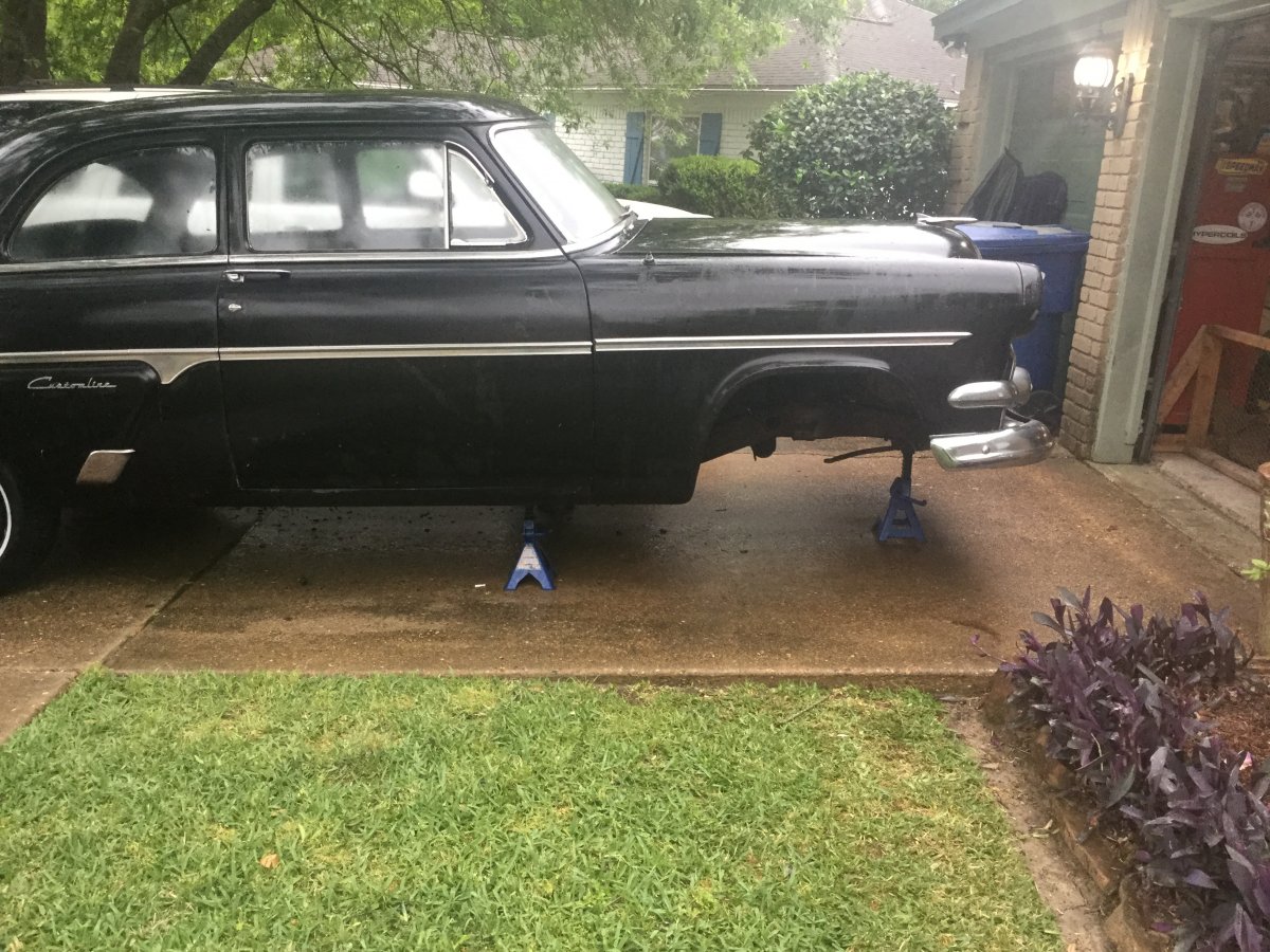

    Hopefully I’ll have nice temperatures for tomorrow. I plan on putting her up on stands in the front and start the front end dis***embly. Take my other 2 tires up to the tire shop and have my two others mounted and balanced. The first two I had to have mounted up a little earlier than expected as a couple of my tires were going flat. Needed to have tires with air in them to roll the car around so I had a couple of the new tires mounted and balanced. I’m going with Hankook white walls. I don’t want to spend 1200 bucks on wide whites. I know the look better and more period correct but this is going to be a daily driver. So a 250 dollar set will have to do for something I plan on using as my primary transportation. I just can see burning up expensive tires on the rough roads we have here.
    earleg likes this.

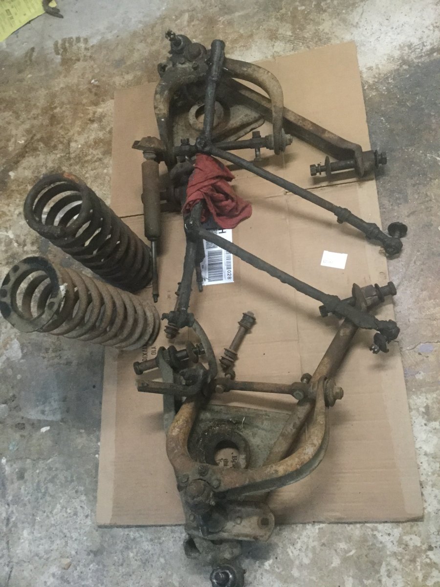

    Front end is apart. My plan is to take tomorrow off and go through all of my parts I bought. I still have stuff in boxes and need to get a firm inventory of what I have and what I’m missing. Also need to clean the garage and make room for the beast. It’s a bit bigger than it looks. Bought some little wheel carts to put under the tires so I can slide it around a little easier and move it to the side when not working on the car.
