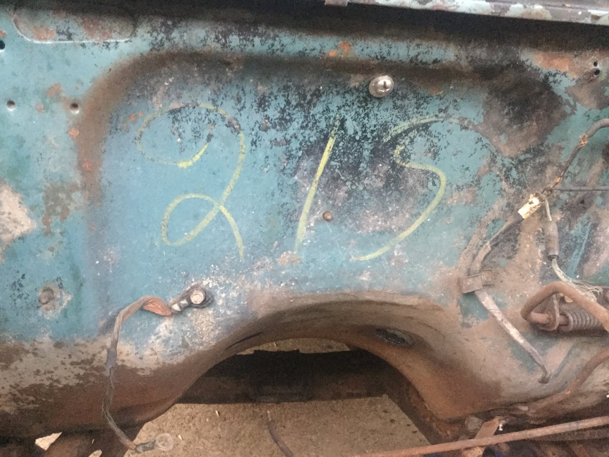

    I was thinking the early ford OHV sixes were 215 cu. in. Maybe that's what the chalk numbers mean?

    My '61 Motor's Manual says '53 was 215, '54 and up 223 cu in for the six cyl's.

    Picture of the marking on the firewall. Really like to know what it means.

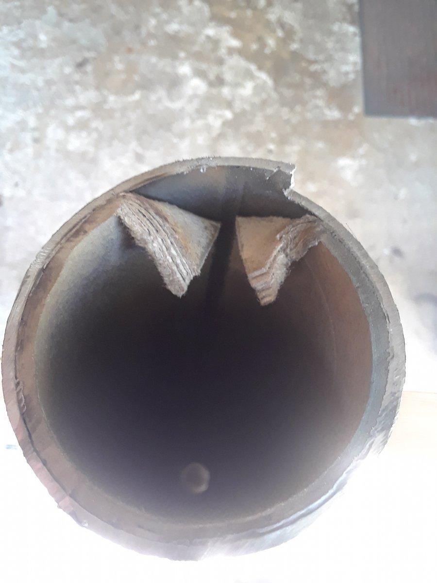

    CA07A44D-6D78-4D4A-A0AA-53E645026F0D.jpeg Here is a mystery to me. I cut the drive shaft with a cutoff wheel so I could keep the yoke in the transmission when I yanked the motor and transmission. I found a sleeve of cardboard inside the drive shaft. Anyone have any idea why it’s in there? Kinda trivial, I know but just one of those things that drive me crazy not knowing.
  9. The tubes are installed to cut down on noise. I absolutely love your choice of engine. Best way to update an old Ford!

    Thanks, I kinda was wondering if it was sound dampening.

    So is it really necessary? I’m making my own drive shaft. Have the 3” DOM tube and the weld on drive shaft yokes. Anything else that can be done to cut noise?

    Spray in foam maybe?
  13. I was told the cardboard was put in after the first end yoke was welded on and then when the second end was welded the cardboard would burn some causing a Vacuum so the weld wouldn't have a blow hole in it.

    When I bought the 3” DOM drive shaft tube, it came delivered in a cardboard sleeve. Maybe I could cut a groove down the length of the cardboard tube and slide it inside of my steel tube like a tension pin. Good way to get rid of the cardboard tube.
    I also was thinking about a spray in foam. Just leave a few inches if each end of the weld yoke. Could actually spray the inside of the tube with spray in foam and then protect the foam with some ceramic ( k-wool) insulation that we use for welding.
    Got some time to think about it. Just not sure how noisy it would be if I just made the drive shaft with no sound deadening.

  16. I believe you may be over thinking things on the drive shaft. I have cut apart way more shaft's with nothing in them than ones with cardboard in them. Also I would not use any kind of spray in anything that could cause a heavy spot inside. That could easily cause a balance issue, you don't want that. My local Drive line service drills an 1/8" hole in the tube 2" from an end. Once the ends are on and cooled off he plug welds the hole shut. That's how he keeps his perimeter welds solid. I'd go that route.

    Bob they press in and you need a press to help.from memory they go in a certain way good advice on pictures as with any job.they are the same from 54 to 56 and oddly checker cab.on the question about the 215 as someone suggested it is probably to indicate the 215 motor by some old mechanic so in future they would know size.saving time for next guy looking for id on size of motor
