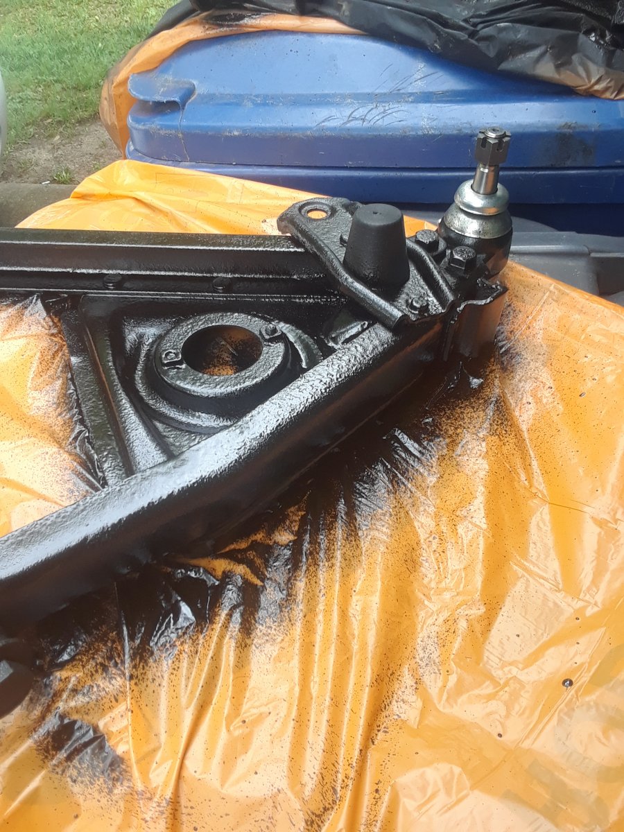

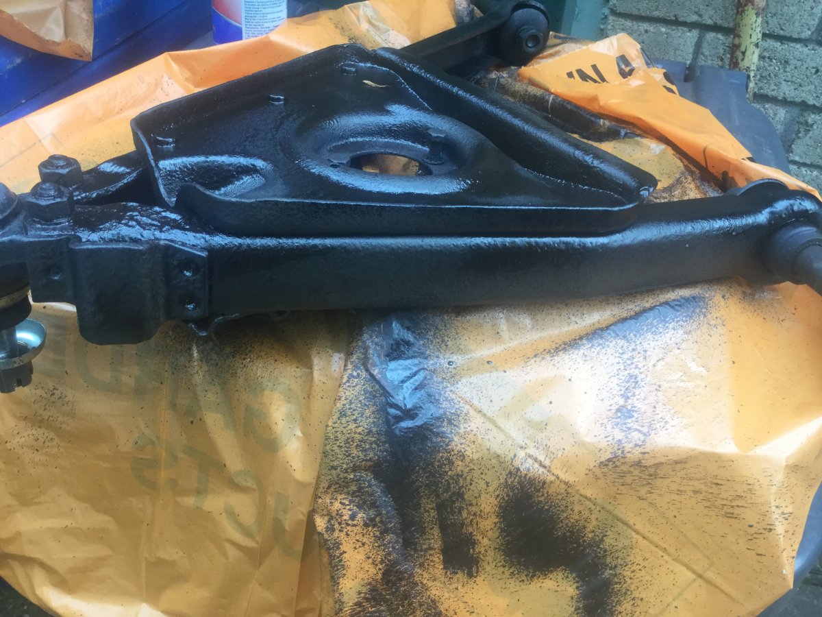

    I had pressed one of my lowers in from the wrong side, I had the arms all apart, acid dipped to get the rust off. I was looking at it, looked at the manual and saw my mistake. I believe the flange on mine was on the inside of the arm. They press in easily with a bench vise and big socket.
    After they were together, I de-greased everything and shot them with VHT matte black, rollcage & ch***is black. I got a great deal on a box of 6 cans on Amazon. This is a real nice paint.

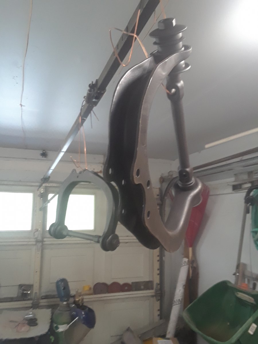

    Got the uppers and lowers painted, the lowers didn’t clean up as well as I wanted. I had to use a wire wheel on a grinder. But gave them a coating of rubberized undercoating to hide some of the imperfections. The lowers and the entire frame and underbody was covered with undercoating. It was on so thick that it looked like a spray in bed liner. The crossmember was at least an eighth inch thick with coating. Got it all off, painted and gave it a new, thin coat or rubberized undercoating from a can. So at least the areas of the frame that are near the front suspension are done.

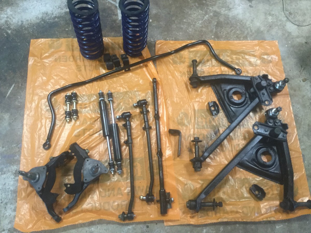

    The front end rebuild kit that was bought on eBay, the seller was Anderson Restorations. Looks to be a nice kit. Couple of complaints but nothing major. I wish they would have labeled the bushings. It’s like a damn puzzle to figure out what goes where. The ball joints have to be fit. They do not just slip right in. I know the a-arms can be compressed on the ends but these needed significant grinding to fit. The other thing is the bolts provided are larger than stock. I liked that the replacement bolts were a little beefier, but it would have been nice to know that you have to drill out the ball joint bolt holes on the uppers. ****ed to find out after I had the uppers bolted on. I kept the ball joint off to make it easier to fish the uppers through the inner fender well. Found out after that modification was needed. Should have test fit first but I ***umed it was all good to go. So be prepared if you buy a rebuild kit, check all fits first. Save some time and some scratches in you paint...good thing I wasn’t going for show quality paint on the parts.

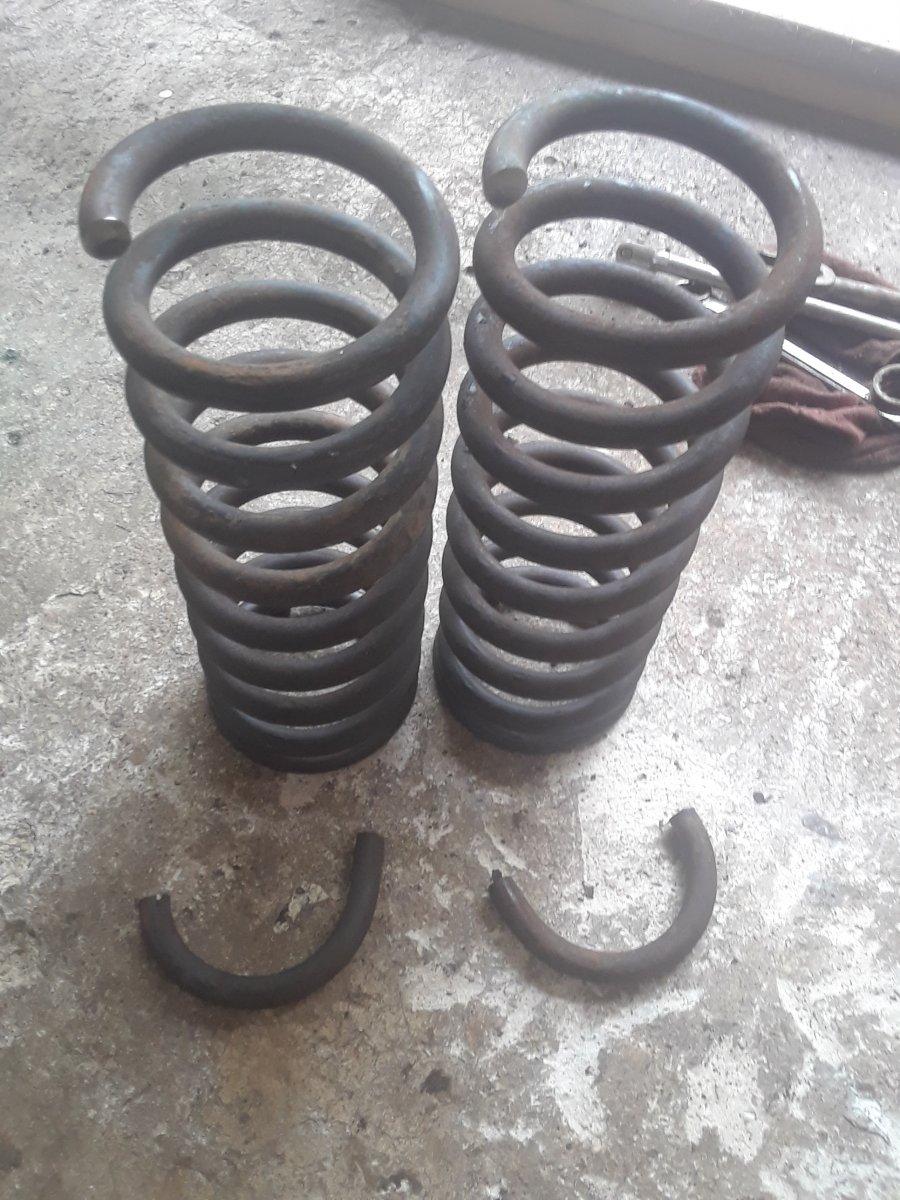

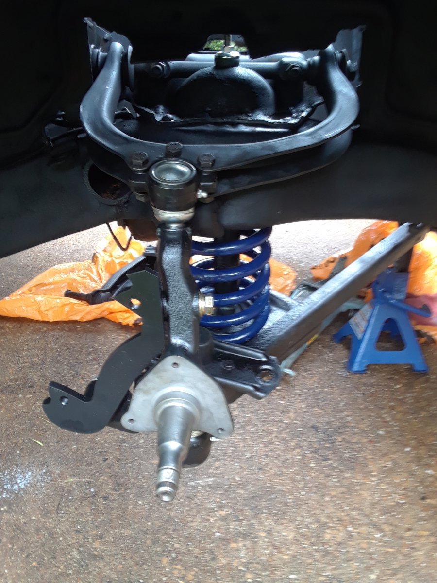

    According to Dave at Drop and Stop, cutting a half a coil along with his 2-1/2” drop spindles will give me the front ride height I’m looking for. I don’t want to go too low in the front because I’m going for a squatted rear rake to the car. Hopefully with the 4 inch blocks in the back, I’ll get the look I want...Springs cut, cleaned up and painted. Ready to go back in. Plan on getting the front end back together over the next few days. I’ll post more when I get a little more done.

  17. bobss396
    Joined: Aug 27, 2008
    Posts: 18,908
    bobss396
    So both spring ends are full coils? On my '59 the top is ground flat. Look up into the frame pocket and see if the end of the coil has to register into a notch. I've seen it on some GM cars. If the lower end that goes onto the arm doesn't have a hard stop for the coil end, you're ok. What I'm getting at is sometimes a 1/2 coil cut off makes it hard to locate the spring at the top and bottom. So the car can sit ****eyed when all ***embled.
  18. Jeff Bohmann
    Joined: Jan 21, 2019
    Posts: 152
    Jeff Bohmann
    The one end is flat. The end I cut is the pig tail end that fits into the lower control arm. There is a slot in the lower that the end of the spring fits into. You can see the little relief for the end of the spring in the pictures of my lower control arm.

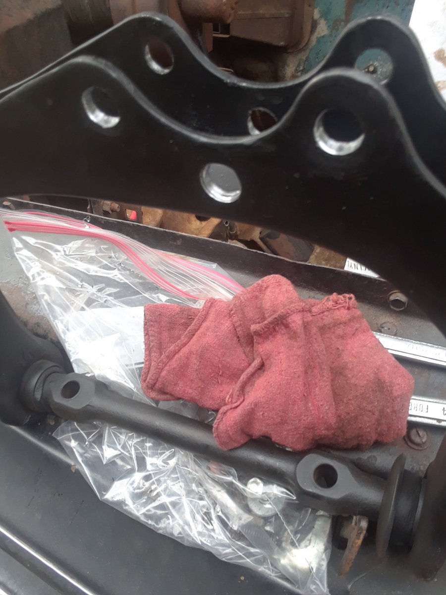

    Everything, well almost everything ready to go back in. Ran into a snag with the center link. A little more help from Dave at Drop and Stop and it was figured out. I had to put in a quick order to Mac’s and get the correct bushings for the idler arm. Ended up just getting the kit for 41 bucks. Included the arm, bushings and grease fittings. I had the bushing kit for a power steering idler arm. Guess that is why it didn’t make sense how the bushings went in...
    Also had to spend a little time fixing the stud on the center link. Damaged the threads a little when I had to split the nut with a cut off wheel. I nicked it with the cutting wheel. A little grinding and some work with a thread file and an hour later, success...nut threads on great.

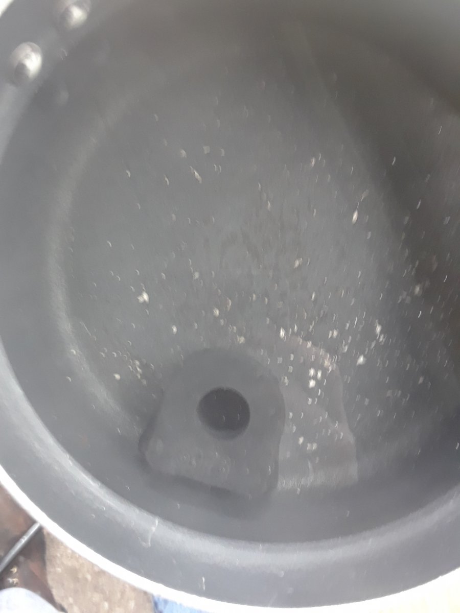

    Does anyone know where the correct place to slit the sway bar bushings?
    The kit I bought has sway bar bushings that are one piece solid with no slit to slip around the sway bar. I doubt if they will fit over the large eye at the end of the sway bar. The original ones were split but for some reason I must have tossed them and have nothing to compare them to. I usually hang onto everything until I’m done and don’t need. If anyone remembers how they go, it would be appreciated. Obviously the split needs to go where there is the least amount of force, but im not sure what that would be....
  22. Jeff Bohmann
    Posts: 152
    Jeff Bohmann
    Was thinking the sides ? Figured the pressure has to be top and bottom?
  23. s55mercury66
    Joined: Jul 6, 2009
    Posts: 4,367
    s55mercury66
    from SW Wyoming
    You might try heating them up in a pan of water, and using some silicone type lube to get them over the end eyes.

  27. Jeff Bohmann
    Posts: 152
    Jeff Bohmann
    Worked great. Had my wife boil some water, once she got it to a boil I took the pot outside and tossed them in for a about 5 minutes. Sprayed some WD40 on the eye of the sway bar and with a little shove they slipped right on...probably much more sturdy than slicing them open.

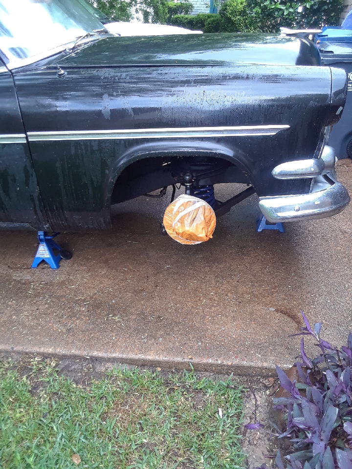

    Weather was hit and miss all day. Made much progress until god looked down and said “I hate you” and dumped a deluge upon me. So quickly covered any bare metal and headed in.

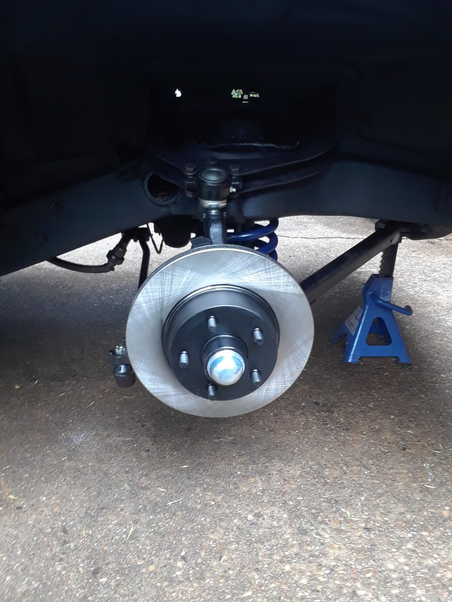

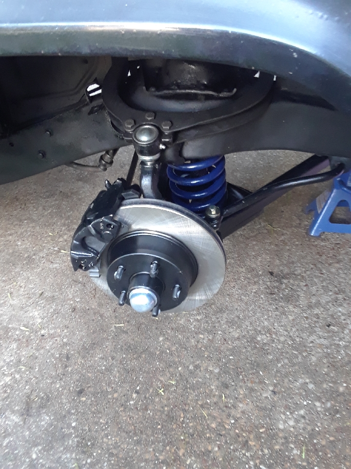

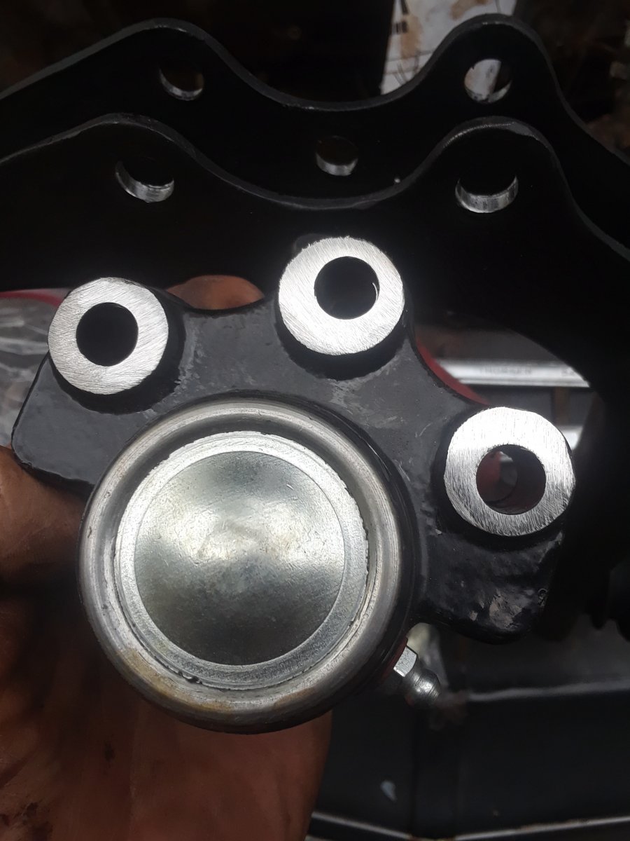

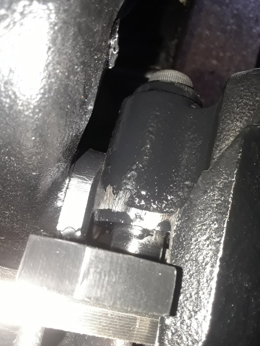

    The disc brake setup worked nice. Minimal fitting. As I mentioned before, Dave from Drop em and Stop em set me up with a bracket for the Granada spindles that will allow me to run GM metric calipers. Only had two little issues. The calipers had some casting flash that rubbed on the caliper brackets. It wasn’t much but probably enough that it could hang up the caliper and interfere with it floating. You can see in the picture how close it is and the grind marks where I had to clearance the fit. One caliper was way worse than the other. Just a couple swipes of the grinder with an 80 grit disc and it was gone. The other issue was when I installed the caliper the mounting bolt protruded through the bracket and hit the back of my rotors. Had to shorten the bolt between 3/32 and and 1/8 inch. All that took less than 5 minutes of fitting. But I am totally happy that I went with the GM setup. The Granada brakes were way to hokey for me. The GM calipers that go on the brackets were nice size and should provide plenty stopping power. Dave’s kit came to me with the brackets already installed on to his Granada drop spindles.
  30. Jeff Bohmann

    Jeff Bohmann

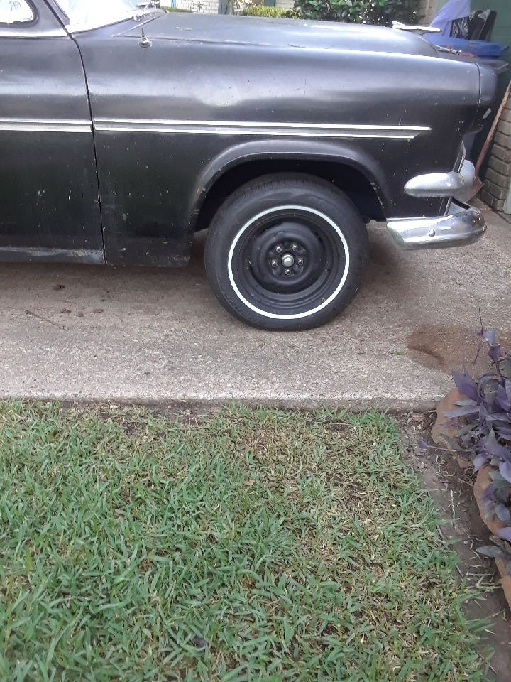

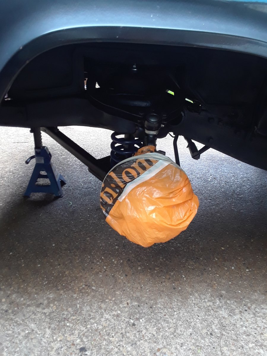

    So once the downpour ended, it cleared up and I was able to get the brakes on and the sway bar installed and she was back on all fours before dark....everything is super tight and difficult to even move the a-arms. With no motor and transmission and everything in the engine bay stripped down, there’s no weight at all to the front end. I’m hoping that it will drop at least 3 more when I get the drivetrain in.
