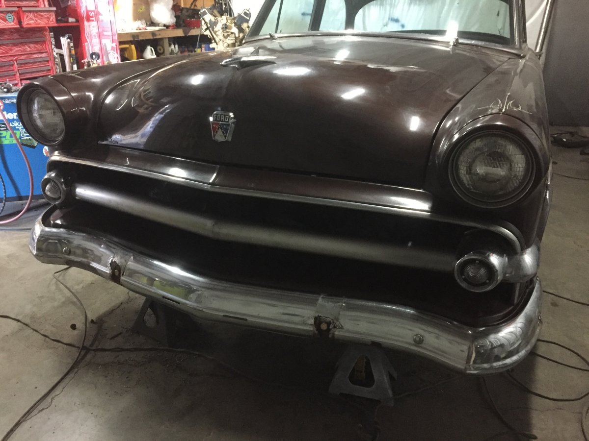

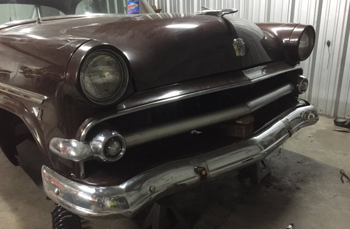

    Grill is looking good! I removed the bumperettes and the center section on mine also.

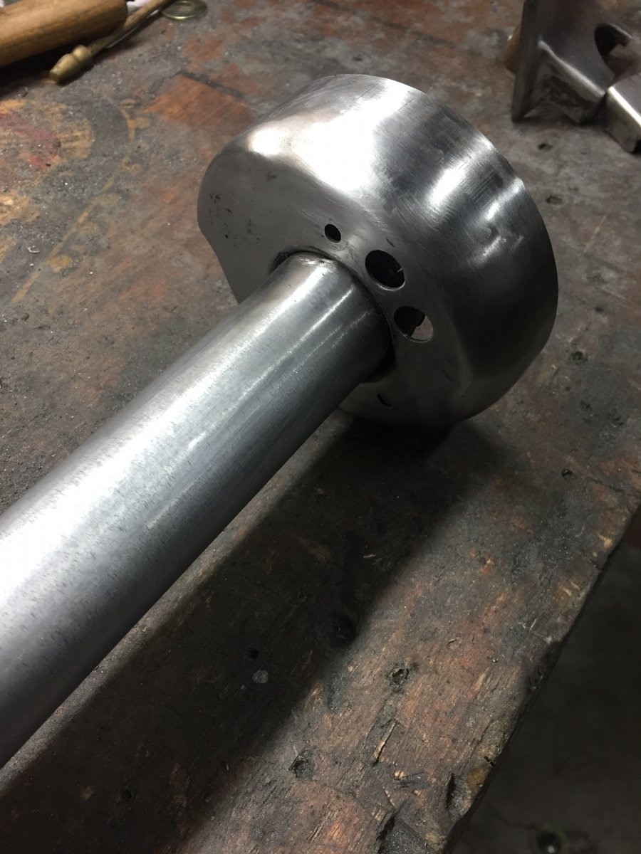

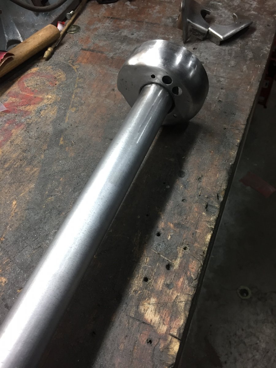

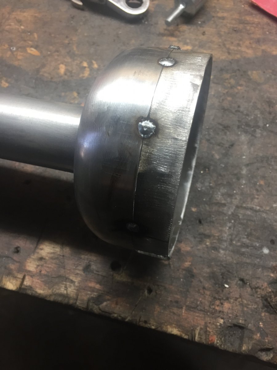

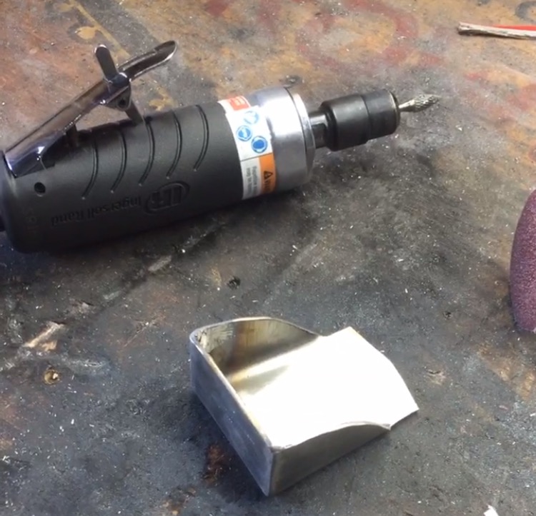

    Welded an extension on to the column to fill the gap that the '49 wheel had between the stock column. Heres a pic of it welded and ground but forgot to take a pic of it all sanded n metalfinished

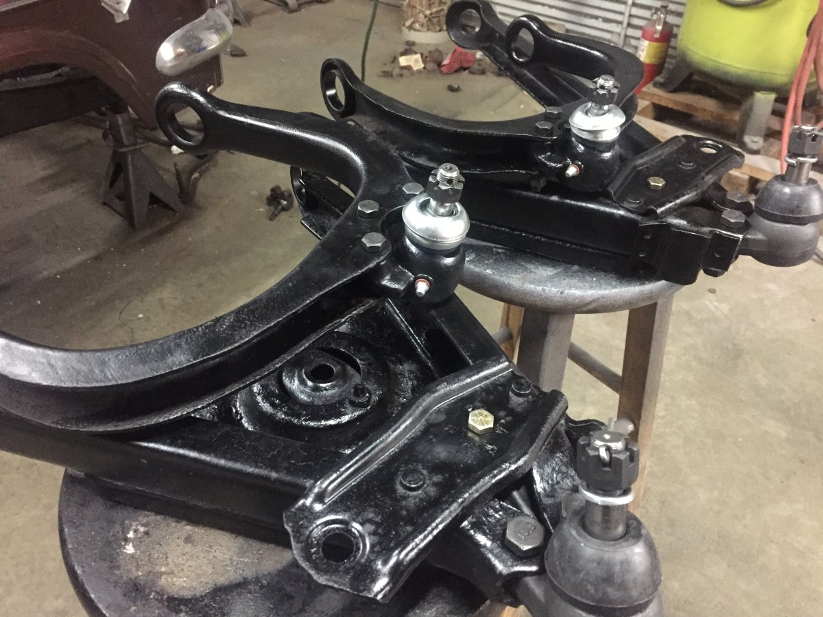

    Got the control arms cleaned and some paint slapped on em. Also got the new ball joints in and the bushings into the lower control arms. I had issues and ended up messsing up the bushings for the upper arms so i have a new set ordered from carpenter on the way. Anyone have any tips for the bushing install in the upper arms?

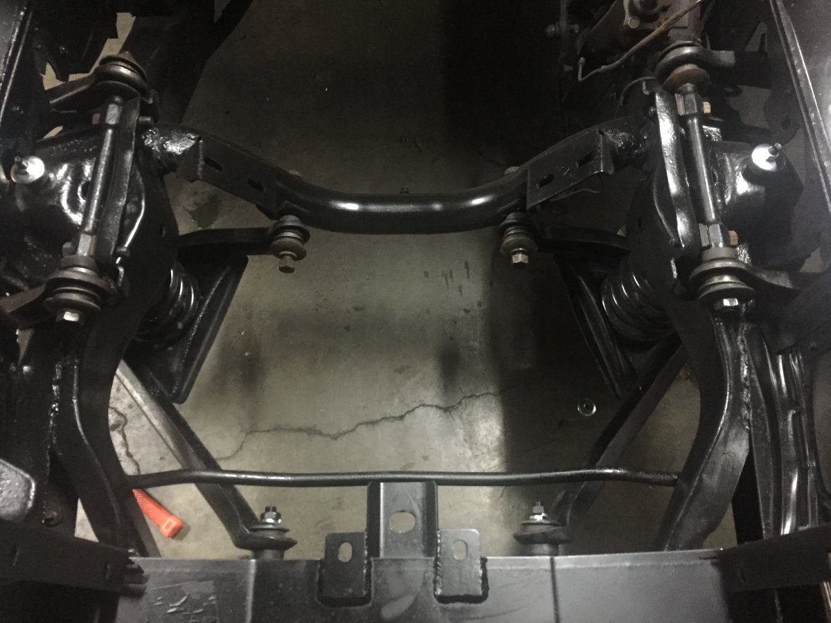

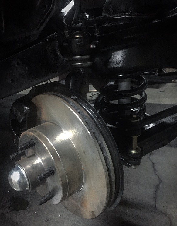

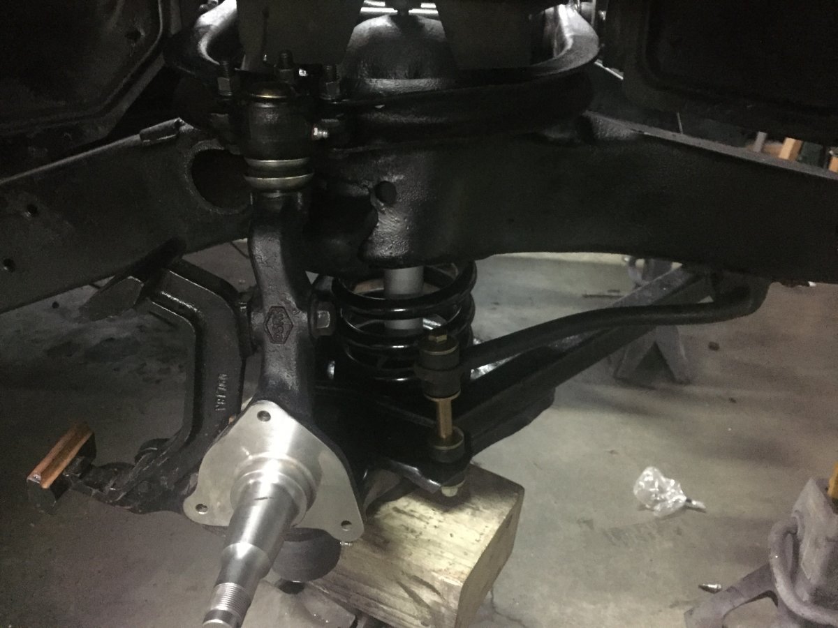

    Got the bushings in, major pain in the rump but there in. Suspension is going back together, control arms in, new shocks, swaybar bushings and endlinks, ball joints etc

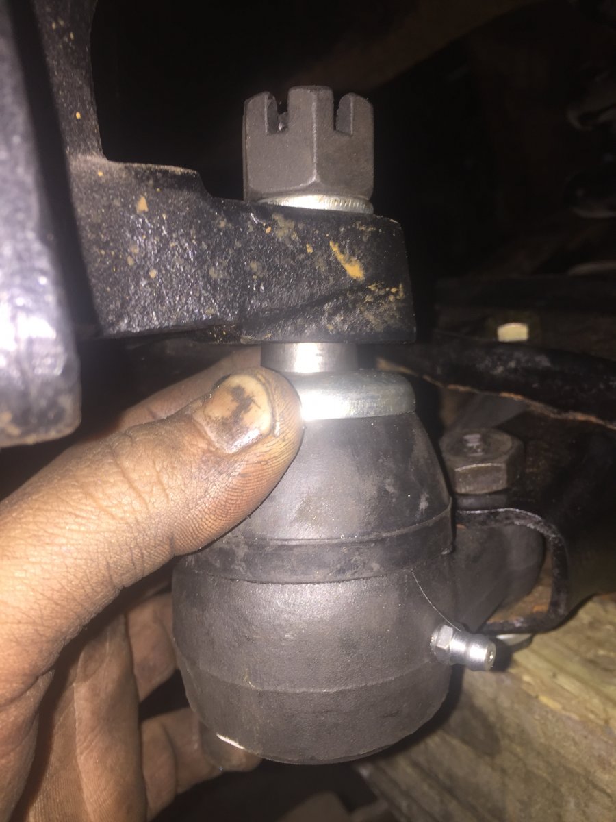

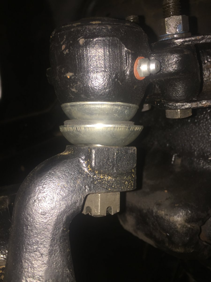

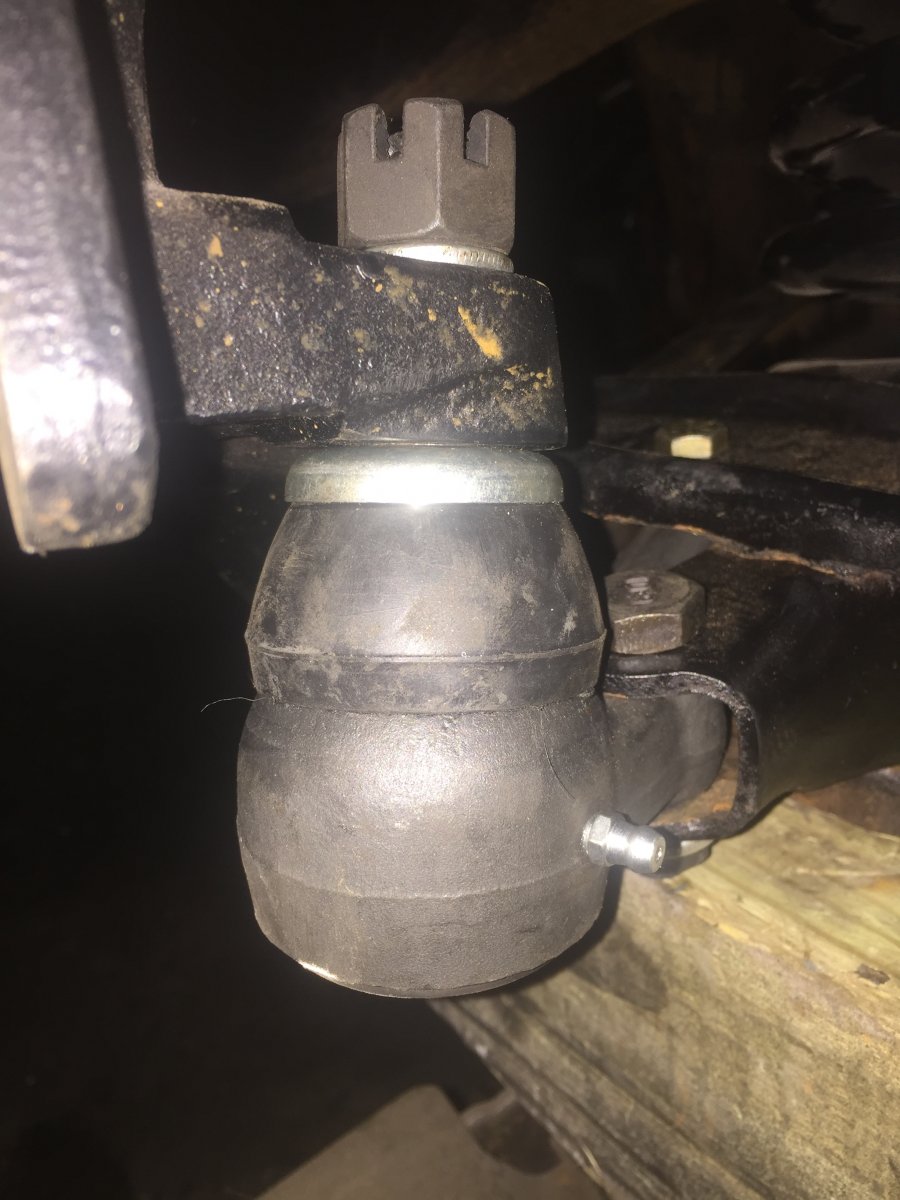

    Question about the ball joints. If anyone can help on this asap id appreciate it so i can ****on up this front end. Heres the seals and cups on the upper ball joint. Does this look correct?
    And heres the lower ball joint. The grease cup isnt really squished tho. I dont know if this is normal or not. Here is a pic of it
    But heres what seems strange. I can pull the grease boot down, its not really depressed by the spindle. Im not sure if itll be fine once the grease is in it but it seems a tad loose now
    Any opinions are appreciated

    It doesn't look like it's tightened up and the cotter key isn't installed yet.
  16. Shane Spencer
    Joined: Oct 3, 2009
    Posts: 2,160
    Shane Spencer
    Thats as far down on the lower ball joint shaft as the spindle will go. Also, the cotter pins fit in both the upper and lower castle nuts perfectly even tho there not installed yet

    I have a bad feeling if the castle nuts are tightened all the way and the boot doesn't squish any that ball joint may not be the right one? Sounds like the shaft is to long or there isn't enough threads to allow the nut to go down more?
  18. Shane Spencer
    Joined: Oct 3, 2009
    Posts: 2,160
    Shane Spencer
    The nut tightens down exactly to where it should and allows the cotter pin to slide in. I also compared it to the stock ball joint and it is the same thing. If anything i feel like i might be missing a metal dust shield or something because it looks like there was a thicker one that went on the lower ball joint to make up that room but it didnt come in the kit

    What about a spacer/sleeve? do you remember if the old one had something like that?

    I read the directions that came with the drop spindle/disc conversion and it stated that there was a spacer needed there with those spindles so i just used a couple grade 8 washers to space it out and keep some pressure on the grease boot. Hahah sometimes it pays to read directions. Anywho the whole disc conversion and drop spindles went on smoothly
    Gotta paint the drag link and install the new tie rods tomorrow and the front end will be pretty much ****oned up

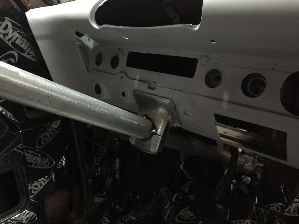

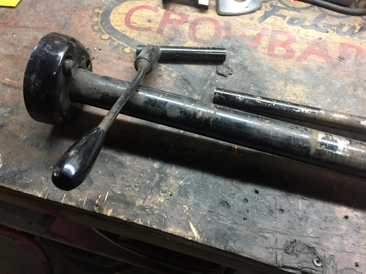

    Couple updates. Heres the column and column drop with the shifter tube shaved...
    I ended up welding the upper half of the column drop to the column. Gotta metal finish it and smooth it out

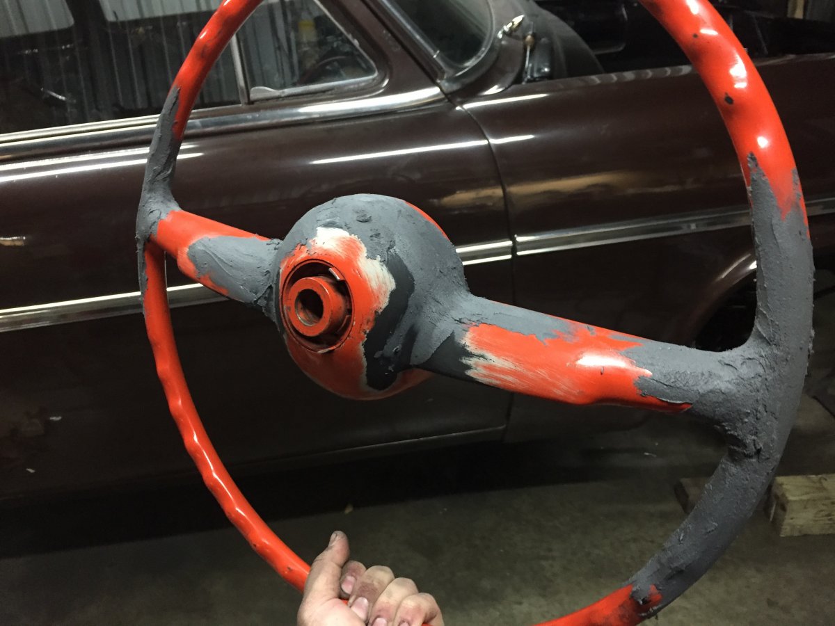

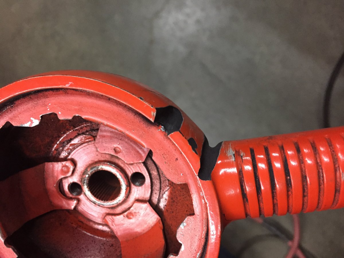

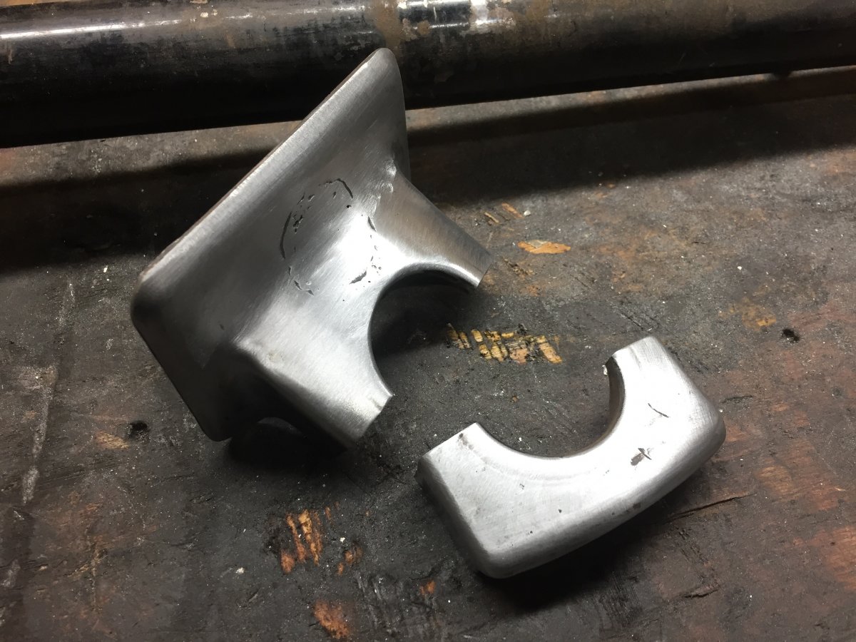

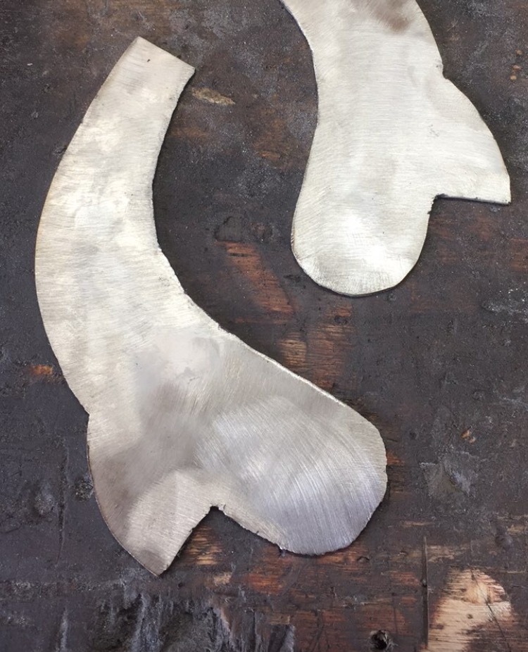

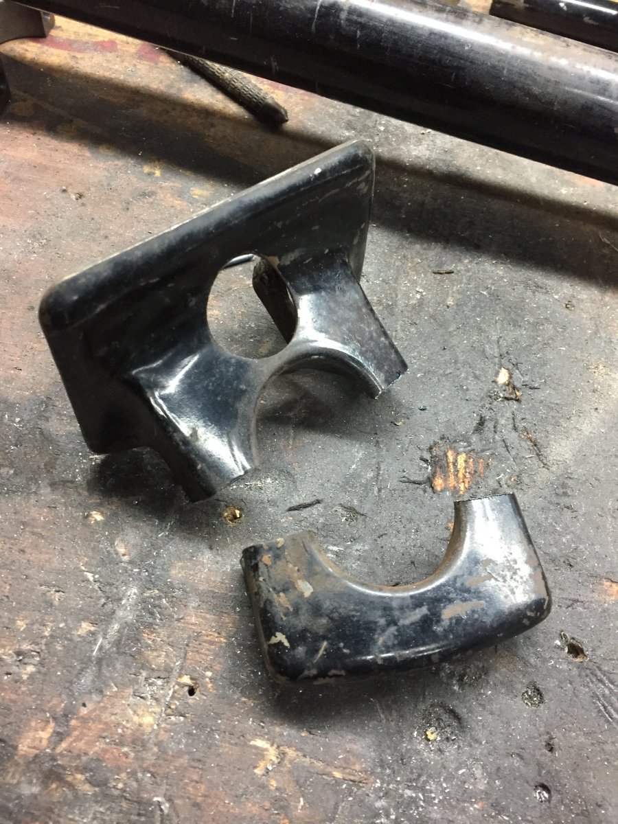

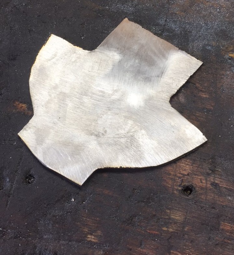

    Pulled the wheel, column and dash back out for paint. Heres a pic of the back of the spoke profile i had to slightly change to clear the cup on the column
    Ground out the cracks to fill with the eastwood kit....
    Pc-7 epoxy from eastwood
    Cracks filled with the epoxy

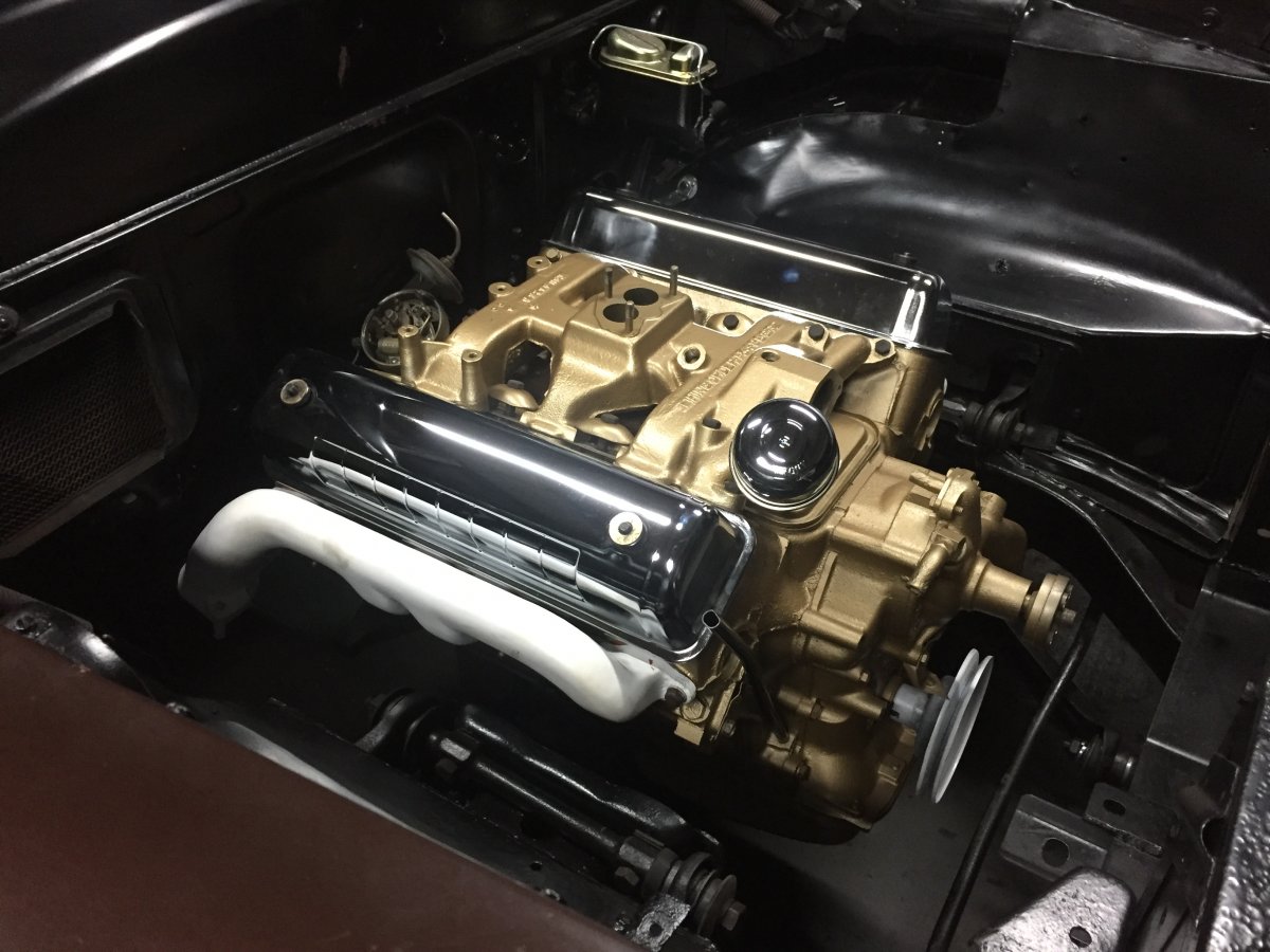

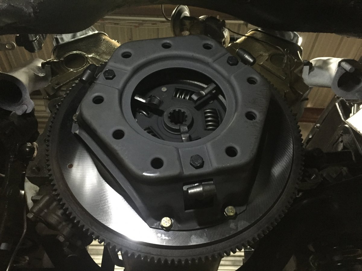

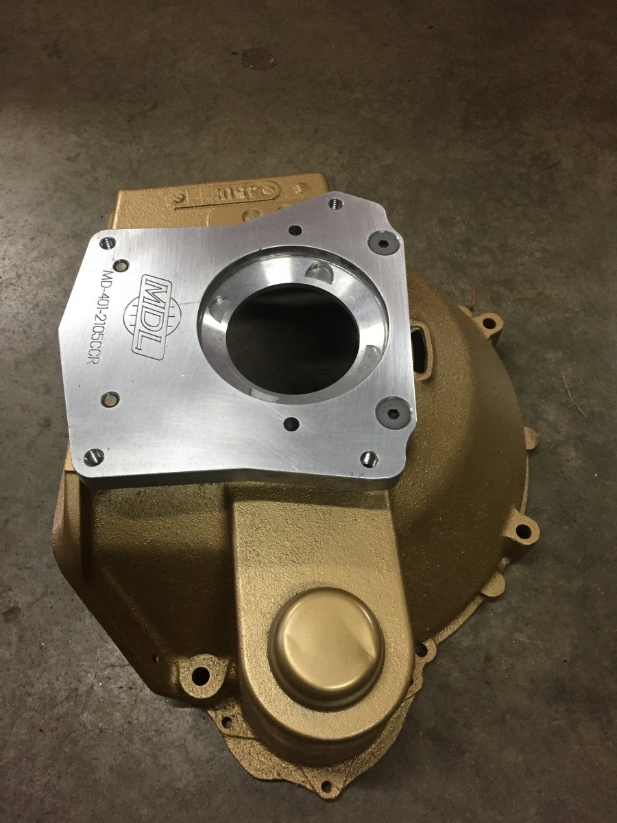

    Got the engine back in....

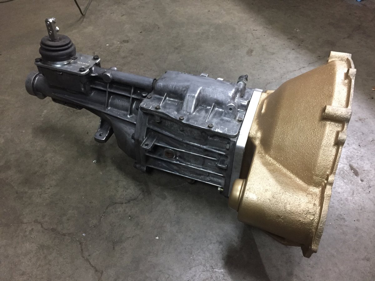

    Flywheel and clutch on
    Trans adapter and bellhousing ready
    Cleaned up the trans and got it all back together

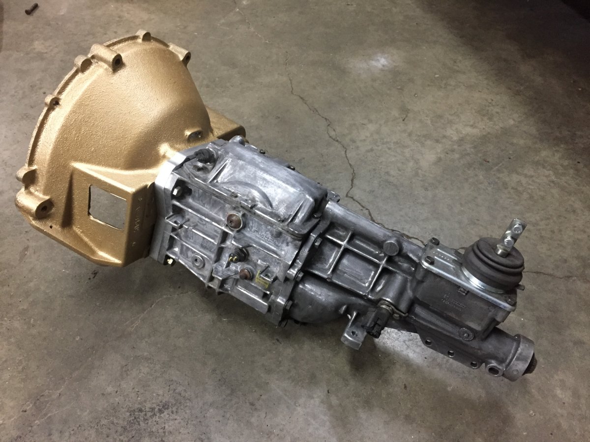

    Got the trans back in. The tailshaft seems really tight to turn when the trans and clutch and all is installed. Is this normal ?? It goes into every gear easy still. Opinions ?
  29. venturesomerite
    Joined: Jul 27, 2009
    Posts: 336
    venturesomerite
    from CT
    Looking really nice, keep it up
  30. voodookustoms
    Joined: Aug 25, 2009
    Posts: 650
    voodookustoms
    I think I remember mine being fairly tight to turn also.
