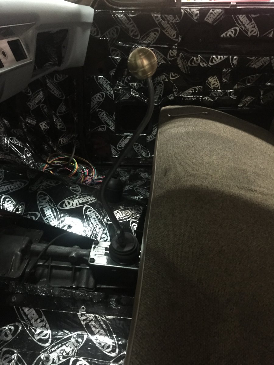

    Some pics of the block sanded and primed column drop that i molded to the column and the upper cup where the 3 speed tube was shaved
    Also bent a radius into the top of my shifter to give it a nice swan style. The stick came out of an old 2 ton or so 55-7 chevy truck. It has a cool taper to it. I bent up a small piece of roundstock as a template, taped it to the stick and bent that to match
    I also have a cool knob coming soon, ill post pics of that when it shows up

    Updates. I used a model a shifter boot as sort of an inner dust shield thatll be inside the shift boot i end up making later on. I ended up just epoxying it to my removable trans cover

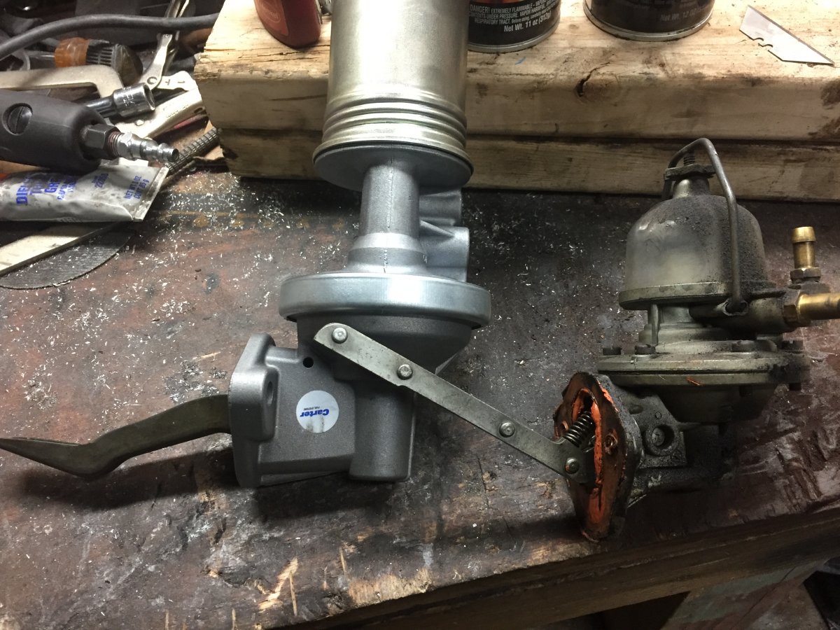

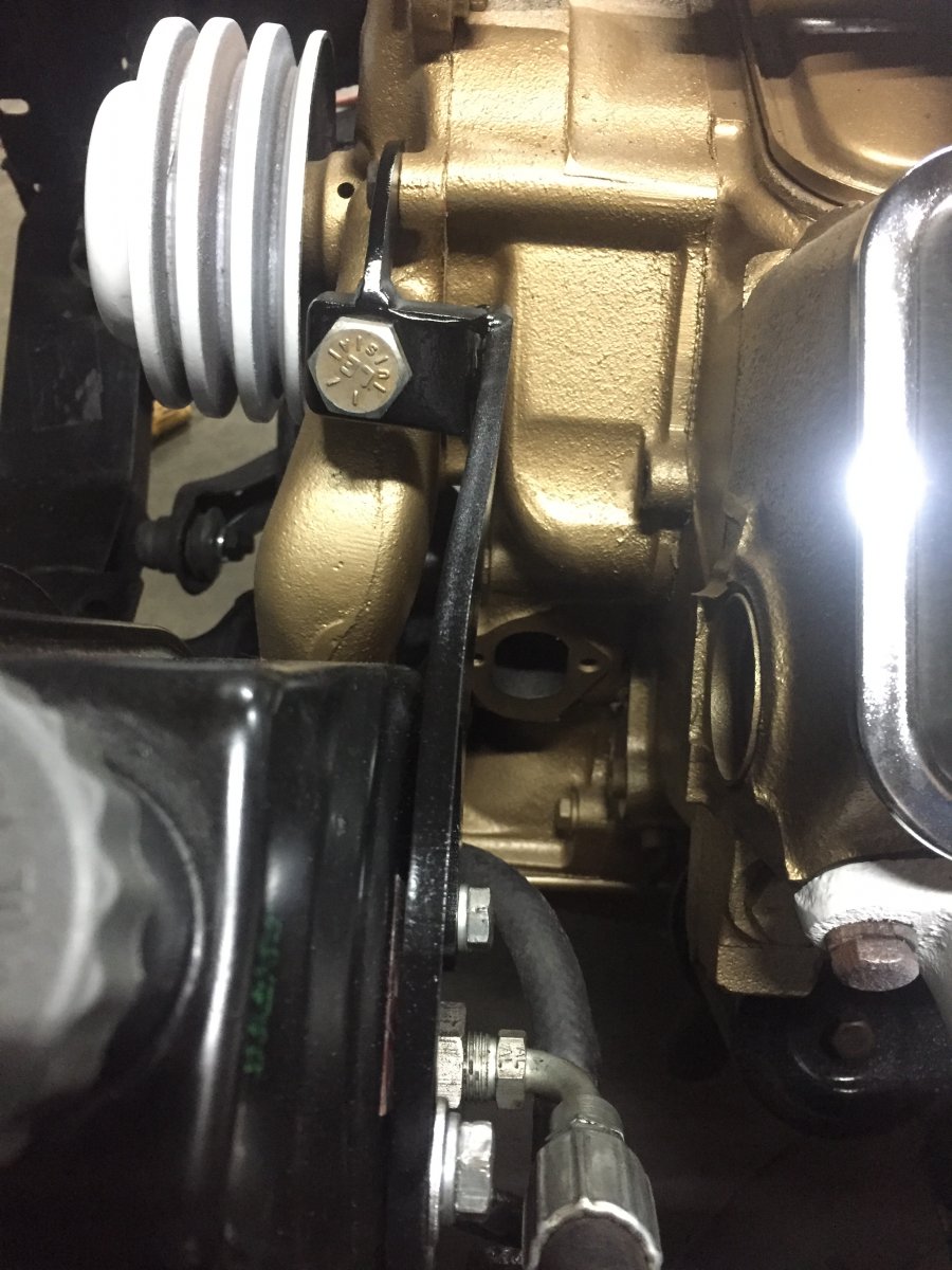

    Need some fuel pump help. Are 239's different fuel pumps than the bigger y's? You can see the difference in angle on the pump arm between the old and new one
    Also the huge canister wont work with my power steering bracket so i need to find another pump

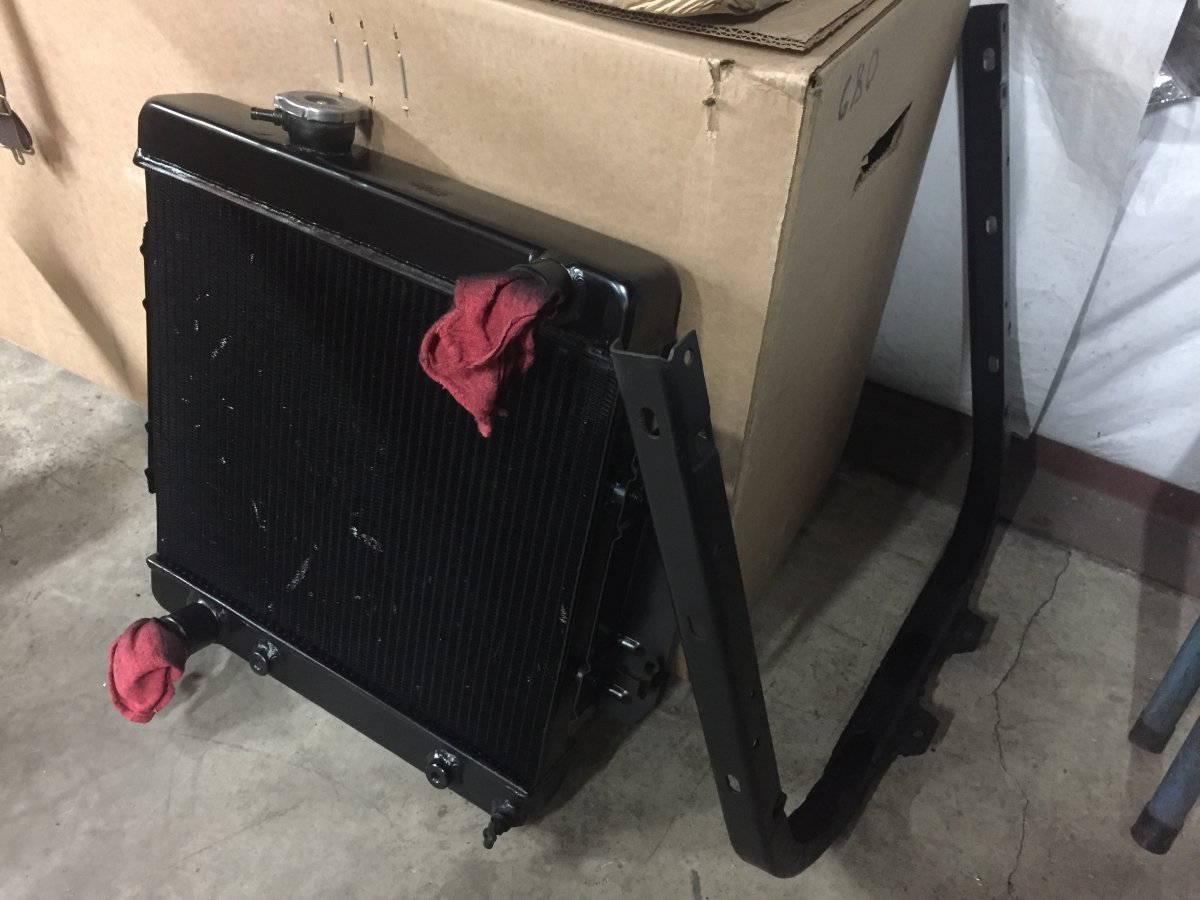

    Got the radiator and bracket thing painted as well

    the pump jeff posted is NOT what you need it does not have the bowl on bottom. ebay is not the best for listing proper parts.there are several listed on the bay right now if you look close you will see the one you need.make sure it is for v8 NOT 6 cylinder.if listed as rebuilt ask if it uses new parts with todays fuel old diaphrams and such will fail.there are places that sell modern kits.daytona carbs I believe is one I am sure there are more.the proper pump with the bowl also has a filter under bowl gl***.this feature is handy for catching debris from tank and old lines.try search for then and now automotive in your neck of woods also.to clarify what I meant by wrong is that pump does not have the bowl.also the line fittings may not be in right place this can be a pain to correct

    Ok so next question about the fuel pump. The original one i took off with the gl*** bowl, in the right of the pic, was mounted so the bowl was on top of the pump but all the pics i see have the gl*** bowl on the bottom. Any thoughts ?

    All I can say is that the fuel pump Jeff linked to on eBay is the same as the one on my 239!

    The gl*** bowl may be more "traditional" period correct but having owned two 239 Fords "back in the day" both developed leaks and they would vibrate loose,crank 'em down too tight and they can crack,not a good idea.

    the bowl was moved to the top in 55 also if you check the bolt holes for mounting.in 54 239 they used a 5/16 bolt then 55 up they used a 3/8 bolt.the 3/8 will bolt up but will never be right.some time in past someone probably used 55 up pump as 54 was one year only.
