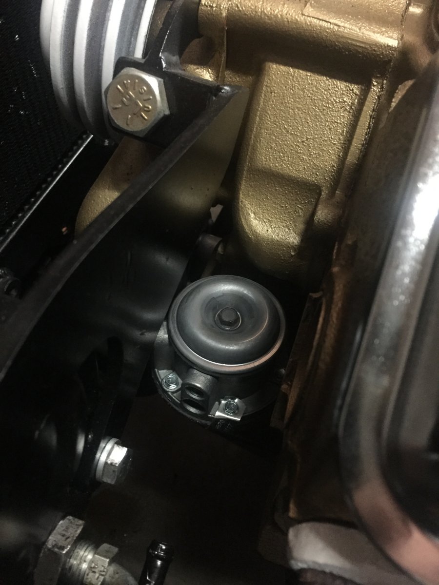

    Managed to get the gas tank back in, gas door has new rubber bumpers, carb rebuilt, new door handles on and rebuilding the vent windows with new rubber. The regulators in this car are a pain in the *** lol
    Heres a shot of sediment in the float bowl
    New fuel pump installed
    Bent up some niccop line to the carb

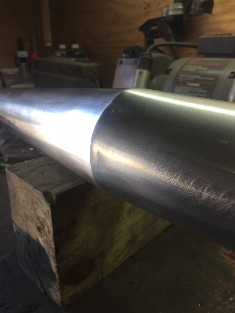

    Finish welded the grille today finally. Tig'd and metal finished and sanded to 220. Need to drop back to 120 to take out a few more small low spots then polish it up. Hand filed it to get the peak looking decent

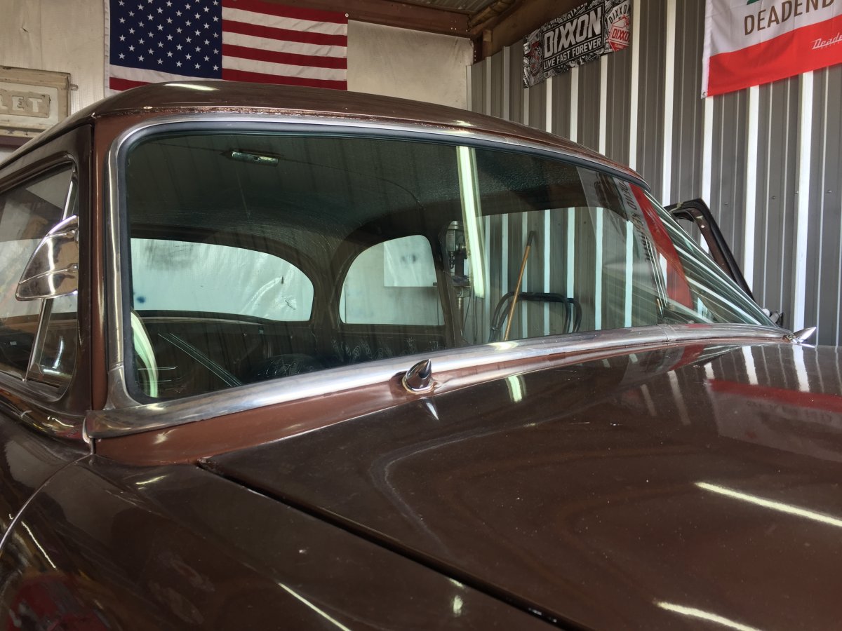

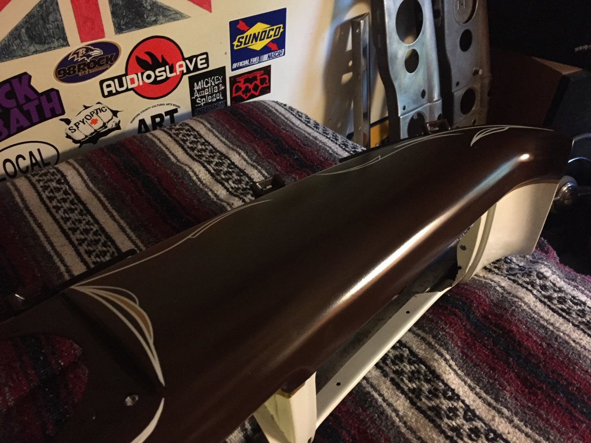

    Not a ton of progress with the holiday this weekend. Did manage to get the old windshield pulled and theres no rust in the windshield frame area which is good. Got a new seal and gl*** ready to go in. Also got the dash two tone finished up, satin brown top with the white bottom

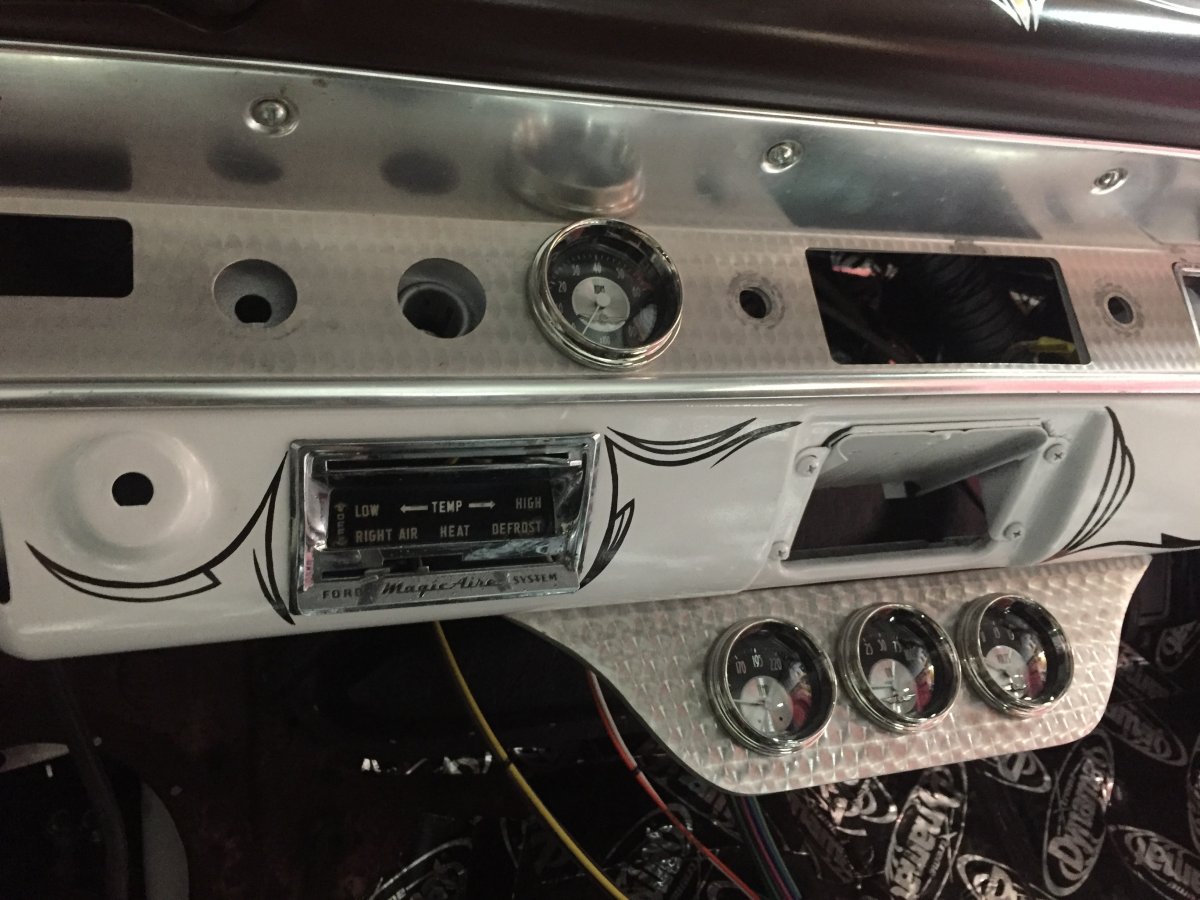

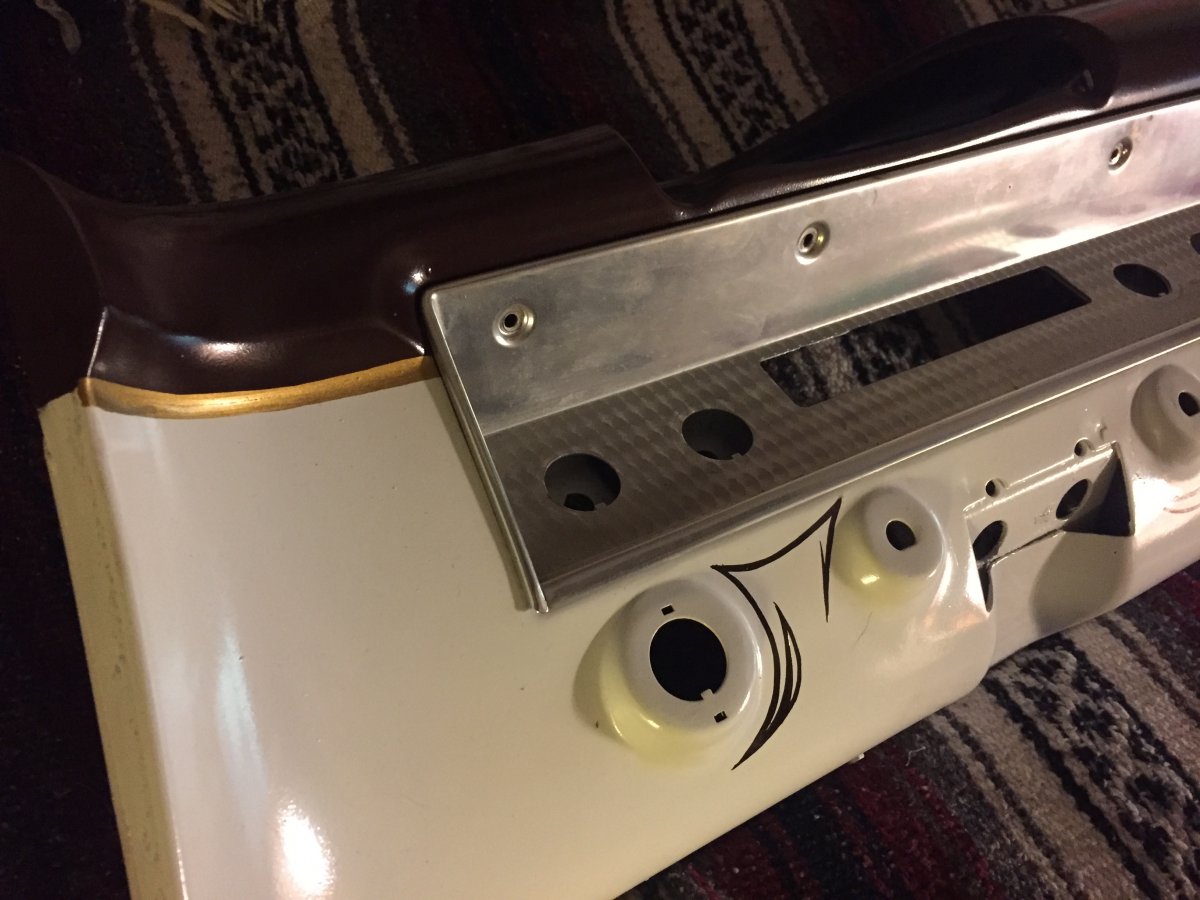

    Other updates, i pinstriped the dash, turned out decent. Some white and dark brown with just a touch of gold

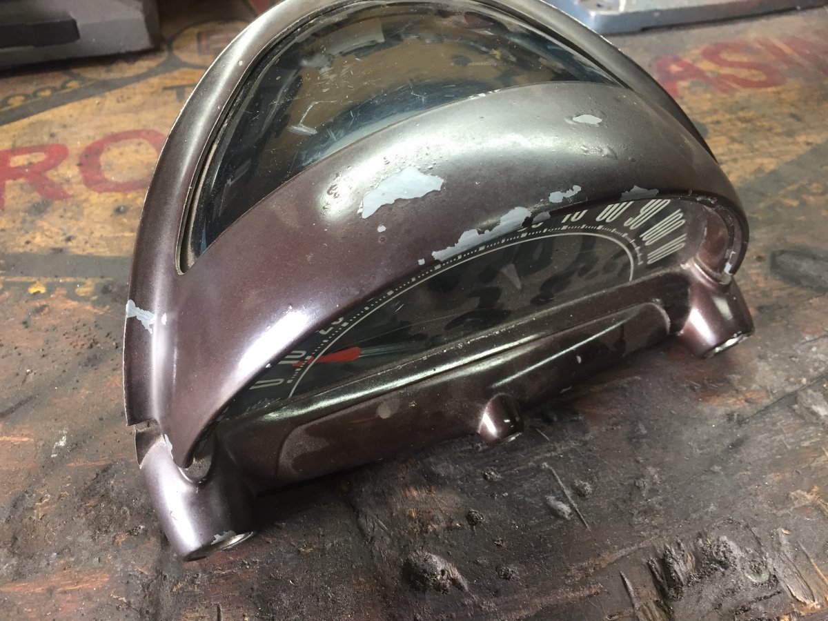

    Freshened up the speedo, satin black paint on the inner base, repainted the exterior and put a gold tip on the needle

    Also my paint was chipping and scratched all around the windshield and it looked like someone may have just sprayed paint over the gasket half ***ed, so after i pulled the old gl*** i sanded and feathered out all the scratches and chips and shot some paint just to prevent corrosion. The colors not perfect but im planning on getting a rattle can of colormatched paint from a local shop that has a paint reader/decoder, then ill just spray it later on. The paint on this car has seen way better days, but its a driver so whatever

    Painted the heater box
    Installed with a new plenum and defrost ducting. Also had to move my harness up from where it is in this shot
    Windshields in. Dont mind the color mismatch, thatll be fixed soon

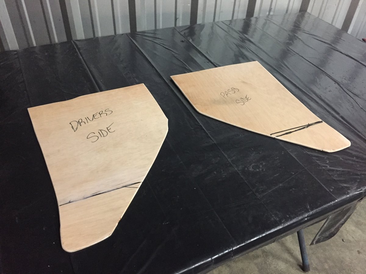

    Package tray panel cut
    And upholstered

    Dash in
    Got the magicaire controls working well and all the cables moving decently

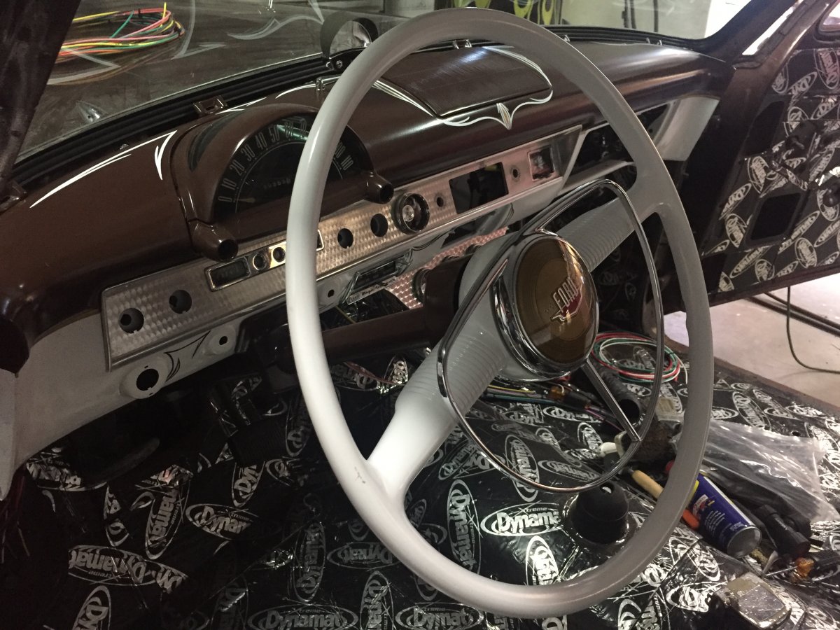

    Got the column in as well. The wheel needs to be touched up still but i wanted to get a few pics
    Molded column mount turned out sweet
