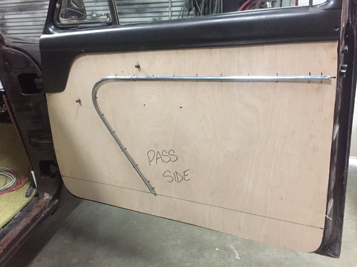

    Got the stainless mocked up on the door panels
    Lines up nice with the rear panels
    You can also see how the paint scheme on the dash will roll into the window garnishes once there painted

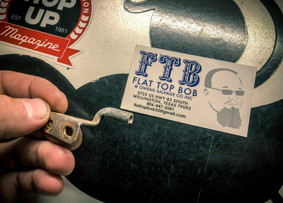

    Flat top bob from owens salvage got me hooked up with a vent window pivot so all my windows are now back together and working properly

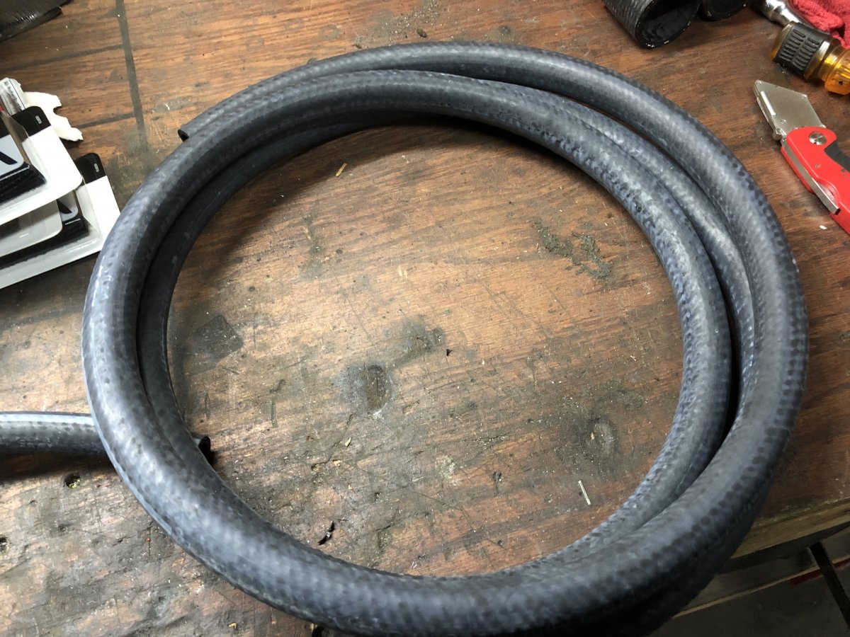

    Ended up running around today for hose clamps and fresh heater hose and a few other odds and ends

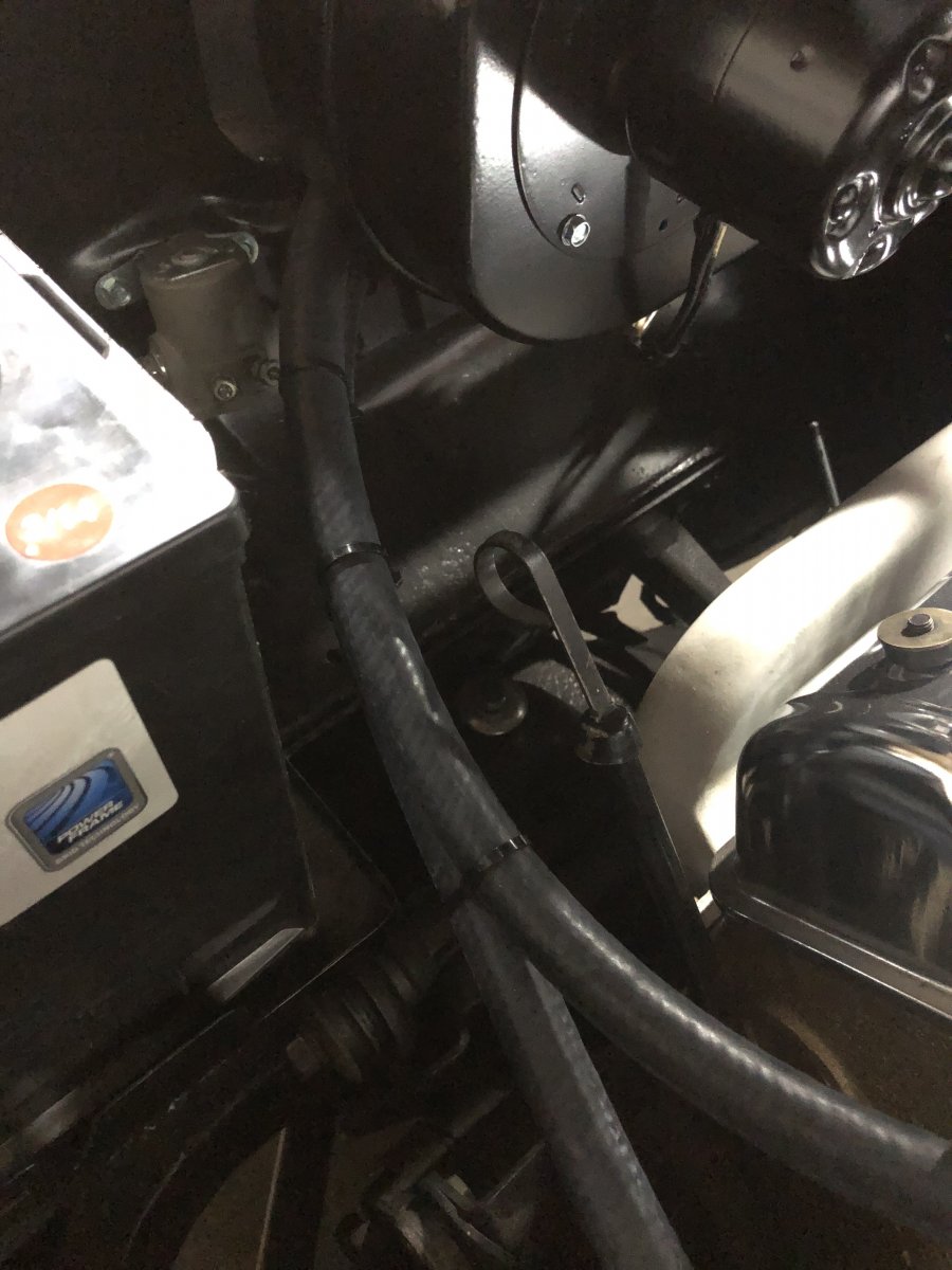

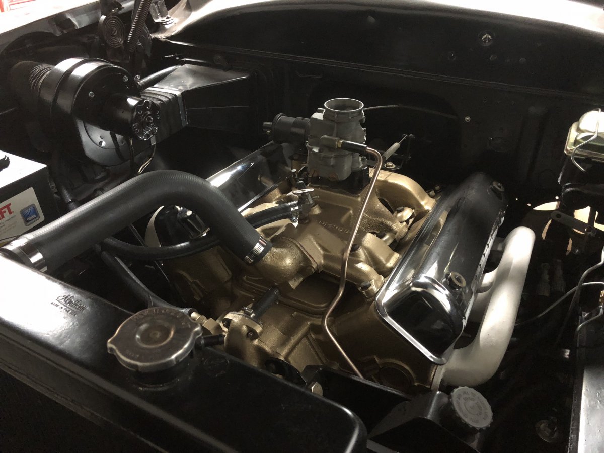

    Got the radiator hoses on for good, little crossover hose on, heater hoses cut and ran and used the “roadkill” zip tie wire seperator method. Actually works great haha. Im also trying to orient my hose clamps to keep the screw end hidden
    6C5493E1-F563-489C-A971-B9CFBE6E739C.jpeg 5204A678-55B5-45DE-803E-8EC6A14F39EA.jpeg

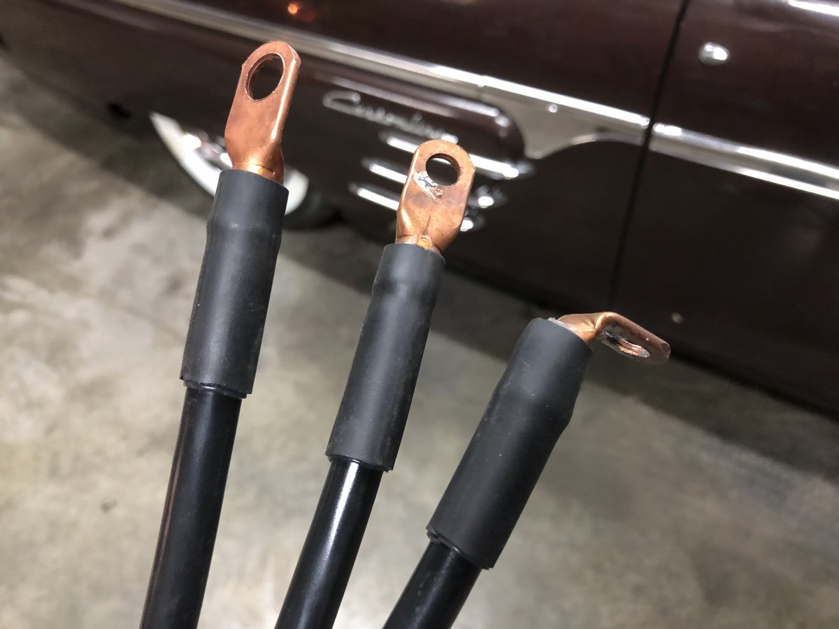

    Whipped up some battery cables with parts from del city. Highly recommend them. Great stuff and incredibly simple to use. Tried to keep these pretty tidy looking
    A0267084-10EA-4D34-A4FB-383939AA4FC8.jpeg A28158AF-FA72-4327-85AB-9416EA96DB3E.jpeg 4C84C641-F79F-4AF9-AE31-C1CE765FE685.jpeg
    Pretty happy with the engine bay so far. Trying to keep it as clean as possible

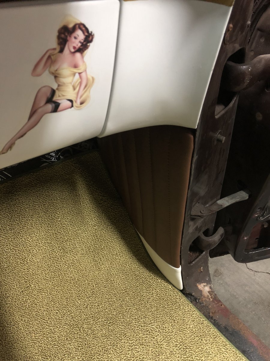

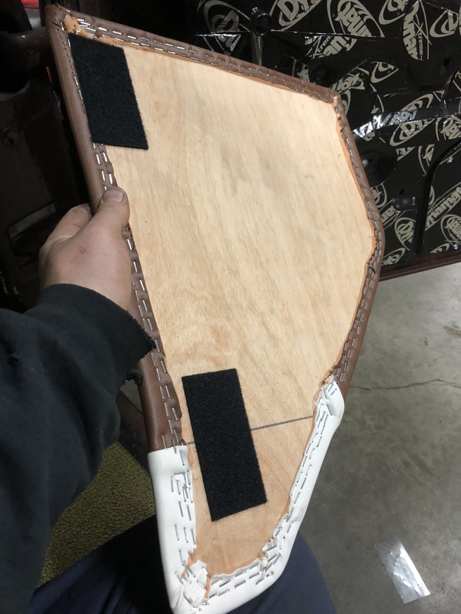

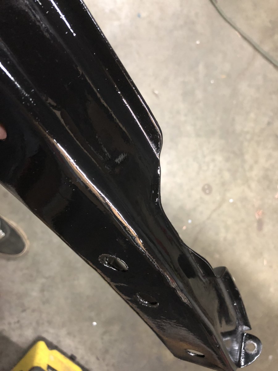

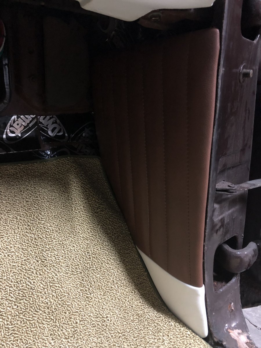

    So the kick panels fit pretty damn well but i needed a way to make sure they stay put, the inner structure behind them is fairly strange shaped and not easy to mount anything to and i didnt wanna modify the panels. Heres how they look just sitting in place
    They dont go anywhere but i wanted some extra insurance to make sure. Snagged some industrial velcro and gave it a shot. Actually works great and is incredibly strong.

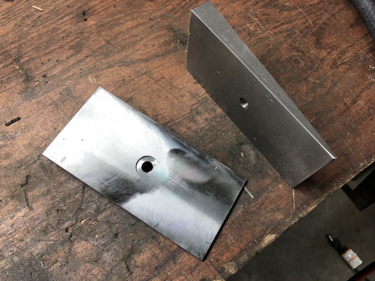

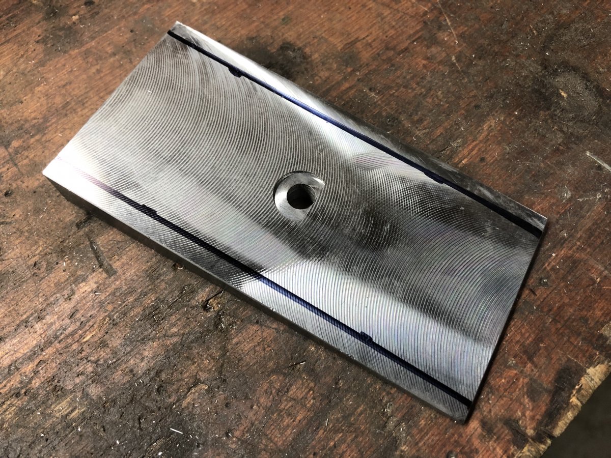

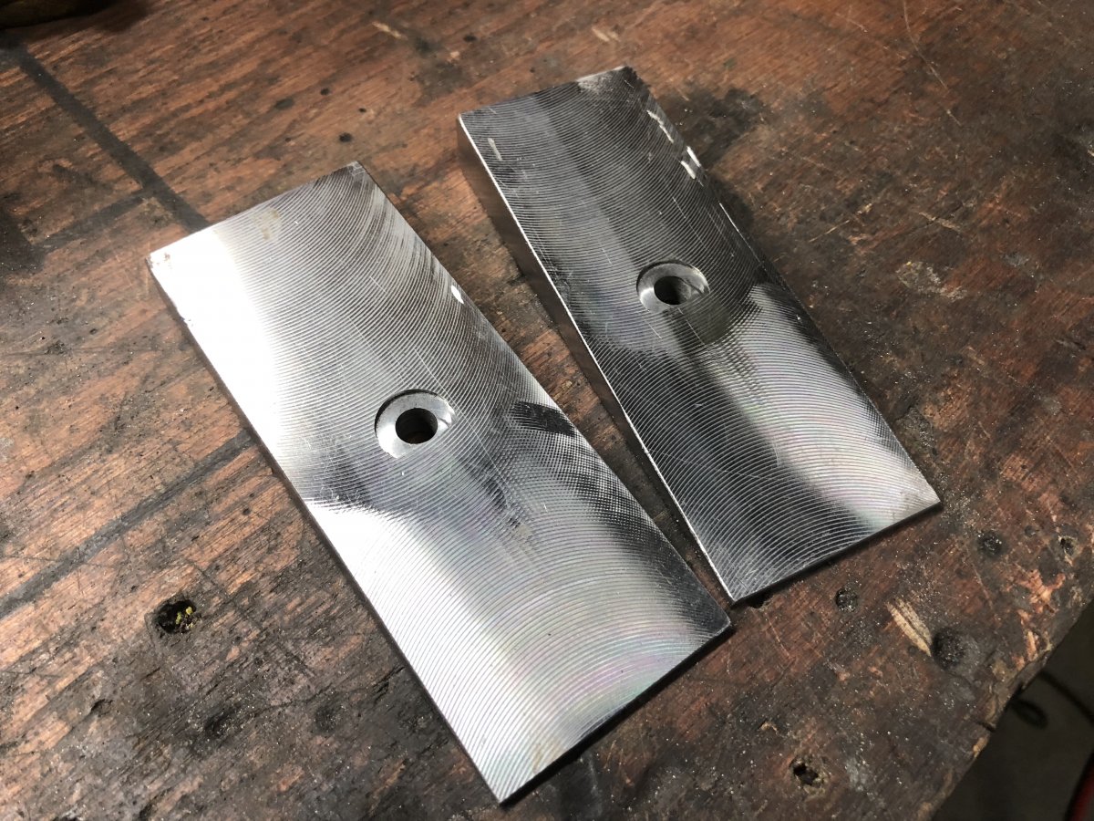

    Put two pieces along the back edge to make sure the panels stay where they should. Works incredibly well. Pinion shims also showed up. Couldnt find any 2” wide shims for old narrow leaf springs so i got some 2.5” wide steel ones from rubicon express. I know too many people that have cracked aluminum ones so i didnt want to try those, these are 6 degree shims by the way
    Obviously there too wide so i cut them down to 2”

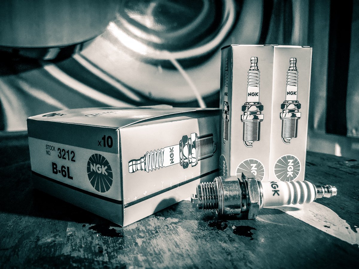

    Worked like a charm. I also ordered a set of plugs finally. Need a few other small parts, need to set the points gap, i also need a set of scuff plates for the door sills. If you have a set you can spare, give me a holler id greatly appreciate it. Then i need to bang out the wiring and she’ll be almost ready. Anyone rewire a 54 with a rebel wire harness ? Any tips or any other things ill need before i get started?

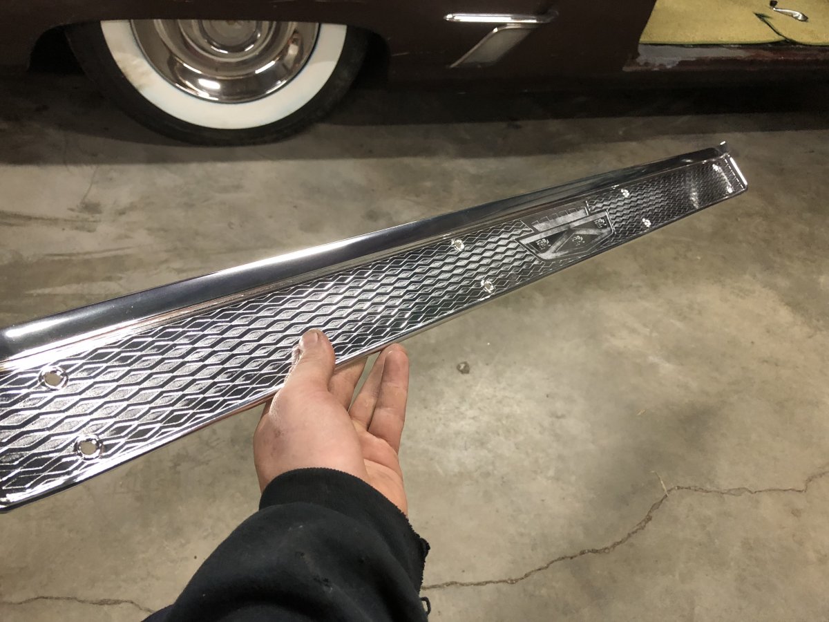

    Scored some scuff plates on Ebay
    Got some fresh plugs, gapped them, set the points gap and threw on the new cap as well

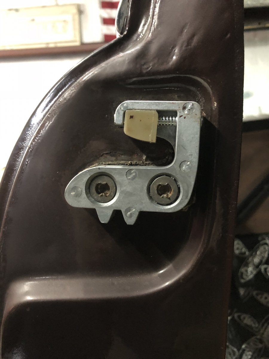

    Got a new door striker in since the teeth were busted up on my old one

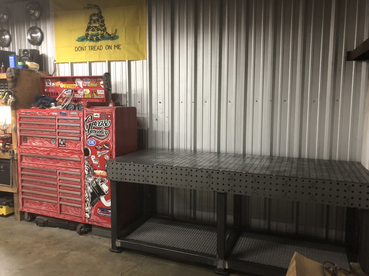

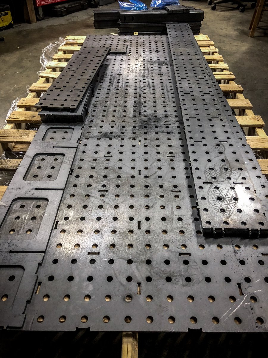

    Also got a welding table for the shop which took up last weekends progress on the car. 3x8’ 1/4 plate with 5/8” holes on 2” center. Awesome little kit from a company called weldtables
