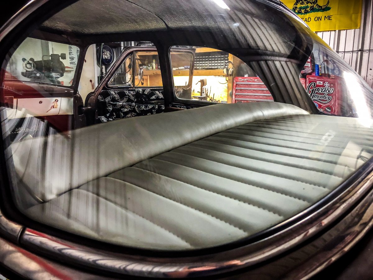

    Had a funeral for a close family friend on saturday so i didnt get anything done untill sunday. Flipped the calipers side to side and the pedal seems to build pressure now which is awesome. Still didnt get a chance to fully bleed them since my buddy that usually helps me was busy but they seem to be fine now
    I got the hooks and tie down bracket for the battery ****oned up and stainless acorn nuts on. Also got my battery cables that i made on and routed cleanly
    Since i raised the driveshaft tunnel the rear seat needed the hump opened up to sit flush. As you can see theres a 2 inch gap at the bottom of the seat
    Bent up a roundstock piece to open up the tunnel on the seat frame
    Sits nice and flush. I had to modify the rear of the seat as well in a similar way. I am going to weld in another piece of stock in a similar shape on the inside to use as an anchor for the hog rings
    Rear seat is pretty much ready to cover, then i can get the rear side panels in and the rear seat in for good.

    My welding table turned into an upholstery table today....
    And the rear seat bottom in as well
    Got a small wrinkle in the middle of the bottom that im not sure will come out, the cover was folded kinda ****ty in the package
    Also the package tray is in for good
