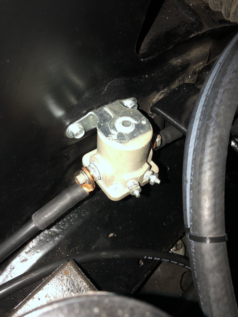

    So heres my starter relay...
    So ill have + battery going to the left big post with harness power and headlight relay, right big post to the starter, left small post will be the ignition wire. What im confused about is the right small post. Does this run to the alternator ? From the pics i took of the old 12v conversion the previous owner did, looks like this wire went to the alternator, but i have a white alt exciter wire coming off of the harness? Where does the exciter wire go? Am i right in thinking the right post goes to the alt ? Heres a pic of the way it was wired before

  14. If it's an actual Ford-design solenoid, the two small terminals are 'start' and 'ignition' (identified with a S and I if marked); the S terminal (on the left as looking at it) connects to the start terminal at the ignition switch. The I terminal becomes energized when the solenoid operates and if used, supplies power to the ignition ballast resistor. If you don't have a ballast resistor, nothing should connect there.

    Im 99 percent sure i have the starter relay figured. The small right terminal ran to the small post on the starter. I found an old pic and also referenced the starter installation instructions. Also in the bottom pic of the relay before i tore it all apart, the small wire coming off of the large left post running down was run to the alternator
  16. While that diagram will work, you could eliminate the small wire from the Ford solenoid to the starter by just using a short jumper or metal link from the B terminal to the S terminal at the starter. I don't know what the other wire with the diode is doing, that shouldn't be needed.
    54vicky likes this.

    Steve, the manufacturer of that starter said to never use a jumper wire on the starter. They said its a permanent magnet motor so it would cause feedback and damage the starter, not sure how true that holds but it worked when i had it wired like the diagram above. Also that little wire with the diode wasnt in there before i tore the car apart. No idea what that is
  18. Whether or not it's a permanent-magnet motor shouldn't make the slightest bit of difference, so I don't understand what 'feedback' they're talking about. Either way is electrically identical...

    I have the starter from DB electrical here is the diagram. Since the "I" terminal provides power with the key switch turned on I use it to power the HEI and electric choke.

    The "I" terminal on the solenoid supplies 12 volt power to the the coil (in my case since I have a 302 with an HEI that is IGN power) when you turn the key switch on and off using a test light you will know for sure. Looks like the relay kit has two grounds, two relays and one plug that goes into only one old headlight socket which gets it's power from the dimmer switch. This is a Ford switch diagram compare it to the GM and maybe you'll "see the light" (pun) 1firewall.JPG
