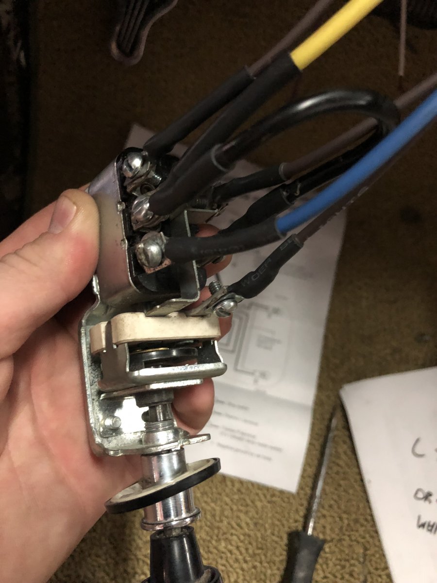

    I still have the receipt in my emails. Im thinking its not the headlight switch though, why would the head and tail terminal be dead on both ? Makes no sense to me

    When i take my tail light wire that goes to the switch, and run 12v to it all my tail lights work. Same with the dimmer power wire, when i run 12v to that my headlights are working fine now. Ive tested the headlights and taillights using the wires at the switch and everything works perfect, but the headlight and tail light terminal on the switch are dead. All the grounds and pigtails are working fine

    Yea, i have the power at the switch, the brake terminal, park light terminal and dash lights/rheostat all work perfect. To test the headlights and tail lights, ive been putting there wires to the terminals that i know are working (brake, park light, and dash light) and all my tail lights, and headlights work fine. But the designated headlight and tail light terminals on the switch dont give me anything. The new switch i just got did the same exact thing which makes me think maybe theres something im missing. Whats the chances two switches have the same two dead terminals? And the first switch that was originally in the car used to work fine. I must be missing something

    Headlights have a ground at the back of the bulb, relay is also grounded. Someone else previously said the switch shouldnt have to be grounded, and my park lights work fine. Not sure

    1firewall.JPG With the Rebel harness all the wires are marked as to placement,are there any left over ? And just for an experiment try using this diagram since you are running that aftermarket turn signal switch.

    THE WIRING ISSUE IS SOLVED!
    Talked to a tech at Rebel, and he found a spare diagram that was hand drawn in there files, apparently for our cars. Wired it up and everything works well. Heres how its layed out....
    Left side back to front is - Park, Power, Dimmer
    Right side back to front is - Taillights, Jumper wire from power terminal, Dash lights

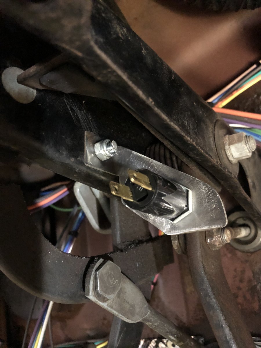

    I whipped up a bracket for my brake light switch
