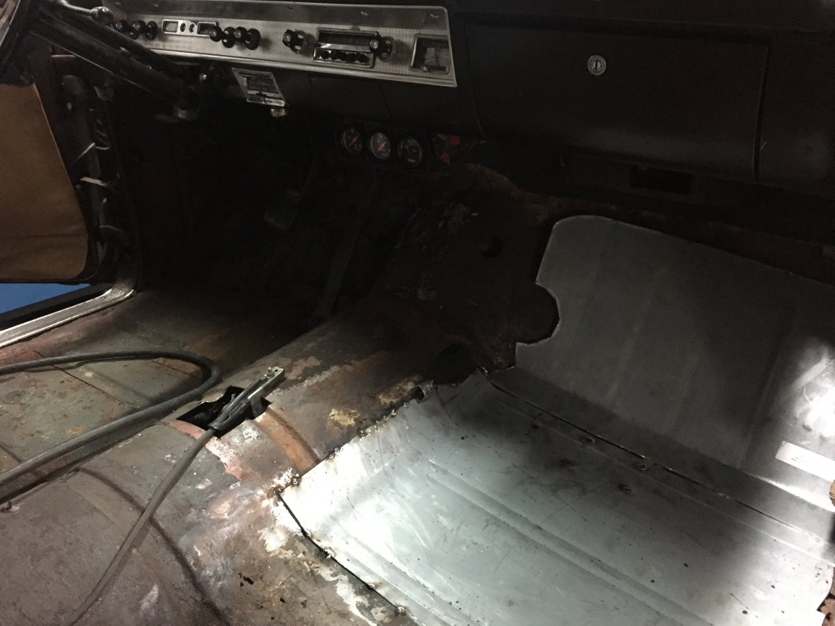

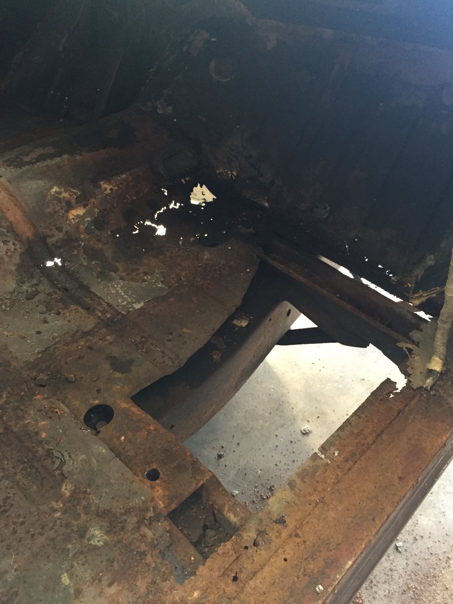

    Started by tearing out the seat today. Does anyone know how the rear seat comes out ?
    Tore the seatbelts and carpet out. Rear pans are better than i thought despite the surface rust in the pics. Front pans are toast as i expected. I could see carpet from under the car hahah

    Awesome thanks man. Anyone have any experience on where to buy floor pans? I see pans on ebay that are cheaper. Carpenter pans are about $80 a side for the fronts. I need the toe board too. Any recomendations ?

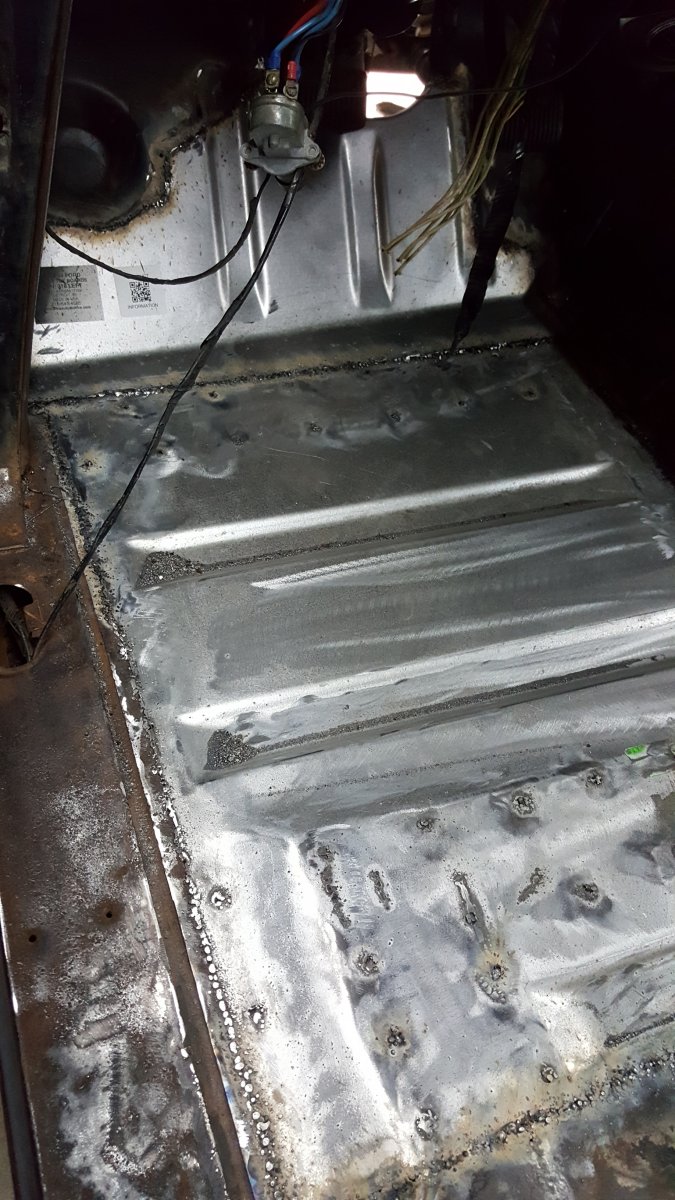

    Ordered up the patches from ebay. It looked like neither these or the dennis carpenter patches matched the floor ribs so i just went with these. Cheaper and still made in USA. If your looking for factory resto stuff these probably arent for you since they dont match the original ribs but there good thickness and rock solid. Got the p*** floor tacked in and toeboard trimmed up but not tacked yet. You can really see how bad the original floor was here

    More progress. Front pans are finish welded and seam sealed. Bolted the t-5 up. Need to modify the k member some and get the mount finished up
