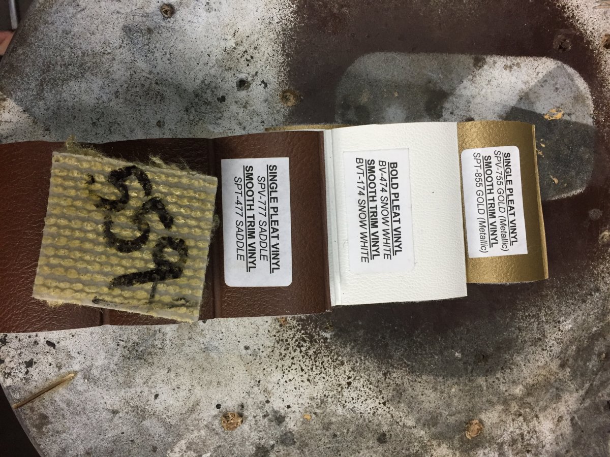

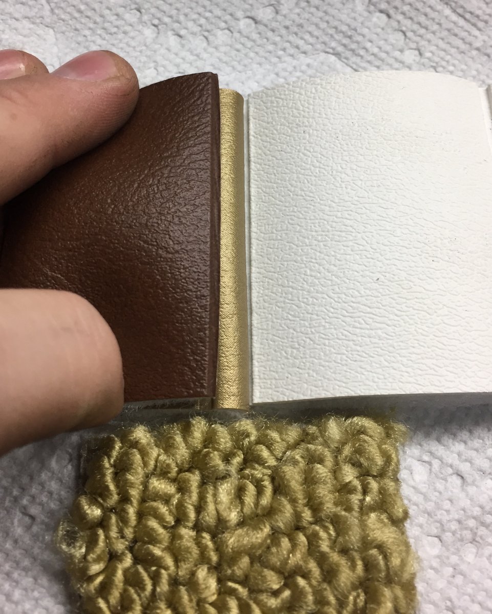

    Like the others, I agree that the gold should be used as piping. The gold vinyl and gold carpet are just enough of a mismatch that they clash when you have large surfaces of gold vinyl. When the gold is simply used as piping, there's so little of it that the mismatch won't be at all obvious.
    By the way, I particularly appreciate your interior colors because they are the school colors for my alma mater: the University of Wyoming. Should you ever find yourself driving through Laramie on gameday, you'll have the most popular car in town!

    I agree ted on the colors. The gold is slightly off. The brown pleats should look good and be easier to keep clean as well which is great for a daily. Thats cool that wyoming uses those colors. Not a very common combo for a school

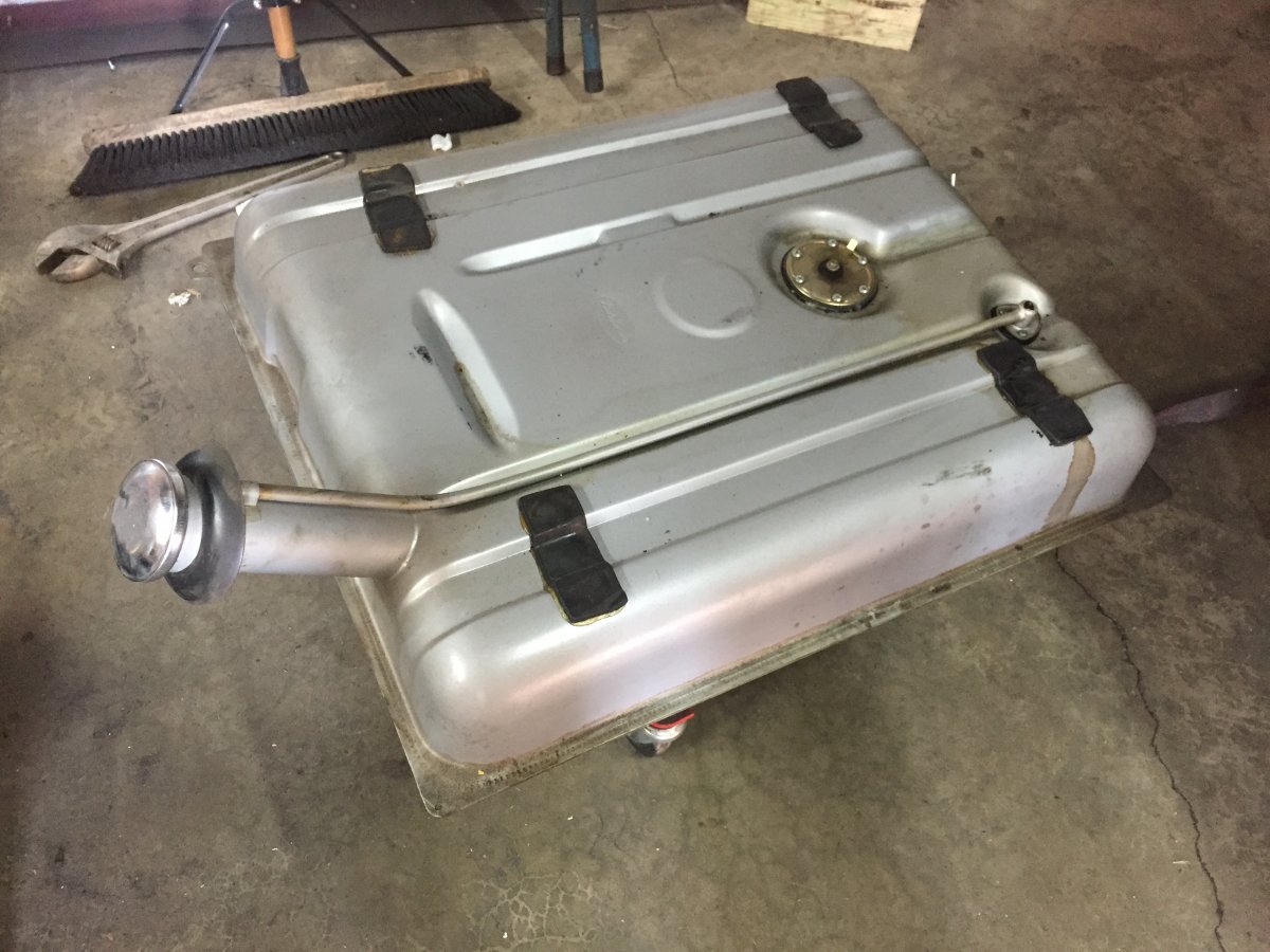

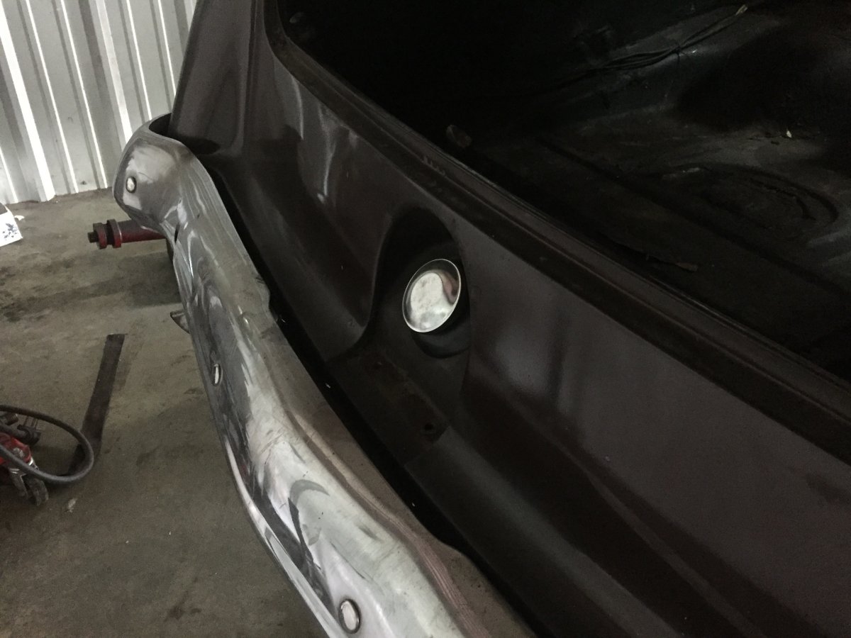

    I removed the license plate bracket to figure out a new latch for it. I like that the gas filler is hidden but ive always HATED the spring operated bracket that holds the plate. Its a major PITA when trying to fuel up, i removed the spring and need to figure out some type of magnet or latch system so the plate will swing freely down out of the way when im fueling
    Dropped the tank, this is one of few things that i had replaced on the car when i had it 7 years ago and its still in great shape

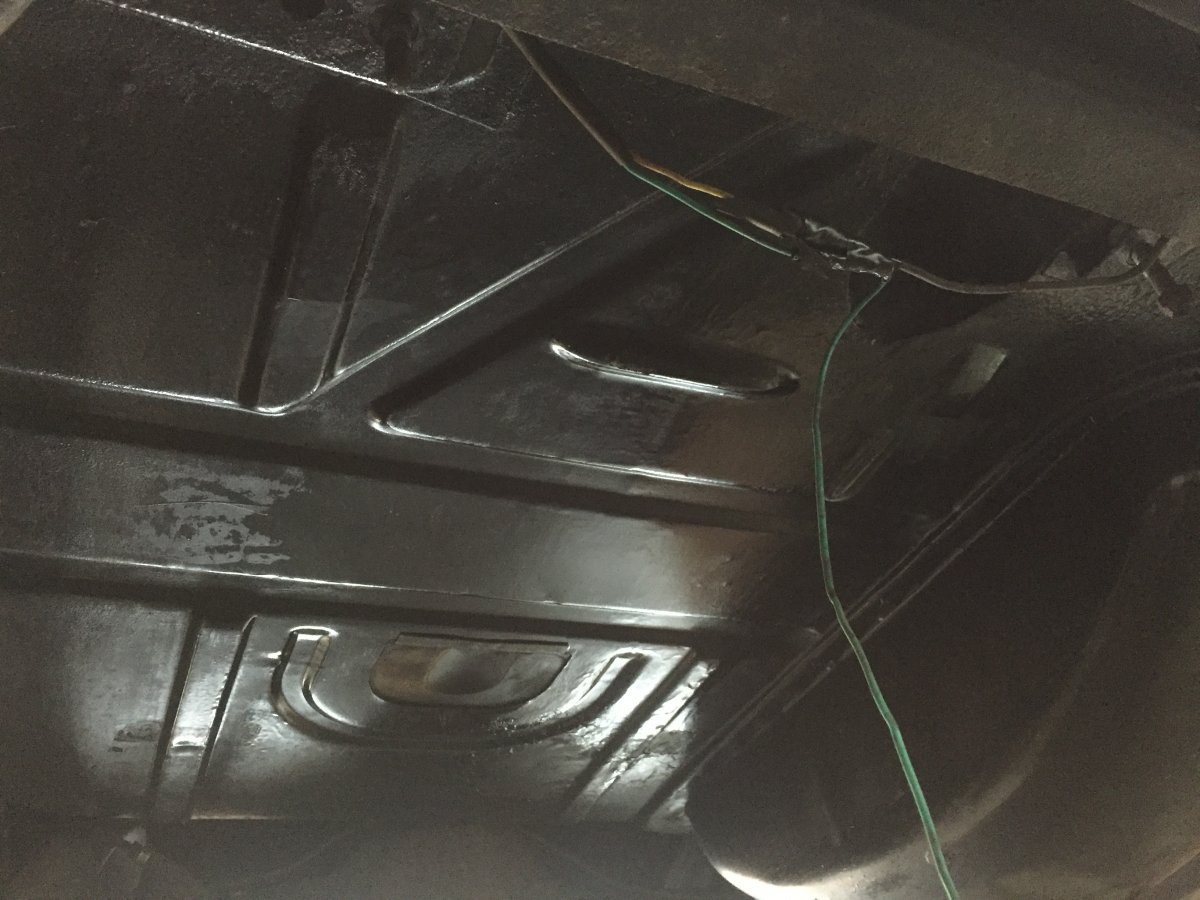

    I painted the underside of the trunk above the tank years ago too and that was still in good shape as well

    Shave it and move the filler neck in the trunk..

    Also i relocated gas fill into trunk and frenched plate where original gas fill was
