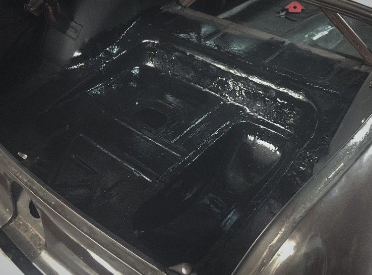

    Got the rest of the trunk floor welded up. Heres a pic of it after i tacked it in. Looks close to factory
    Brushed on a quick coat of rustoleum, gonna seam seal over the welds next and then paint everything before i lay the dynamat down

    Floor is pretty well finished. Seam sealed the driveshaft tunnel and raised trunk floor. Got ****onhead bolts holding the trans cover down. Gotta do a little more welding work up front around the firewall/trans tunnel area after i drop the trans. Then paint and dynamat.

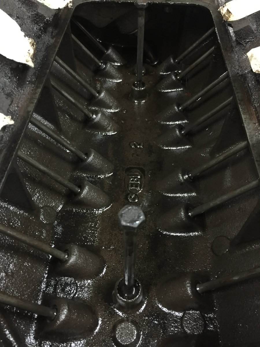

    Got the engine and trans yanked. Tore the engine down pretty well, everything looked clean. Only concern i had was that the rocker overflow tubes were rubbing the valve springs just slightly. Other than that all looked great. I have a thread going on about tearing into a y block so hopefully i find out what to do with the overflow tubes
    Heres some pics
    Heres the overflow tubes. You can see the one has a perch its resting on and the other doesnt but both were rubbing the spring slightly
    Im planning to pull the heads and check everything out as well. Im ***uming the rocker ***emblies come off as a whole piece and then just pull the heads, but ill do more research on that. Also read the end head bolts are 3 threads longer and to watch out for that. Good progress for now though

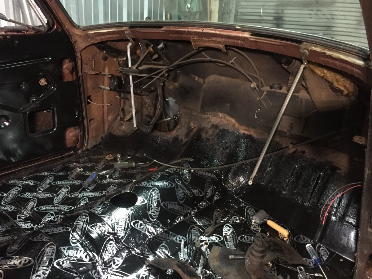

    Threw down a quick coat of paint on the floor, wheel wells, tunnel and inner doors before work. Also got the inner door access panels i made dynamatted

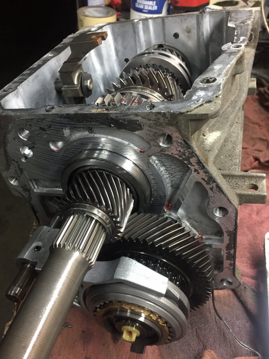

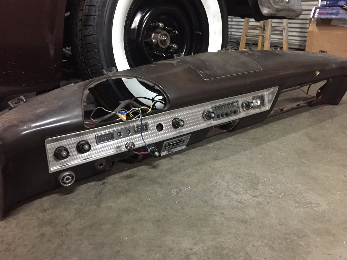

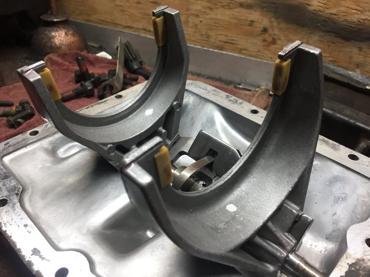

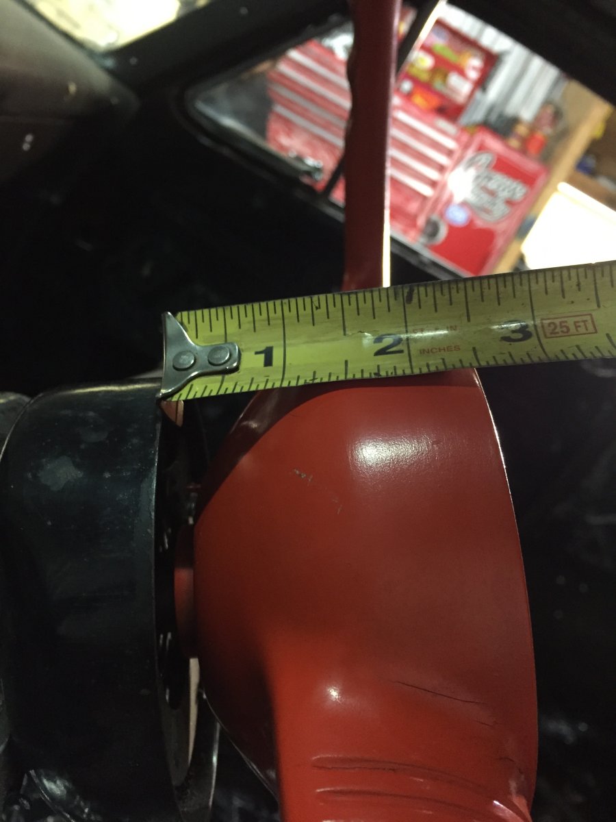

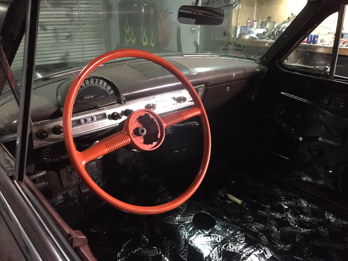

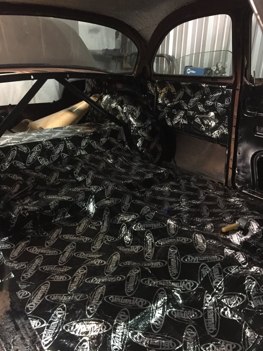

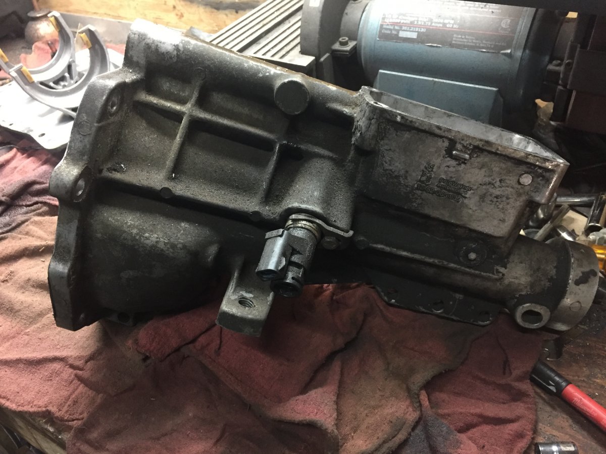

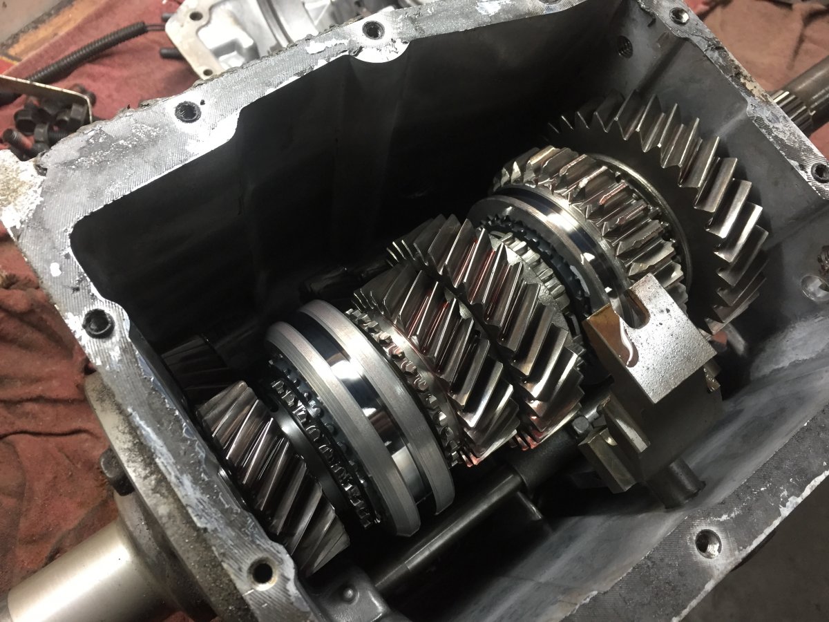

    Tore into the T-5 to check out all the internals. Looked surprisingly clean in there....

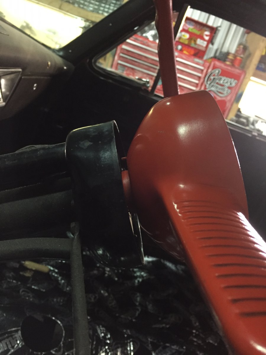

    Got the shoebox steering wheel on the shaft. Bolts up just fine but theres a gap between the back of the wheel and the column so ill have to do some work to fill that
    Got the majority of the car dynamatted. Still need to do the doors and toeboard area
    Got the dash and column pulled out as well

    JeffB2
    from Phoenix,AZ
    Makes it a lot easier to rewire with it out,some guys suggest painting the inside white as it makes it easier to see under the dash. I changed all my bulbs in my '54 to LED's.

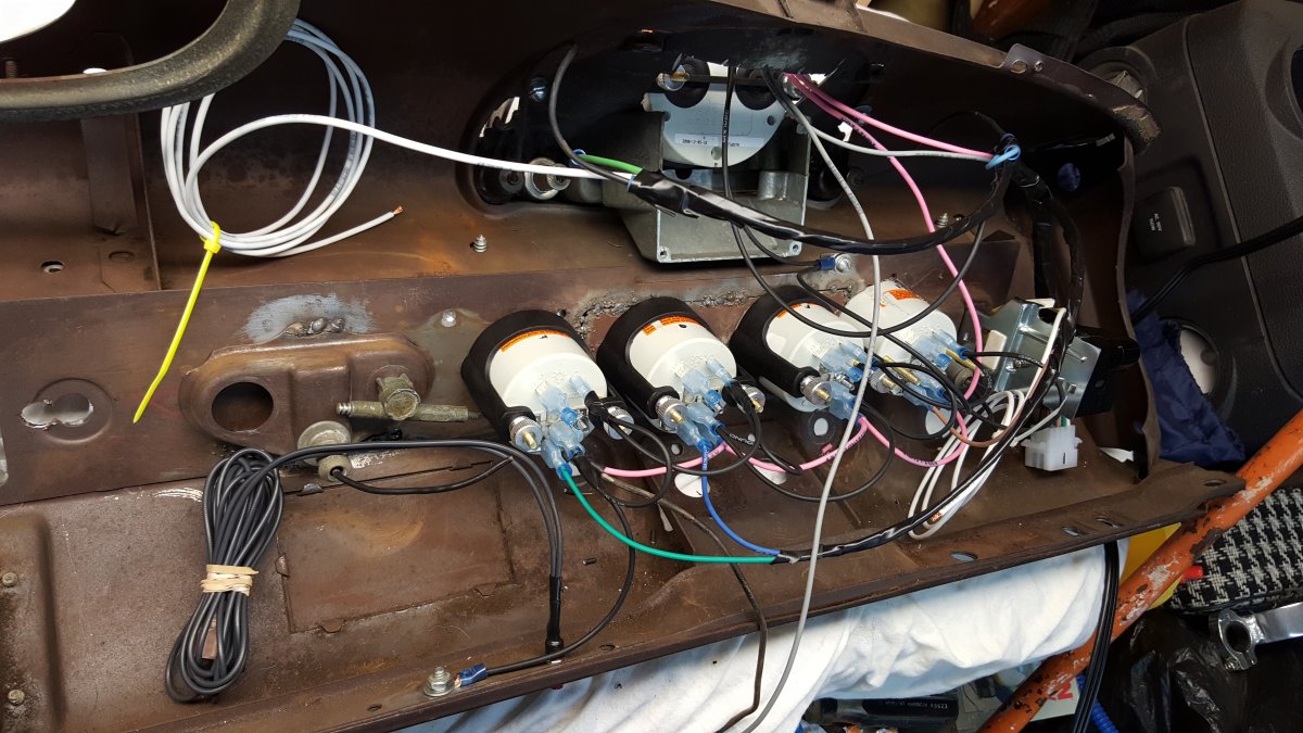

    Jeff do you have a link or part number for the led lights? Id also like to wire the dash with quick disconnects if i can that way i can bolt the dash in and just clip the harnesses together

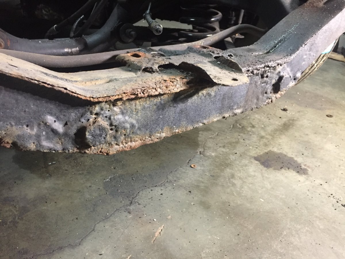

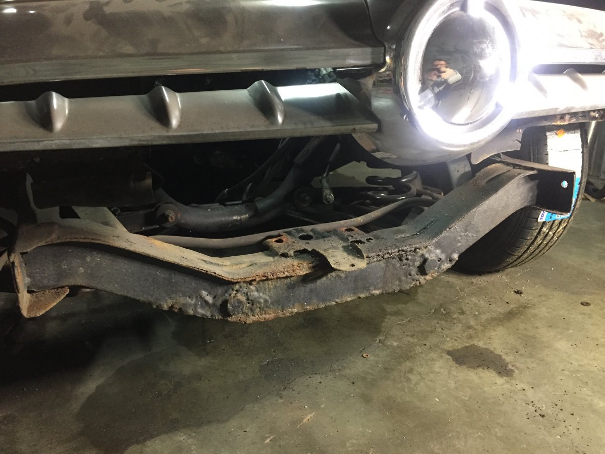

    Got the old front crossmember cut out. This thing was bad. Rotted to hell and looks like someone did some hack repairs to try and cover the rot. Heres some pics
    New crossmember
    Whacked out the original with the plasma. Check out the **** repairs. Pretty sketchy
    New one set in the rails. Fits like a glove

    Ya the quick clips are awesome for the dash! I used a 12 pin molex..I still have to tidy things up in there
  30. Don't be too hard on the PO about the front crossmember... replacement ones weren't always available. I recall going to the local wrecking yards in the early 70s to buy every 'good looking' one I could find. Bought seven of 'em, then had them chemically derusted. I got back one that didn't have at least one rust hole in it....
    Seen several with nasty looking repaired crossmembers, but they drove fine....
