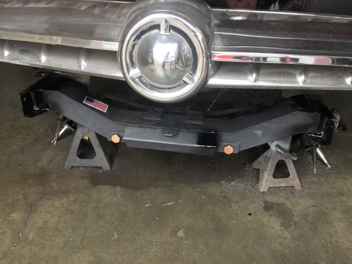

    Quick pic of the crossmember welded in and i threw some paint over the welds untill i can get under there and paint everything

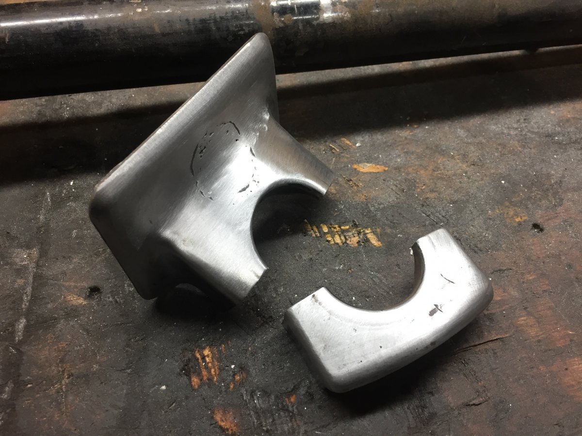

    Didnt get too many good pics of the hidden mounts but heres a few screenshots from a video. Made these from stainless and welded them to the back side of the main bar. They bolt down through the valance. Heres the bracket cut...........
    Bent and tig welded
    Made a mount for the middle of the bar that mounts to the stock center valance brace. Here it is cut.......
    Bent a tig welded
    The bracket is upside down in this pic. The front edge is welded to the bar and the boxed section bolts to the brace. Heres a look with everything bolted up
    Grill turned out nice and clean. This will be buffed out and all the mounting brackets painted black on the backside even though there not visible anyway.
