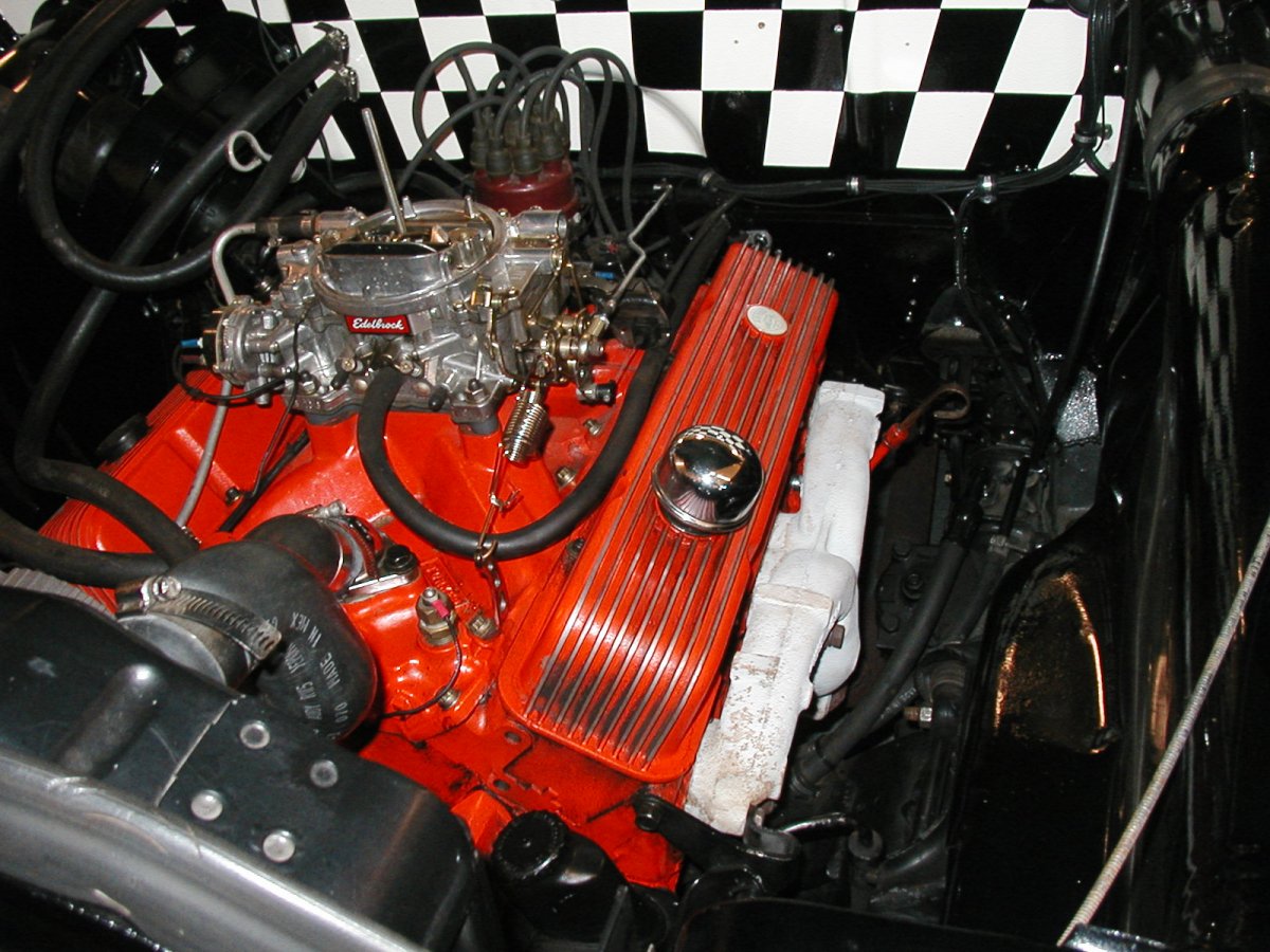

  22. Chevy in a Ford, you bet. This is my Avitar. Nothing done to the Firewall or floors. I know, it's a 51 not a 54 but same basic ch***is. I may have done it the hard way but the outcome is the same fit in the Hole.

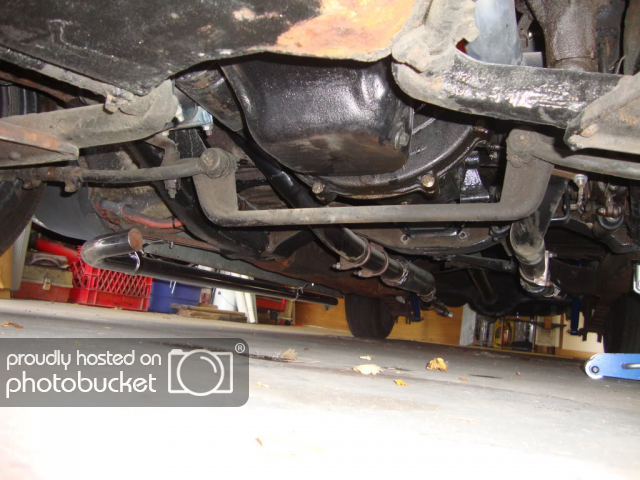

  27. Jeff Bohmann
    Joined: Jan 21, 2019
    Posts: 152
    Jeff Bohmann
    Picture of the problem child. Not sure if it posted.
  28. Jeff Bohmann
    Posts: 152
    Jeff Bohmann

  30. Jeff Bohmann
    Posts: 152
    Jeff Bohmann
    Not sure if this one posted either. I’m new to this so maybe someone can let me know if the pics are showing up. I found this picture on an old forum and may be my answer. It looks a little low for me, especially when you drop the front end, but it looks like it could be tucked up a little higher. I may go this route. I am Weill the options before chopping up my pan and or firewall....but y’all gave me many good ideas....we will have to see what works out the best.
