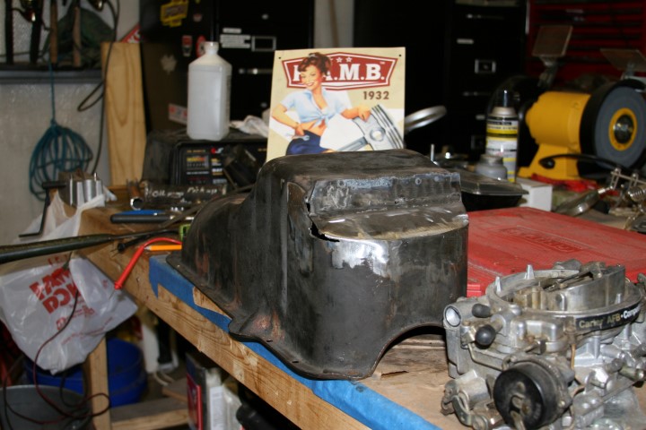

    Ok some more pictures I was running out of room in the other post. IMG_3334 (Small).JPG
    This picture shows how close the center link is to the flex plate at full lock. You can see there is no room to move the engine any further forward.
    This is the pan I sacrificed in figuring out were to make the cuts. Must have trimmed and cut this thing a dozen times before I got it right.
    This is the inside of the pan the shelf is pretty close to the oil pump body on the bottom, the pick-up when installed is in the exact same spot in the sump as stock.
    Hope this give you a little bit of an idea of what is and is not. Now I got to pull all of this stuff clean it up paint and get ready for the finale install.
