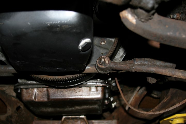

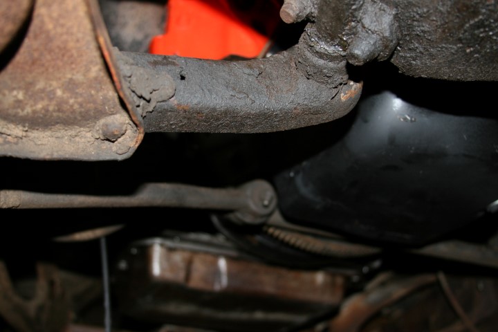

    The other thing I was thinking about while tossing around ideas and options, is what if you move the inner tie rod holes out a half inch when you fabricate the drop draglink? There is enough adjustment on the tie rods or even shorten the threaded stud on the tie rod ends. So if the tie rods are a little farther apart on the drag link, it would give you more room and won’t hit the side of the pan at full stroke. I know your pics show it clear one direction and almost hit on the other. I’ve done it before on circle track suspensions to clear when we had drastically set back engines.

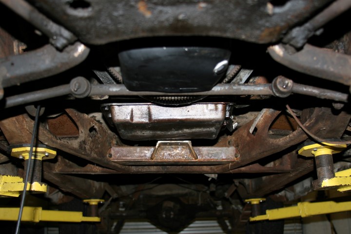

    So anyways, back to the topic of the the center link hitting the pan...after looking at several options and a few ideas from the post....and not to mention a long conversation with Dave at Drop and stop..looks like the way to go is cut the pan...i am going to order another stock steel pan. Like Hombre said, use an old pan to sacrifice for the purpose of R and D, and once you have what you are looking for, go at it....I ordered the motor/transmission mount kit from Butch’s basically as a time saver and help me get the motor in the right spot without spending too much time. I am in a little time crunch so the little extra money for that kit was worth it. Dave suggested cutting the entire bottom out the pan sump off to basically be able to see what the pick-up is doing in relation to the notch being fabricated. I agree with that idea as it will make it much easier to see if the pick up is affected by the notch cut out. I’m also going to look at boxing in the entire bottom of the pan and maybe making it larger in another area to make up for the loss of oil capacity.

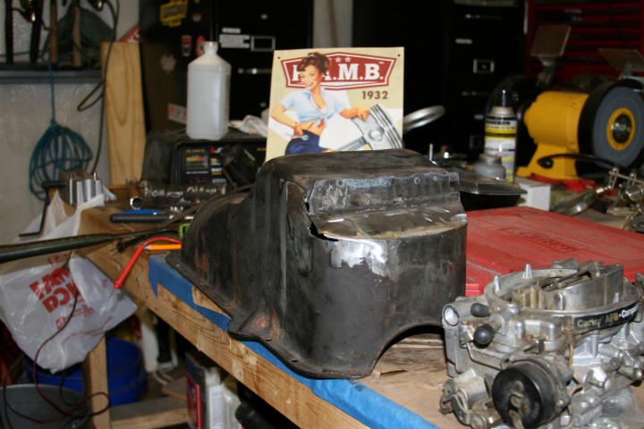

    Great, I was talking to Dave at drop and stop again today. He was looking at your posts of the oil pan and we ended up coming up with a game plan. But he and I both we kicking around a possible starter issue. So it looks like I’m going to do the pan but I plan on widening the pan forward of the cut out area to gain back the lost capacity of the notch in the back. I’m going to order a stock unpainted Pan to use for the final product and my old one will be used as you suggested as a mock up....I’ll post some photos when I start the work. Hopefully I may be able to save some dimensions and maybe a template for those who also run into this issue.

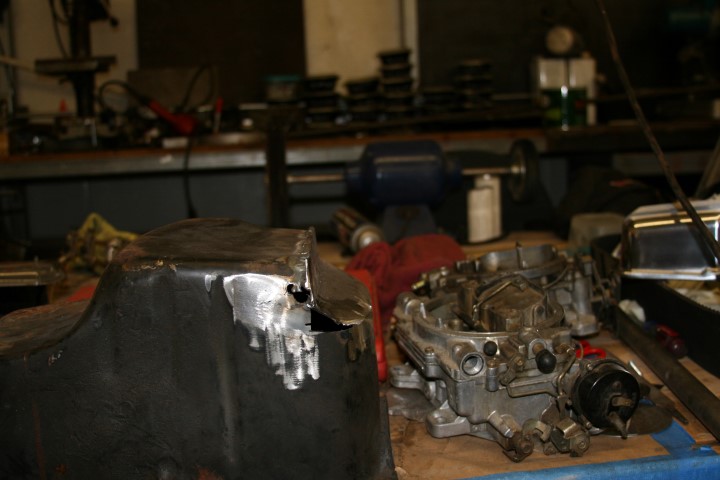

  24. Hombre
    Joined: Aug 22, 2008
    Posts: 1,075
    Hombre

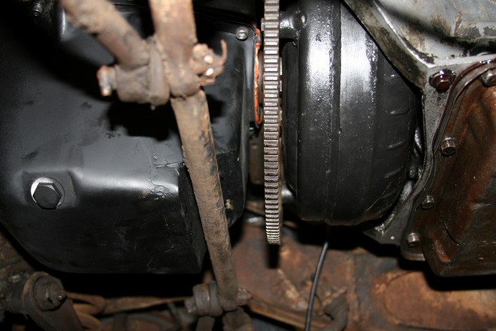

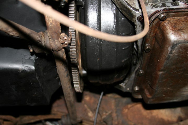

    Jeff, sounds like a plan to me. A word of caution though. For all of this to work engine placement front to back is critical. It's not a hard thing you just need to be sure to mock up the engine and check that the center link clears the flex plate. If you think about this the center link is going to fit between the oil pan and the flexplate, the notch gives you a little more wiggle room that's a good thing. You will need to mock this up in a way to be able to check for this clearance. I fab my own motor mounts ( frame portion) so what I did was lower my mock up block into place ( and I did use a mock up block, an old junk 350 block I had laying around) I then blocked under the front of the oil pan to get the motor were I wanted. I then leveled the motor at the intake manifold and shimmed this at the ****** mount so that everything was good and steady. Once that was done I could move the engine block and mock up ****** ( had one of those too, it was a empty TH350 case--lot lighter that way) front to back to get the clearance I needed. I then welded some round bar to the front crossmember and then bolted this solid to the block surface.
    Once that is done you no longer have to worry about anything moving or slipping out of place, it's rock solid. I then went 2 1/4" deep into the pan front to back. This gives you plenty of clearance for the oil pump pick up to remain in the stock location, as it is closer to the front of the sump. To gain the clearance you need you need to make the cut up the oil pan very close to the oil pump body, once you have these two reference points the hard part is done. Then its just a matter of welding the pan up, and fabbing and installing the frame portion of the motor mount.
    I like your idea of adding some volume to your pan when you make these modifactions to get it back to full capacity. After mine was all done and the engine was back together and ready to go I filled my crankcase just to see how much oil capacity I had lost, much to my surprise it was right at 1/4 of a quart...

    I would have thought more...but I’m only estimating from your pictures, so I didn’t have actual measurements. Estimated that you lost 12 cubic inches of area x .554 to convert to fluid ounces you would have lost 6.6 oz of liquid capacity. My plan is to actually fab a square box like the drag pans are constructed. Notch the back as you did and probably the corners also to allow a little extra clearance for the tie rod ends. Years ago, I used to race in some cl***es the had rules that you had to run a stock pan. But the rule didn’t say anything about altering. So we used to box in the stock pan and put in baffles. More volume and better oil control. It still was a stock pan as far as the rules go...but that’s why I took up hot rods....no rules, and nobody gives you **** for putting a Chevy in ford...

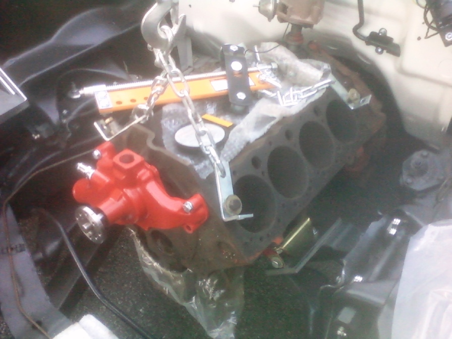

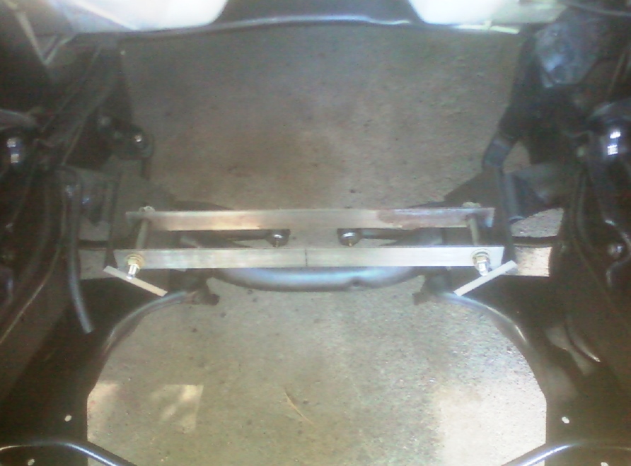

    I mocked mine up using a bare block and my old steel heads with the oil pan. I dropped in an old distributor so I could get it away from the firewall. I know that the Chevy motor mounts are 16.5" on center. I made up a jig out of steel I had laying around and made up the ch***is mounts from some 1/2" x 4" hot rolled steel I had. I used Energy Suspension motor mounts, also their transmission mount. I purposely made the ch***is mount uprights a little tall, so I could machine material off them to drop it lower.
    Jeff Bohmann likes this.

    I really like the motor mount fixture you made, I need to try that. Even without a mock up block, as long as you would have that motor mount fixture in place, everything else is just measurements....if you don’t mind spending a little time with a tape measure and a note pad.

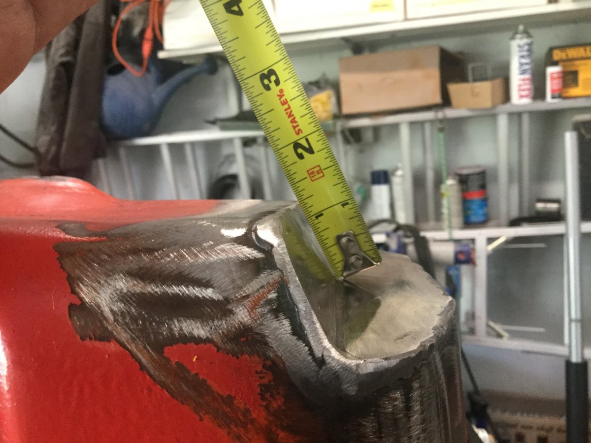

  30. Jeff Bohmann
    Joined: Jan 21, 2019
    Posts: 152
    Jeff Bohmann

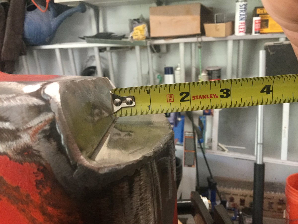

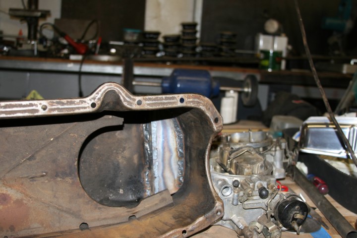

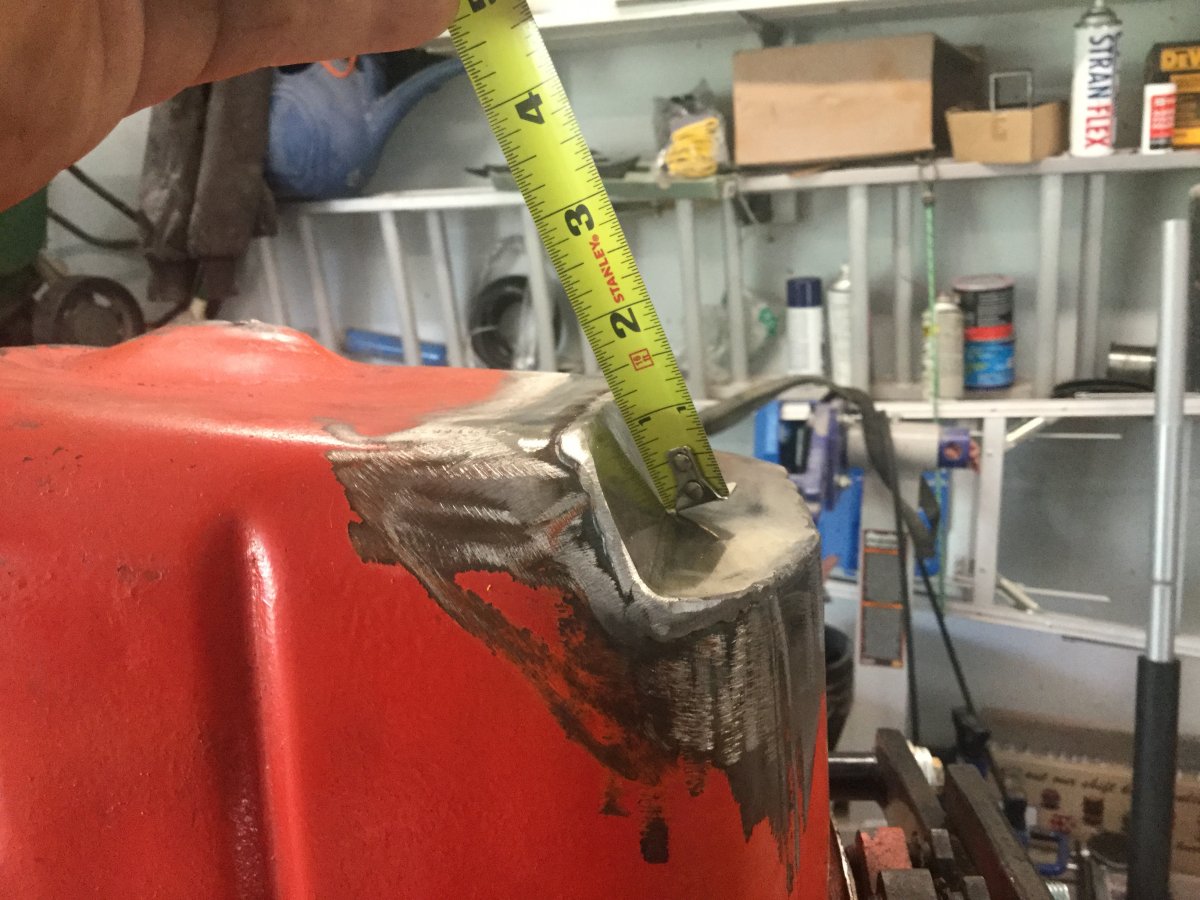

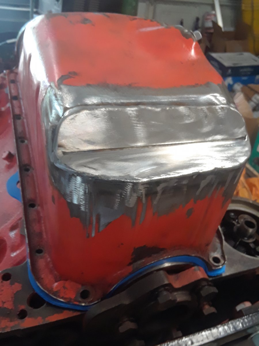

    First attempt. Ended up using the pan that was on the motor. I have two more in case I need to try again. But I cut the notch as high and far back as I could go.
