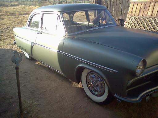

    still working on my chevy..but helping out a friend with her Customline...welded in some holes.. did a little notch, painted it a satin green, and doing a few other things to it...
  10. solo_909
    Joined: Apr 9, 2006
    Posts: 1,786
    solo_909
    Nice! I like the stance! Is that with 3" blocks and the astro springs?
  11. BadLuck
    Joined: Jan 7, 2006
    Posts: 3,055
    BadLuck
    yeah 3 inch blocks... not sure about the springs... she purchased it already lowered... but if somebody sat in the back seat..it would rub the drive shaft...did a little notch under the seat..problem solved :)

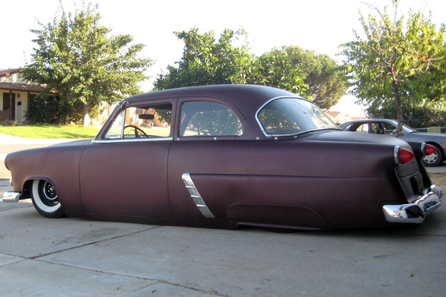

    like this?? hahaha

    Below 3" drop you have to modify the tunnle, I think that car is bagged or Hydro equiped!!
  22. EchoOfGecko
    Joined: Aug 4, 2010
    Posts: 254
    EchoOfGecko

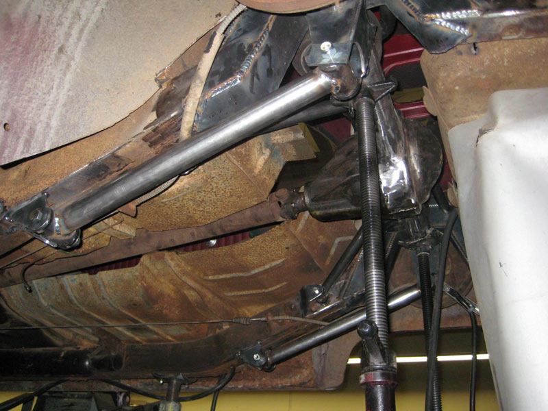

    Yea, that's SlmLrd's car, bagged with a bridge in the back and a Mustang II front end I believe. I think he has since sold it, but his is one of my favs.
    Here's a couple pics of his rear set-up, hope he won't mind.

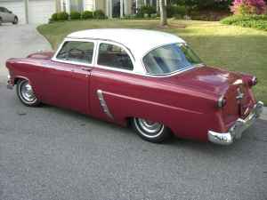

    Here is a 53 that I had a while back.It has 3" blocks and 1 round cut off the coils.It rode like a dream.Do your self a favor and add disk brakes.

    Thanks Dirty, visuals always help me more. That sits perfect!!!

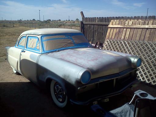

    heres my 54, it has 3 inch dropped springs in the front with 2.5 inch dropped spindles, the rear is the 4 inch jamco springs and 2 inch blocks. it rides good for the most part..................john
