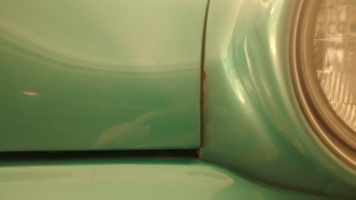

    This is what am dealing with, this is the hood closed.
    Simply not catching on the primary latch, only secondary latch.
    I look at the catch, and ***ume it would connect with a slot on the post.
    But I look at the post, I use a wrench to move the spring up .... there is no slot.

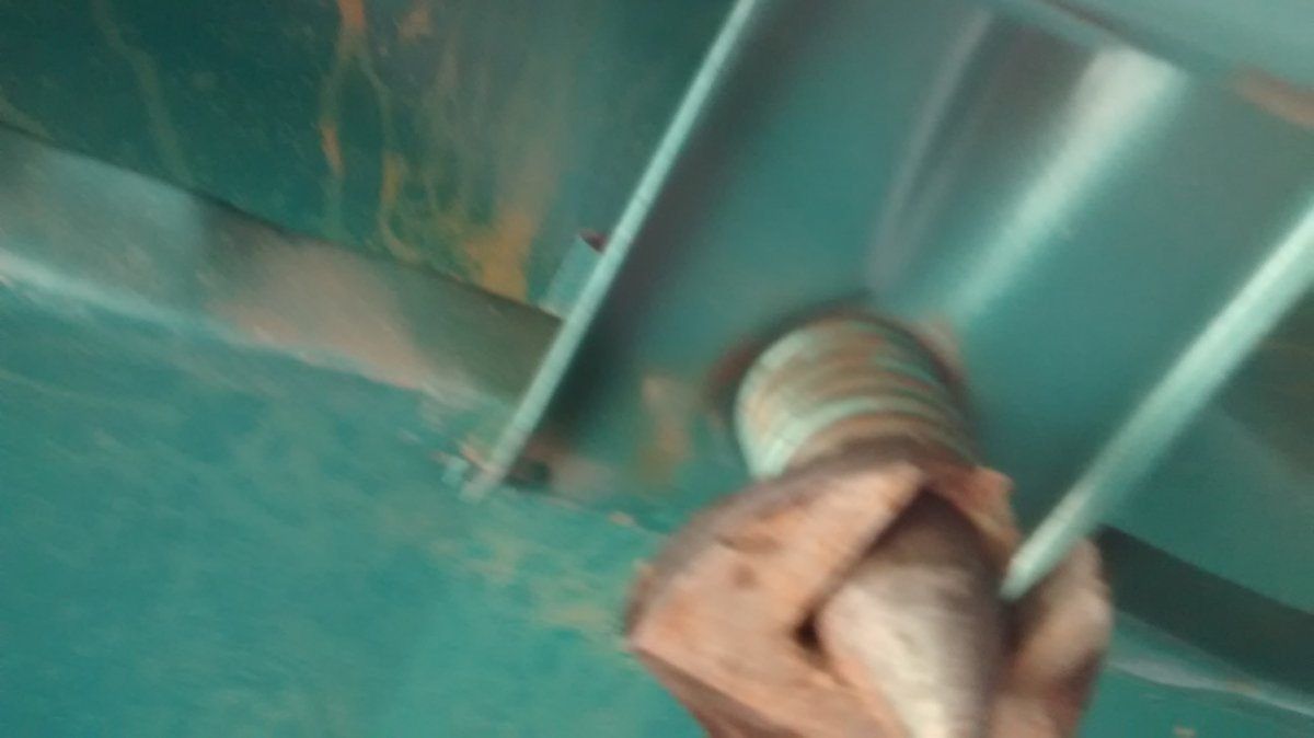

    Too me, something smells fishy here, just wonder if I am missing something?
    Do I need a new post?

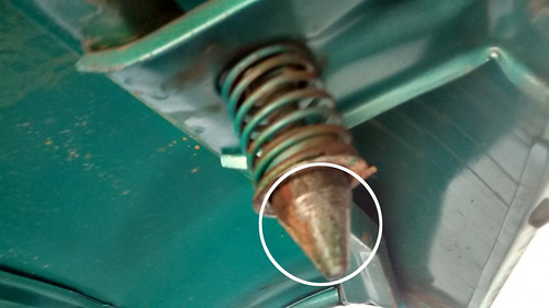

    There is a a adjustment nut to raise the piece shaft that fits into the latch up & down, if my memory serves me correctly it is on the other side of the bracket.

    There could be a locknut on top, above the bracket...that's how it is on my Hudson. Tricky to get a wrench on it, but it can be done. If so, loosen the nut, then unscrew the post a couple turns, and see what you have.

    I guess my next step will be to remove that nut, Clean the pin and put things back together.
    I would just expect there to be some slot on the pin for the latch to catch on.
    Raising or lowering the slot would adjust the hood.
    The pin is smooth as far as I can see.
    Maybe if I remove it and clean it, will understand it better.
    I have no history on the car, I just wonder if it is the right pin ... maybe I can cut a slot in it and make it work.

    The arrow is pointing at something that doesn't look right, can you take a better photo?
    The pointed part should slid into the hole for the latch and it is flat on the back where the latch can close around it after it when the hood is shut. HRP

    I hope this helps, here is what I see. And I use the wrench to push the spring up.
    I see nothing for the latch in the core support to catch on.
    Why I am wondering if it is correct pin ... I suspect I am ignorant though :)

    ok I am slow, if you look up about 3 turns on the spring, the pin changes.
    Possible I loosen up the pin and it will catch on the latch.
    Just seems like a lot of adjustment is needed for it to work.

    This entire piece slides into the opening.
    Reach inside the grille and pull the hood release, the latch mechanism should slid back ( arrow) and open up to allow the pointed plunger to slid into the hole and latch if it is working correctly. HRP

    seems to me the "nut" under is welded. and the "slot" adjust hood > use a Pipe wrench or grind a slot in pin..
    USE A Flashlight and a mirror and show us the nut...

    Here is the real issue right here.
    This hood when you close it, you have to walk back and push down on one hood spring, then walk over to the other side and push on the other ... you can see the alignment is stopping it from closing properly.

    But back to the hood....yes, you do need to fix the hinges before the latch will work correctly.

    that spring compresses and lets the step on the pin be caught by the latch. As far as the pushing on the corners to close fully good luck with that I know of several around here they all act like that. Repop hinges were available, VERY expensive!!!!!!!!!!!!!!!

    I had the same problem and loosening that nut at the top of the pin and threading that pin down lower was enough to make it catch. It grabs and holds snug now.

    The latch and pin need adjusting LAST when setting up a hood!!The hinges do need to be repaired first so the hood can be raised and lowered correctly and evenly. The way I was taught to set a hood up properly is to either remove the hood pin or the latch ***embly so the hood cannot close. Then adjust the hood against the cowlfor a nice fit. Hopefully the fender alignment is good if not adjust the fenders to fit the hood. You may need to jiggle these around a bit but you should end up with a nice fitting hood by holding the hood down yourself. Now reinstall the hood pin and or latch ***embly - this was left off so it would not fight you while you set up your hood gaps. Next lower the hood so you can watch how the hood pin contacts the latch ***embly it should line up - if not don’t adjust the hood or you will loose all the nice gaps. Adjust the latch and pin LAST to get the hood to close down tightly.

    It appears to me the fenders need to spread at the front and the hood moved back. I had to loosen the bolts attaching the fenders to the grill surround to make the moves.
    Also lowering the hood centering spring pin should get the both the main and secondary latching.
    In the photos it appears the hood will not sit correctly with the spring/pin out. As stated above you need to do that first.

    the pin has nothing to do with the hood not closing.you say the owner had no problem closing it from the picture it looks like someone tried closing the hood like a modern hood and twisted it when p***enger side hung up.if you take a hold of the hood from the front and try to twist to p***enger side it may close properly.doing this will move it back and to right.closing the gap at back also moving the front away from fender.do not go crazy but be firm. post results

    You are correct, I watched the owner the other day and exactly how he was trying to close it.
    The owner is 6' tall, pushing 300 pounds, he has some heft behind him.
    That did the trick, I held the p***enger side with left arm, pulled down with right arm, I felt the hood pop, and now it is sitting square in the hole, and level distance left to right in the front.
    Still wont latch, now as the last step, the post needs adjusted.
