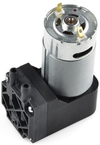

  8. David O Smith
    Joined: Jul 21, 2021
    Posts: 26
    David O Smith
    May add one of these to help.
