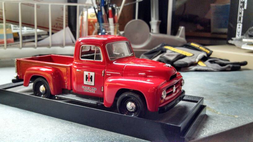

  10. fatblock6
    Joined: Oct 28, 2013
    Posts: 58
    fatblock6
  11. fatblock6
    Posts: 58
    fatblock6
    I know this is only a model but its kinda the look I'm going for but with a Very four speed running gear. Just thought it would be cool to bring it to life.
  12. fatblock6
    Posts: 58
    fatblock6
    Sorry that's a V8 four speed
