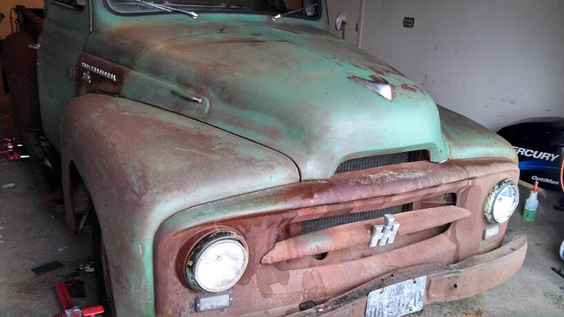

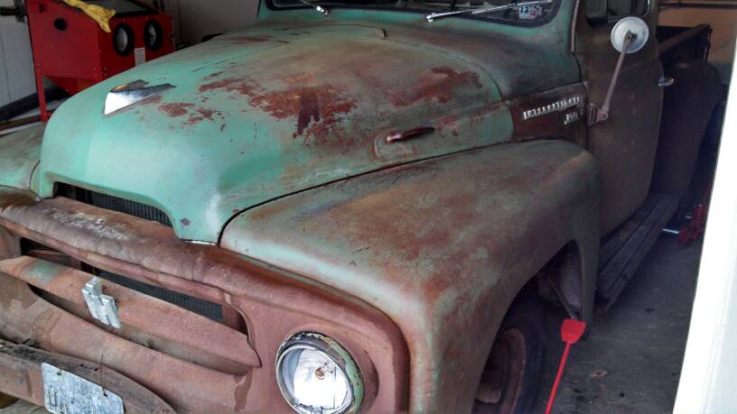

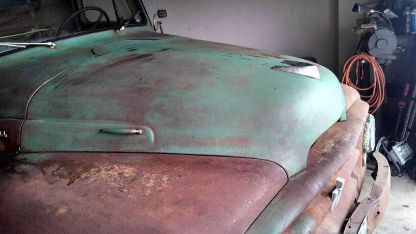

    Well truck is finally in transit. Should see it Friday. Here are some pictures before pickup 1392772283168.jpg 1392772313511.jpg 1392772346990.jpg
