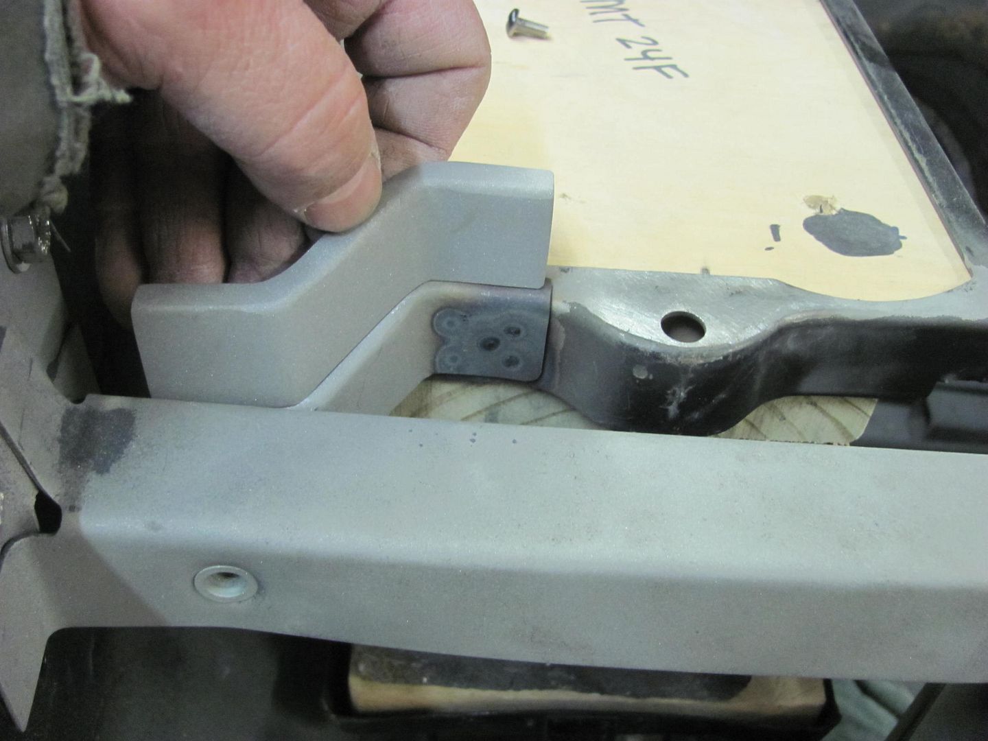

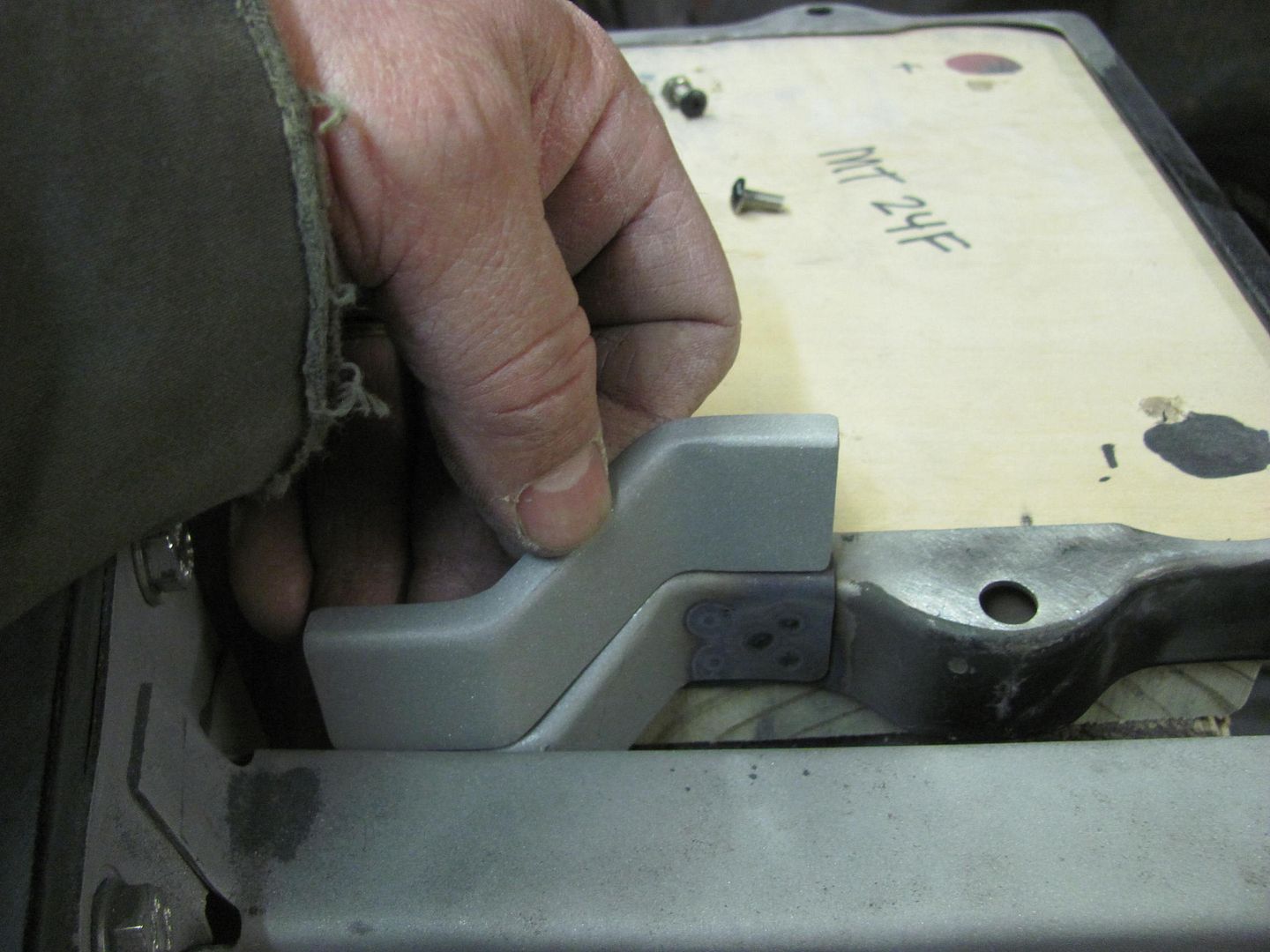

    Tonight's update. We took delivery on some nice used core support side panels from Jay Hammond's Chevy Parts. The others were quite mangled, so this will save quite a bit of time in making a set.
    Kyle finishing up the battery hold down modification...
    We also mocked up an MT24F battery...
    The factory version of this battery location for an air conditioned car also calls for a "zee" bracket to the back side of the core support.
    So with dimensions taken, a practice piece was cut out of poster board...
    Laid out on some 16 GA CRS...
    And got a bit more blocking done across the door gaps..

    Today Kyle cut out the battery tray's zee bracket, and I had told him we should tip the top lip first and then make the vertical bends...
    As you can see, it turned out horribly, and sometimes I need a learning curve myself... :D
    We had used a narrow bottom die to tip the top flange, and should have also used something different for the vertical bends.
    So let's back up and punt, here bending the vertical bends FIRST and using a roll former die to keep any markings to a minimum. We did a partial bend here, then did a partial tip, and jumped back and forth a few times for a much better result:
    Plug welded through the thinner battery hold down into the 16 ga metal of the zee bracket using a Letter A sized holes and enough heat for weld penetration to show on the back side...

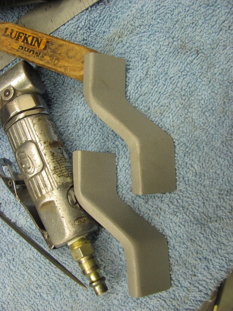

    A while back we had made the brackets to make up three "reproduction" battery trays based on a 1955 Chevy factory air conditioned car.
    The only part that did not come with the used original pieces we had as patterns was the factory hold down with it's attached "zee" bracket that secures the battery hold down to the rear of the core support, as seen here in the factory ***embly bulletin.
    We recently mocked up the battery location, and made a zee bracket based on the picture and the dimensions we had in front of us.
    Now to make the remaining two brackets for the other two battery trays.. A roll former die in the press brake was used to make the vertical bends.
    A bit of tipping using a press brake die as an anvil, and then using the tipping tool...
    The finished brackets and a comparison....
