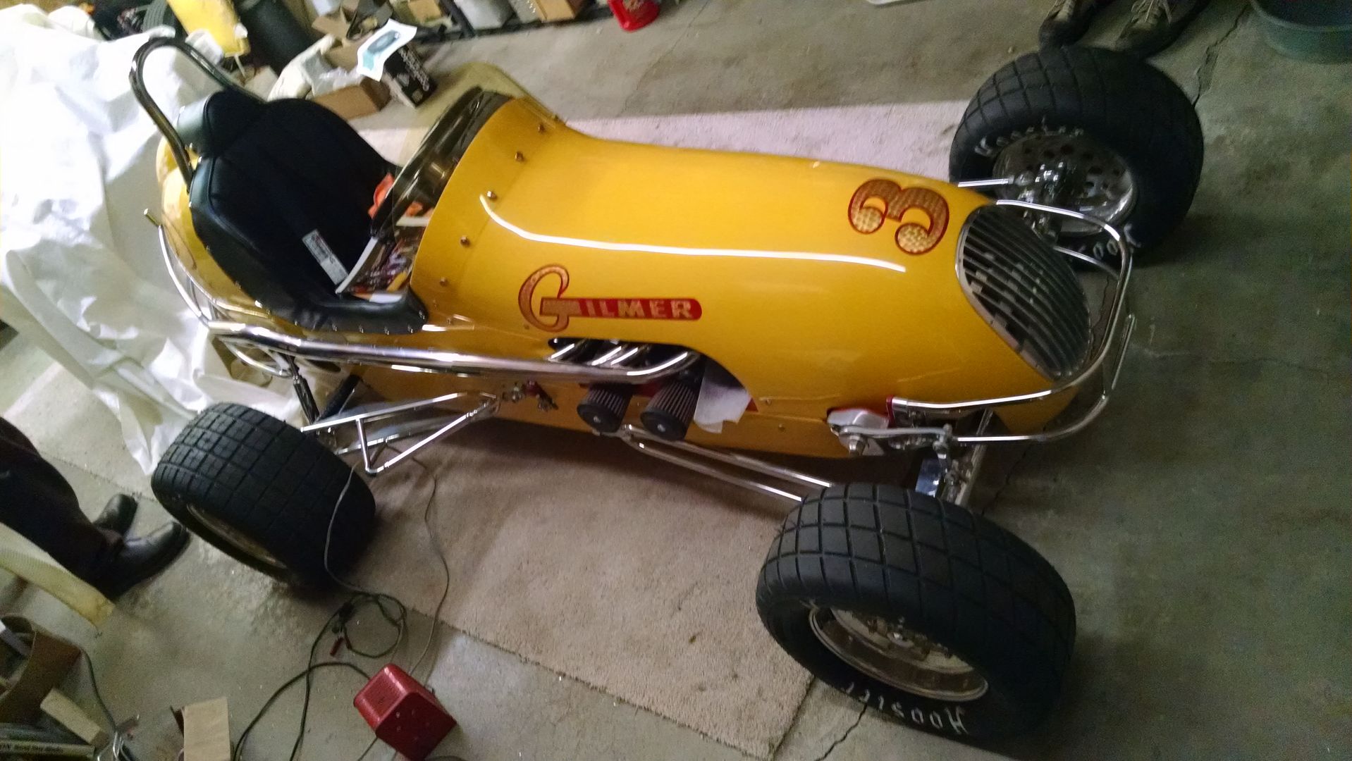

    I made it back to Howard Lake and got a chance to meet Richard's friend, Jan Gilmer. He's well known in the Midget racing world and even more so, since his retirement, in his meticulous reproductions of 1/4 scale RC replicas. Here are some pictures of a restored Midget from 1956...
    .....along with Richard's thread posted here about the body he built for the car.. A work of art to say the least.
    http://www.allmetalshaping.com/showthread.php?t=2768
    And here are some links on Jan Gilmer for those interested...
    http://www.herald-journal.com/archives/2012/stories/Gilmer-cars-Australia.html
    http://www.quarterscalelegends.com/gilmer/gilmer.htm
    Jan has a small machinist shop and still produces amazingly accurate 1/4 scale reproductions to this day. They are highly sought after, and after seeing them in person, I can see why.

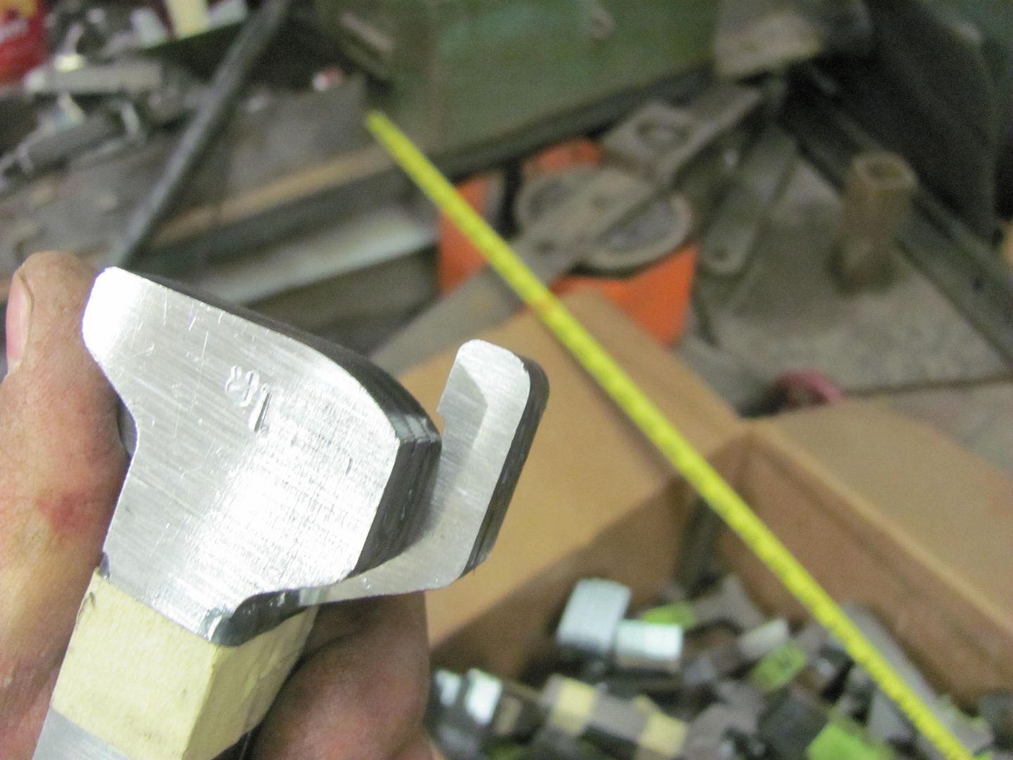

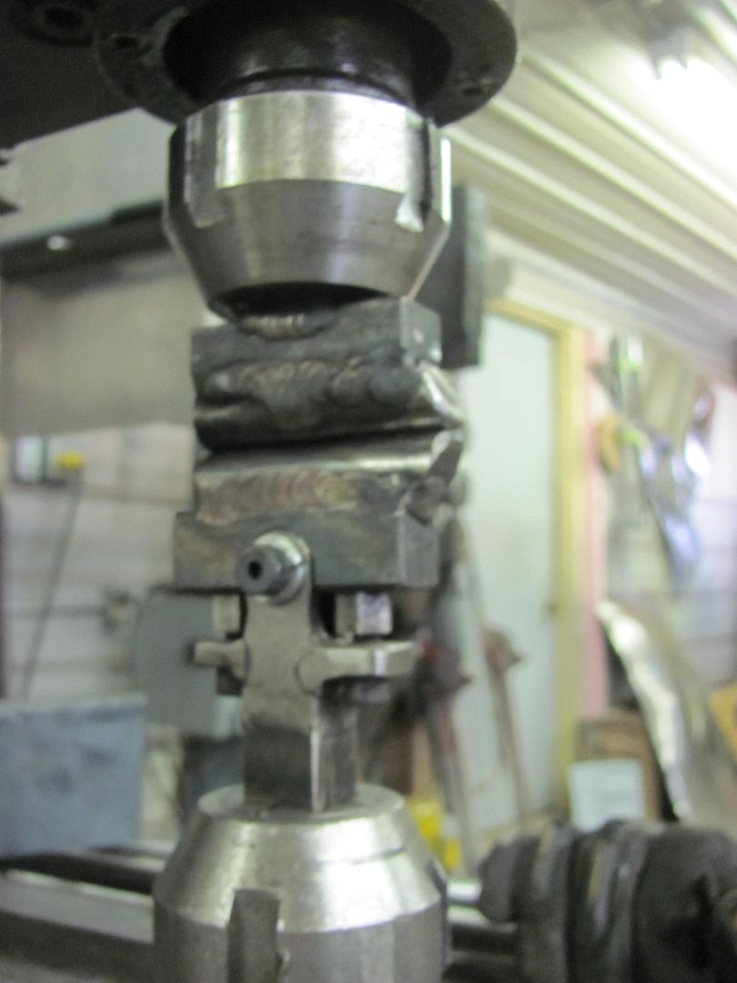

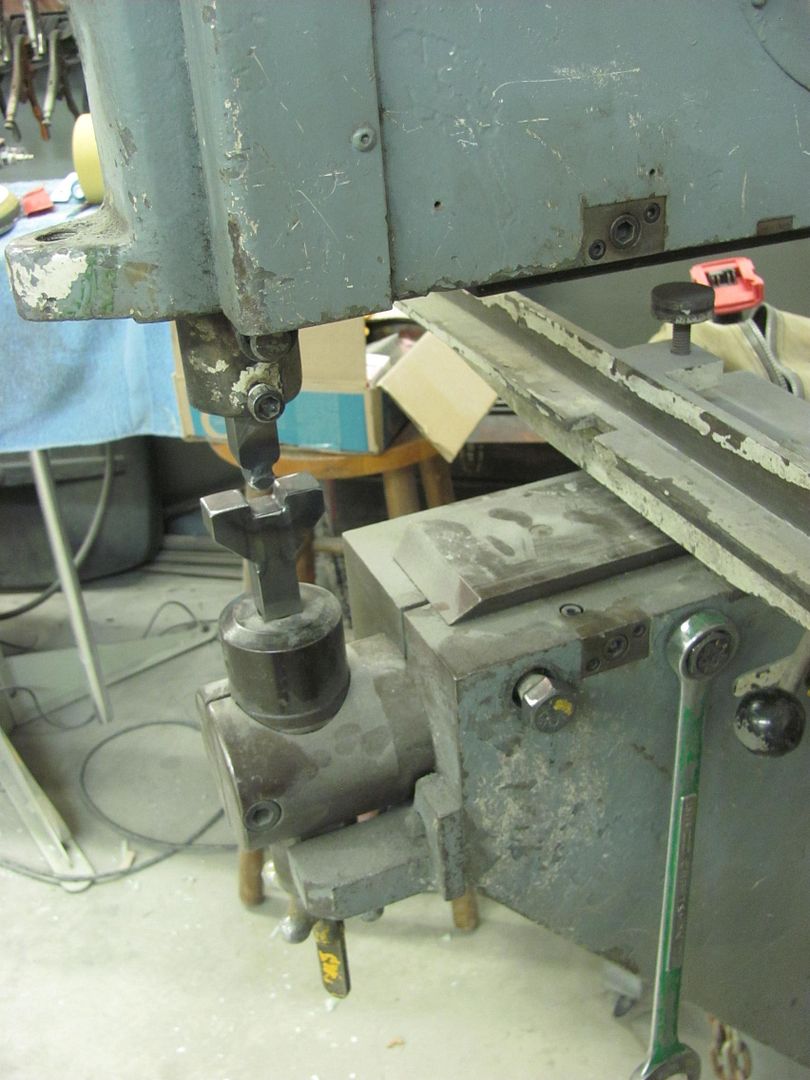

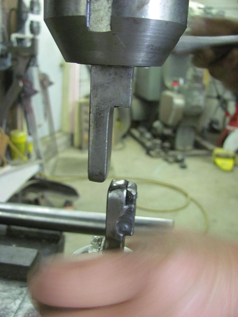

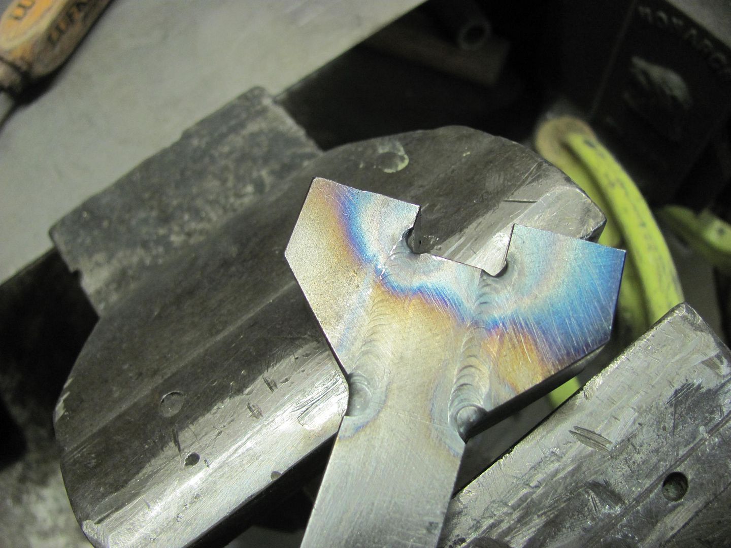

    Since I wasn't going to be at Dan's spring event, he spent quite a bit of time showing me some shop tricks...
    Band Saw "guide" for cutting convex shapes on the band saw... Slides into the blade and gets bolted to the table.... Essentially moves the table surface for those oddball shapes that don't fit the table..

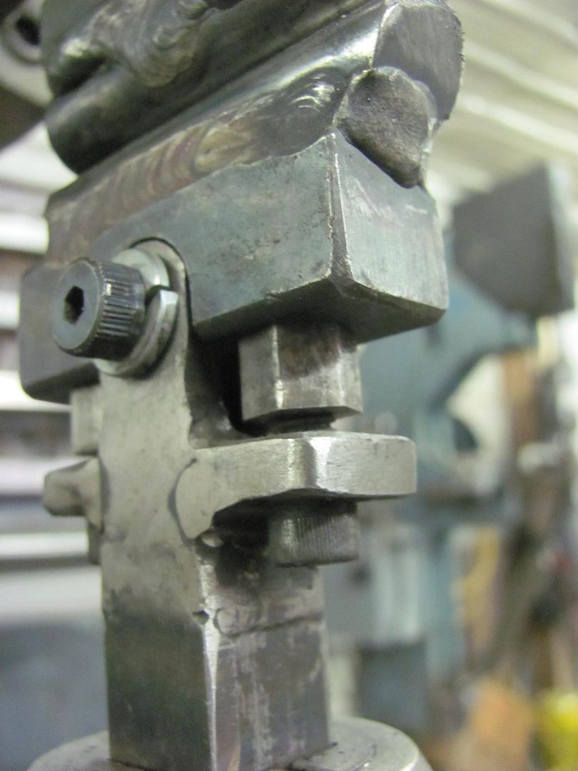

    Linear stretch dies for the Pullmax....
    The cantilevered and jack bolted design allows you to adjust the stretch for a tight radius, and the pointed ends allow you to get into the corner as tightly as needed...

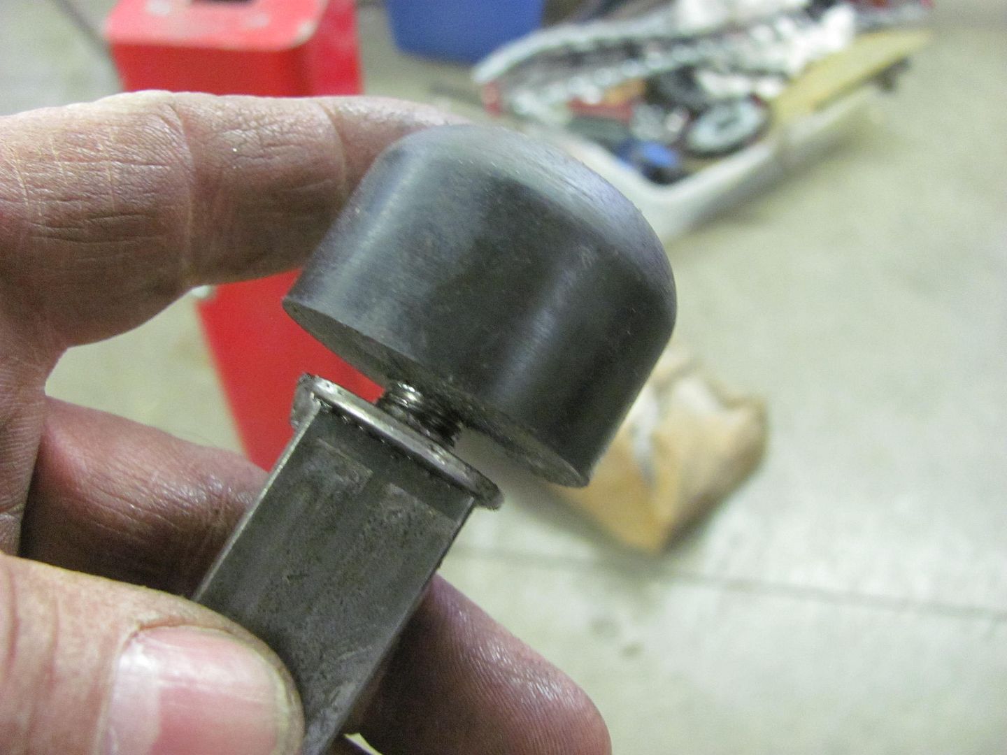

    Adjustable backstop for thinning a panel for sharper bends
    Delrin die to use for panel beading.. in conjunction with MDF forms.. (partially unscrewed to show threads)
    "tank roll" or 45* radius tipping dies for the Pullmax... 3 pieces were laser cut in 1/4" stock and welded together to form the 3/4 shank..
    Flanging/step die using an MDF guide....
    Imagine this for a bed side...

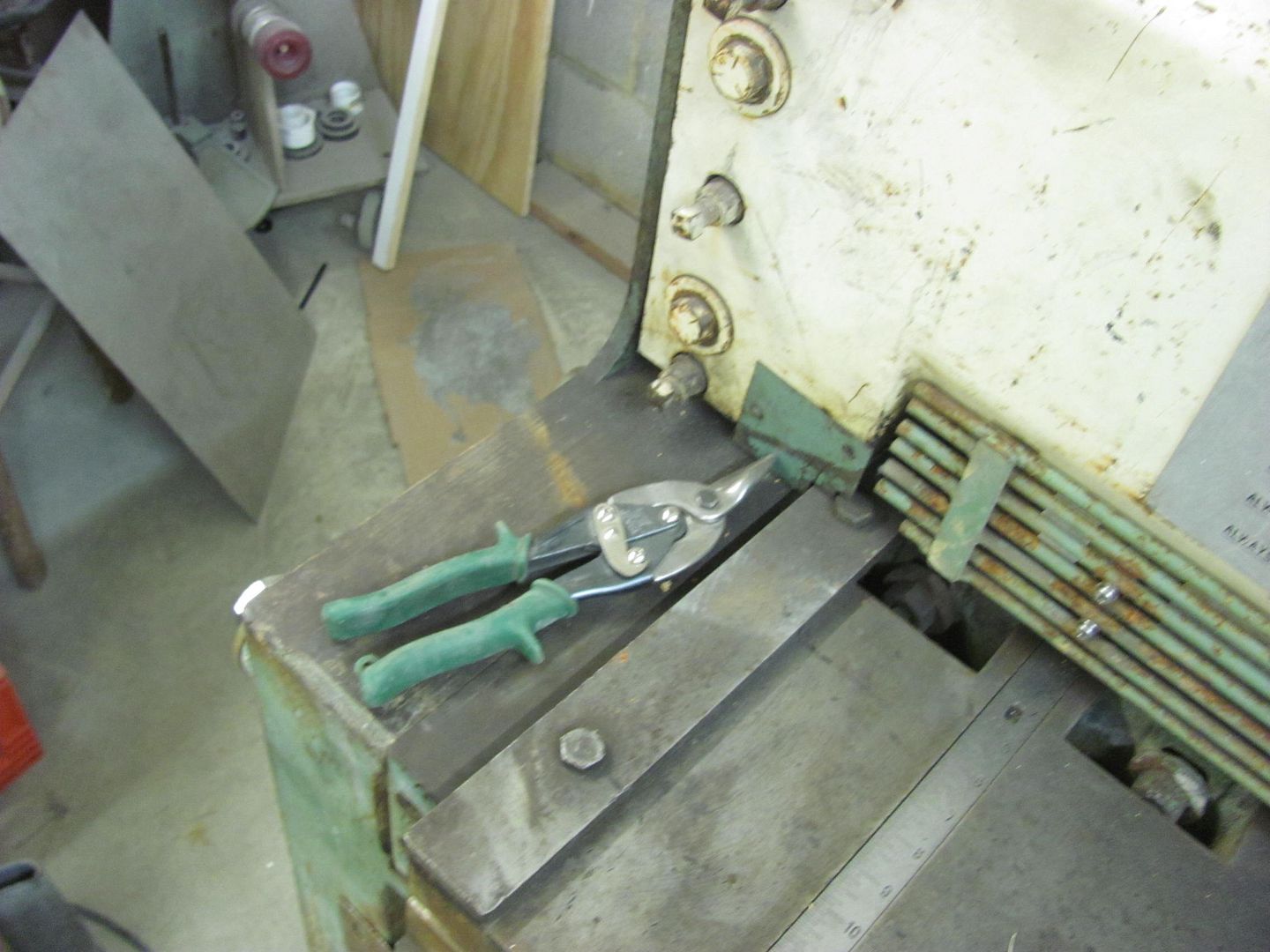

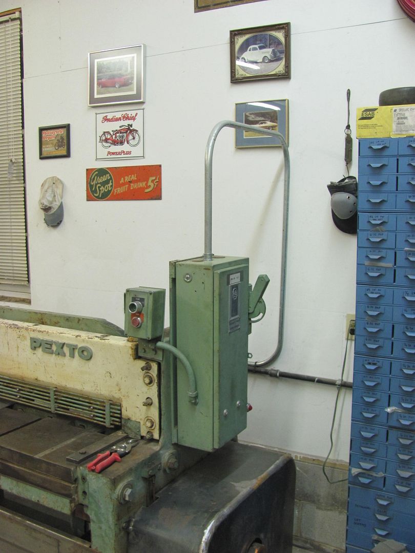

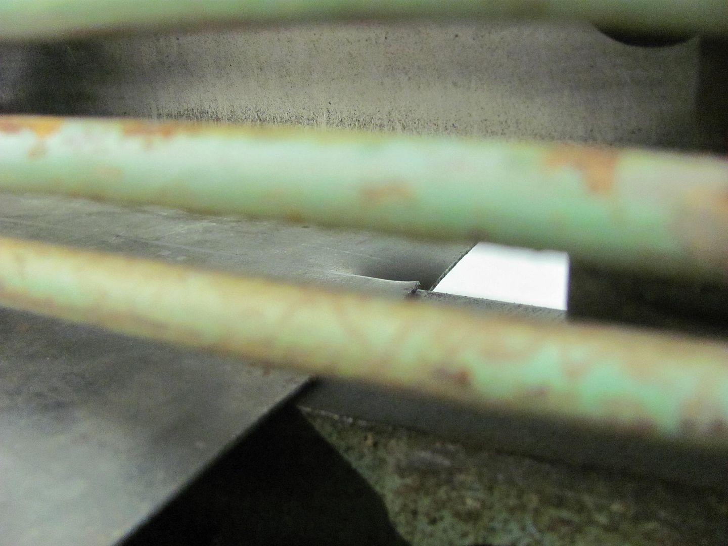

    Got some electrical work done this evening, wired up the phase converter first, checked the voltage, then wired up the shear..
    When I went to Minnesota to pick up the shear, I noticed that Dan had a couple pair of snips laying on the shear.. Didn't put two and two together at first.
    He had the shear installed without the back gauge due to the space requirements, and I had even less shop room than he did. This is where the snips come in. Mark your panel for the cut line...
    Use the red shears to make a slight cut on the right side of the panel....
    .....and the green shears to make a slight cut on the left side...
    Now you have the cut line "marked" on both ends...
    Slide the panel into the shear just past the cut edge, then gently pull back until it stops against the lower blade...
    Now shear. No back gauge or second person to help sight in a full width sheet needed.. No fuss no muss. Thanks to Dan for the helpful hint!

    Well, it's that time of year again, and the local Arby's Wednesday night car shows are in full swing, so we've changed the shop nights from Mon & Wed to Tues & Thurs so that we'd have Wednesday free to stop by the shows. We plan on taking Brad's Fairlane (the shop's last project) to a couple of the events this year, Arby's is just over a mile away from the shop, so his 4 gallon tank may just make the trip.. :D
    This is one of those cars that you'll feel and hear well before you see it, so it should draw a nice crowd ;)

  30. Thanks again for sharing Robert. Any chance you could give a peak at the anvil on that planishing tool?
