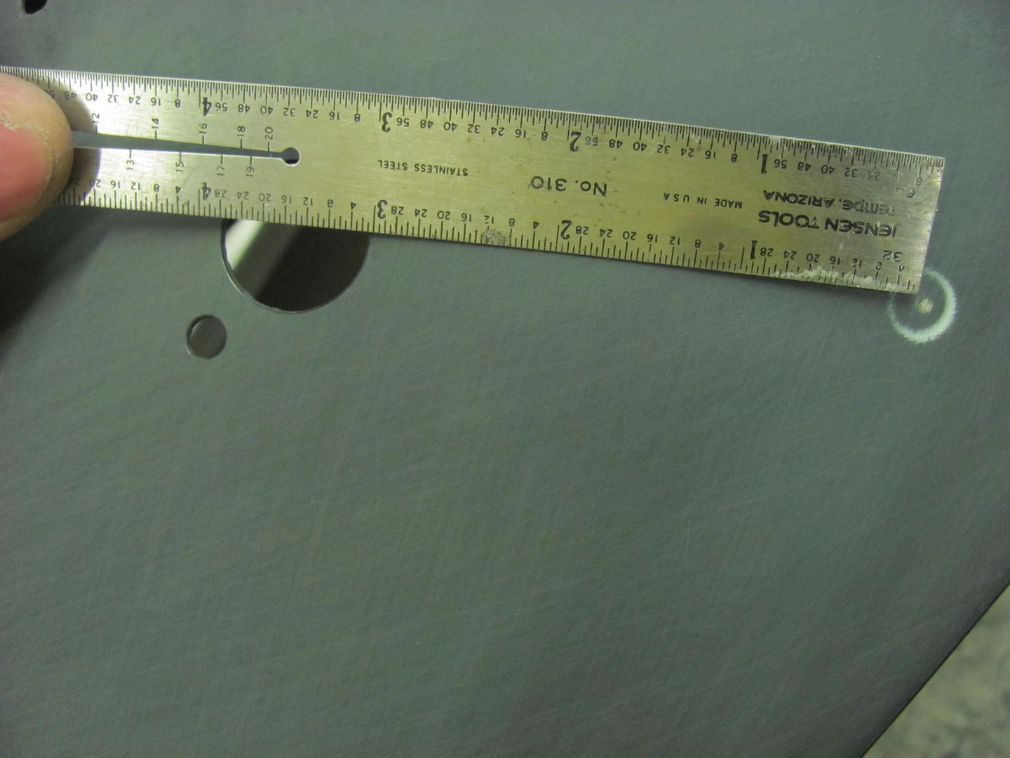

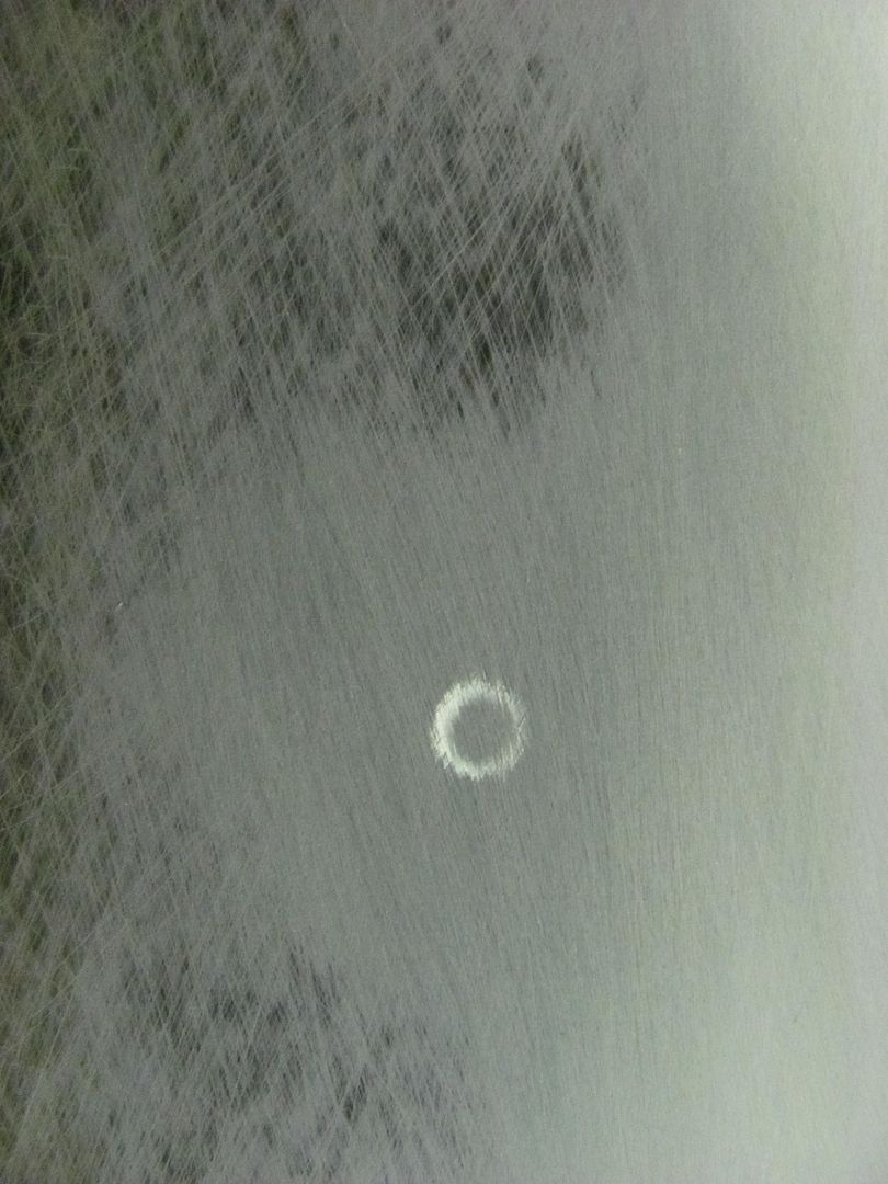

    Thanks for the comments and likes fellas. Well for a tutorial, we may as well share the good with the bad.. :(
    I was blocking out the tailgate the other day and had a "halo" effect appear in the epoxy, shown below just to the right of the latch hole. This has a light skim of Evercoat 416 beneath the epoxy in that area. It was nice and flat while in bare metal, after spraying epoxy, after blocking the Evercoat/ before spraying the last coat of epoxy. I was baffled at what would cause such a nicely formed circle in the paint...
    Even scratched the area to see if there was any softness to the Evercoat, but no..
    Here's the panel in bare steel before paint and after first coat of epoxy...
    No dings, or defects otherwise seen. I had posted a query on the SPI forum to see if anyone had ever run into this. I don't know why I didn't think of this first, but it was suggested to: 1) look inside 2) only time this type of defect had been seen was dropping screwdriver inside door and left similar mark on outside of door bottom after sanding.
    So in full investigative mode, I first measured the distance of the defect from the turn latch hole..
    The Halo is approx. 3" away from the handle hole..
    Measuring that distance on the inside shows.....oh wait....what's that bare metal?

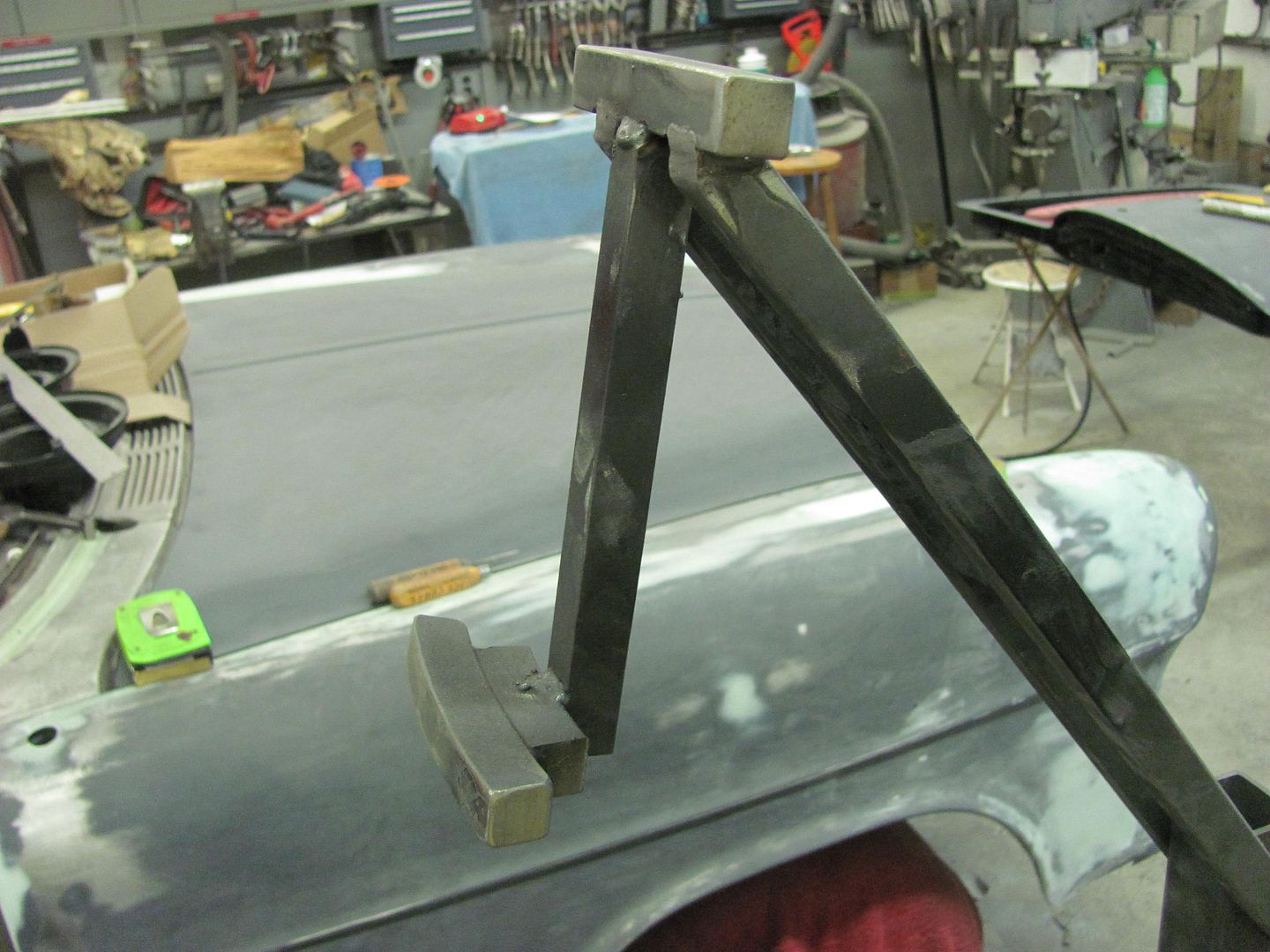

    As soon as I saw this I realized there had only been one thing inside that could have caused it... the painting fixture we made..

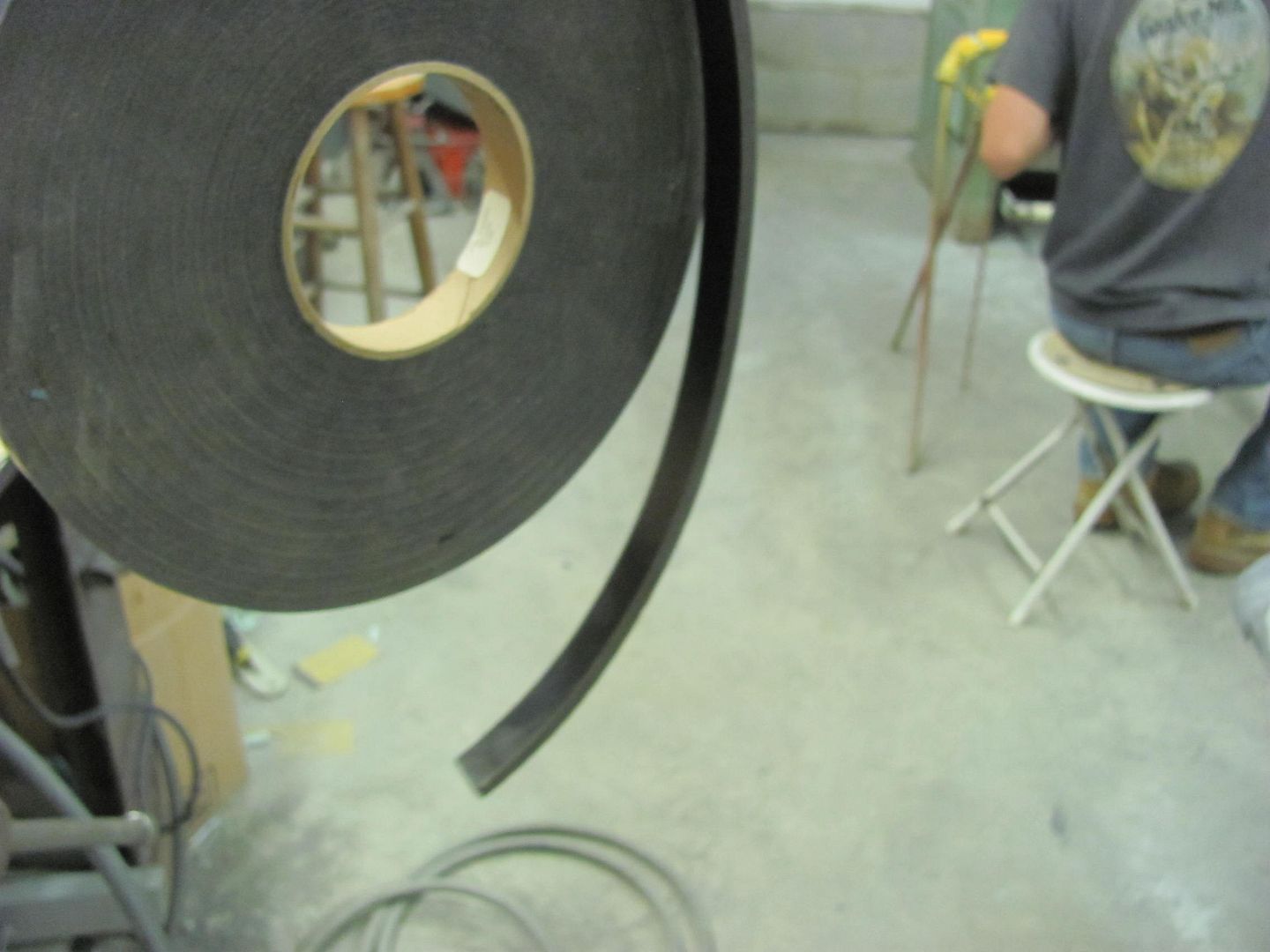

    This was made to hold the tail gate in correct alignment as on the car for painting. I had radiused the lower bar but failed to do so on the top one. A check of the skin with body sweeps shows that a #15 sweep is about correct, so it was used to verify some relief grinding on the top bar...
    As added insurance, some truck cap gasket seal was added to further isolate the issue on both top and bottom bar....
    On a positive note, glad to find this issue in the primer stage......
    But let's back up a second and look at this picture, it should have been my red flag. Where the second mark to the left in the picture was not as round, looking at it now does show a rather symmetrical device was causing this..
    So please use my lesson in dum***ery to prevent a similar occurrence. :D If you're making fixtures to hold body panels insure there are no pointed edges that may cause any outward dings.

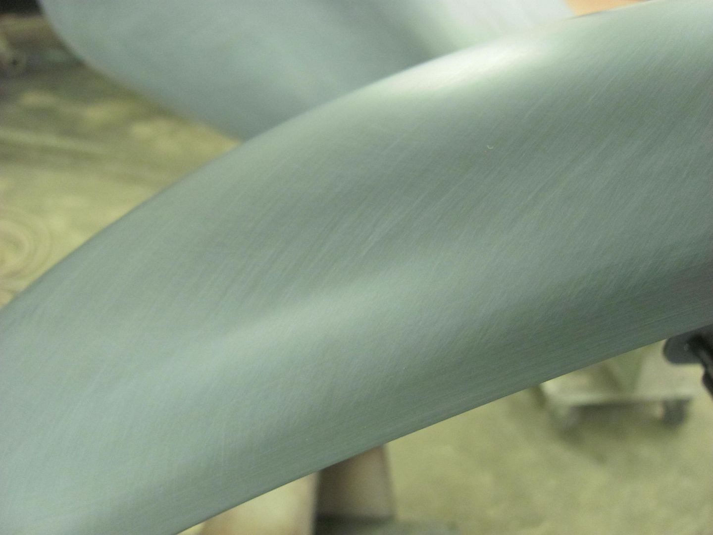

    Tonight's post offers some blocking pointers.
    We had already done a couple sessions of priming/blocking the door across to the quarter and to the fender, all installed on the car. After this, more primer and put a perimeter of tape on the door skin. Now block separately, and the tape allows you to block the door and keep off the edge to prevent losing your match to the fender/quarter.
    I don't stick with 45* angles, if you want to keep a long direction flat, you need the long block to better follow that direction. So change up to some sharper angles, about 30* off the long direction every now and then. Work one end to the other, consistent spacing, consistent angle, end to end. Then alternate to p***es in the opposite direction.
    Once done, and the inner part is good and blocked, now remove the tape and GENTLY block to the edge, taking care to not pull down at the edge and round things back off again. Whatever hand is holding the block make sure it is minimal pressure and stays on the door skin. In other words, no pressure pulling down past the edge.
    One other point, to keep the inner end of the sanding block from sanding out all your hard work in the center of the door, put a wrap of tape around the end of the sanding block that is towards the center of the door. This helps that end to glide across the center of the door without cutting primer there.
    Now to show the importance of the long board..
    We had done some blocking with the 27" AFS and seemed to have two high spots with a low in the middle of the door..
    Note the high areas marked by the green tape...
    Now we can see that as the sander is moved to the left, the left portion of the AFS is over the high spot on the left, and a bit more movement and the right portion of the AFS will start dropping into the low void. Effectively, this is still cutting material out of the low, keeping it low.
    Looking at the next size up, a 36" AFS....
    Here we can see this one does a much better job of spanning the high spots and staying up on top, for a more effective job of knocking down the highs and leaving the low in the center alone...
    After a few horizontal p***es at slight angles, like so with the 36".......
    We follow up with some vertical p***es at slight angles with the 27".... all rods removed to better follow the contour. Then alternate back to the 36 and another horizontal session..
