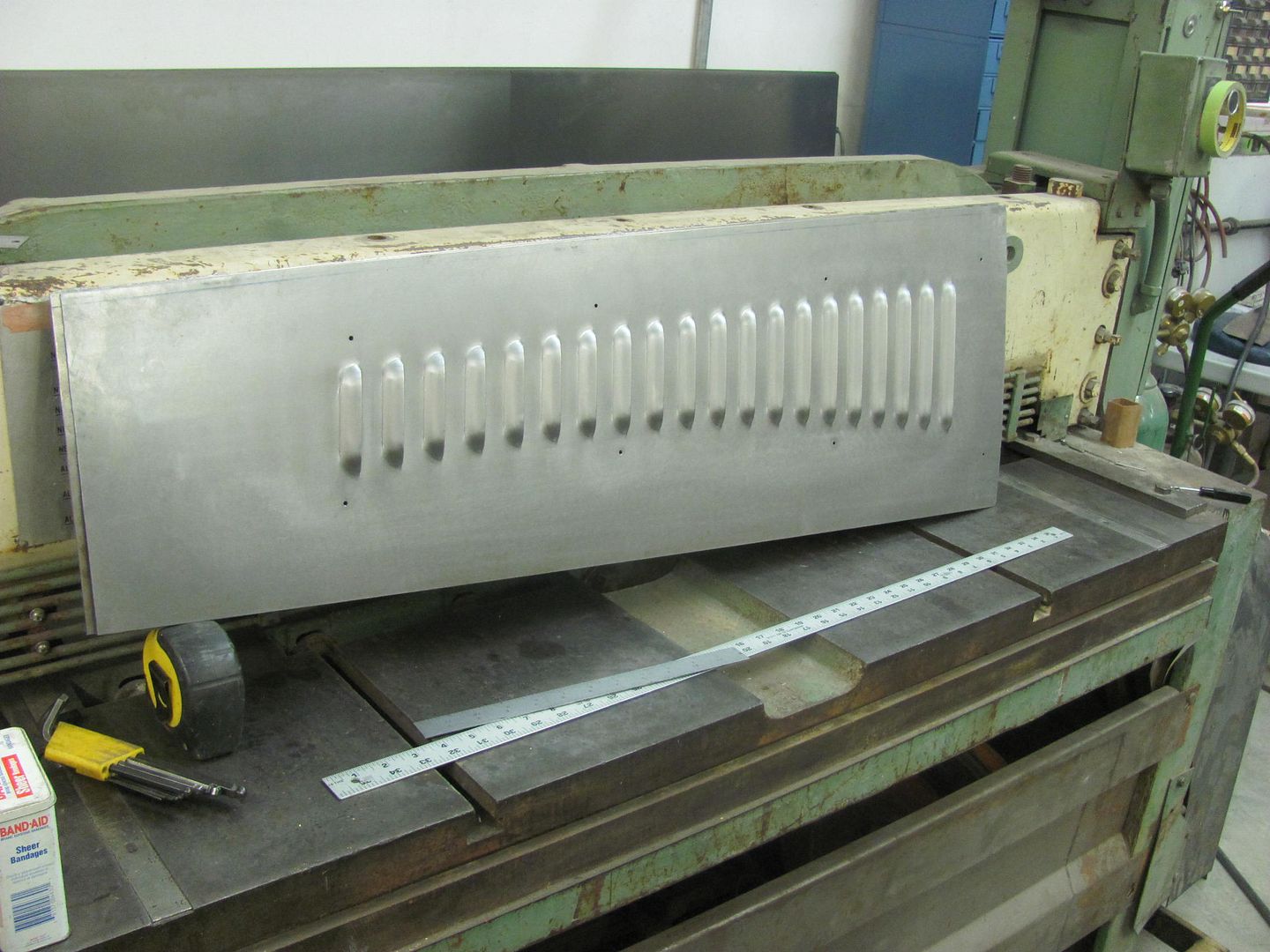

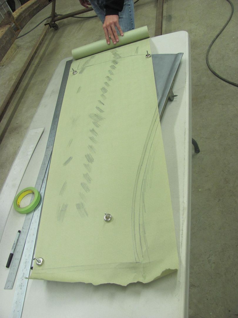

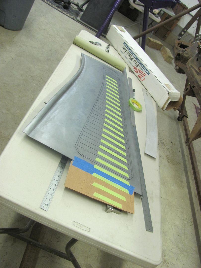

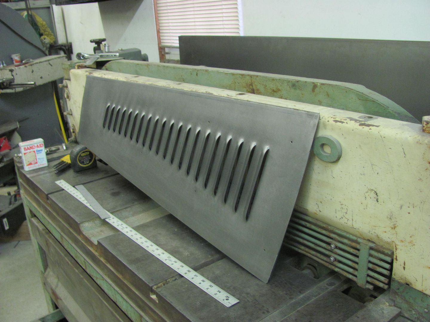

    Had an early Chevy hood side show up at the shop tonight, the owner wanted a couple different versions of louver samples made up that he could hold against the hood on the car to better visualize. One style he was looking at lends from an early Alfa Romeo that extends the louvers onto the cowl, as shown in the green tape..
    We took a paper pattern of the details so the hood side could go back with him to use as a pattern for the opposite side that still needs to be made.

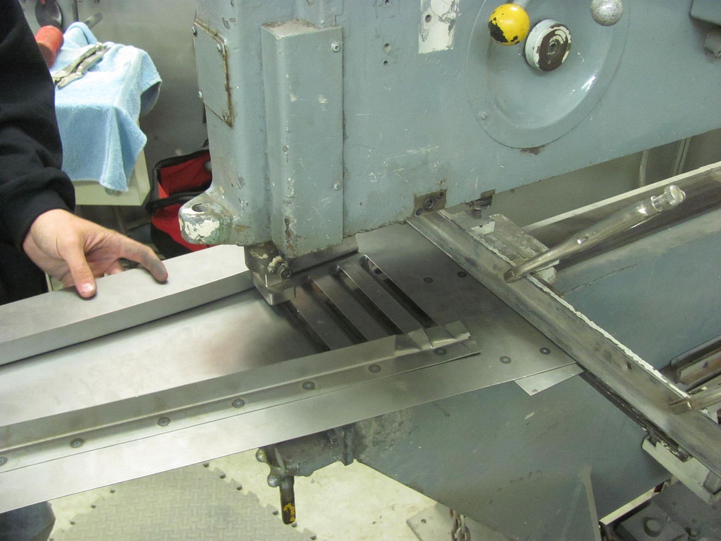

    Spot welded on some "end stops" for the louver die.....
    .....and a squared plate for the back gauge.
    Louvers in the Lennox.....
    One sample down, one to go..
    JUNK ROD, D-Russ, tb33anda3rd and 3 others like this.

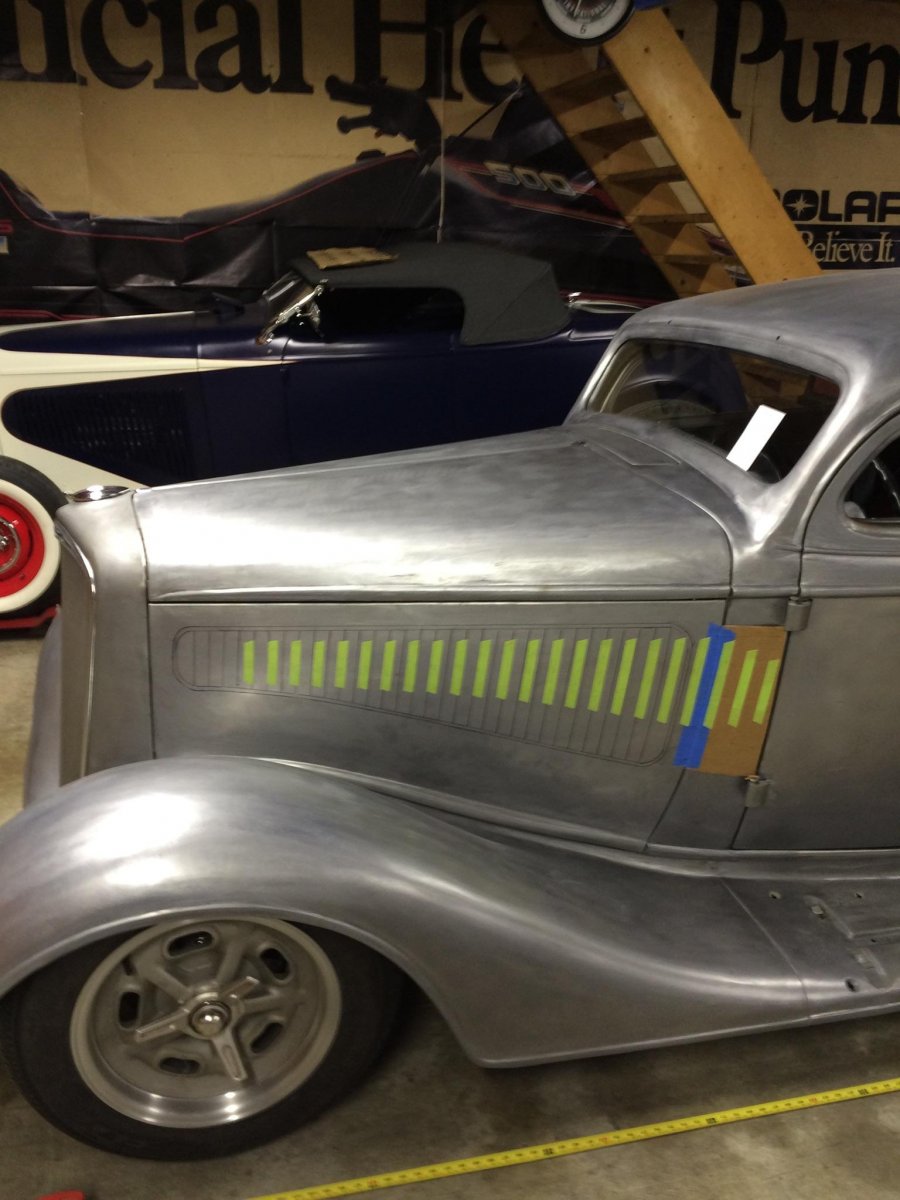

    Looking at the fake "green" louvers as installed on the car...

    Shortening the height of the louvers in the cowl area so dramatically doesn't flow very well. Maybe keep their height consistent with the arc the rest of the louvers follow? Or start the height change further forward.
    MP&C and tb33anda3rd like this.

    Thanks for the feedback. That was some of the styling cues he was taking from the Alfa Romeo. Ultimately the final call will be between Cody and the owner, but I will p*** that on.
    And for you guys who missed this car at Jalopyrama (myself included), I can say in looking at the hood side (that had two welds going the length of the panel) that Cody does absolutely gorgeous work. All gas welded with nothing visible on the outside and barely noticeable on the inside, as one would expect with gas welding. I see him very busy in the future... ;)

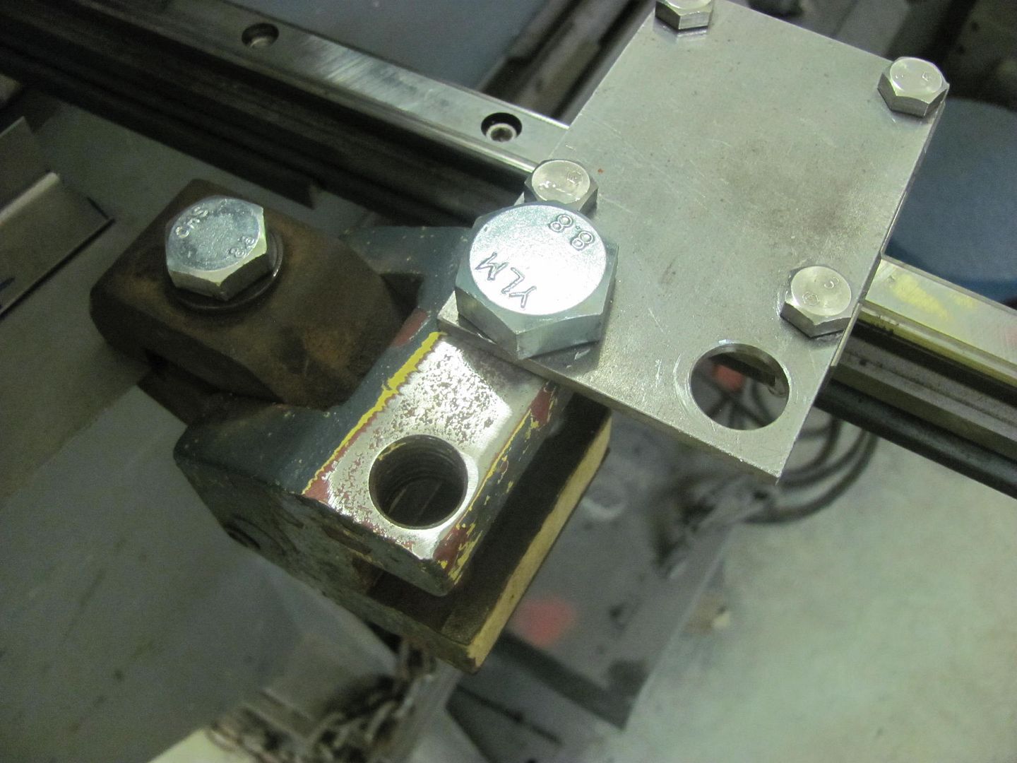

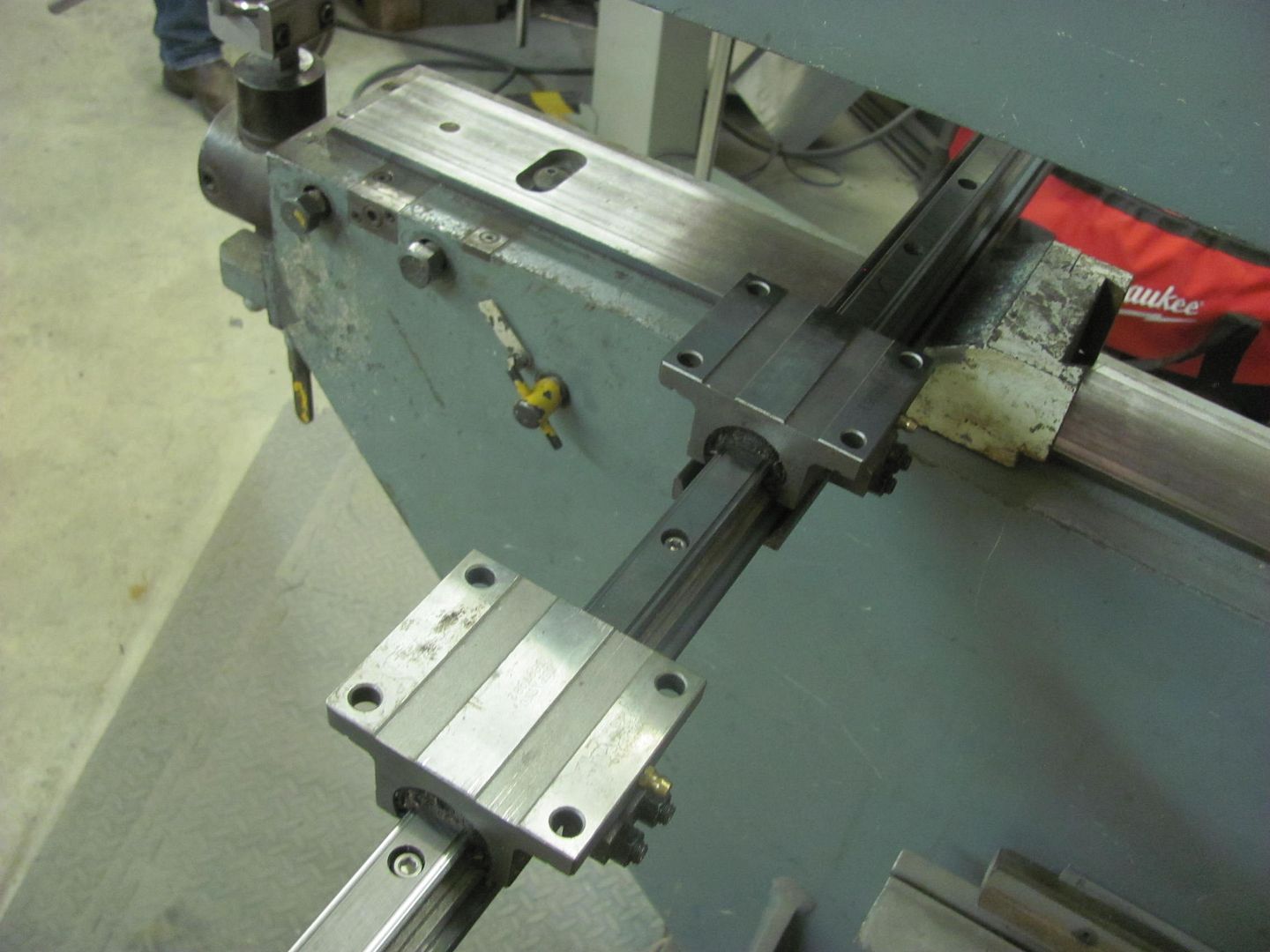

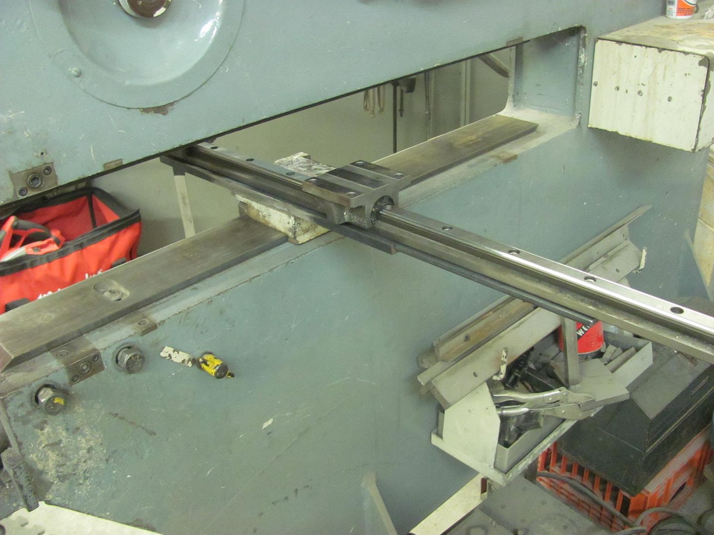

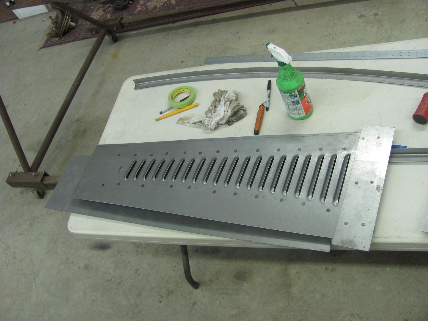

    Well FedEx showed up today with a CL delivery, got a matched pair of 48" linear rails. The two bearing blocks will have a material clamp bolted to each block, and used on one rail. We'll get a chance to try it out on the second louver sample. Where we had been manually holding the workpiece against the back stop, this should work better with a simple glide back and forth once clamped in place..
    While I was getting that squared away, Kyle was removing some s****s that were left on the frame from the original trans crossmember.

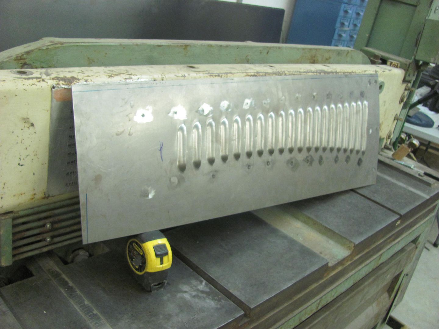

    He also removed the spot welded guides from the louver panel. The good part about samples is we can see what works well and what doesn't. Here we can see that we won't use spot welds next time as it's too much clean up. I think we'll give some stainless rivets a shot on version 2...

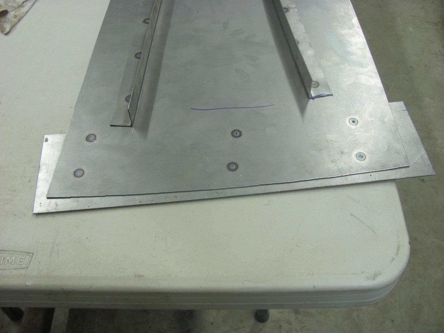

    The more I looked at our panel with the spot weld carnage, the more I disliked the result, so with new linear guides installed, we made all new today using stainless pop rivets to hold the guides in place. This will leave a few 1/8" holes to fill, but should be much less issue than cleaning up after the spot welds...
    We needed just a bit more throat for this set of "lengthened" hood sides, so one bolt was removed from the material clamp and then rotated the clamp inward 90". This lets the panel p*** through rather than bottom out in the clamp.
    Guides riveted in place....
    Here's the new version 1, much cleaner, less distortion, and we can re-use the guides...
    The cowl piece was done without guides....
    And version 2 with the cowl piece.....
    Dave (the car owner) stopped by this afternoon and picked up the samples, and indicated he was being over-ruled by most parties on louvers in the cowl, so likely that version won't be used...

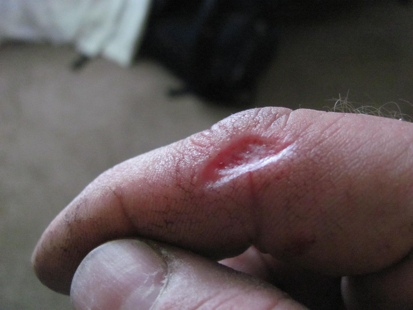

    Now, in the interest of showing the good with the bad, the lessons learned if you will, Safety tip of the day is to deburr your sheet metal even if it's only for practice pieces....
    D-Russ likes this.
