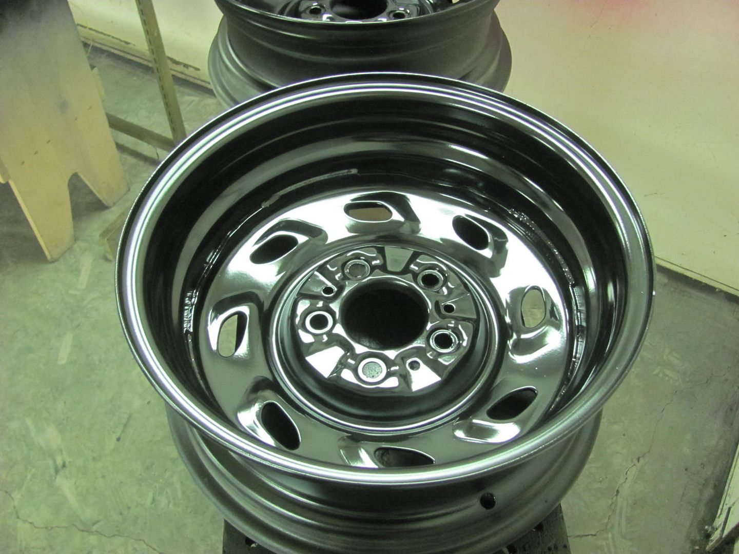

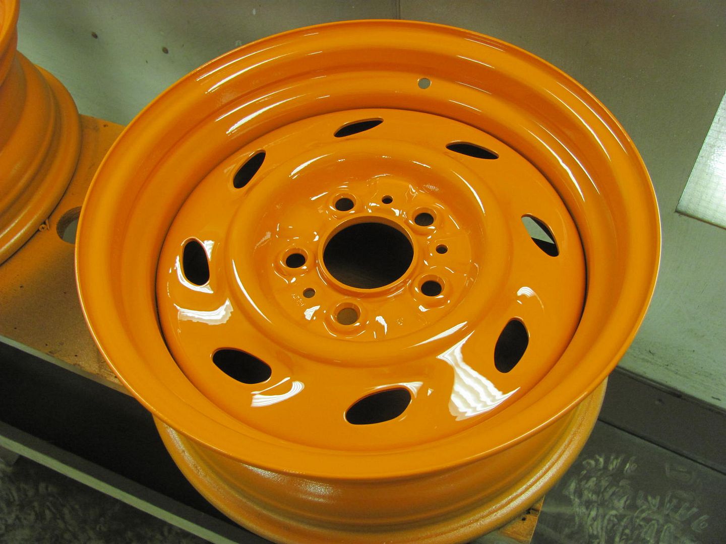

    The other day when we primed the frame a second time we also did the front side of the trailer wheels..
    and today I mixed up some Centari that has been sitting on the shelf a few years.. It sprayed pretty decent...
    And more blocking.....
