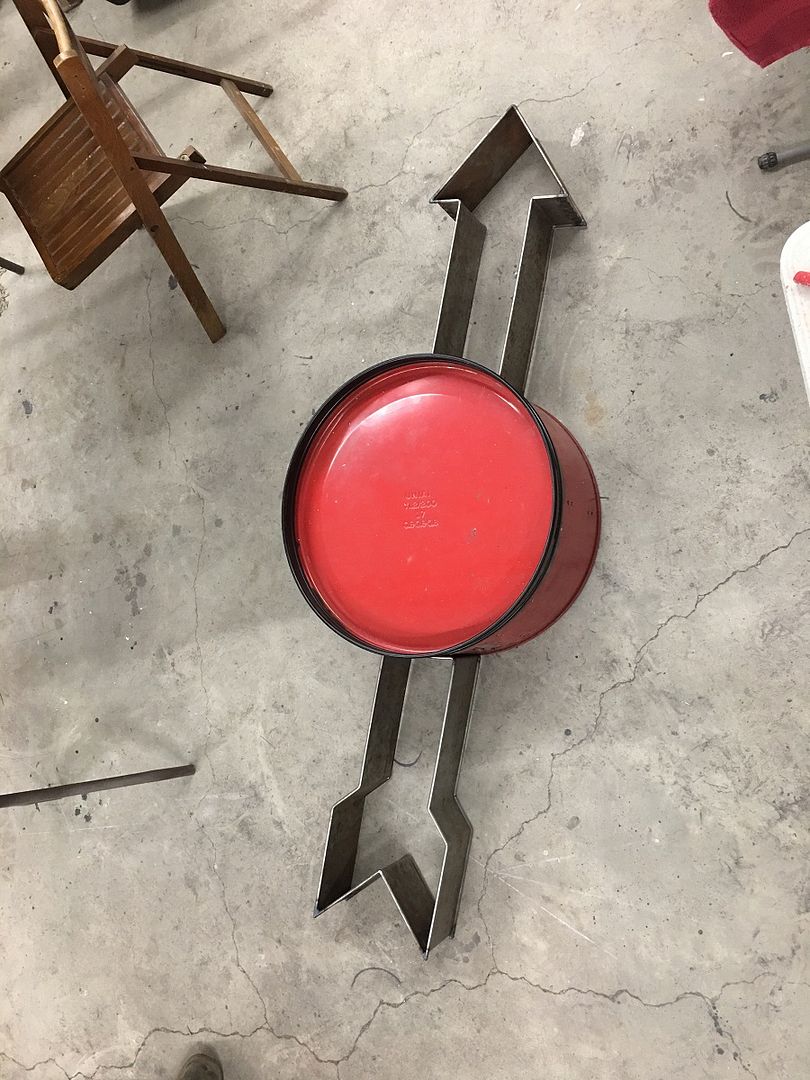

    Mike is still plugging away on the Drummer's Lounge sign.

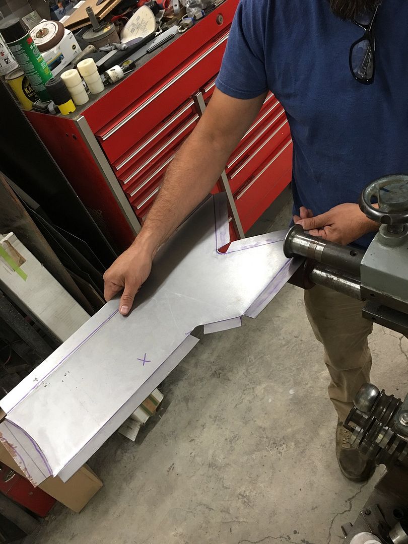

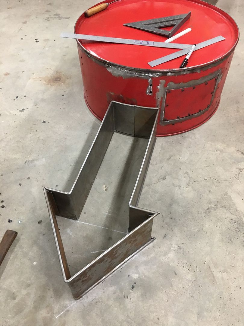

    Saturday he started fabrication of the insert panels. One side will be plug welded in place, the other will be removeable to access the wiring for the flashing lights.
    Tracing the first pattern onto some 19 ga crs, and adding mounting flanges.
    The bend lines are run through the bead roller with a tipping die into the skate board wheel to better mark the bend location. Makes it easier to locate the upper press brake die as it will fall into the indent.
    Since everything is a tool, and we needed to fold down a bit of metal in the inside corner, a piece of angle is chosen for it's inside radius match and a body hammer with a nice barrel roll on it does the trick...
    Side #2....

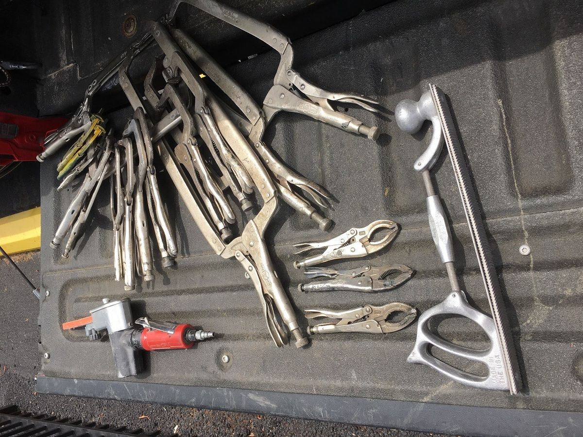

    I have a bunch of them that have been modified for one purpose or another. If you don’t have the tool, make it!! :D

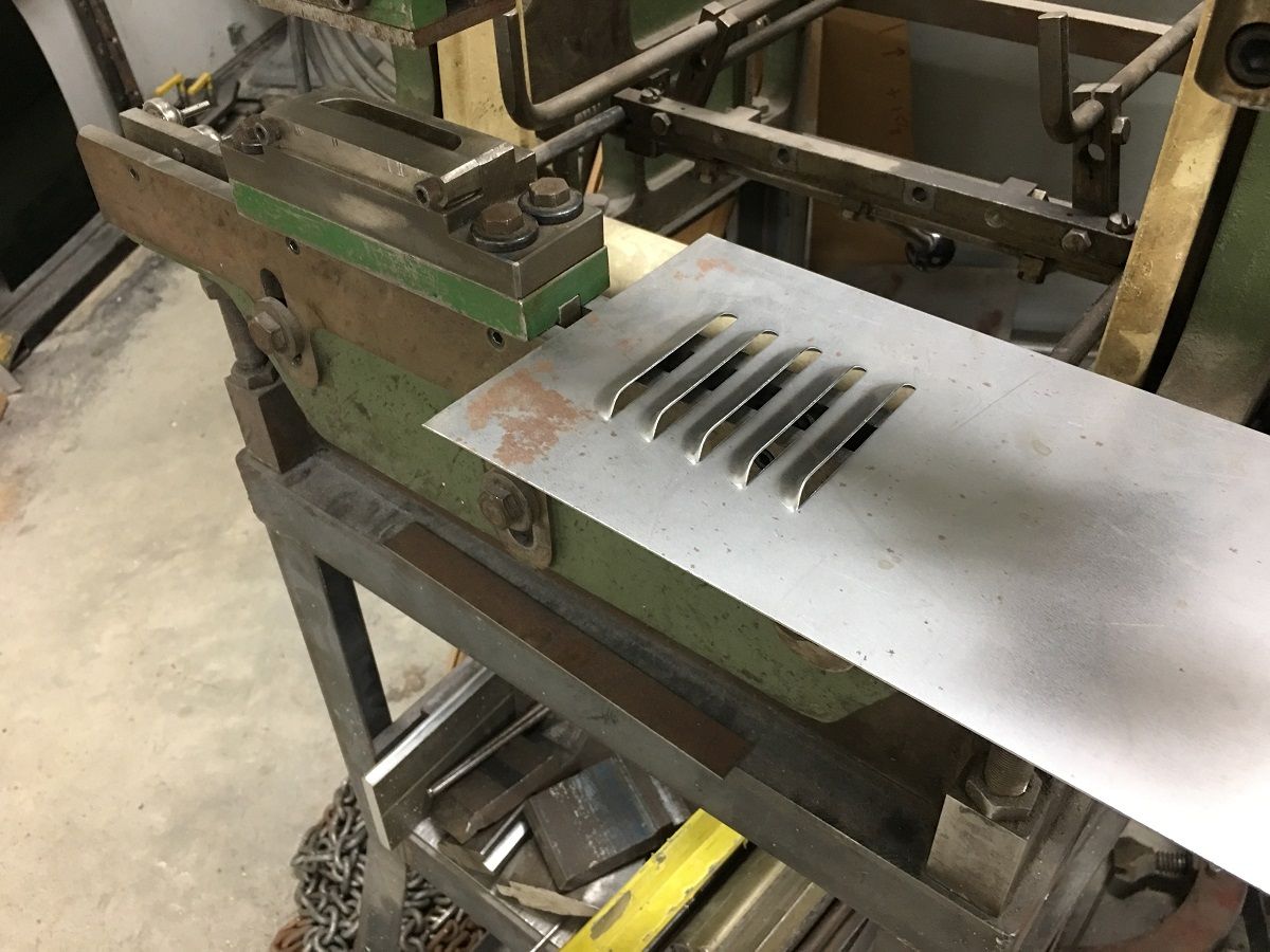

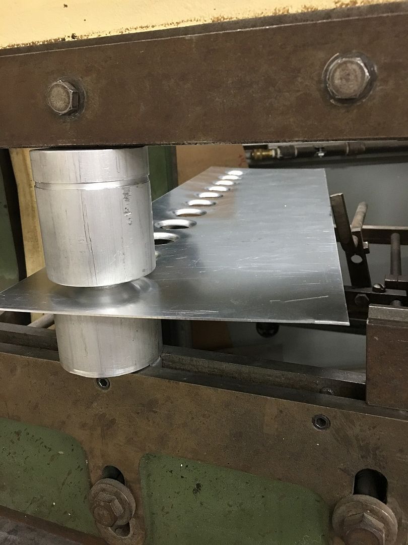

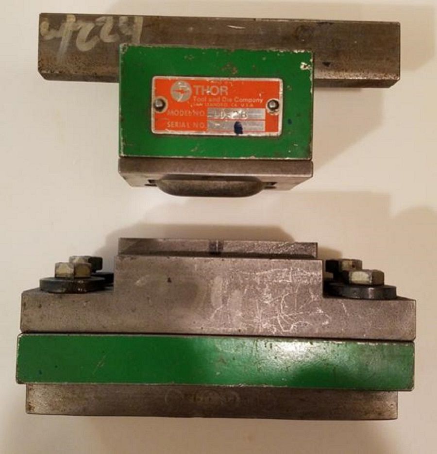

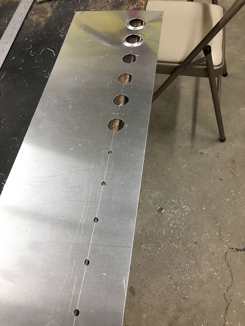

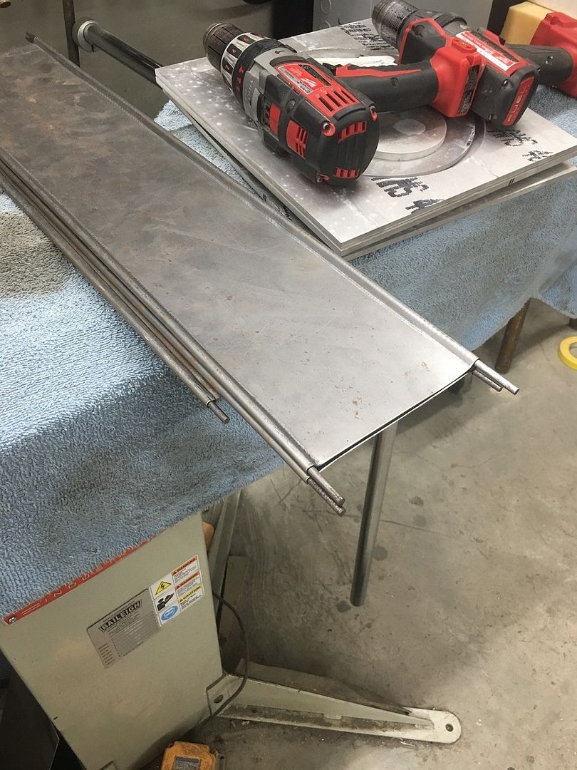

    I picked up some louver dies that are set up for the press brake but should be the start of a louver press eventually... got both 2" and 3" dies.
    I also have a couple good friends that understand my tool addiction that both sent me a link to an ad for body tools, especially for the Vise Grips. Here's what I picked up from a retired bodyman, now to keep these quality tools going. VG collection is now over 130.. never enough.
    ...and with the engine brackets back from powder coating, and our new 45* water neck arrived, we were able to get the belts and upper hose all mocked up. The hose we used was a Dayco 72384, made as a lower hose for a V6 Ford Explorer, but it fits this application like a glove...

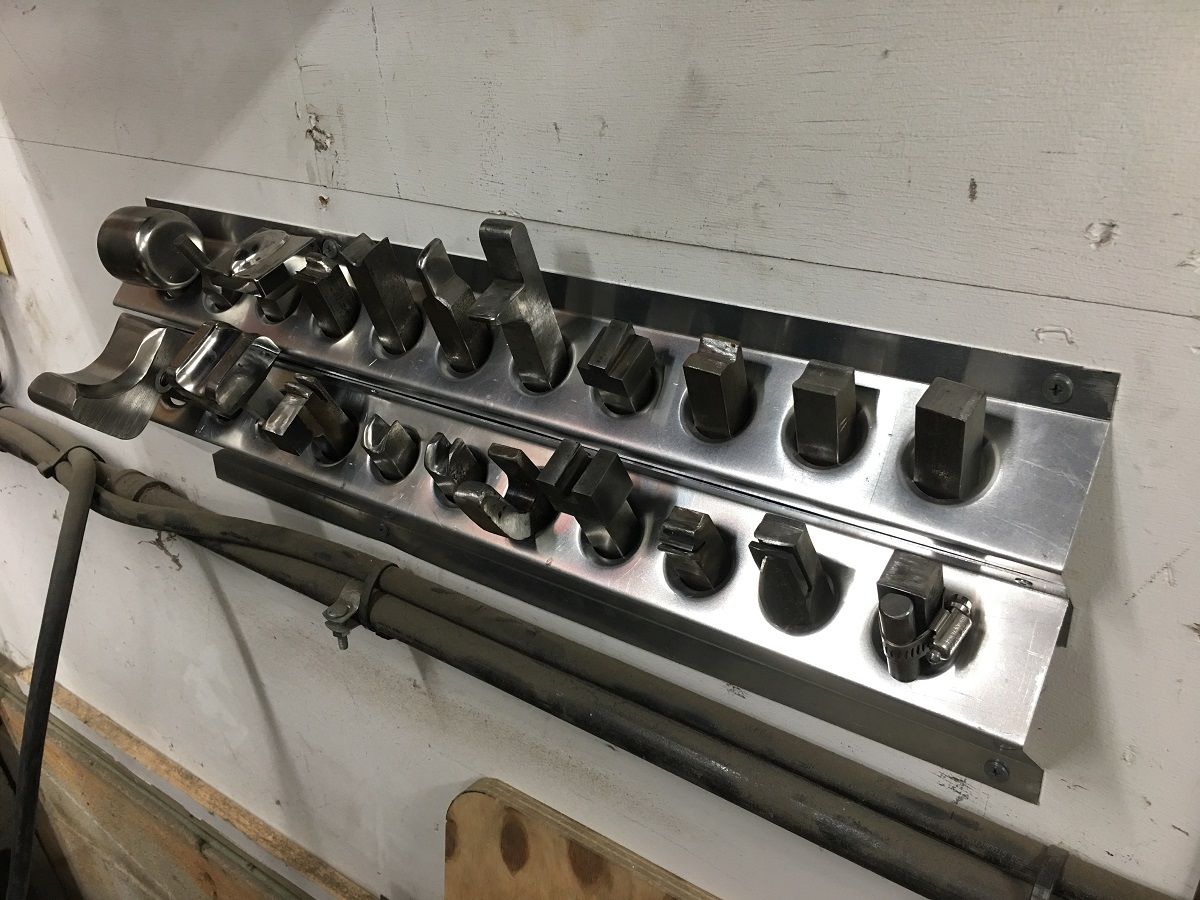

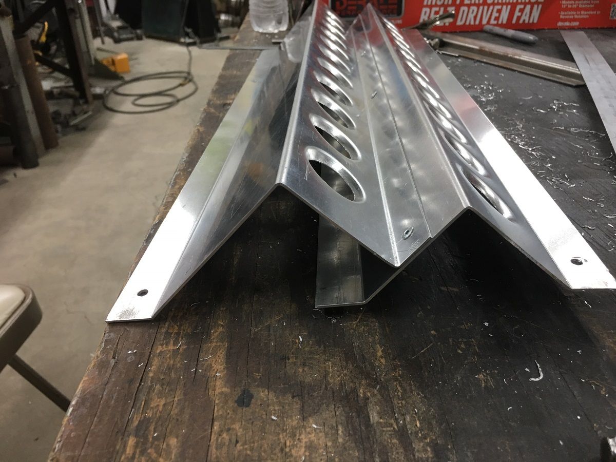

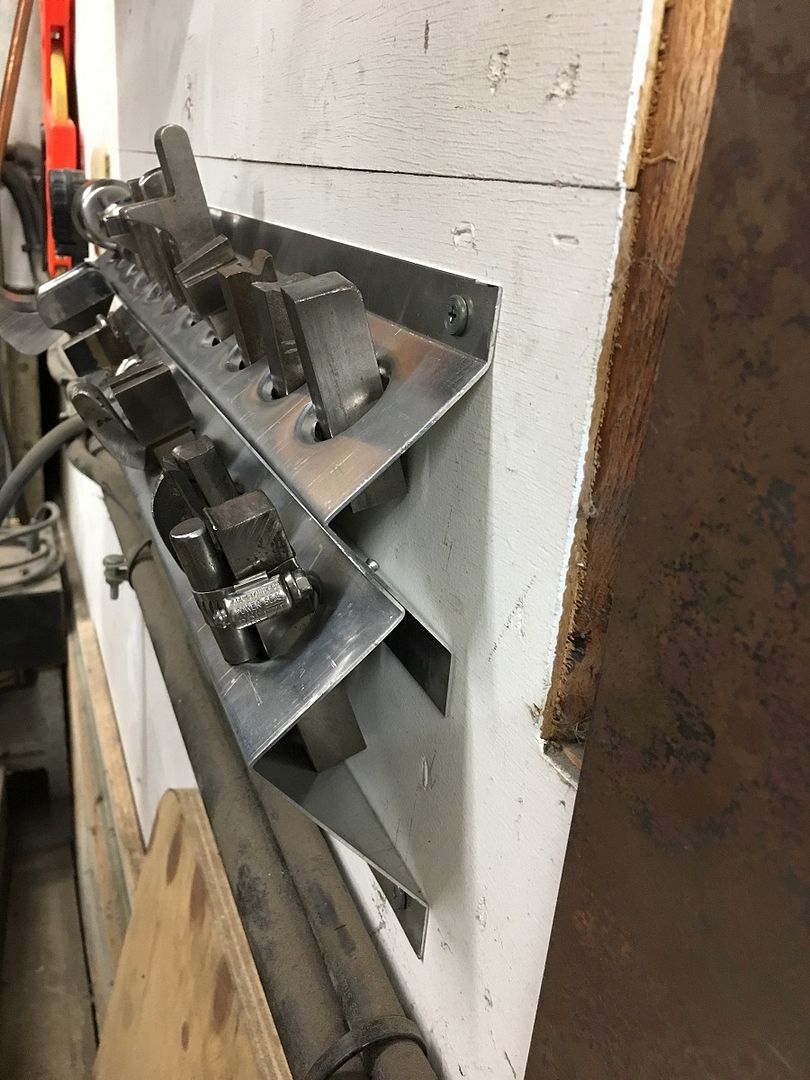

    Spent some time organizing, needed some racks for all the Lennox dies..
    One set down, two more to go....

    Mike has been plugging along on the Drummers Lounge sign, the arrow is close to done, it still needs fastening hardware added for the access panels, and holes added for the lights..
