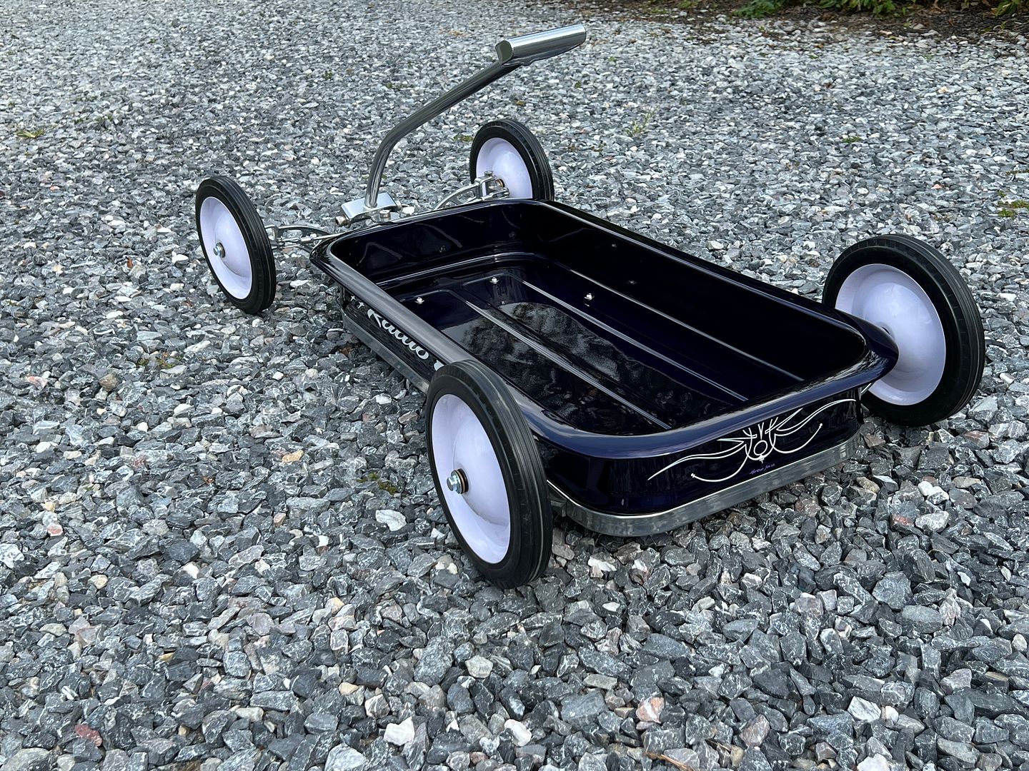

    We picked up the powder coated parts from The Shop at Shorty's, for re***embly we had ordered some replacement slotted oval head screws and square nuts in stainless so we could polish them up a bit for a bit of bling.
    And no job is complete without undergoing the close scrutiny of the quality control inspector...

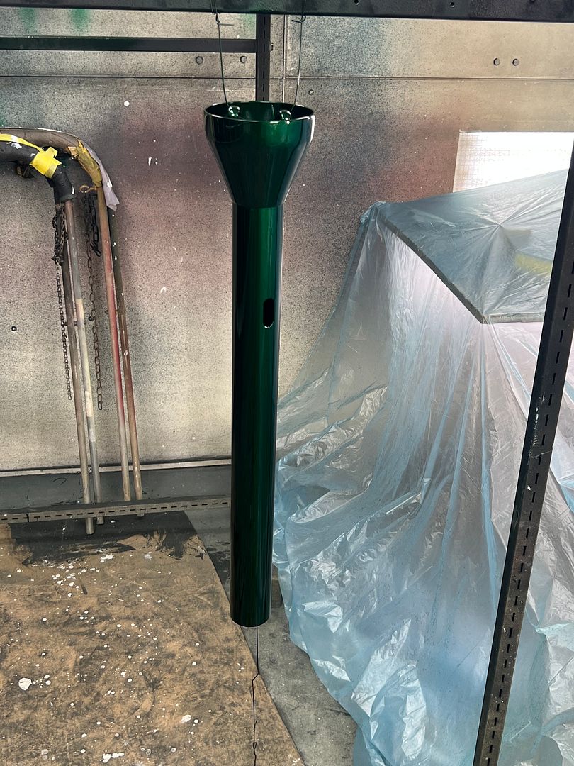

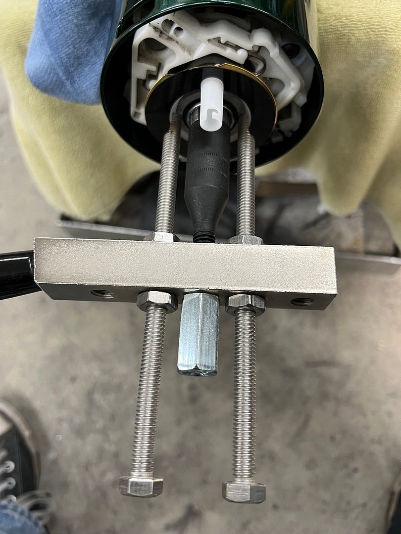

    Steering column one step closer to green paint...
    and blocked to 500 grit...

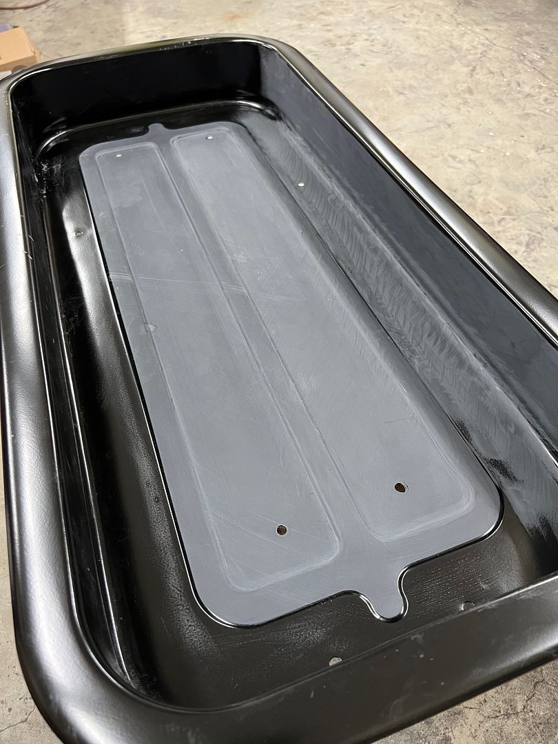

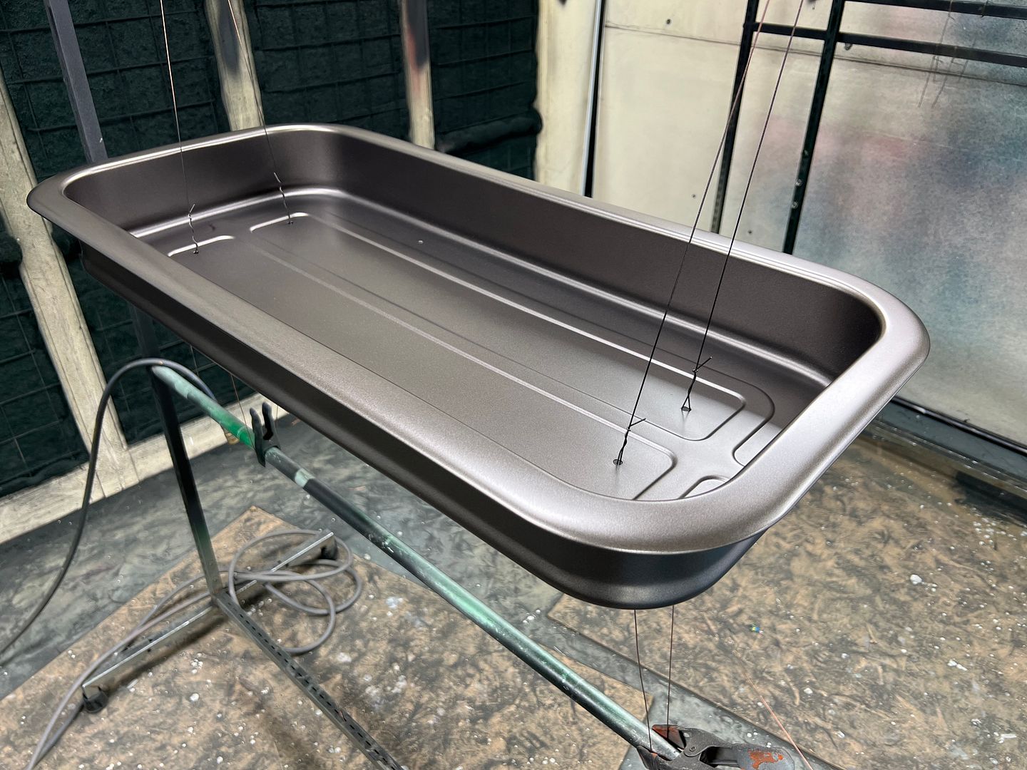

    And this is the second round of three coats of epoxy and blocking. Think this will be the last round, and then on to some silver base and blue kandy..

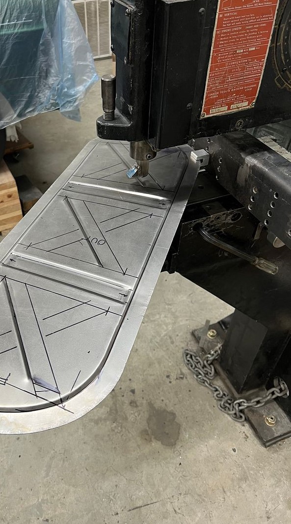

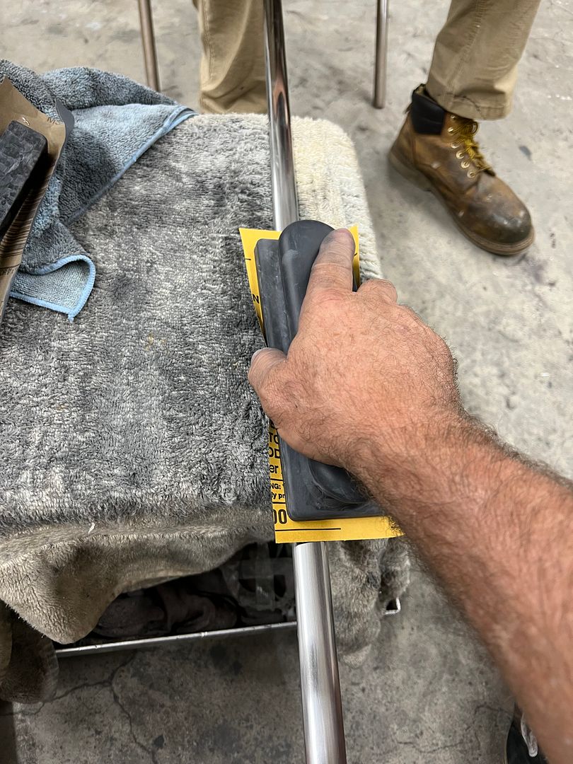

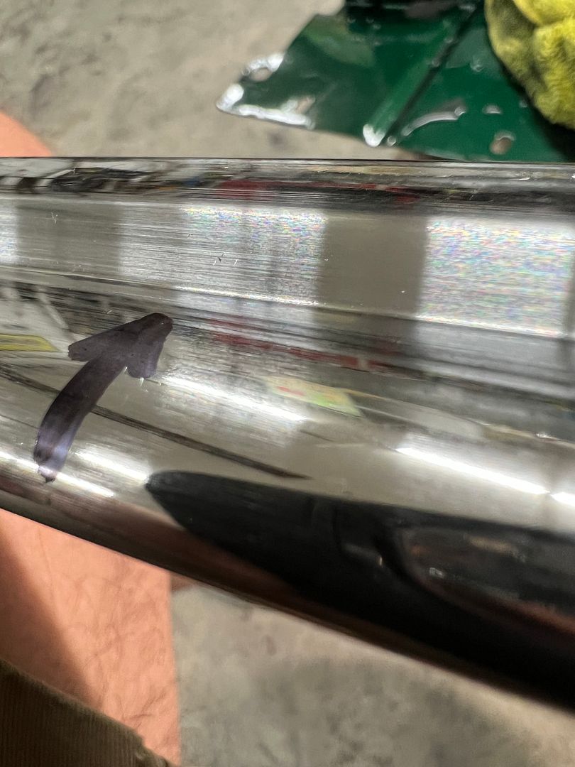

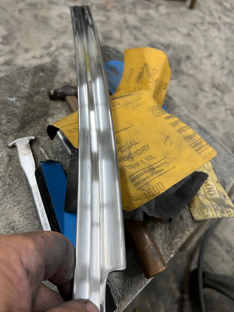

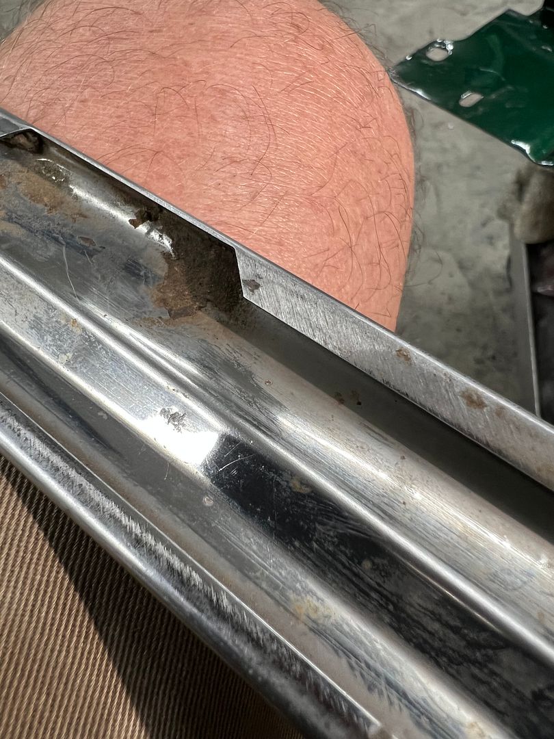

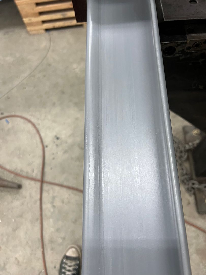

    More work on the wagons. Jared and I continuing to repair some stainless trim. I was asked about our process, so here's a bit more detailed approach. But understand we are complete novices at this, so take any of this with a grain of salt.
    To start, some light scuffing in line with 1500 grit helps to highlight any rock dings in the windshield trim..
    Once any defects are identified, they are LIGHTLY tapped outward from the back side to bring the defect outward where it can be removed. Then 400 grit is used to remove the defect (and by default some of the adjacent material). So we want the defect to be pronounced outward, but not too much. Better to tap it outward in repeated steps than to go too far and create a stretch. I missed getting a picture before we started on this "rock chip"; this was after a few p***es with 400 on the 3M board (just above arrow).. It was tapped outward about 4 different times until we got it where the defect was sanded out.
    Back side that was tapped....
    https://www.youtube.com/shorts/BdSQMh6MOTU
    After removing all the dings, the surface was sanded working progressively through grits 1200, 1500, 2000, 2500, and then on to 3000 and 5000 trizact discs on the DA. Afterwards it was polished out on the buffer...

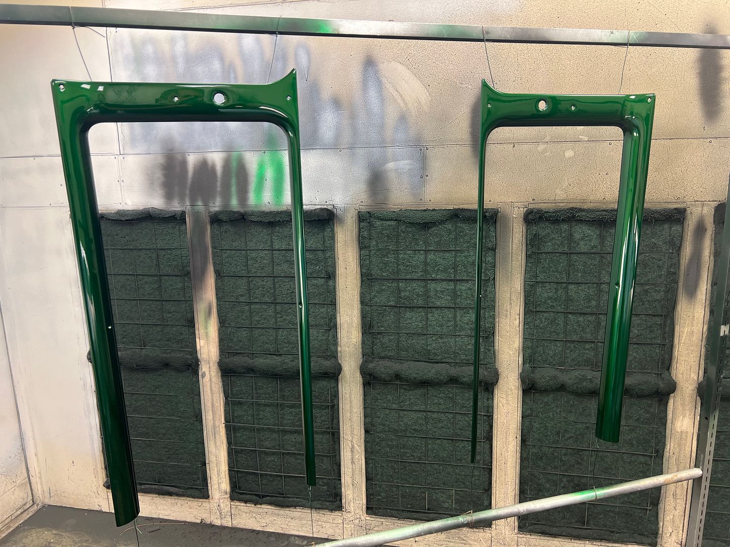

    Some parts painted green so we can continue with more ***embly...

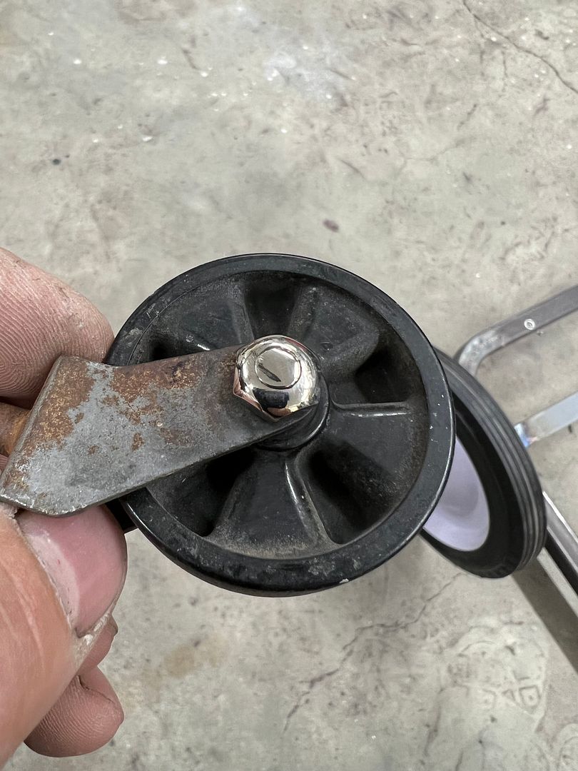

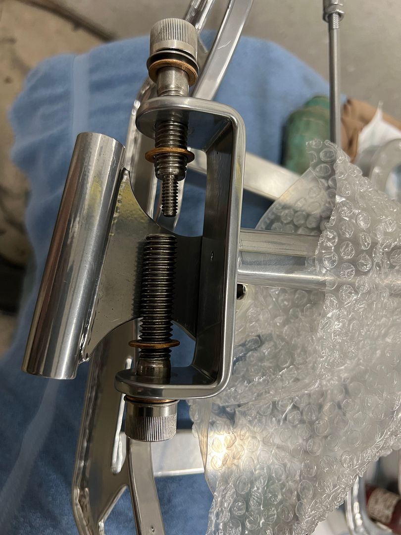

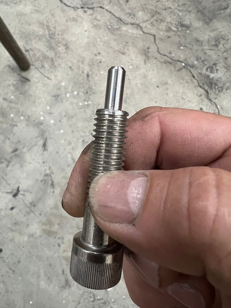

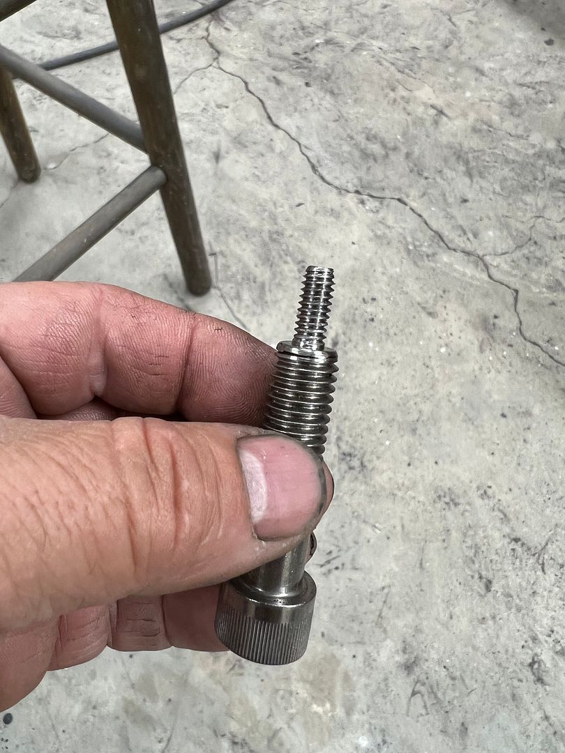

    When we had mocked up the wagon frame we just had a 1/2” bolt stuck through the bottom of the pull handle. Now that we’ve got the frame back from chrome powder coating, it’s time for some final details. The bolt for the bottom of the pull handle needs to be an Allen bolt to match our kingpins, and we need one from each side to be symmetrical. A little late to thread any holes in the pivot piece, so we’ll go with docking hardware. A 1/2-13 bolt was turned down for 1/4-20 threads, and the opposite one drilled and tapped.
    An allen wrench in the vise holds the bolt for threading
    Bolt for the opposite side...
    Frame is all done but t******* the axles, now to finish blocking the epoxy on the tub.

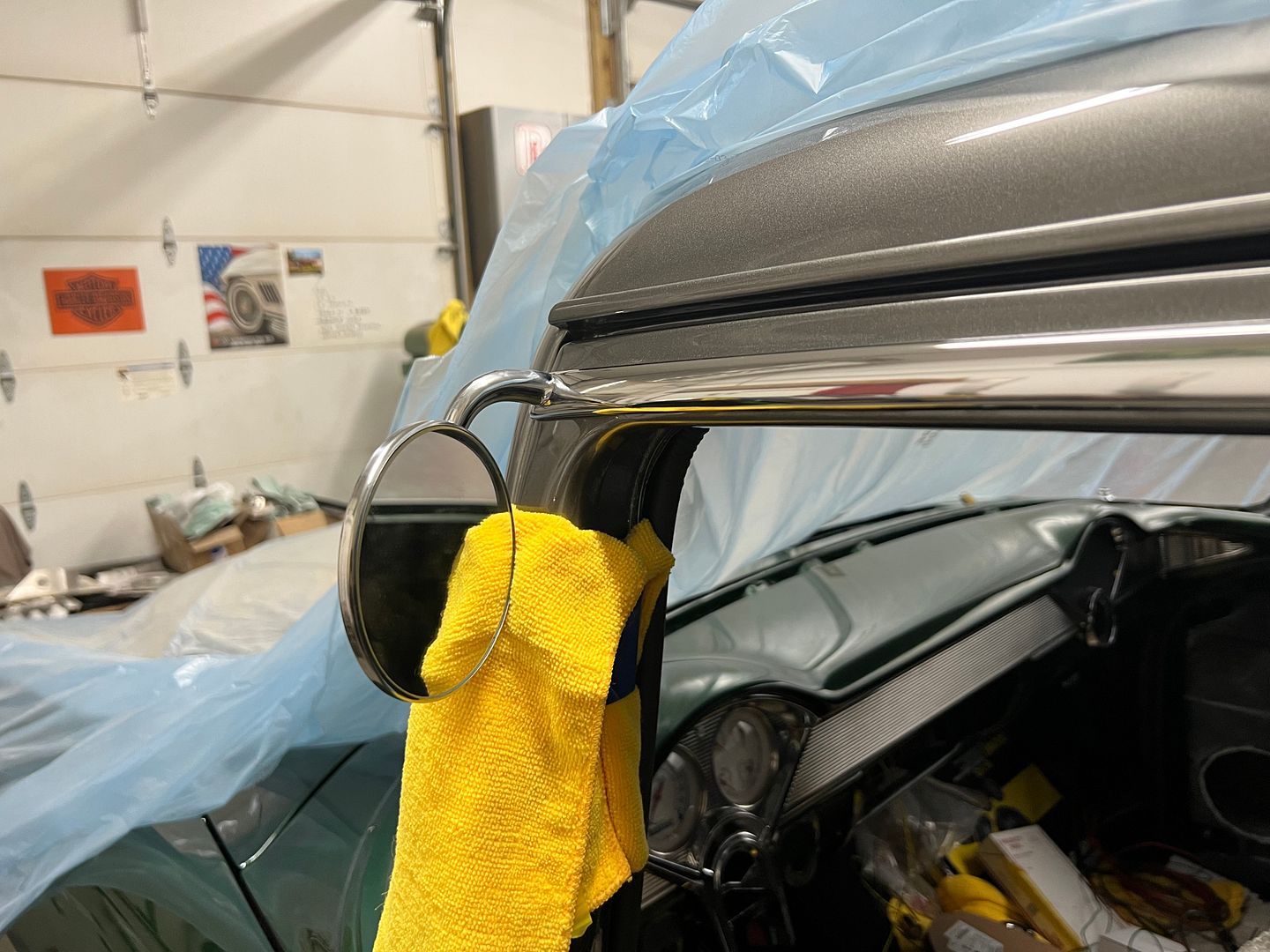

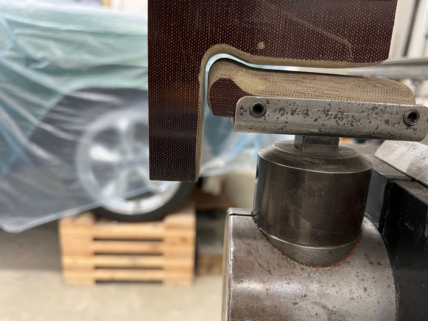

    Back to our stainless trim, we need to modify the upper door trim to hold our peep mirrors. We opted for the old school look of the peep mirrors but did not want to use the clamp on paint chippers. The front edge of the trim uses a machine screw through the door and into a nut plate. Our plans are to use a formed hole in the trim and use the hole in the door to attach the mirrors.
    As we had used the tail stock of the South Bend before with success, we made some press dies to match the mirror's stepped end and provide a flange in the holes for added strength.
    Trial test of the mirror, yellow rag hung outside the rear window for a more visible reflection

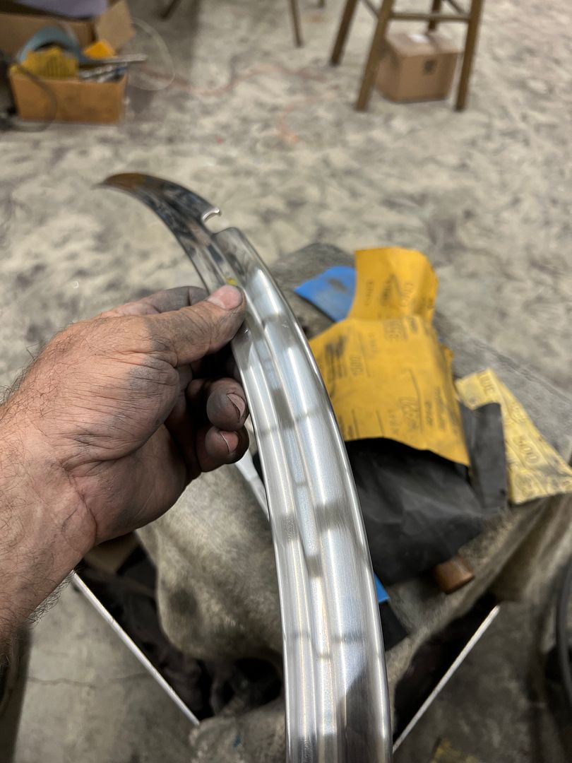

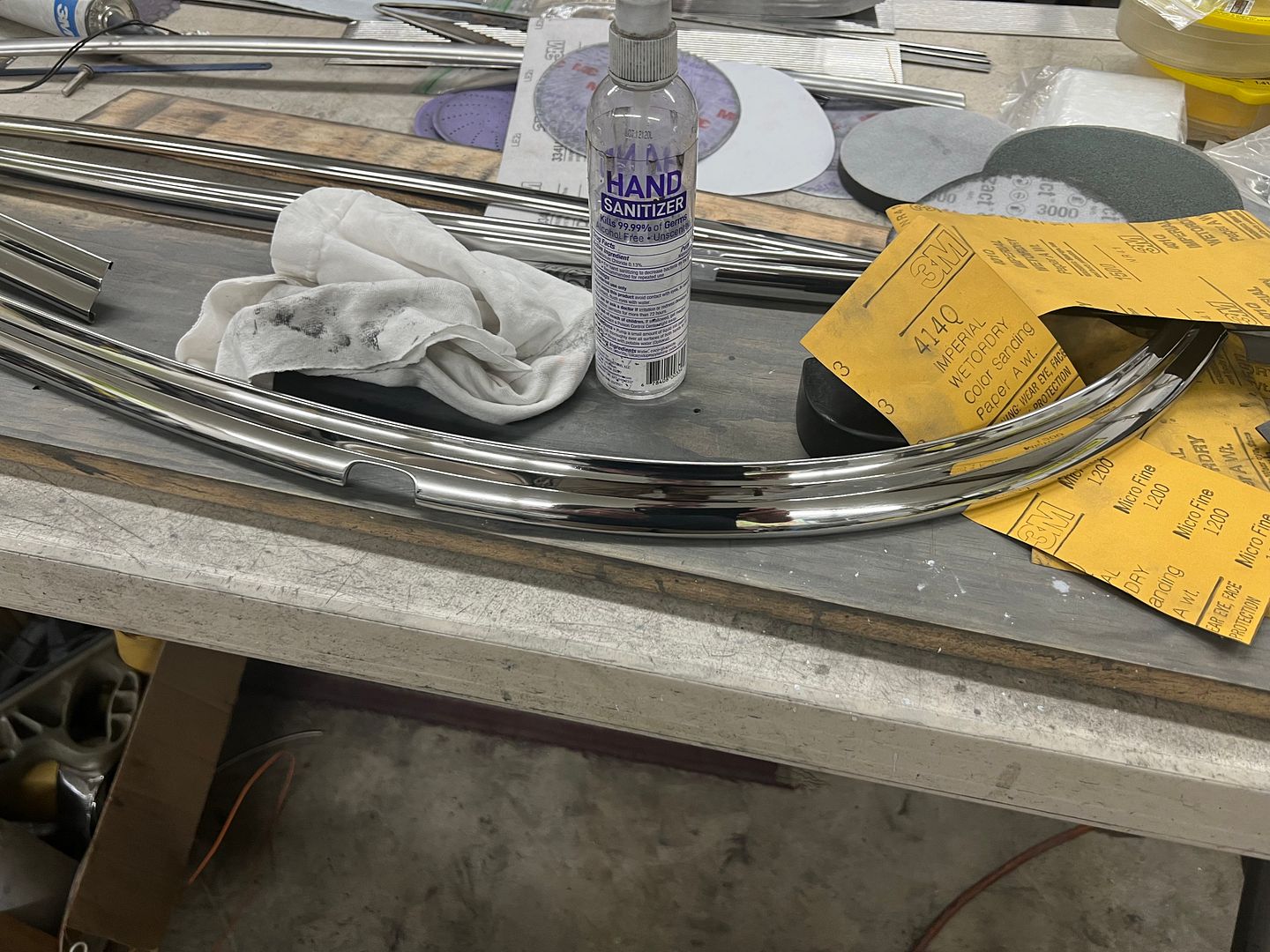

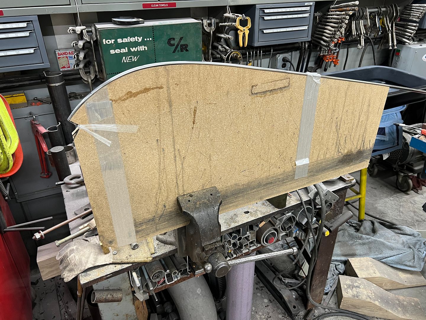

    Back on wagon duty, we've been continuing on stainless polishing. We had been doing some of the shorter sections by sanding on top of my 4 wheel shop stool as it has a nice flat top surface.
    Once we got to the longer sections of trim, this became too ***bersome, so some 1/2" MDF was repurposed as a "holding fixture" while we refined the damaged scratches and dings. A Black Diamond longboard was used with 500 grit PSA paper to highlight any low spots, high spots, or other carnage. Then some LIGHT DUTY metal bumping to address the issues and a repeat of the highlighting sanding. Once all the defects were addressed, we then worked progressively through 600, 1200, 1500, 2000, and 2500 w/d paper. Then 3000 and 5000 Trizact, and finally on to the buffer.
    A modification of our "fixture" to hold the curved end of the trim...
    https://youtube.com/shorts/tViITsStf_A?feature=share
    https://youtube.com/shorts/zYWU_zc4q1w?feature=share
    Jared helps out here to help stabilize the skinny trim and keep it from flopping around. Once quick mis-step at this point is about an hour minimum of recovery.

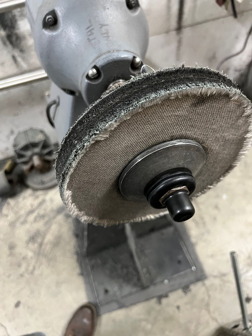

    Good extensions on the buffer shaft, I have to make up some for mine, which is a Baldor. Right now the wheels are too close to the motor housing. I wear gloves too, really goes against the spinning-object thing but better than a nasty *** slice on my hand.
    Stogy, lothiandon1940 and MP&C like this.

    Thanks for the comments guys. Rock, I like to feel the heat in the stainless to better gauge they all are getting the same amount. Yeah, sketchy **** does happen, but I have better luck with control when I can better feel whats in my hands. Bob, those shafts have not been extended, that is the length they came. Baldor buffer motors..

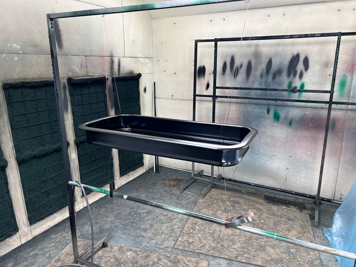

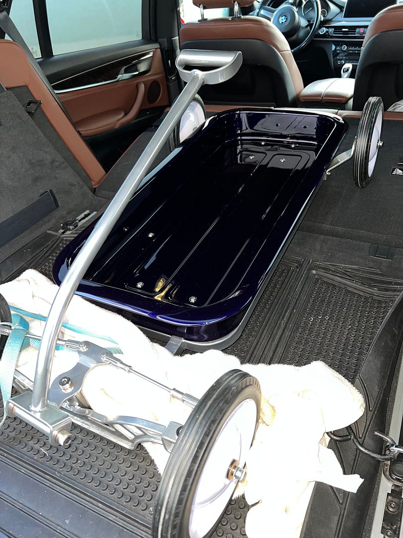

    Friday night was paint night. We started with a coat of SPI epoxy thinned for sealing, then two coats of Galaxy gray shimrin basecoat, then 4 coats of Cobalt Blue Kandy, and two coats of SPI universal clear.
    First coat of Kandy:

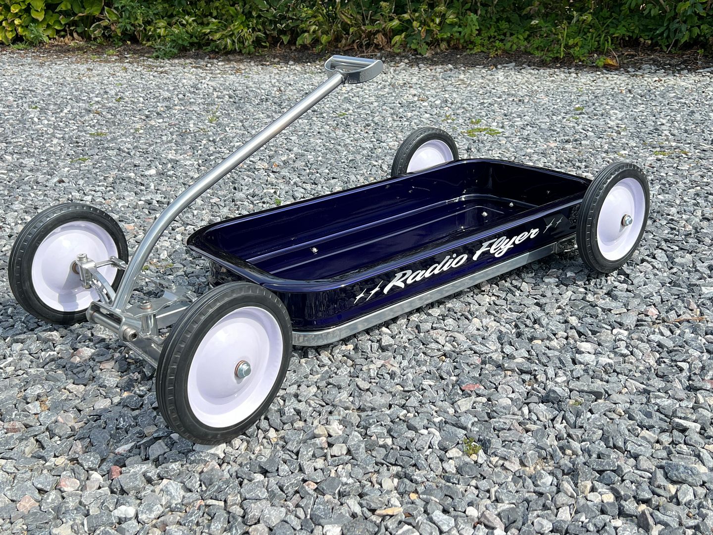

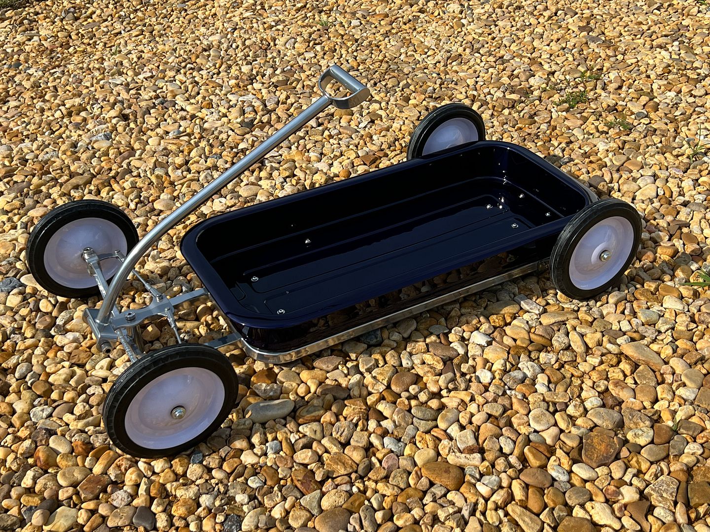

    It was loosely ***embled Saturday morning and carried into the sunlight for pictures. The low morning sun was not enough to wake up the metallic in the basecoat, and this looks jet black.
    A bit later, it’s starting to wake up the blue….
    After wagon ***embly and photo op, we did some more Stainless scratch refinement... Two long pieces left to go. and one on order. Dana had taken one somewhere for straightening, and the results left us with a wrinkle and a crack forming. So that one's replacement is on the way from The Stainless Shoppe.
    Jared putting the eagle eye on the remaining stainless to find any defects...

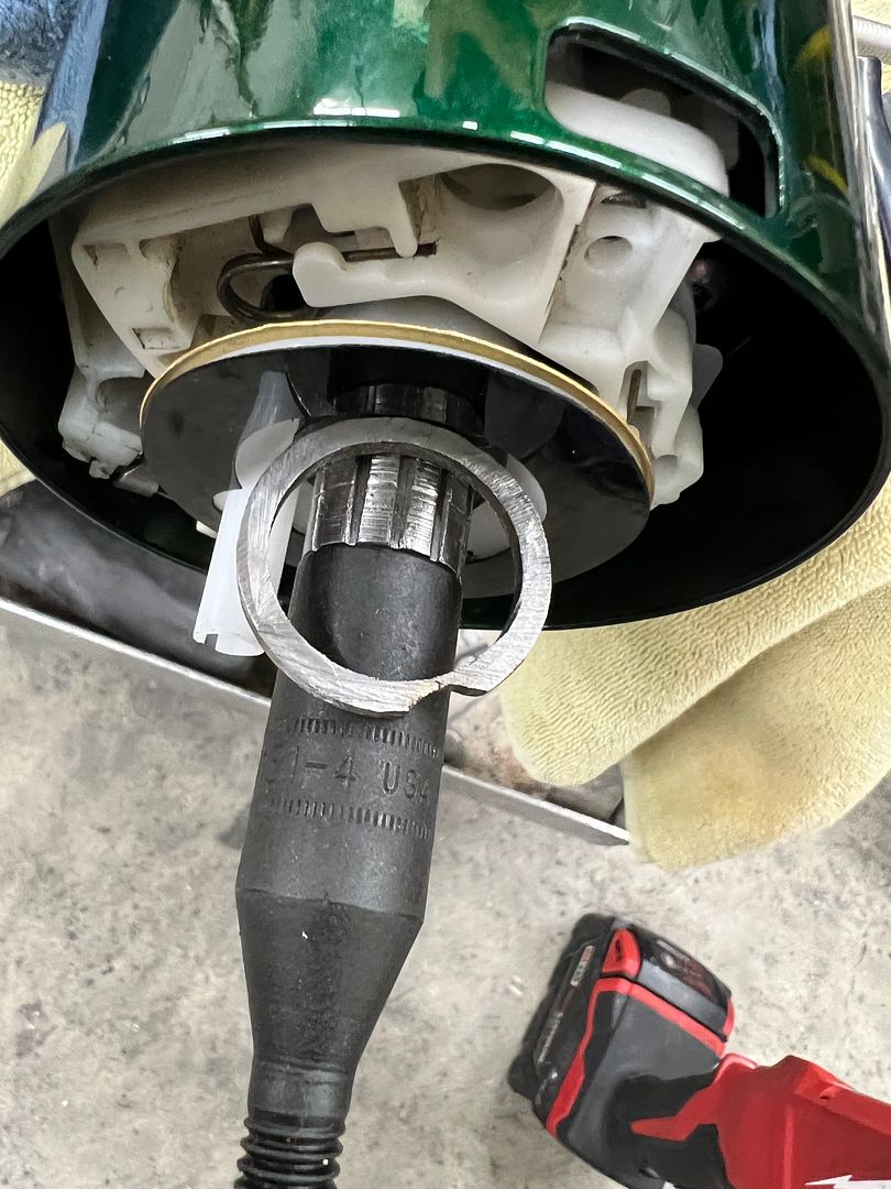

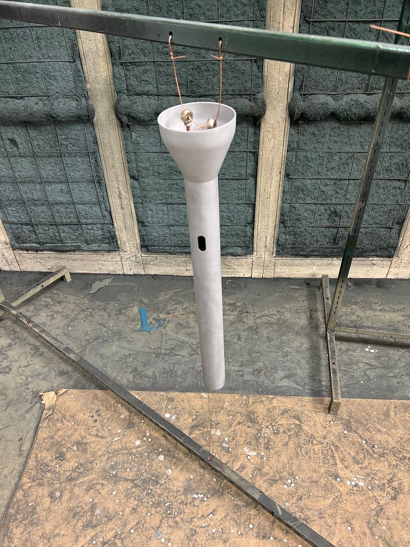

    Re***embling the steering column after painting...
    some heat shrink was added to the harness to help prevent abrading against the steering shaft. Our steering wheel puller kit did not have the needed parts for compressing the spring for the ts cam/horn ring, so we made a push ring and modified some 5/16 bolts for the cause. Much cheaper than grinding on the snap on parts.

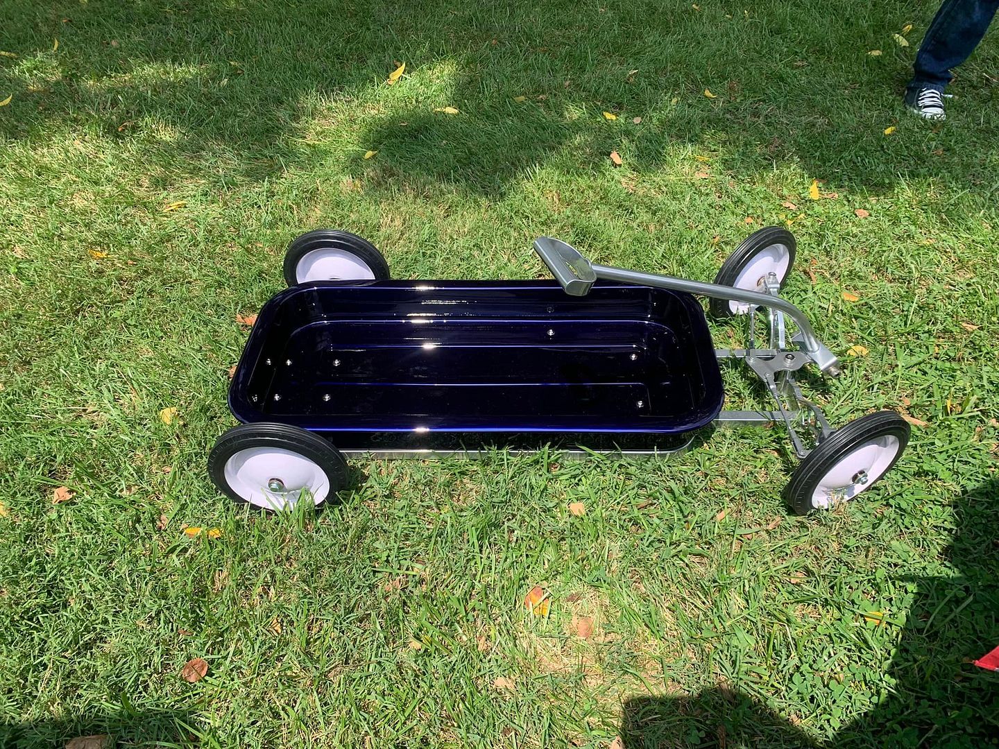

    Sunday morning we loaded up the wagon for it's maiden voyage, a shakedown run at Eddie's Brunch and Car Show, located at Bailey's Olde Breton Inn. This isn't a real large show (although it grows every year) but it's one of those must attends, and all the proceeds benefit our local Ho****e.
    Some takeaways on the wagon design, the pull handle length that was designed for a small child inside the wagon was too short for a 6' tall fella with a long stride. Felt like yap dogs at my heels [​IMG] . And I think the frame design may need air bags, where it did well on the pavement, there was quite a bit of drag (rolling resistance) with the gr*** up in the frame.
    *Car show pictures borrowed from FB

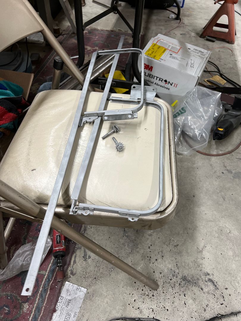

    Next, we attempted to install our vent windows in the "reconditioned" frames the owner had bought. Only we noticed they weren't so ready for installation...
    and bent...

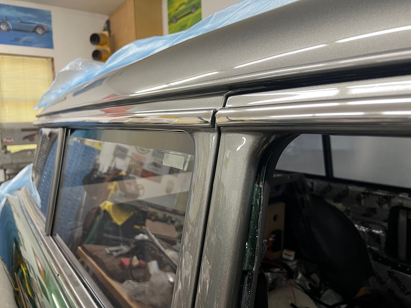

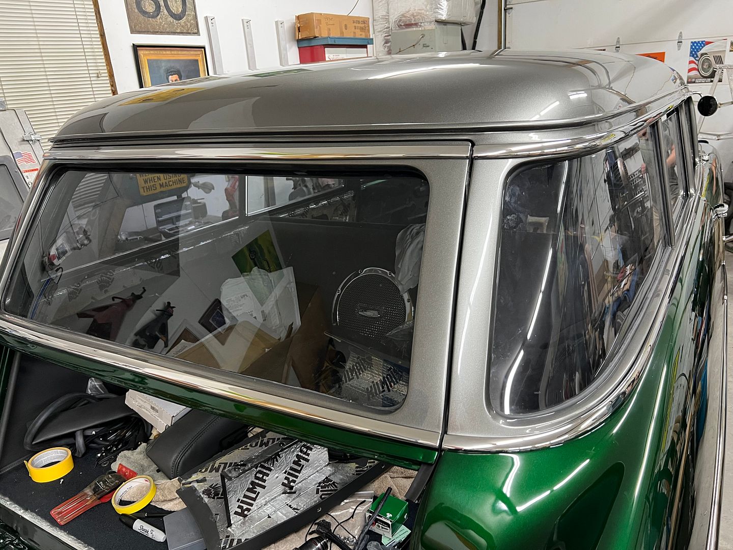

    Well, since we're on a roll, lets check the stainless trim that divides the vent and side windows. This had been "reconditioned" and included with the bent and cracked vent frame. Looks like they just polished up the dents and scratches. Not going to meet our standards.
    So we media blasted the original frames, which had no damage, and dropped them off at the Shop at Shorty's for a Cerakote finish.
    Inspecting the stainless trim, we found the originals to be less beat up than the reconditioned stuff, so we opted to straighten out the originals. Here's a comparison of the trim, the two on the left are the reconditioned that had been polished right over the defects. The two on the right are the originals, the left of the two has had any dings/dents pushed from the back in prep for our refinement process. (except the one up top I missed) The right one has gone through our w/d 360, 600, 1200, 1500, 2000, and 2500, all done wet. There are some minor scratches still, so we'll go through this process once more prior to buffing to make sure we have a flawless finish.

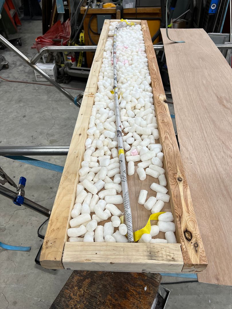

    And a helpful hint for those who dabble in polishing stainless. We've all had occasion where the stainless slips off the buffing wheel, bouncing off the buffer shaft, causing another 2-3 hours to correct. We added a rubber grommet to cover the nut and a plastic end cap to cover the threads. Less chance of damage from those mis-steps.

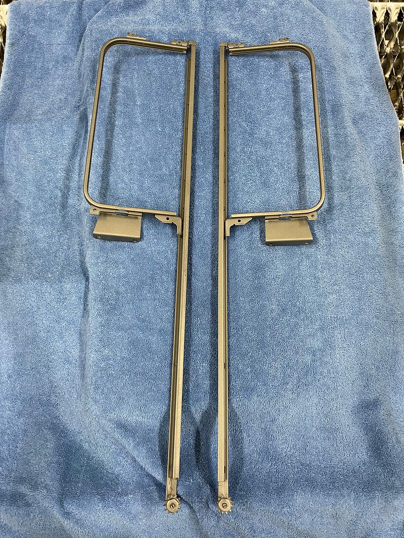

    Picked up the vent window frames from The Shop at Shortys, done in a Gunmetal Gray Cerakote finish.

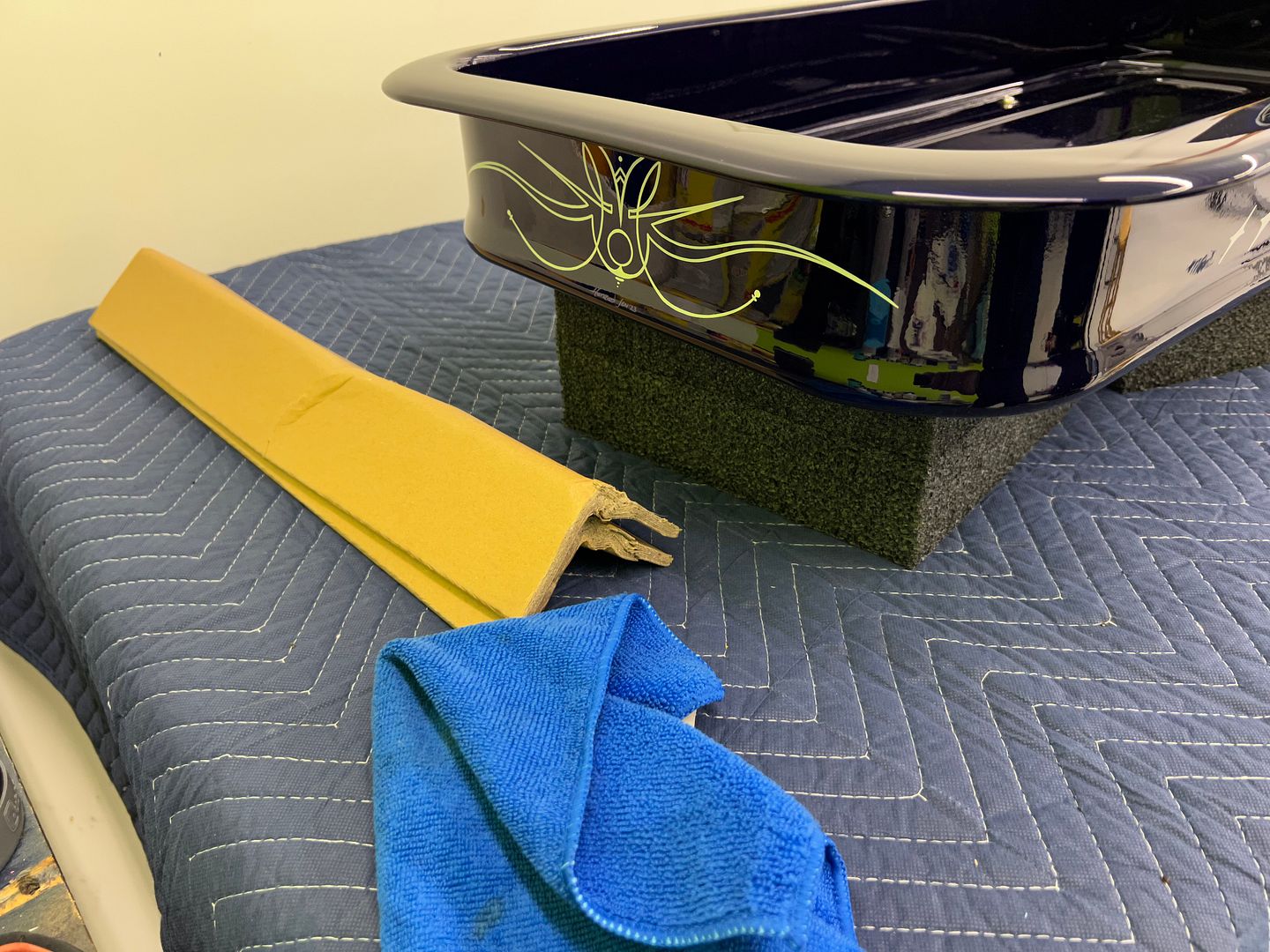

    Friday was our appointment for lettering the blue wagon, rode up to PA to HotRodJen's art studio..
    We opted for a script that deviated from the stock "decals", why hand paint something to match a factory decal? Let's go with looks fast while standing still...
    and re***embled for the trip home..

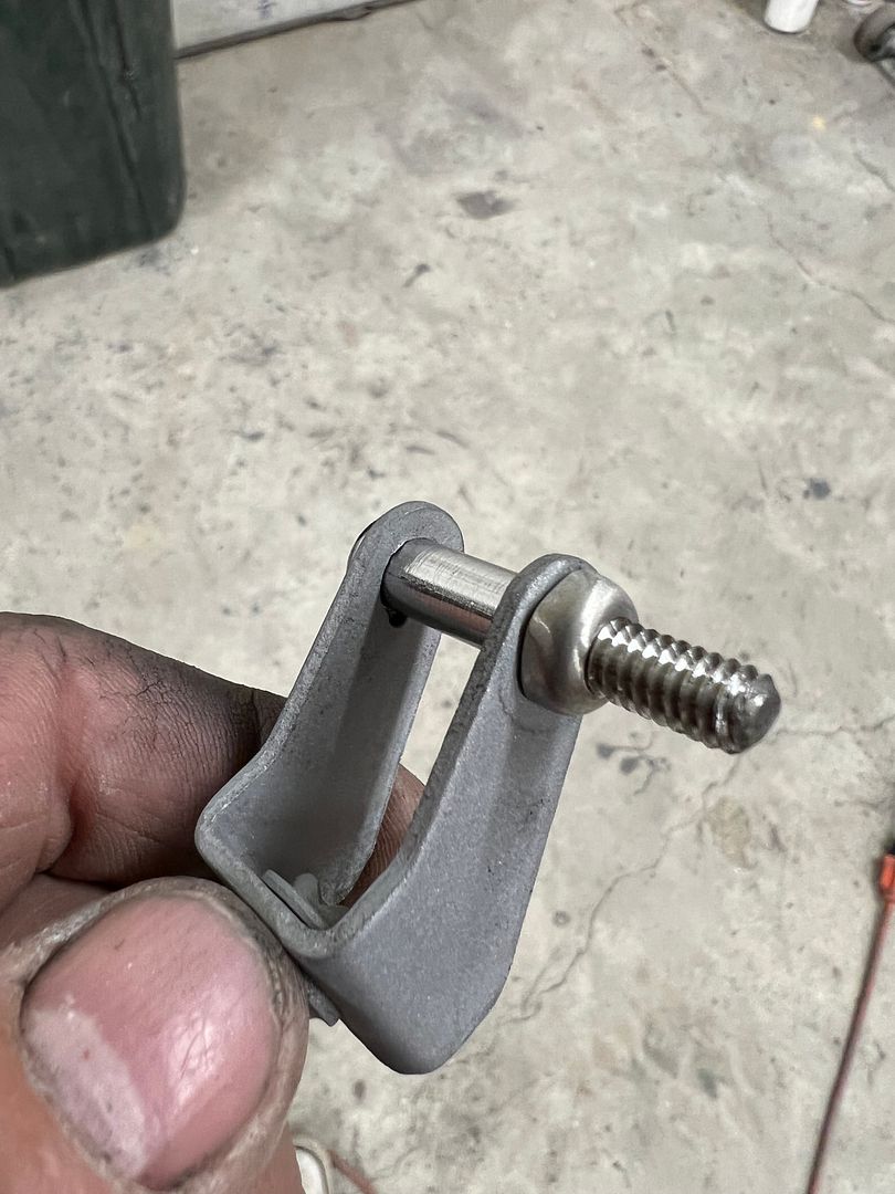

    Well in our typical back up and punt fashion, the original battery hold downs that we had already powder coated did not fit the battery, too short. So we ordered some round stock in stainless to fabricate some new ones.
    A threaded standoff was modified to provide an angled surface for using as a hammer form to get the bottom "hooks" consistent...
    All polished up...
    Installed, and no polish job is complete without addressing the ends of the rods..

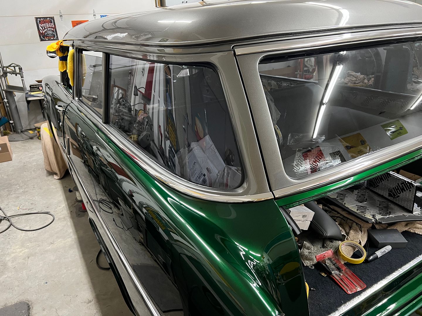

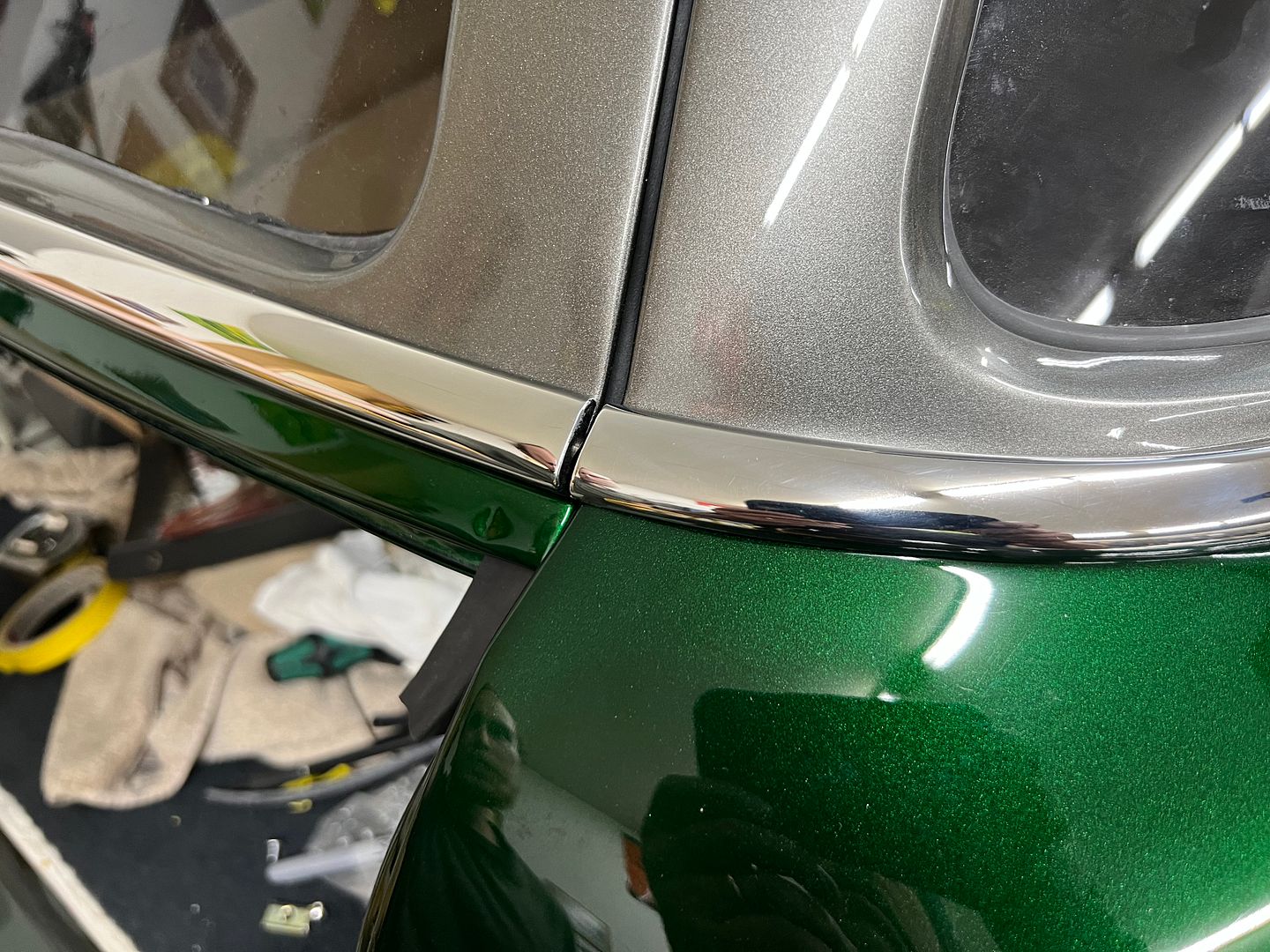

    We also got some of the stainless and chrome added to the front end. What an alignment pita that grill and surround is.. Still have some tweaks to do..
