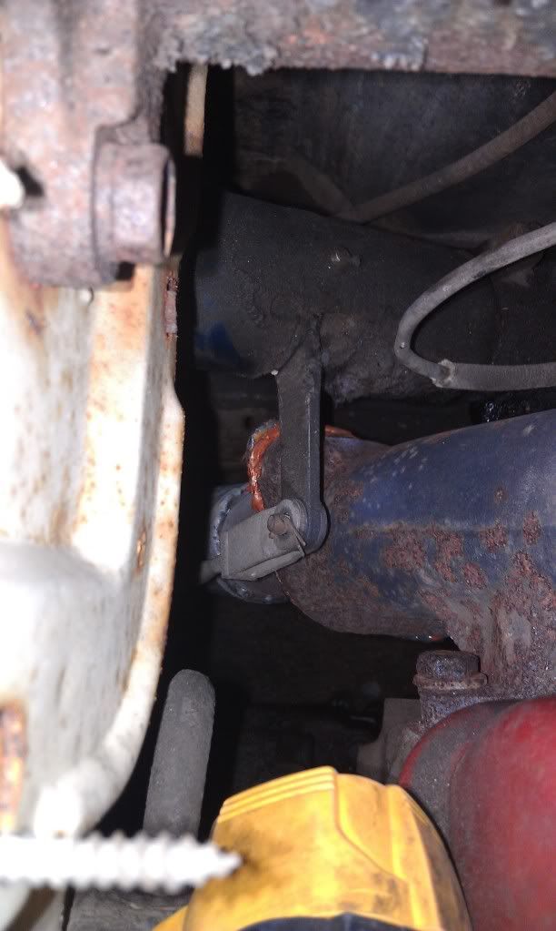

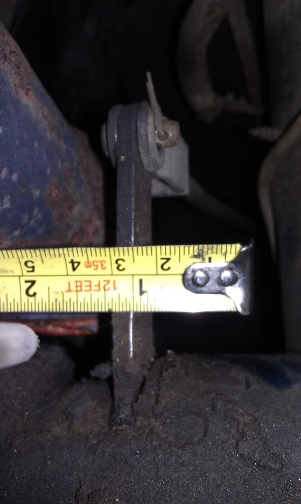

  11. Ficco55Merc
    Joined: Oct 4, 2010
    Posts: 41
    Ficco55Merc
    from Mass
    Just took these quickly in my driveway since i have the car home tonight. if you need more i'll take a better look at it tomorrow. The cars still hot and I'm half in the wrapper haha. Hope this helps
    appears to be
    3/16" thick
    3/4" width
    2 1/2" hole to column length
    5/16" hole diameter
