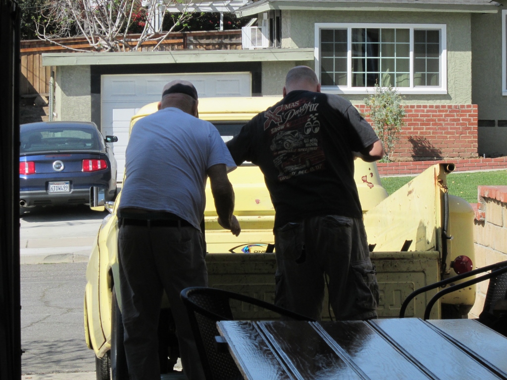

  12. tjet
    Joined: Mar 16, 2009
    Posts: 1,350
    tjet
    Couple of pics. My dad was telling me how to do it
