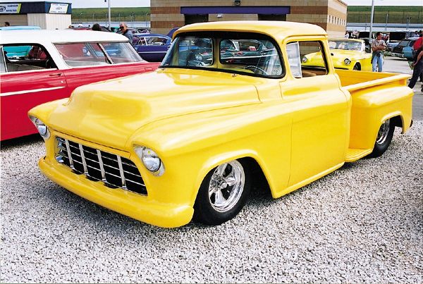

  8. You do -NOT- have to have a second roof on this chop at all.....Never do that on this chop....and cutting the gl*** first in also not necessary.
    I cut these often and even the big back gl*** model is completely doable [by sinking] that [rear gl*** only],the windshield was then cut to fit after the chop.
    I built this one in 2000 and it's roof skin is not cut on top of the roof-a 3" chop...

  15. 100% true. A good buddy of mine did one, and he added a front-to-back filler strip to keep the door tops and the windshield posts in the right vertical location, but you don't need a second top. Consult with a good gl*** guy before you start. If he's done this before, he might be able to give you some good tips to that'll help him when it's time to install the gl***. Here's the only picture I have of his '57. He chopped the top and shrunk the upper cap so it wouldn't look so top-heavy. He did everything himself:
