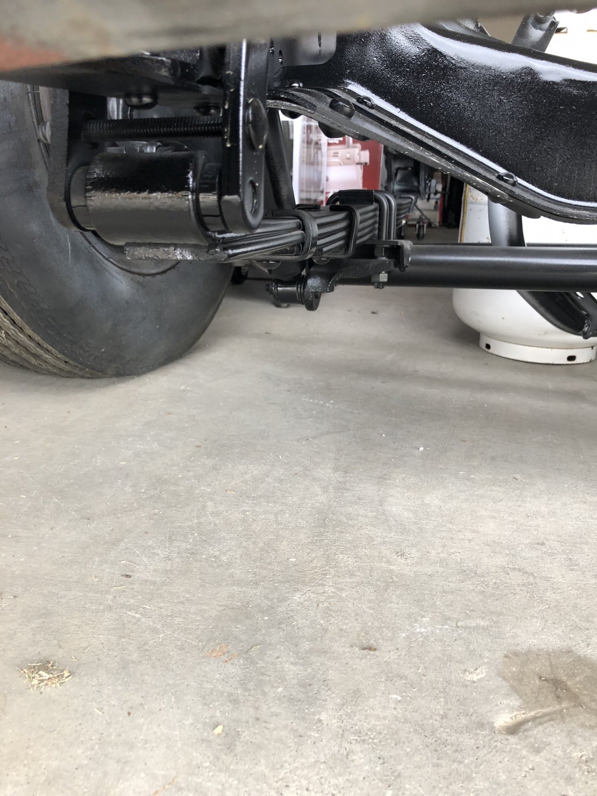

  6. Jeff56
    Joined: Jul 22, 2012
    Posts: 89
    Jeff56
    These are the springs. They are sagged more now from sitting

    from kcmo
    The springs are sagging too much and not doing any springing action.

  10. Those springs have no arch, so they can't work!! You need to replace those with stock-spec springs! Also, that looks like a manufactured 'dropped' axle rather than a Sid's dropped stocker. I would check that over very carefully for caster and camber. Good luck!

    Springs need to be re-arched or replaced. Spring liner between leaves will help once the springs are working. Sort out the springs then get a good alignment. Do you have the shims between the springs and the axle? They are used to set
    the alignment.

    as long as the springs are not bottomed out (hitting the frame or bump stop), they'll still work as springs...they don't know how much arch they have.

    guthriesmith
    Yep, a buddy of mine has an F1 with a dropped axle that the springs actually arch in the wrong direction. It does still rides pretty good too. :D

    Jeff56
    I haven’t had it aligned yet but I do have the 6 degree shims that Sod told me to use. The spring shop lowered my leafs 3 inches when they went thru them.

    These are the Posies front springs, no radiator, any fluids in engine/trans and no shocks, but you can see how easy it moves. Should do even better with the extra weight added.
