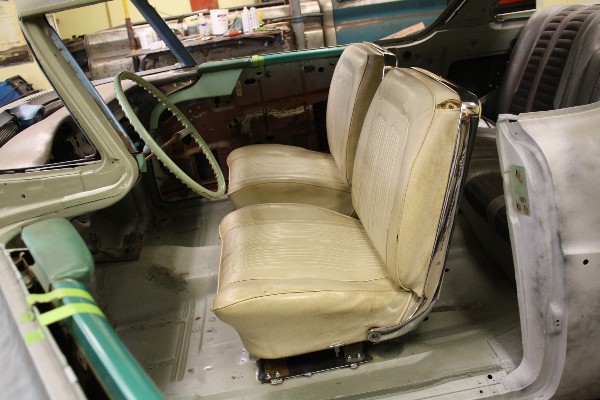

    It's decent. I don't know what the front seats are out of, but they're comfy. Dash was originally teal, its been painted black. Again the body took the worst of it, protected everything else.

    The seats appear to be 62 Impala. It will help to identify them if you post a more complete photo of them.

    I'm thinking Chevy II or Tempest seats because of the shape but no chrome.

    I believe you are correct. Looking at the photos again, you can see the p***enger seat trim is pointed at the top. 62 Impala seat trim does not go over the top like 63 and up but stops on the side and is squared off.

    64 era impala seats???

    Seats are 62-65 midsize GM with the spears on the side of the backrest. Impala 62-65 and all full size p***enger GM had the chrome all the way up the side and over the top of the backrest.

    Those sure look like it, thank you! My apologies for not getting better photos of them, I've been busy stripping old paint and primer. :)

    If the inside seat trim is painted, not chromed AND if the inside trim doesn't cover the seat back hinge (like the outside trim does... They are probably like mine. They are out of a Corvair. I thought my seats were from an A body GM also, but found out when I dis***embled them to recover them that the 64 Chevelle seat covers I bought wouldn't fit. The seat is actually a couple inches wider than the A body seats.

    Some early Nova SS's used the wider base GM bucket like the full size car but also did not have the chrome band over the top.
