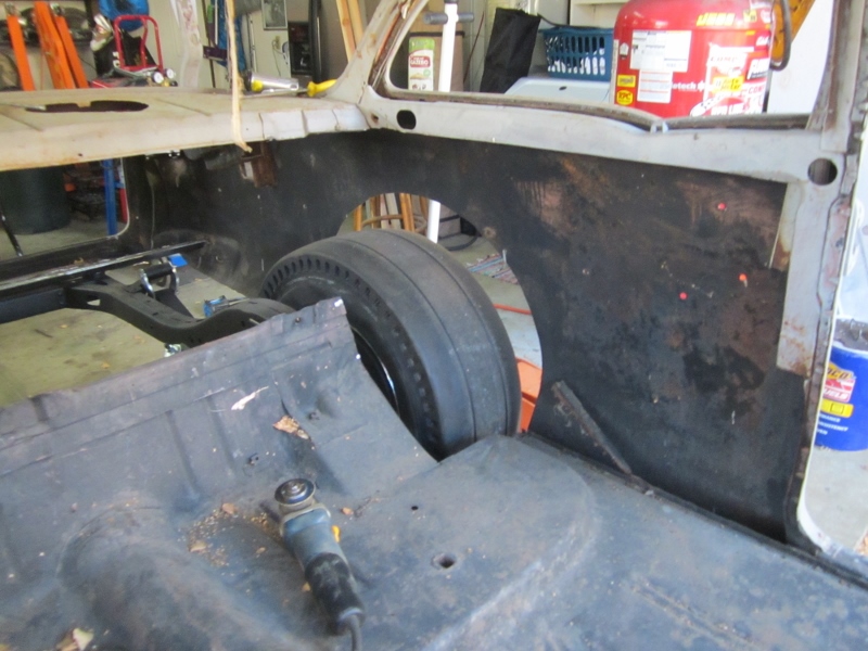

    Radiused the wheel wells yesterday. They are far from done, but merely a start so i can get a overall idea about the stance, and get to work on the trunkfloor..and some standard rust issues...
    Hoping to have the trunk floor and wheeltubs made in a few weeks, time allowing

    I got my 55 running about a year ago and really enjoying her. On the radiused wheel wells, we made mine a tad oval with it a bit taller than wide to allow for ch***is squat. If we drew a radius from the axle center like you did, the distance would be equal around the tire and not enough vertical clearance - if you go taller, then the sides will have too large a gap. As it turned out from a video at Eagle Field, car barely squats so no clearance issues. ;)

    if your ch***is works you get separation ,not squat...

    Understood... if it expands, it still has to compress. What happens when one pulls a wheelie? :confused: Whichever direction, it needs ample clearance for rebound.

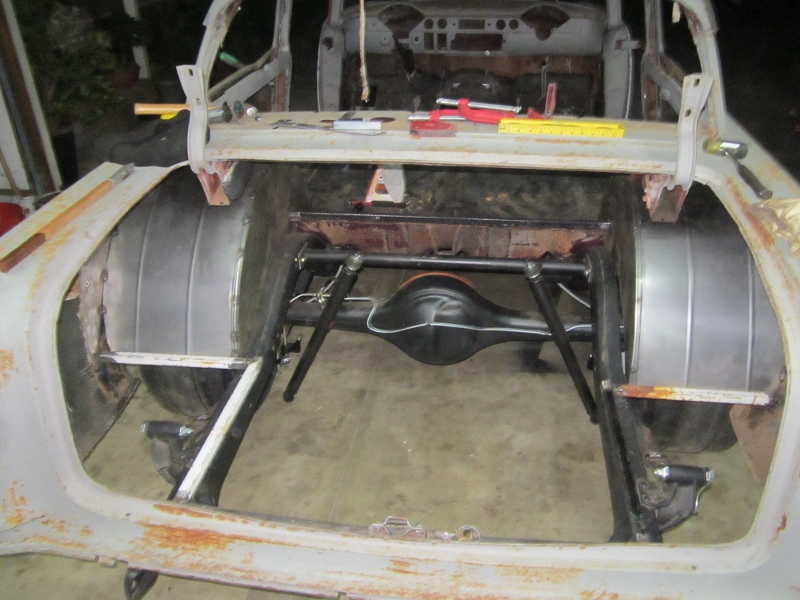

    Started wrestling around with the wheel tubs purchased from Summit. Not the easiest thing on the planet to measure and cut so they'll fit smoothly against the fender. Lots of patience and a weekend later i am at least on the way. Next step will be to make the mounts for both battery and fuel cell.

    looks like the rear has settled some or have you used the cement bags in the trunk (my personal favourite) to get and maintain ride height?
    I love Tri-5's done this way!! Cool choice in wheels/tyres too btw

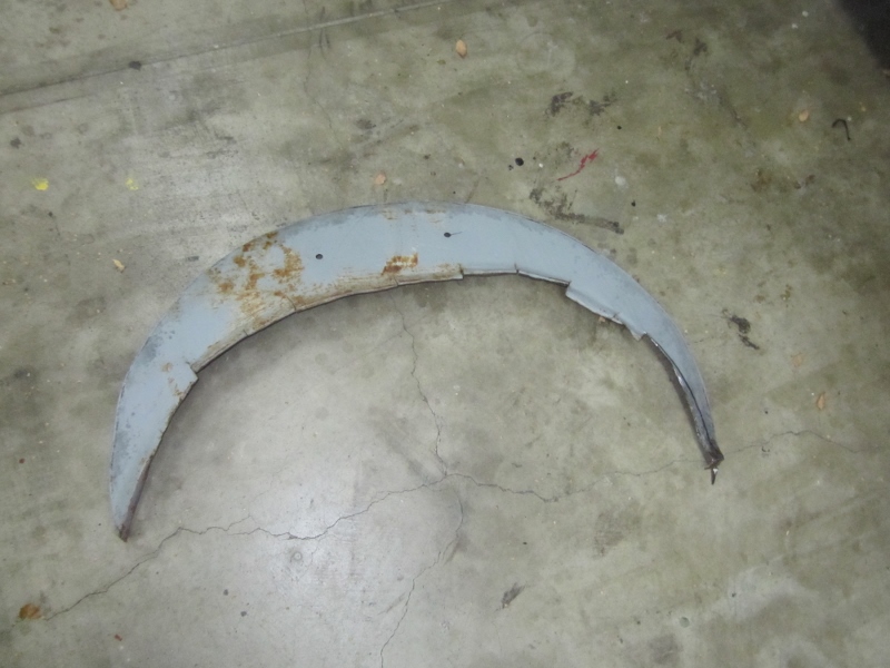

    next time try fabbing the wheelwells using cardboard to form patterns. Then transfer the patterns to the sheetmetal. Saves time and sheet metal...

    Yes, that could have been an option, but this was fairly simple too and worked out just fine. Moving along....
