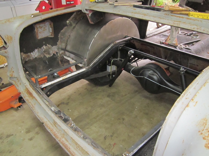

    Bending up a edge on the wheelwell radius will avoid cut tires also. Depending on whether you want a bead to show outside, or keep the wheelwell flush, it can be done inside or with small 1/4" round stock on the outside.
    This is what I did on my Austin when I radiused the rear wheelwell. This was taken early on before I did the rear suspension, so not sitting as low as it ended up later:

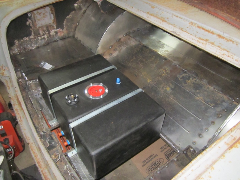

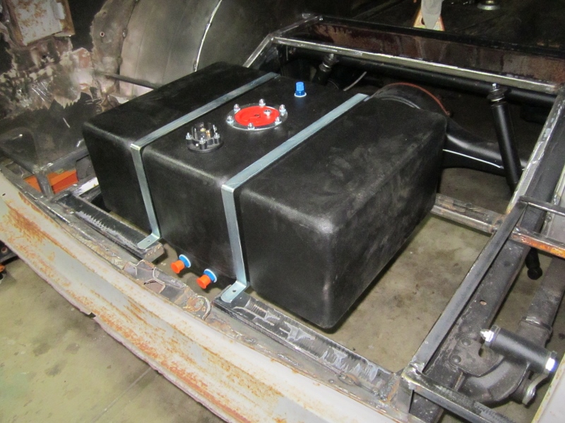

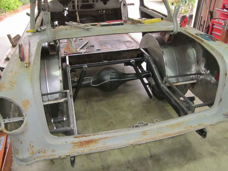

    Finally found some time and started on the floor structure for the trunk area. Got most of it done, and will make the battery brackets today. After that is done, i will get the bead roller out and start laying out the sheet metal. After that i hope to be able to finish of the wheel lips and openings.

    Hoping to get going on the trunk floor this weekend. Simultaneously i am working on a -61 Ranchwagon that's stealing some precious time.
    My goal is to have the -55 body at the paintshop around late March . Before the body comes off, i will install a dual mastercylinder, and figure out where to run all the brake lines, and fuel lines. Patch up a few spots in the floorpans, and finish the radiused wheel wells. I will keep the outside flush, i kinda like that raw look. Getting some good ideas for hinges for the tilt front, and will also have to straighten the front end up as the top part is sagging a little. Some re inforcement plates will have to be molded into the top from underneath. Also trying to make up my mind if i want a scoop or not.....Fun problems!!

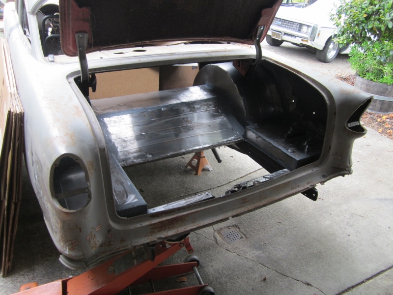

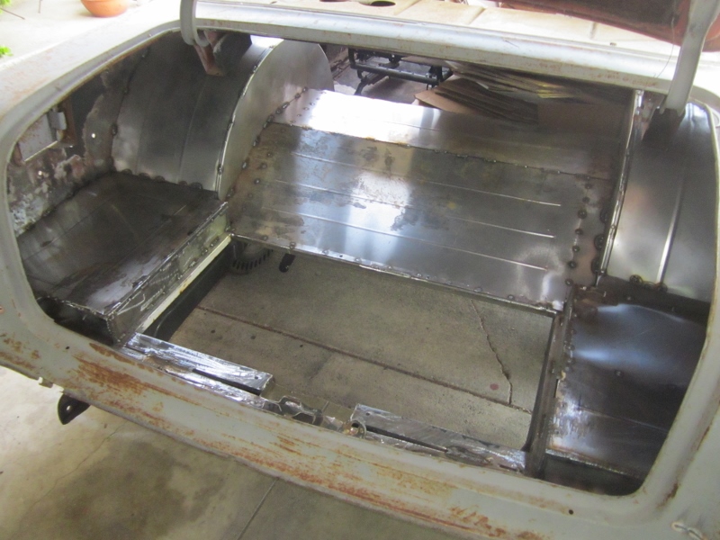

    Finally got a little work done, in the trunk area. Super simple tools rules..
    Finished sealing up everything last night, in the trunk and wheel wells.
