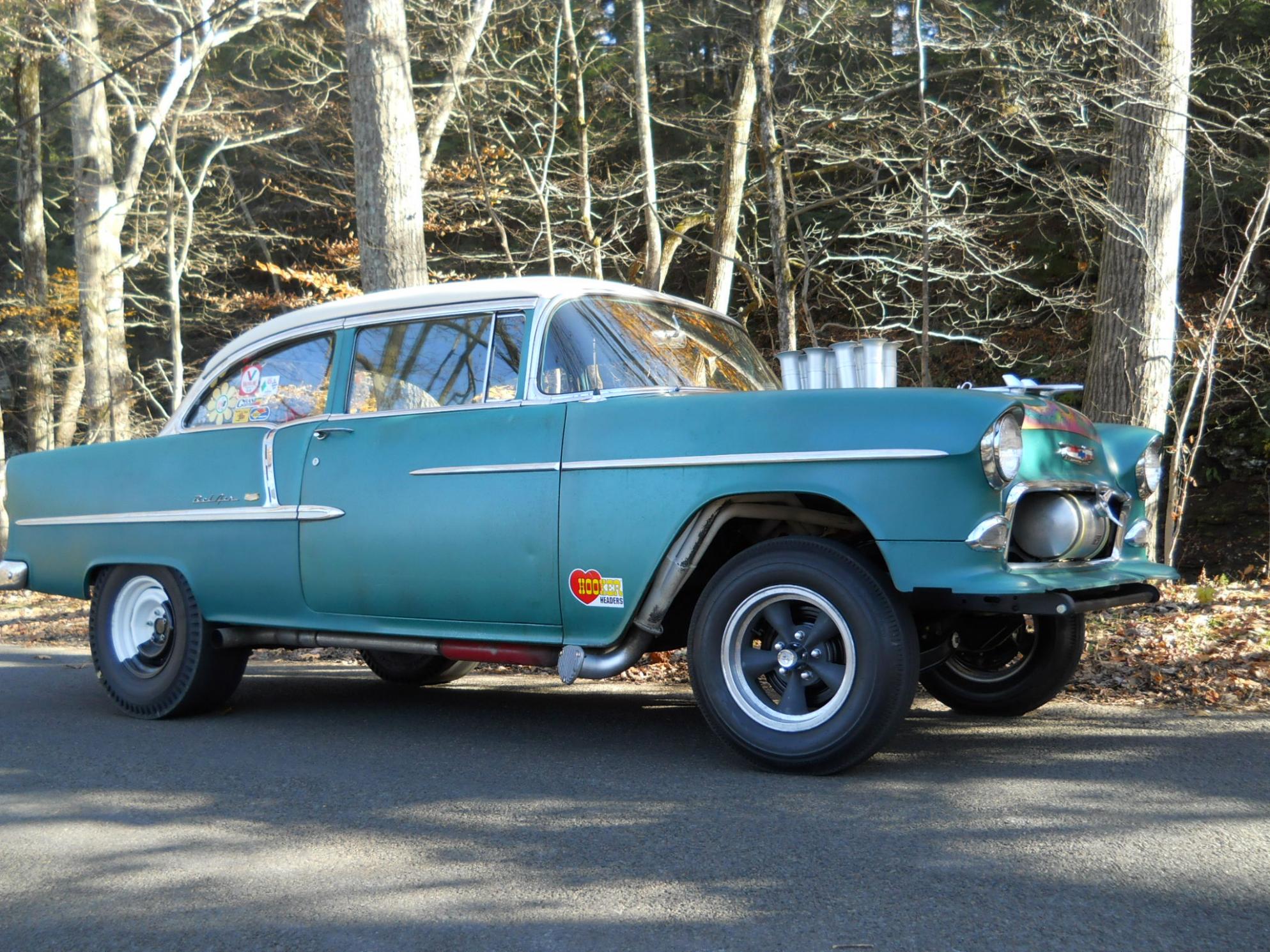

    Hey Ratmotor, You should make that shot your avatar.
    That one or a better side shot, That looks pretty wicked.

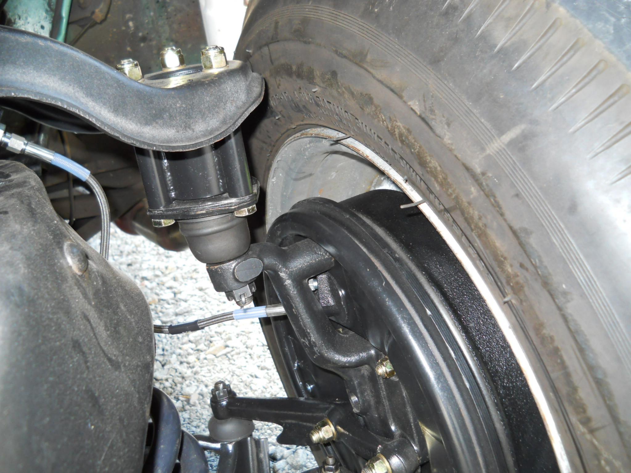

  13. The raised spindle approach I believe will widen your wheel stance on the tri-fives. 409 springs without removing a coil will be way too stiff and hard on the lower a-arms. They are also a thicker coil and tough to install. The ball joint spacers alone will not produce static lift but will allow the car to raise during acceleration and you will have to add a spacer to clear the wheel . I would not use those spacers pictured , jmo. Moog makes a #656 spring that is about an inch or so longer than stock , it goes in easy and should give around the 2-3" lift as mentioned. The ultimate way to go is a complete grafting of a straight axle set up but not everyone wants to modify their cars to that level. Just a few pointers that I explored in doing my car. I also am curious on the truck spindle approach......that is new to me.....I would like to hear more on that one too.

    Ball joint extensions aren't my favorite way to raise a frontend, but they can work if you're willing to go to heavier springs as mentioned in post #12. On a Tri 5 Chevy you'll also need to remove the bump that's tacked on the end of the frame around the coil spring pocket. It sticks out towars the ball joint and the extension will hit and bind when your suspension is lifted, or on acceleration. This is a major problem with the aluminum spacers cracking after repeated binding at that point.
    With those large C shaped extensions you'll get much more lift, and they need to be turned to avoid clearance issues. You should mock them up without the coil springs and check travel with a floor jack raising and lowering the suspension until you're sure they clear in both directions. Then reassemble with the springs and you should be good. The longer/heavier springs are fun to getin there! Good luck!
