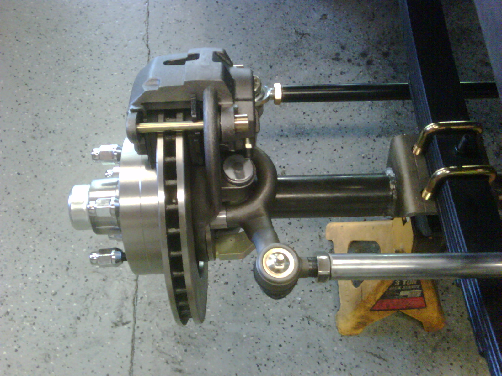

    I threw the engine in so I could weight the springs down to check my shackle angles. Spent two hours getting them right. While I had the engine in there I couldn't resist tossing the blower and headers on there for a photo op.
    Front susp is 100% welded up.
    Saturday is front end ***y
