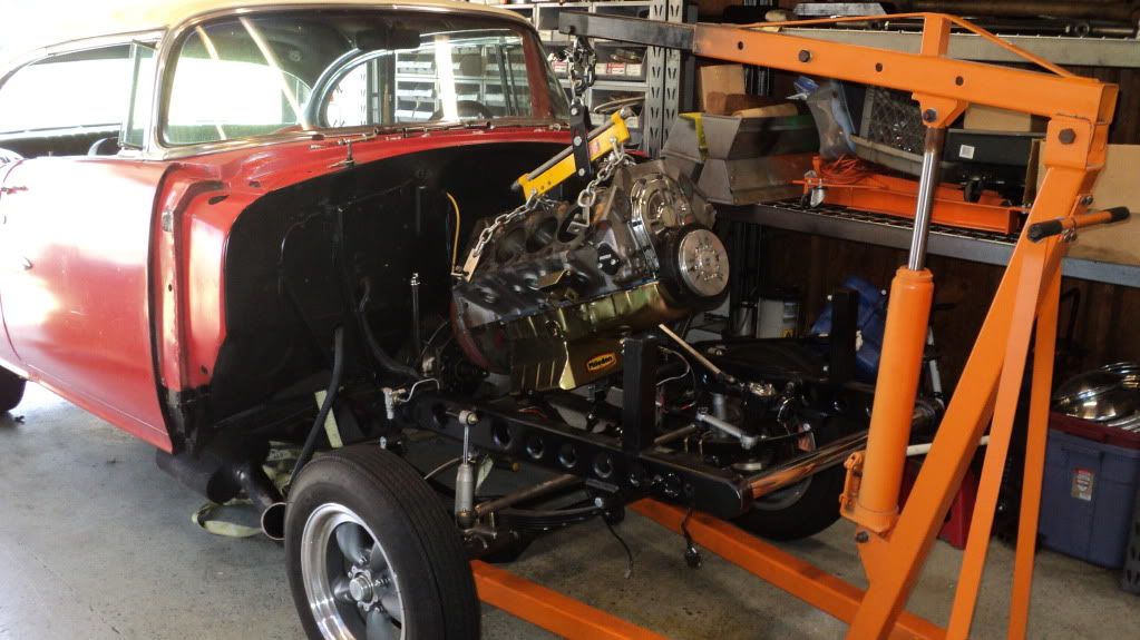

    Joined: Jan 18, 2008
    Posts: 176
    truckjunky24
    Chopperman, not telling you how too do it, But why did you bolt the converter to the motor and not put it in the trans too make sure it goes in the trans pump ??? it will bolt up if not in the pump! if not in, new trans time!!! it will kill trans pump when you fire it up!!!!! Just asking!!
  24. brewster55
    Joined: Sep 2, 2010
    Posts: 149
    brewster55
    good eye!
    thats bad news.
  25. truckjunky24
    Posts: 176
    truckjunky24
    Been there , done that when i was younger and knew it all!!! LOL!!
  26. Chopperman
    Joined: Sep 26, 2006
    Posts: 1,273
    Chopperman
    Your the second guy to notice:D
    I do this all the time. There is plenty of room in there and it slipped right in with no binding at all. I just make sure to visually line the pump gear up vertical with a screwdriver and then rotate the engine ***y over to match prior to dropping it in. All is good.
    I got a perfect matting surface block to ****** on the first shot. If I was off on the pump, I wouldn't be able to mount the block to the trans without a 1/2 gap and then wrenching down and binding the converter against the pump housing (that would be bad)
    Not recommending this method for everyone, but it seems to work for me.:D
