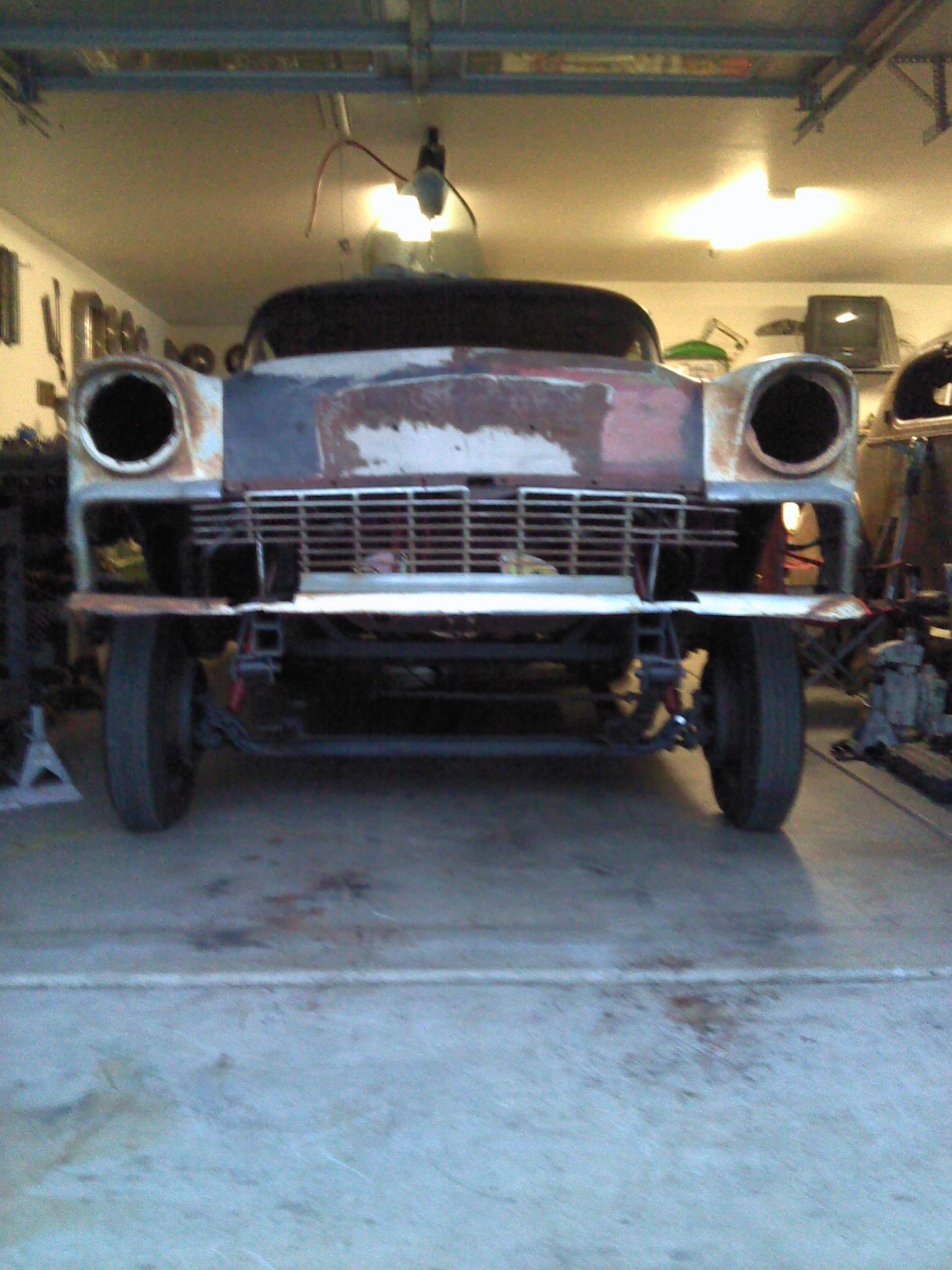

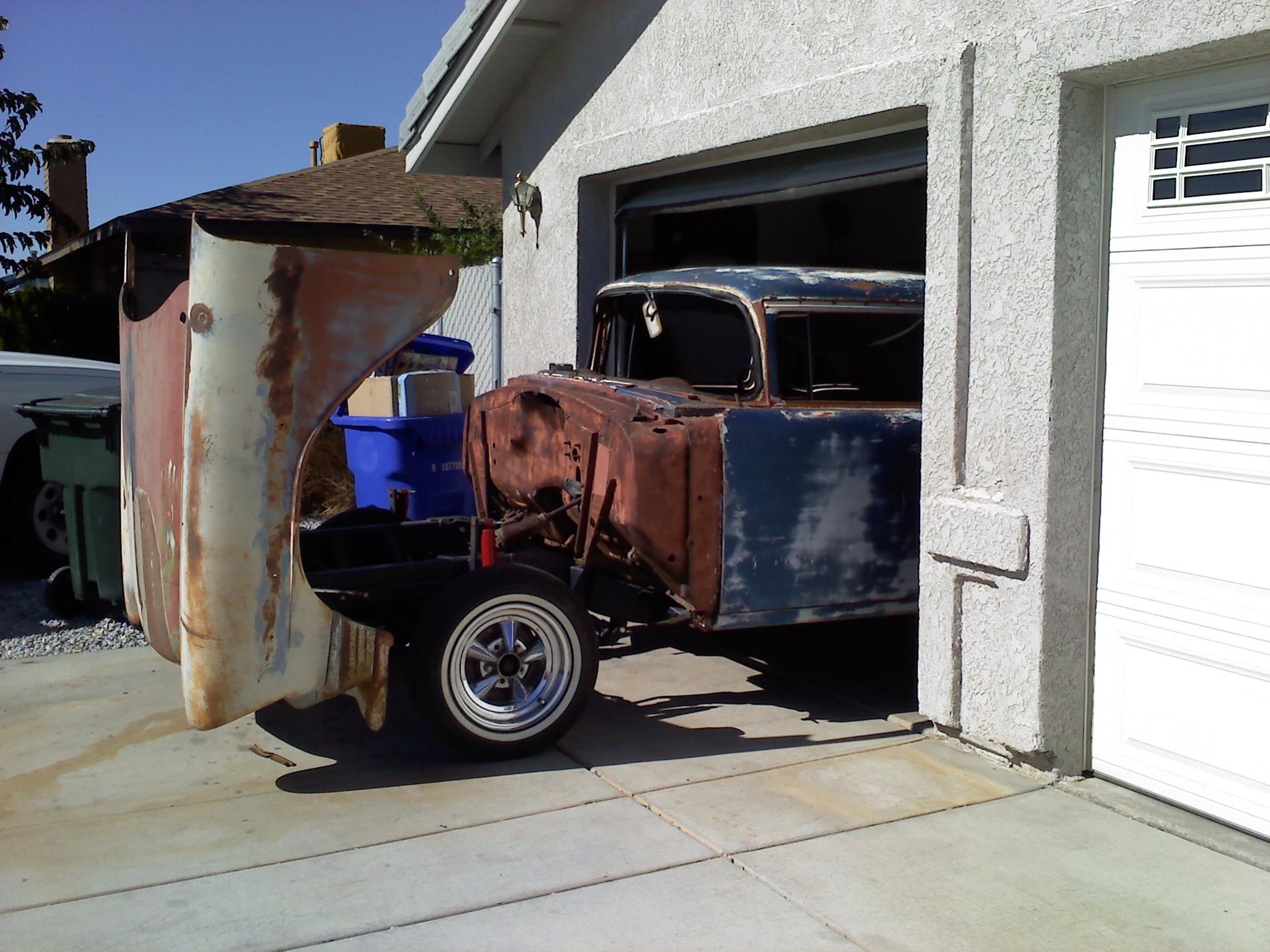

    I need advise, my axle is too wide as I have stated before. 46-53 front I-beam streight axle is 50-1/2 king pin to king pin, thats what I need. Now the problem is my leaf spring location is 31-3/4 center to center. On the 46-53 truck axle its 26.6 center to center of leaf springs. What in the Phuck do I do with that???? Am I stuck with what ive got? does anyone else have this problem? and corrected it somehow? I dont want to cut off what ive got but it seems that is the only way to get all my wants and needs fixed. I want my wheels at stock width and what I have now looks stupid....Please help. What other streight axle has 31-3/4 center to center on leaf spring mounts and 50 inch king pin to king pin? Call me at 512-809-3711. My name is graham. Thanks. or post up what you got and pics, or send me some liks to other 55 g***ers with this problem.

    Well if you don't want to cut anything you're going to have to get a tube axle made that accepts your spindles. That would be your easiest solution.

    You really don't need a different front axle. The 55-59 axle is not too wide if you run the right wheel, with the right backspacing. Of course with a 7" wheel it will always look too wide, but a 3.5"-4.5" wheel will fit and look great.
    Why not look into a pair of Rocket 10 spokes if you don't mind new, or a used pair of slots in narrow width?
    I had a '56 Chev truck axle in my '55 g***er with 4.5x15 Fenton slots and skinny tires. It looked great, but 3.5"x15" look a tiny bit better! That's what I'm running on my present g***er. Found mine on the G***er Forum complete with new tires for $500 a pair.
