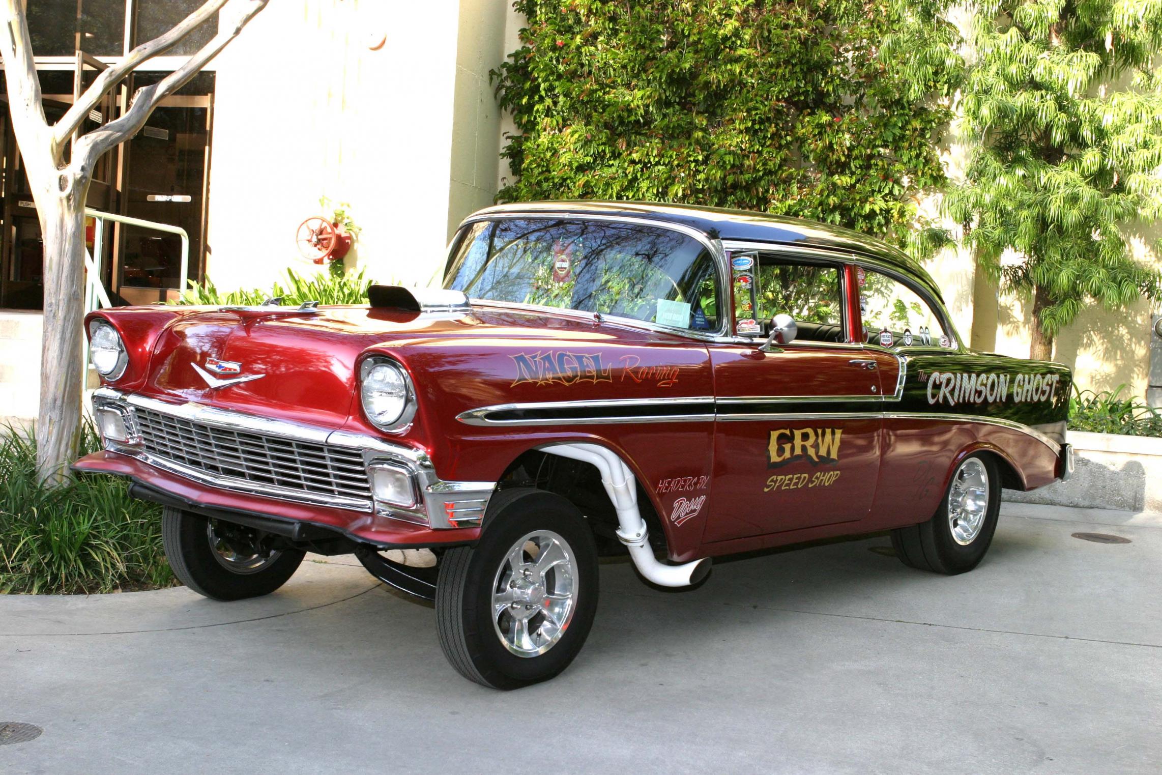

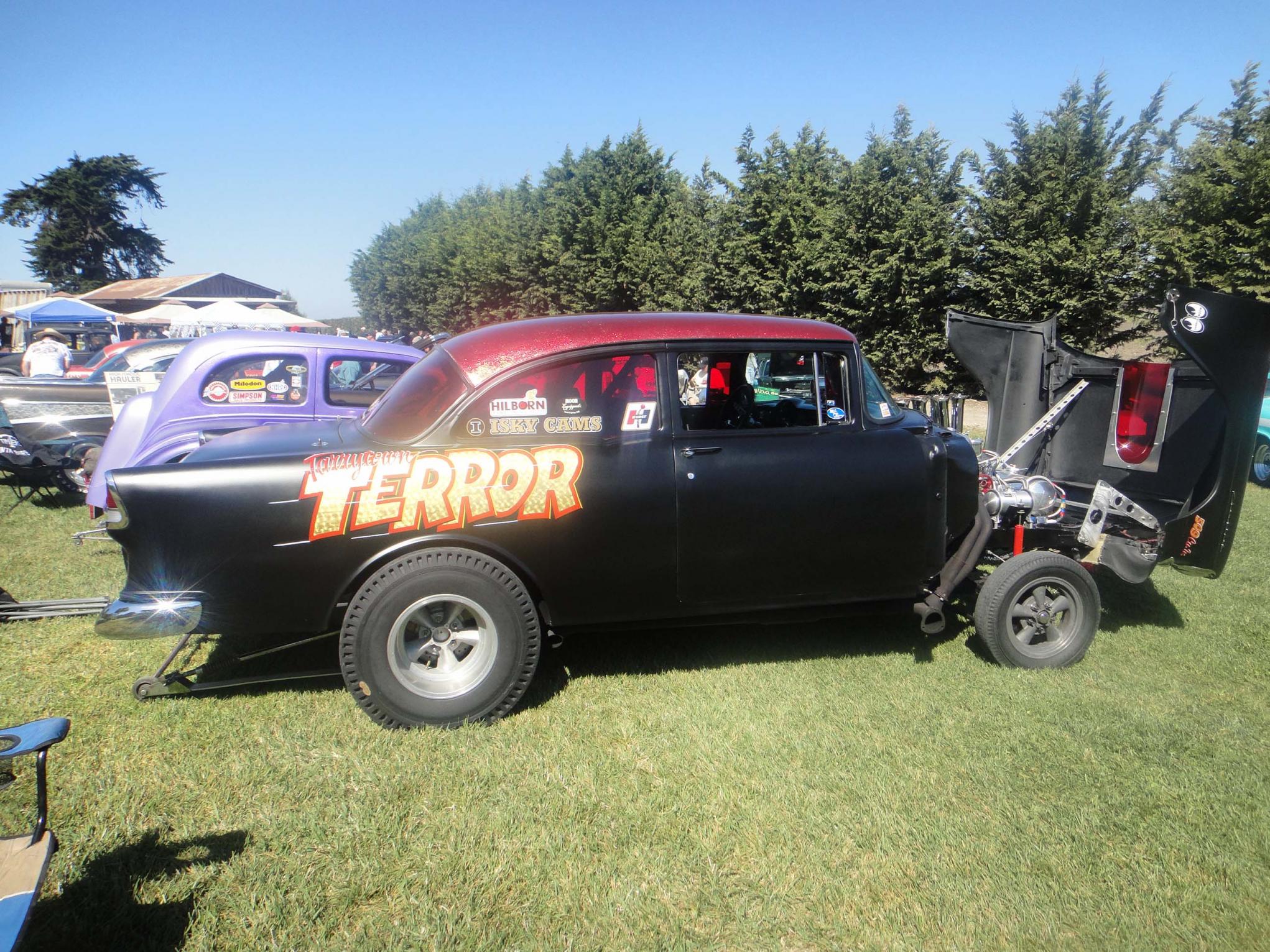

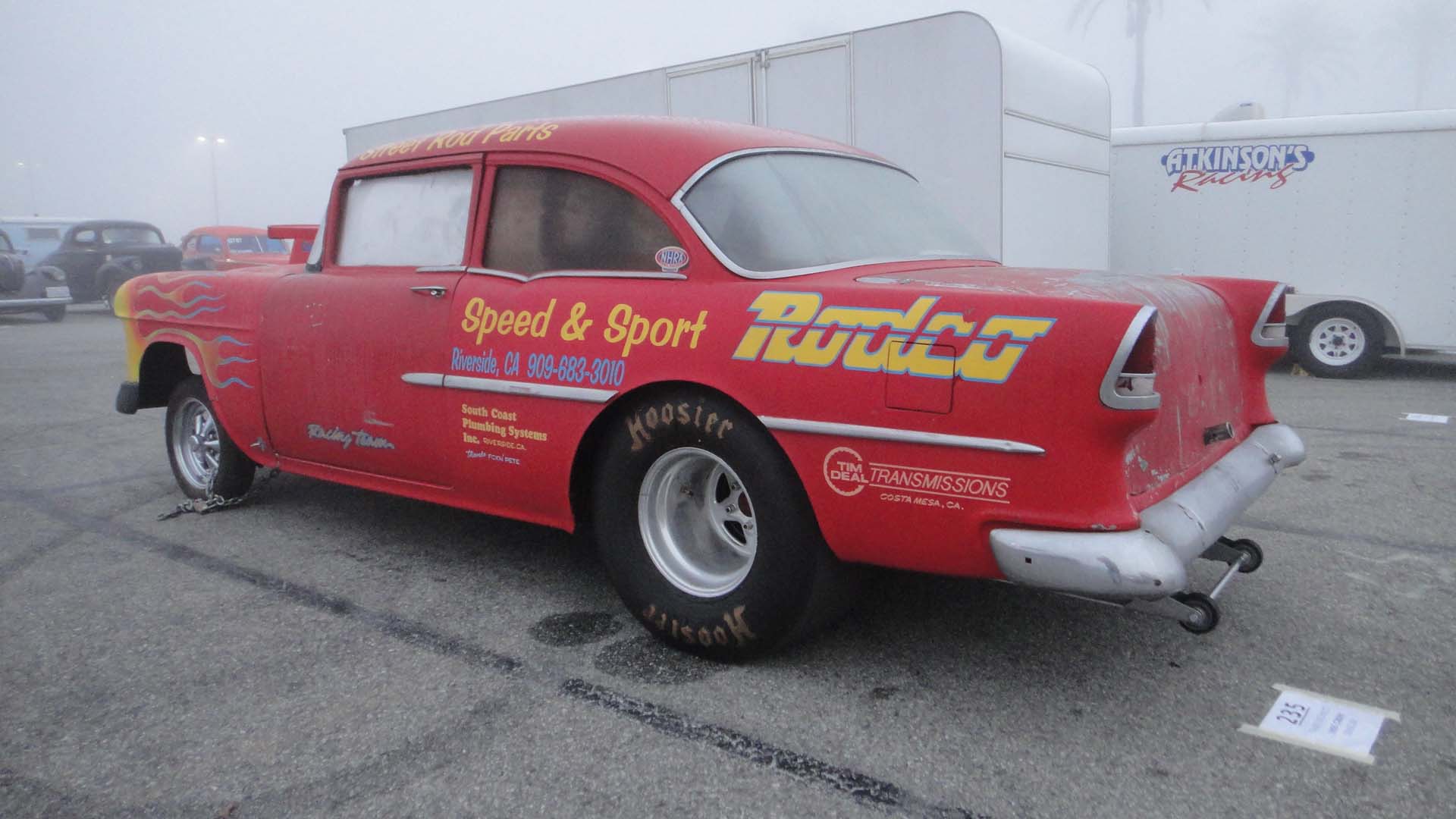

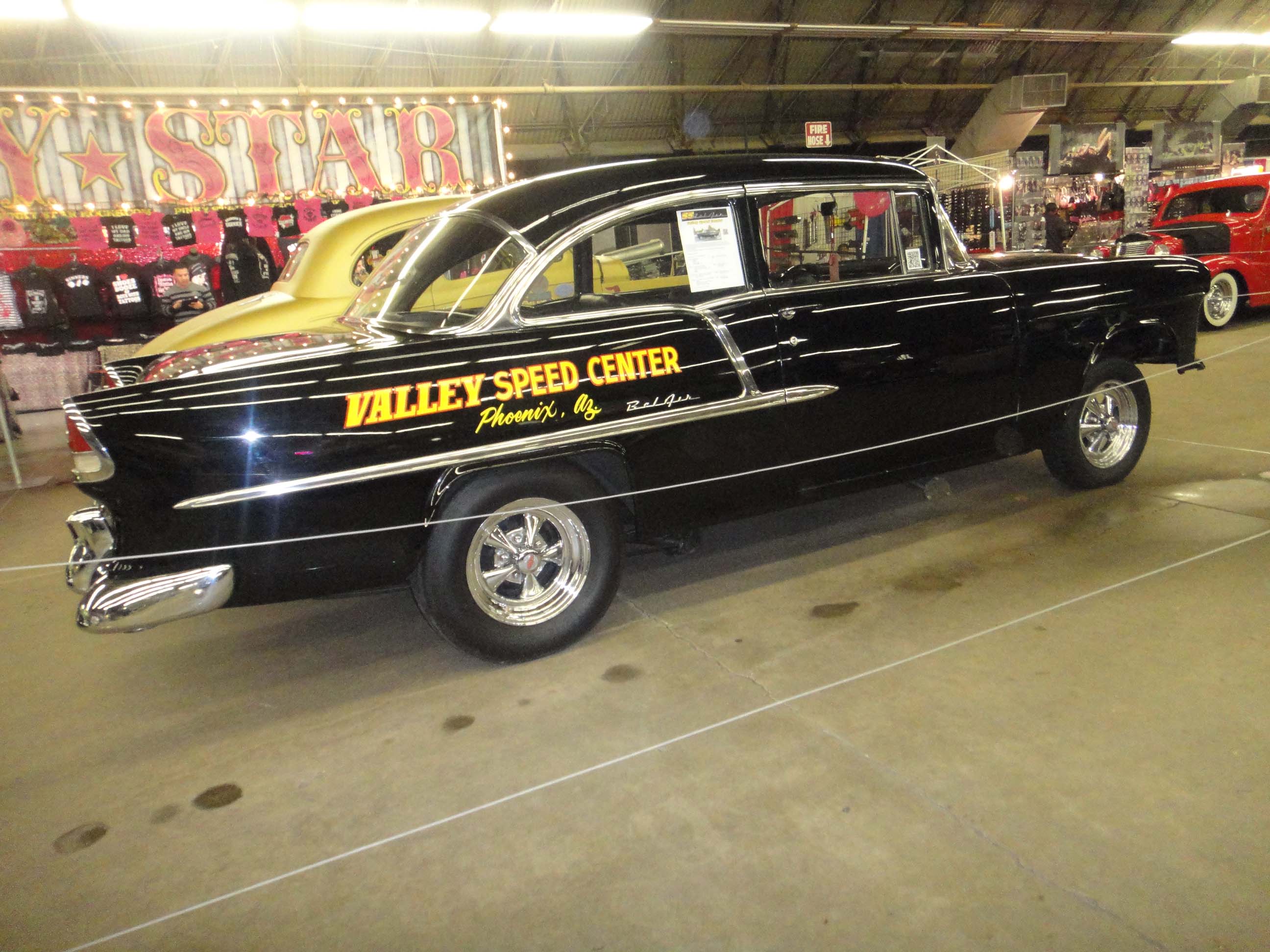

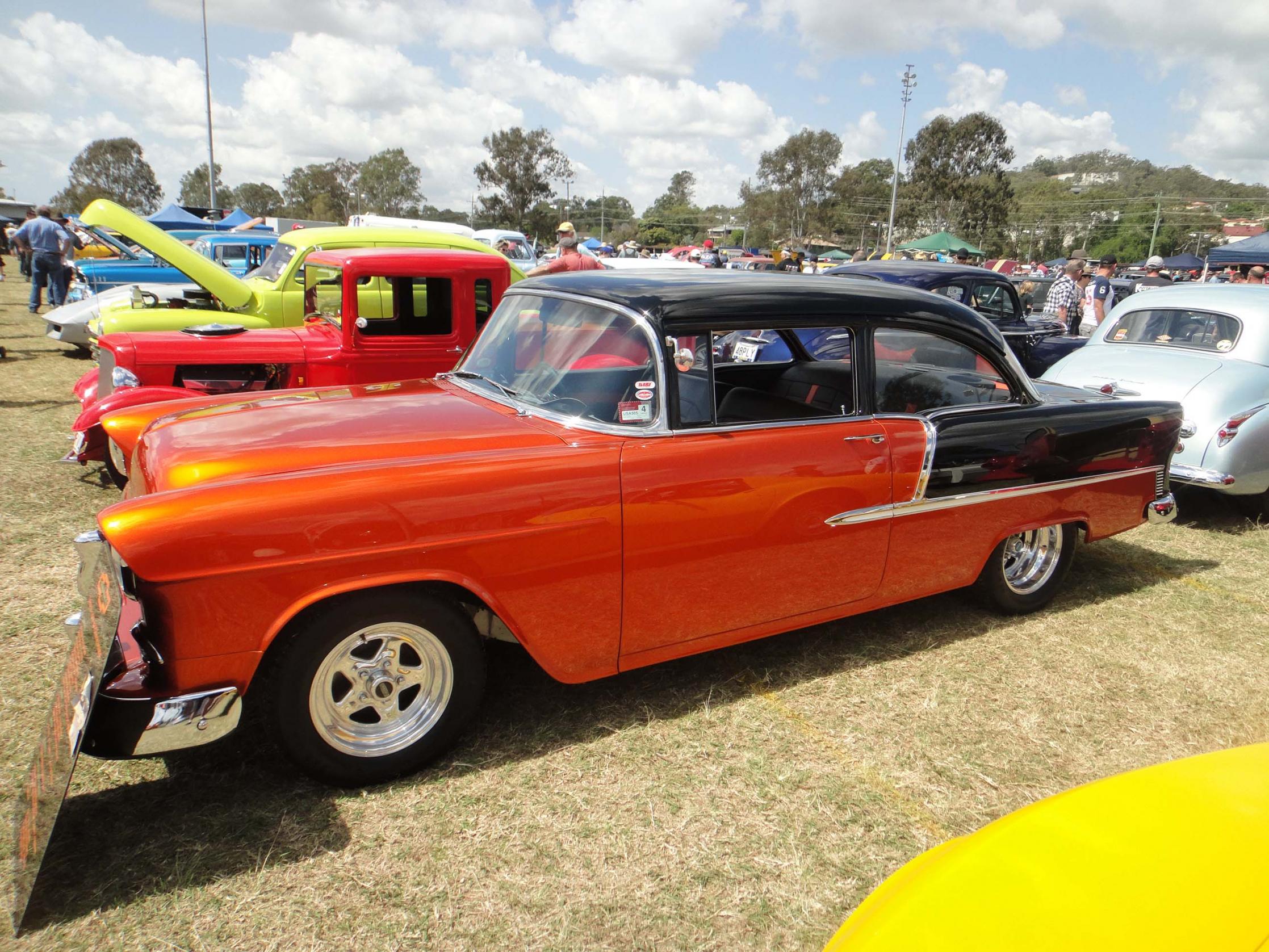

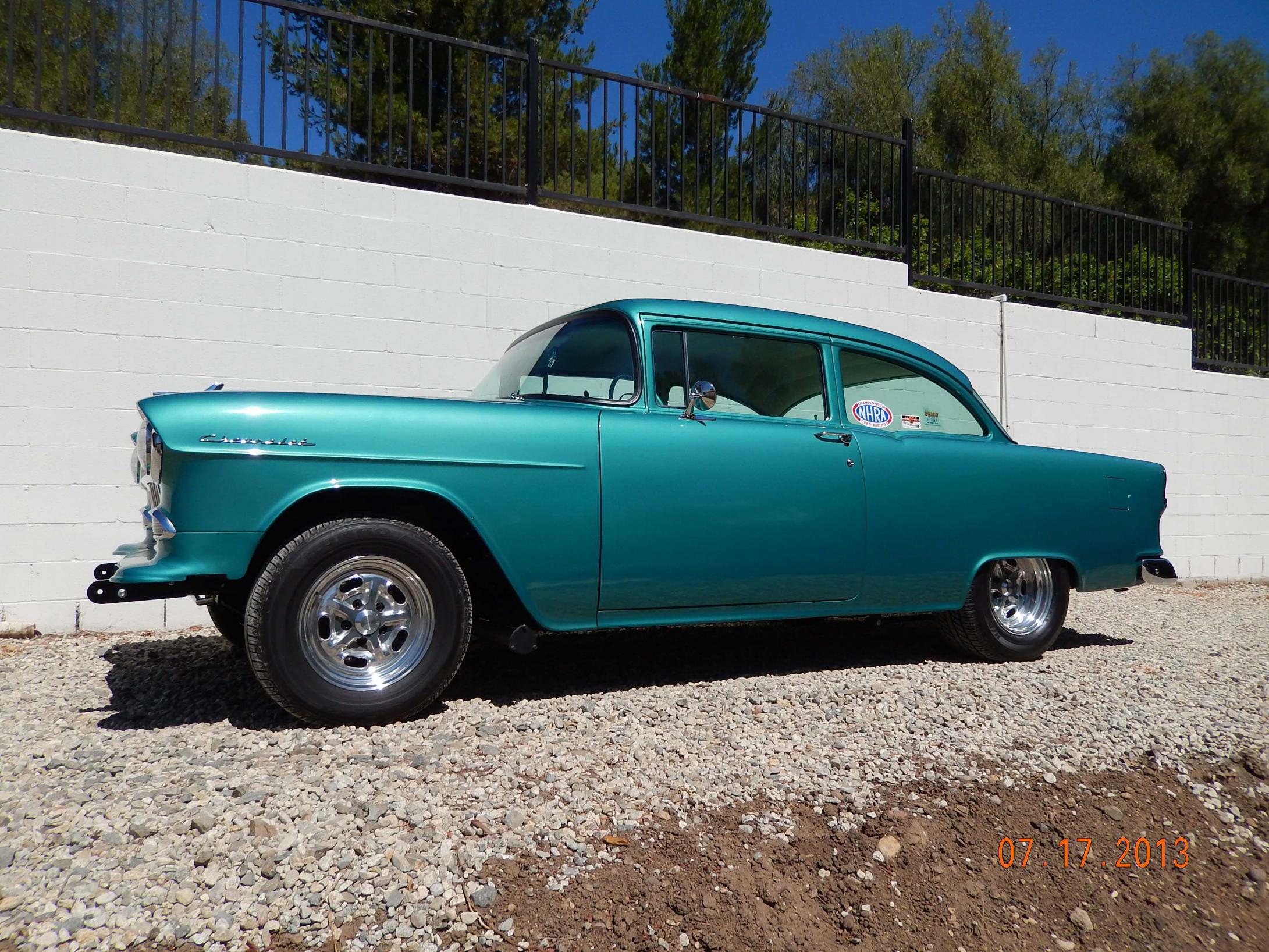

    Here're some tri-five ride height pix. IMHO, if bottom of the rocker panel is above the center of rear axle, it will begin to look like a street freak or 4X4. If you're running old style ladder bars where it's welded to the rear axle housing and pivots on the front, you'll need a floater (what I run) or shackle in front of bars to prevent spring windup and eventual breakage. Enjoy!
  2. Cool pics for sure, but they look really different with radiused rear wheels.
    The rocker to wheel center relation is the first thing I look at or at least that's the first that catches my eye and I'm forced to look there first. Either way, it all seems to start there.

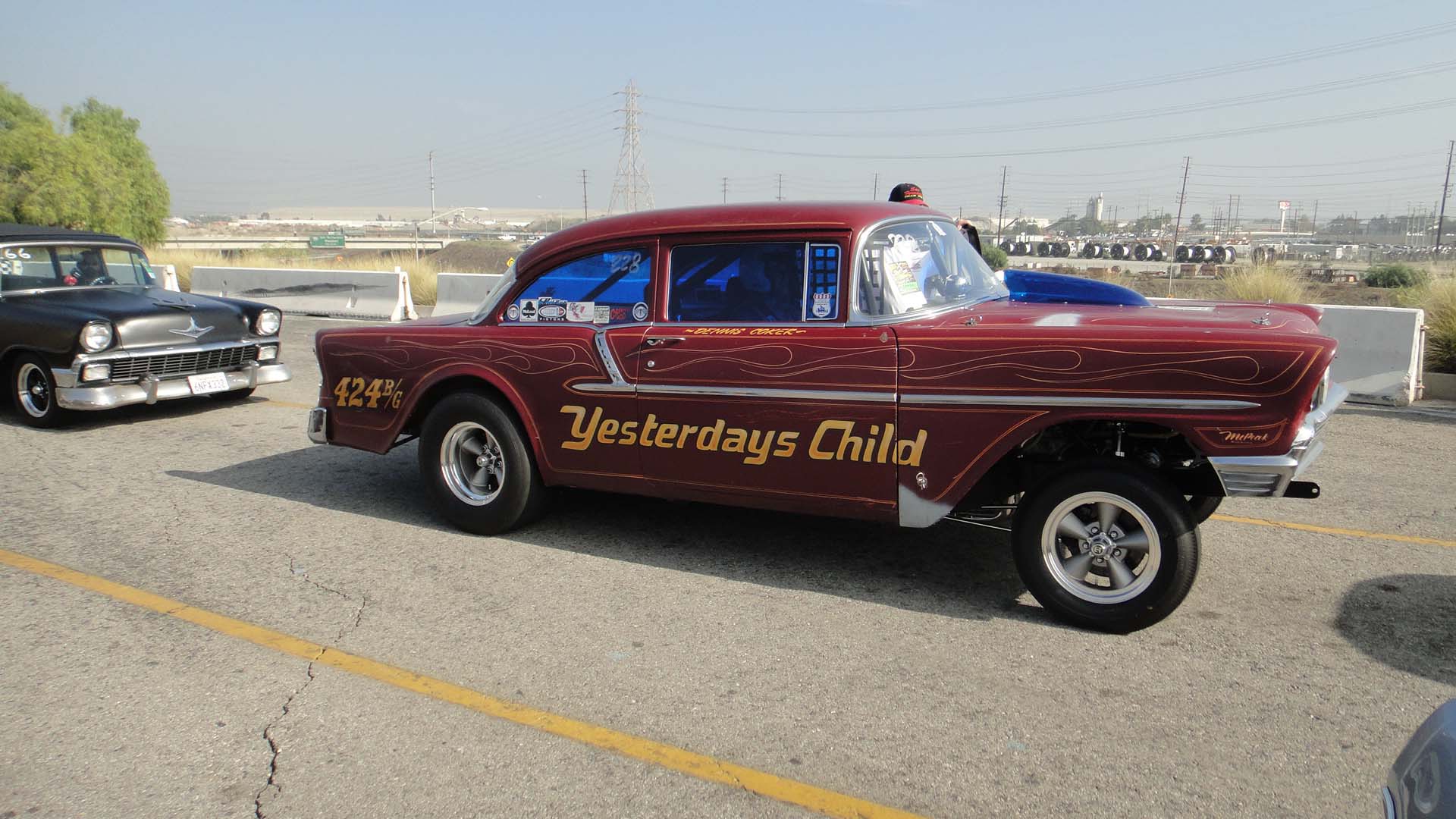

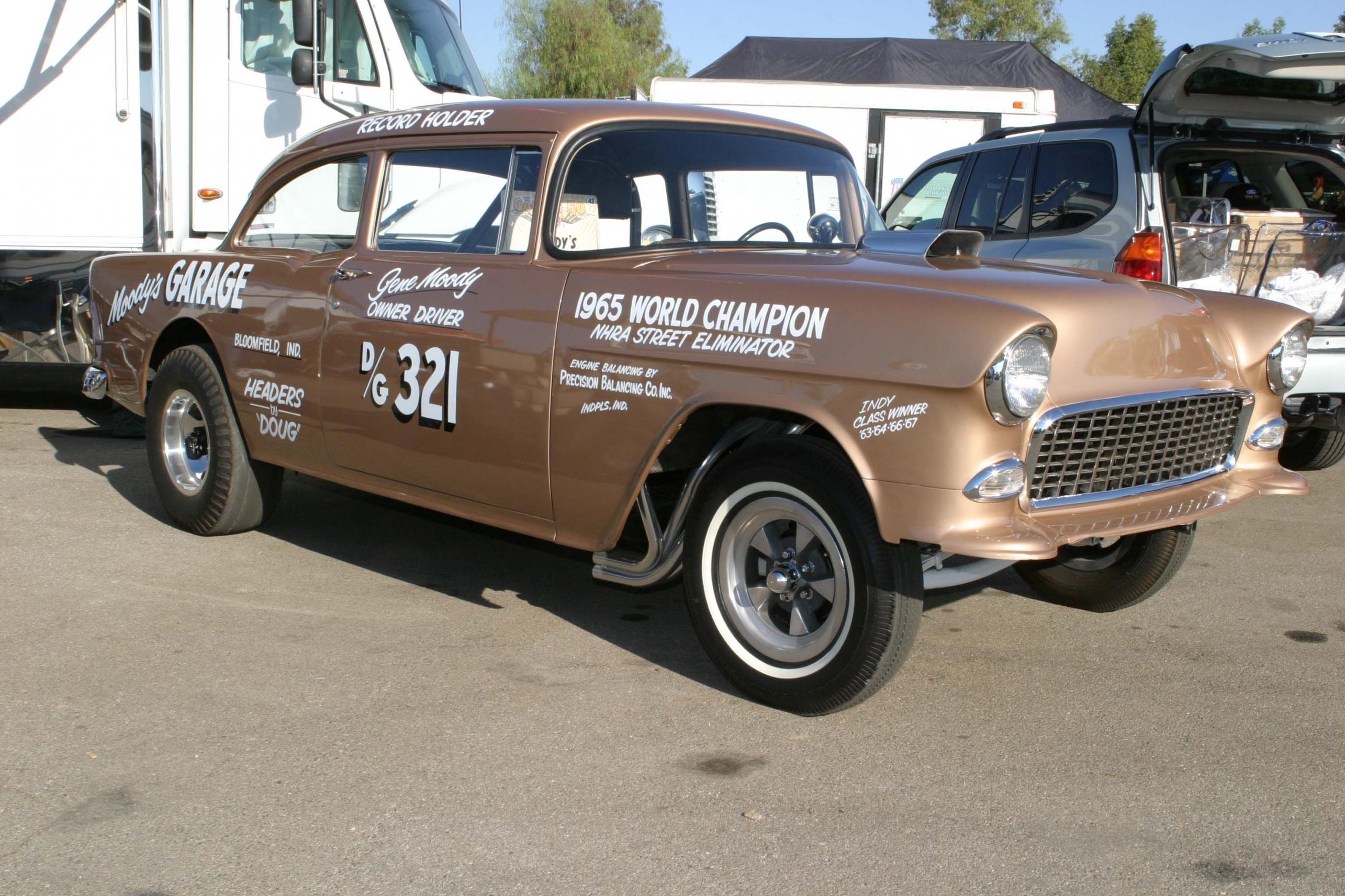

    I totally agree with both of your ***essments to ride height. Rocker panel too low - looks droopy and too high, it begins to look like a 4X4. One of the first things that catches my eye is the level of rocker panel in relation to axle centerline, then a slight nose up... but then, to each his own. To me, the more serious cars had fenderwells radiused - at least it seems that way. Back in the 60's, I couldn't afford to radius my rears and tires weren't allowed to exit the fenders (if it was a street driven car) in our state so it was a no no. Some people liked to graft a Nomad rear fender opening which was okay but I personally prefer the tradional round opening - screams G***er!
    Laws have relaxed quite a bit especially in CA so we can get away with things now we couldn't back then. A few more pix to enjoy!

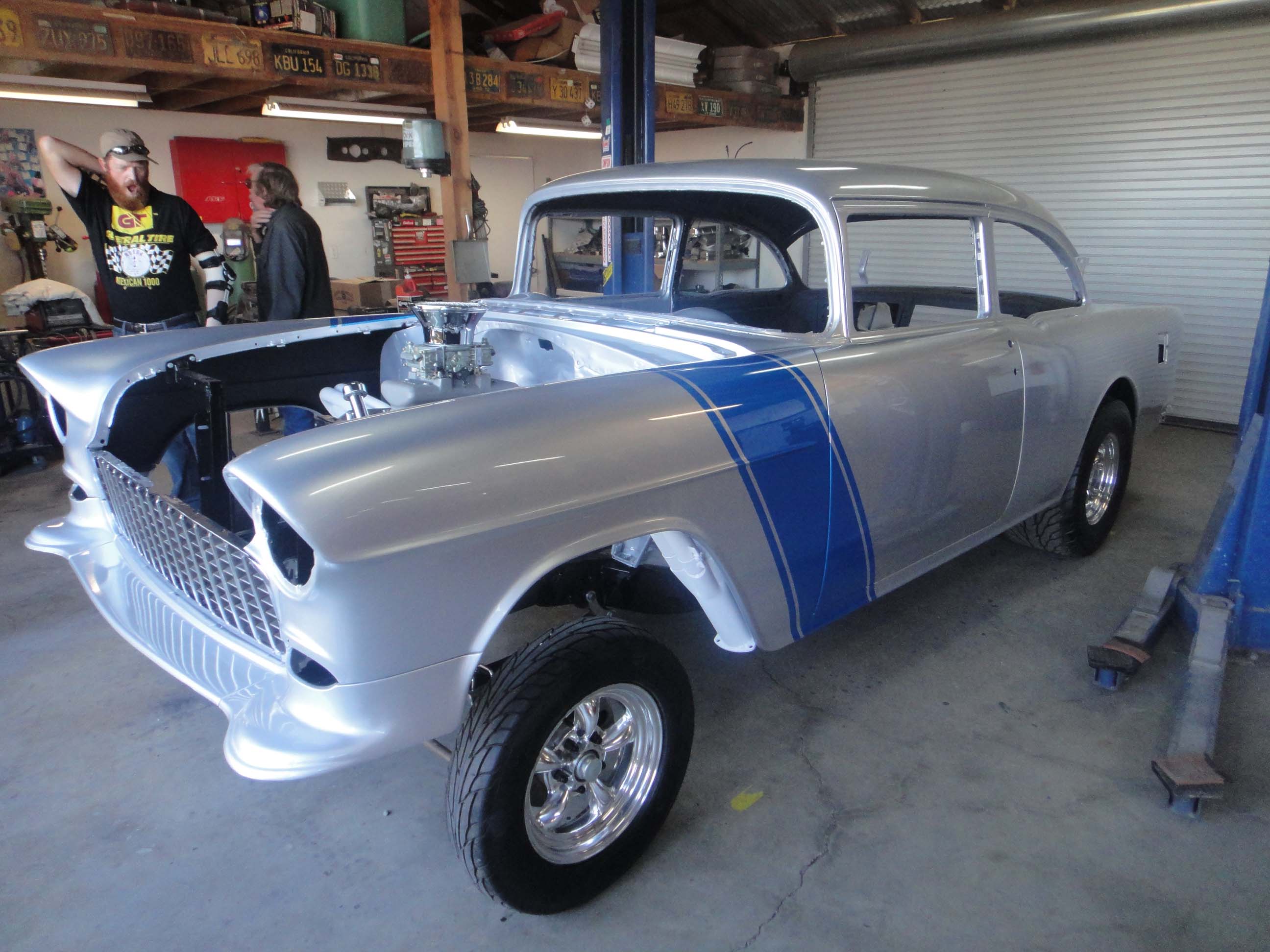

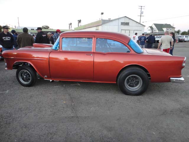

    This is one of my all time favorite angles of a G***er.
