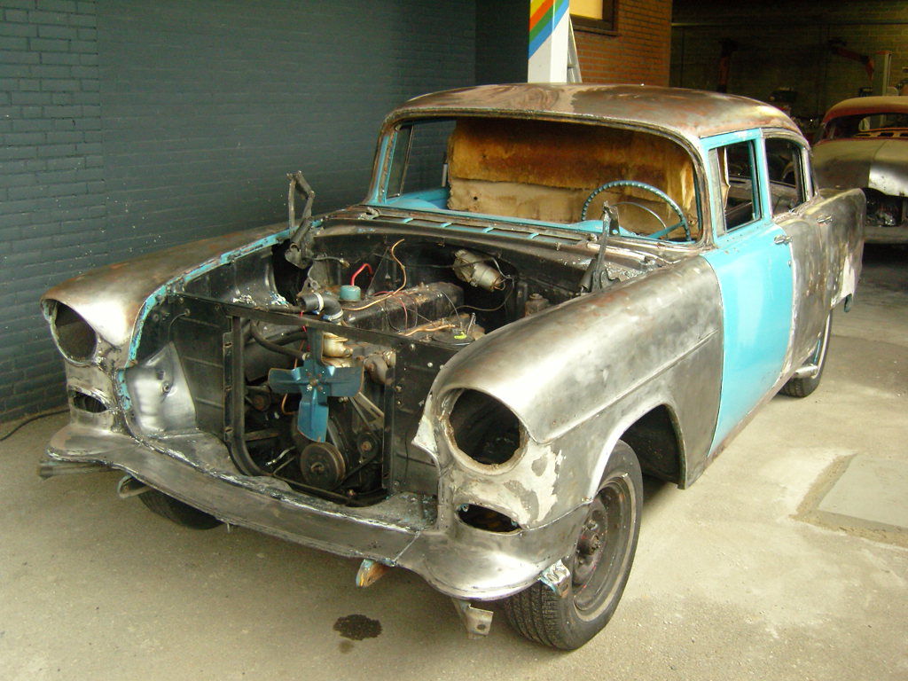

    Are there any good lookin kustom 55 chevy's outthere?
    I am building one for a client ,4 dr to 2 dr conversion, we are half way and she is lookin good ( at least I think).
    let me know how youlike it (or not)

    I like the looks of the 2 door conversion but I don't know if I'm feeling the new revised shape of the C-pillar. Did you cut the roof to use a hardtop windshield, or are you planning to cut the glass for the windshield?
    One-piece bumpers should look nice, nothing wrong with shaved trim, I don't understand what's happening to the gas filler door. Also, what are you going to do for parking lights, with the stock holes shaved? The radiused wheelwells front and back are interesting.

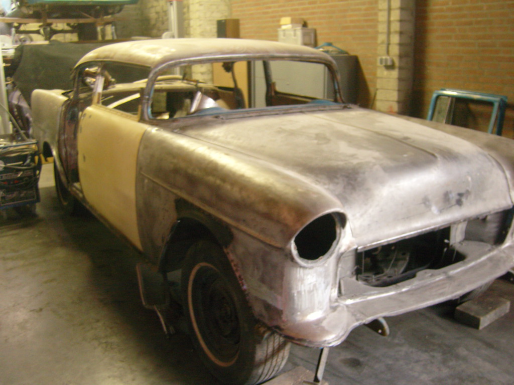

  20. trusty-t
    Joined: Apr 12, 2005
    Posts: 47
    trusty-t
    We made our own C-pillars, the ones in the pic are just for support as we cut the roof , we did a 3"chop and shortened the roof 4", the gas filler door we placed inside the trunk, cut the filler and turn it 180 degrees .
    I hate those chunky parklights ,they had to go. (maybe some different eyebrows)
    As for the windshield we have somebody make us a new one, we make the mold , I also did a 56 Buick topchop (Scapers Willems car).I tried to cut the glass on the Buick and it worked till it was 3 days in the car ,I went into the shop and and it was broken.it is expensive but it's worth it.
    cheers
  21. trusty-t
    Posts: 47
    trusty-t
    [​IMG]Here a some new pics we did not do much on the the car due to family problems of the client,but hey we are gatting there...
