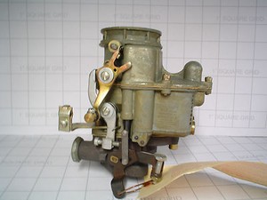

    I know i need to eventually get another one esp when i get an intake ( speaking of, blue thunder or mummert?) but i think mine right now could do with a solid cleaning/rebuild. As far as i can tell this is a stock one that came on it, i believe its a holley of some sort based on what i read but it does say Ford on it. Does anyone have a kit or anything they would recommend or should i just replace it? i want to say it looks like this one here
    https://i.ebayimg.com/images/g/xz4AAOSw~JhfxCAK/s-l300.jpg
    or from a profile view it does look like this
    https://i.ebayimg.com/00/s/MTIwMFgx...-kPG5NBSc9ICISrQ~~60_35.JPG?set_id=880000500F
