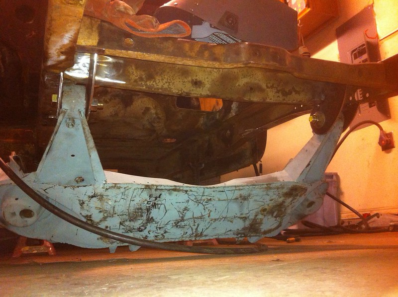

    Looks like my dad got the subframe stripped and cleaned up along with the front portion of the frame. The jag rubber frame mounts showed up so he pushed it under to see how everything looked. The trans am will be here next Sunday and at that time we will locate the subframe along with the motor. I hope to come off the subframe with the engine mounts so it can all be dropped as a unit for service. My Dad takes horrible pictures as always.

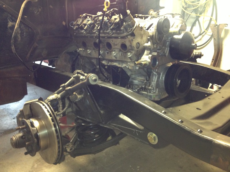

    We were able to get the trans am home last weekend and had the motor out a couple days ago. The ch***is is already sold and the buyer is picking it up tomorrow. With shipping we have $500 into the motor and trans.

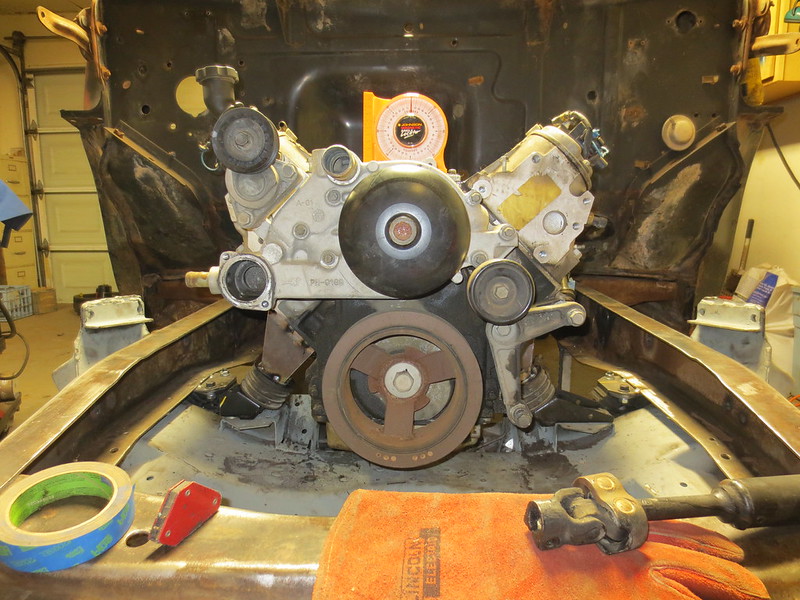

    We ended up using one of the LS truck oil pans to clear the rack, but other than that the motor fits well without having to modify the jag crossmember. It will be soft mounted, but we did still have to notch it a bit to clear. Next up is frame boxing and mount fabrication. I will relocate and modify the existing trans mount, and engine mounts will come off the crossmember so it can be dropped as a unit.

    I was sick for a week after Christmas so things slowed down a bit. The last few days have picked up and the mounts are now tacked in. I need to fit mid-fifty frame boxing panels and will then do the finish welding on everything. The rear mounts will be vertically gusseted to the inner frame boxing panels and I am considering boxing the front of the forward mounts as well.

    The motor and trans are now mounted. I forgot to get an image of the trans mount, but we were able to modify and relocate the existing ford engine crossmember to work with the 4l60e. The engine mounts are getting pulled off tomorrow for final welding and a boxing panel added.
    I picked up a majority of the seals and an oil pan with better ground clearance to use on the motor.
    Does anyone have any tip for adapting the F-100 steering shaft to the jag hinged joint? Is the ford shaft keyed or smooth under the spiral drive piece?

    Looks like my dad went ahead and put the subframe under it. Motor needs to go back in to position the bar that is replacing the old cab/running board mount crossmember.

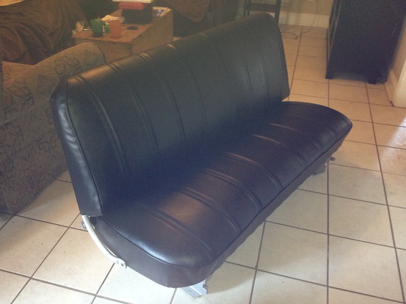

    My Dad finished up replacing seals, pumps, and oil pan on the motor. The subframe is now back together so all that went back on the ch***is. He also finished covering the seat and built the doors. Next up is brakes, fuel, steering, and then exhaust.
