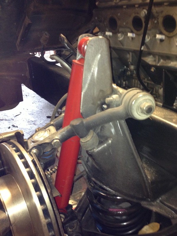

    Not too much progress, but my dad did finish up the shock mounts. He is painting the wheels this week and should have the steering done once the rack side joint shows up.

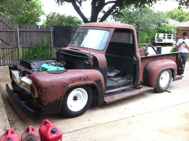

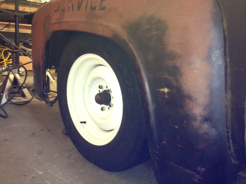

    My dad painted the wheels and trimmed the fender liners for the shock mounts over the weekend. We found an aluminum driveshaft from the 04 trailblazer that was the proper length (51").
    The tires should be mounted once the paint has set a for a few days. Excited to see how it sits.
  7. NoClassic
    Joined: Jan 18, 2008
    Posts: 89
    NoClassic
    from DFW
    My dad had all of the tires mounted and the rear looks good. The frame is going to need a small notch at the ride height we want. The front needs wheel spacers and maybe a taller tire than the 235/70 we have now. He also installed a majority of the sound insulation, the front sheet metal, and finished building the doors.

    The jag spring rate was not going to get us the ride height we so we decided to bag the front. I would have rather used the springs considering the trucks intended use, but it was just not going to work. The bags also make servicing the suspension much easier as compressing the coil springs would require droping the subframe. I still think the tire needs to be taller.

    As for the ride height that is not my main motivation in wanting a taller tire. It would mainly just be an attempt to fill the wheel opening and come closer to the rear diameter to reduce the "rake" a bit. There is almost a 3" difference in overall tire height front to rear. I think something between 30-31" should look right if it will clear.

    Finished up the notch in the rear, and made some changes to the front shocks as we need more travel out of them with the bags. The brake lines are also now complete, and we finally got the steering shaft back after three weeks at the machine shop. One of the crossmembers under the cab needs be changed to clear the driveshaft so that is next on the list. Still need to tuck the bumper a few inches, its just sitting there for the image.

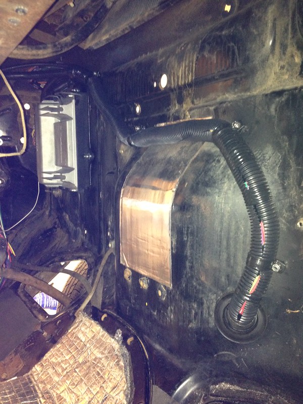

    We have been slowly making progress with a few changes that took more work that expected. We modified the front cab mount crossmember so it can be removed in order to drop the motor while attached to the subframe. We also had to modify the rear cab mount crossmember to clear the driveshaft.
    I was not too happy with the front brake lines so those were plumbed again. This time through the boxed frame rails exiting at the bottom just ahead of the subframe mount. All but a short front section of the fuel system is now complete as is the rear suspension. My dad bought the air shocks before we decided to use the 8.8 and could not return them. Not ideal but I guess they will be nice if it has something heavy in it.
    I really struggled with the gauges and would have liked to use a long sweep electronic speedo behind the stock face. I could not find anything that I felt would work so ordered a new set. I am sure some will hate them, but its the most basic design I could find without breaking the bank. They are going to sit in the stock housing behind gl***. Trying to find a local CNC router or laser cutter to have the internal surround done. May resort to hole saws if that is too expensive.
    We also tucked the bumper and I had to replace the 4l60e front pump rotor after my Dad fractured it while attaching to the motor. The engine harness is in along with the PCM. Just today I mounted the ch***is fuse panel and ran wires outside of the cab down/inside the frame rail. Also fixed the emergency brake lever, re-reouted the cable and adapted it to the explorer 8.8 section.
